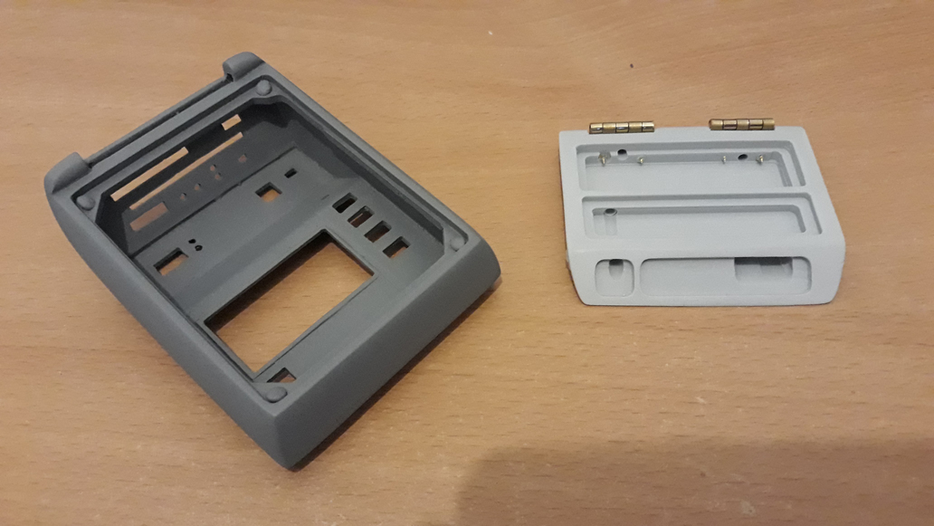

So I've been working on a few things. First I've drilled the holes that will accommodate the wiring, including to the metal hinges (which will connect the bottom part to the main body). I've also stuck the back of the main body on, and blended it in with putty. A few coats of primer and sanding with a 2500 grit have got the seam almost impossible to see.
The next thing I'll be tackling is colour. I've done some tests with the back plate using a Vauxhall Astro Silver. For comparison I've place the buttons, and the raw resin next to it.

What do you think? Too light, wrong saturation of colour (blue grey vs brown grey)?
I use Vauxhall Smoke Grey for all of my Star Trek Starfleet props, it is by far the closest silver I could find in the UK.

On another note I've cut out some clear plastic to replace the solid inserts at the bottom of the flop out section so the light can be seen.
I don't suppose anyone has come across hinges that match the size and shape as the brass ones supplied but in zinc or other conductive silver material?
The hinge arrived but it's a bit too small on the hinge itself. So I'm going to go with the one that Stapleton sent with the kit. Right now I can't do much more until I get the electronics from Gerry (he's been a bit busy which has meant it's taken a bit longer for him to get electronics sorted) and I've tried to match the paint colour (hopefully propninja will be able to send this to me).

What about taking them somewhere to get them plated? A chrome plating over brass knocked back with ScotchBrite is a pretty close match to the 7173 color.
