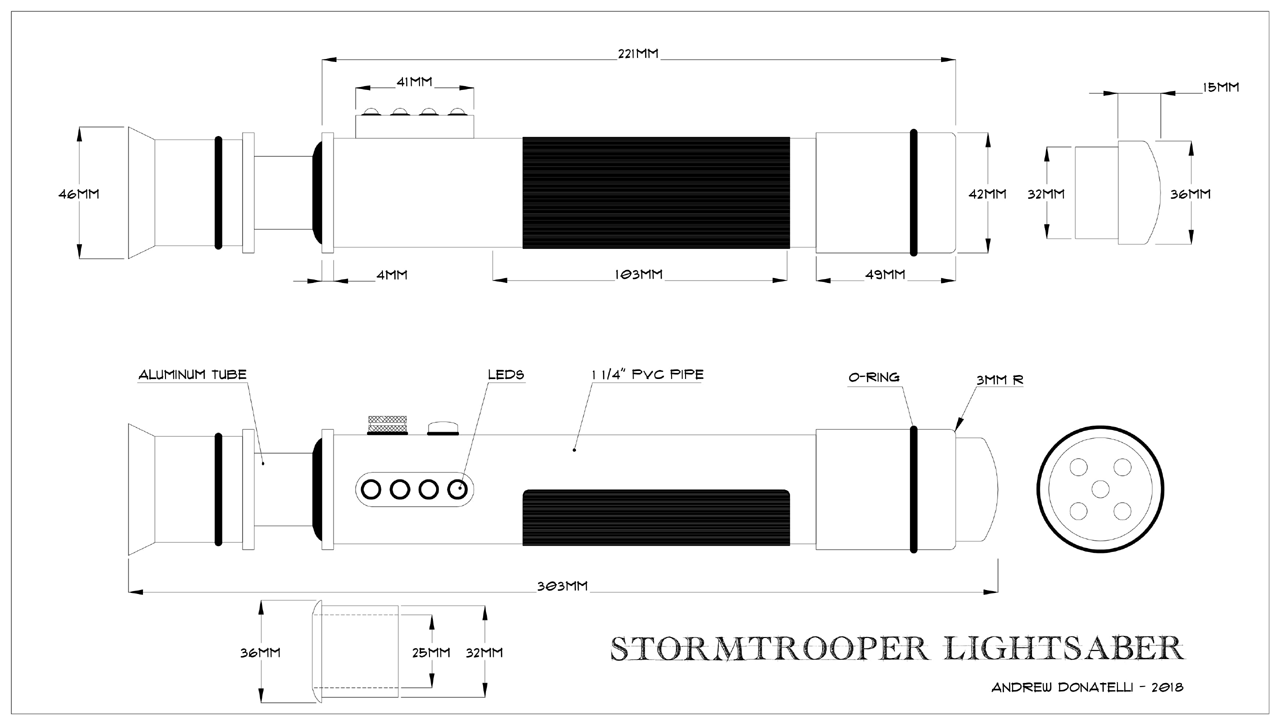

Other than adding bits and pieces to a flashlight, I've never made a saber, so I'm going to attempt a scratch build. My intention is to make as much as I can myself, including the electronics and maybe a crystal reveal. I've never even seen a saber with electronic effects first hand, so I'll be working blind a bit, but I'm going to jump in and see what happens.
I've decided to build a Stormtrooper saber.
First thing is the drawing.

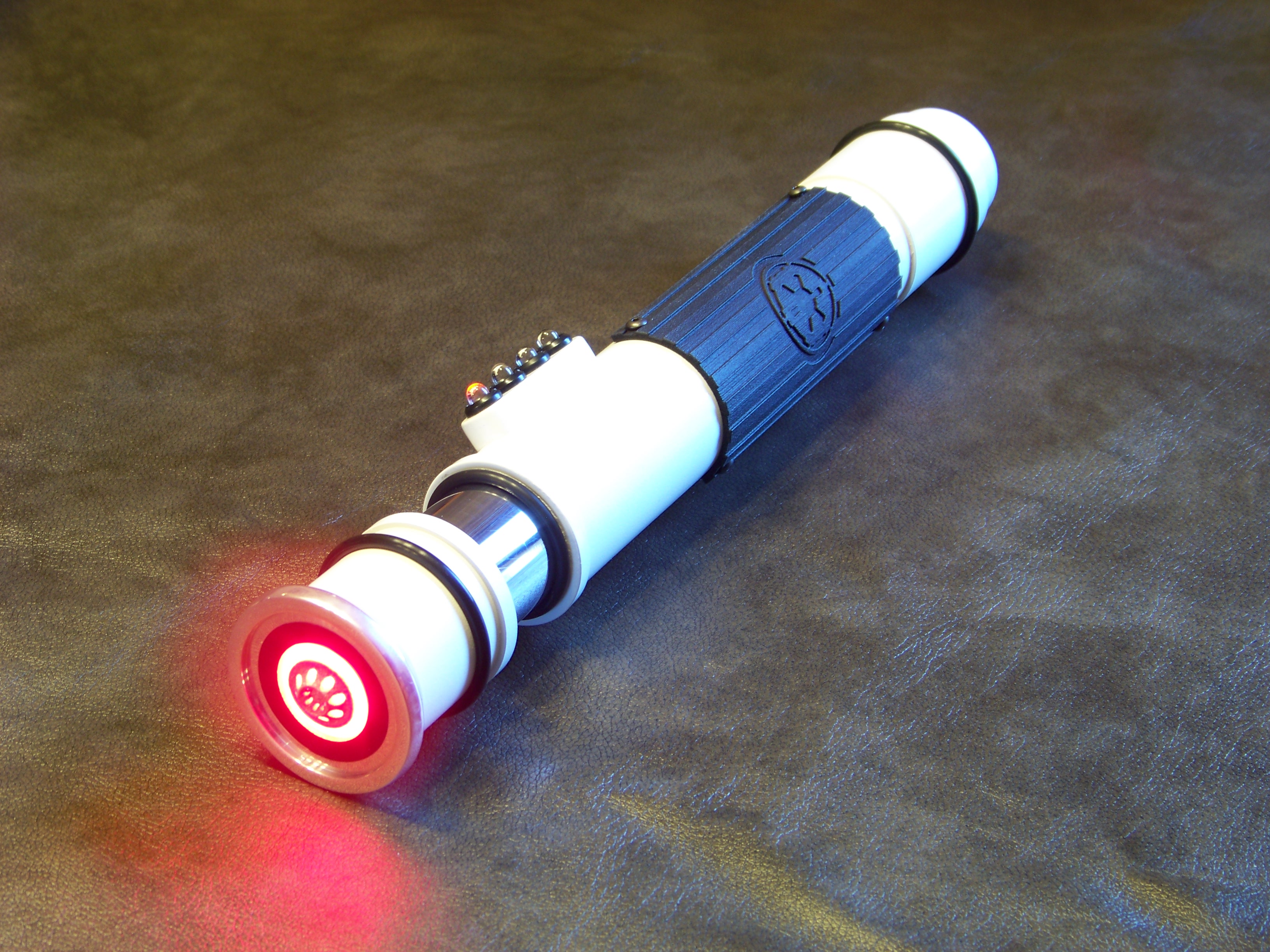

Edit: 06/14/2018I've added a picture of the completed Lightsaber here. Go to this post to see the more pictures and videos.

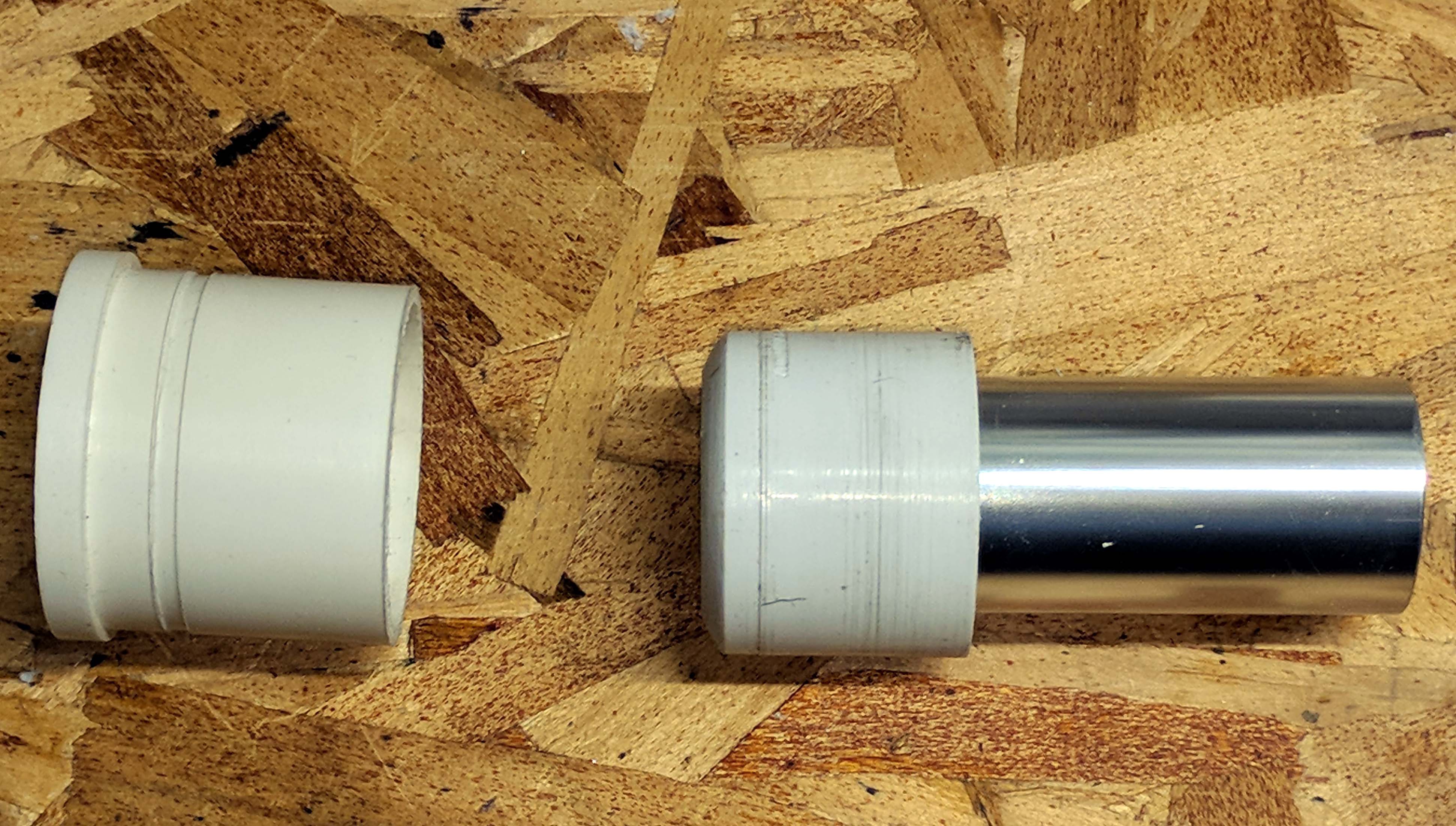

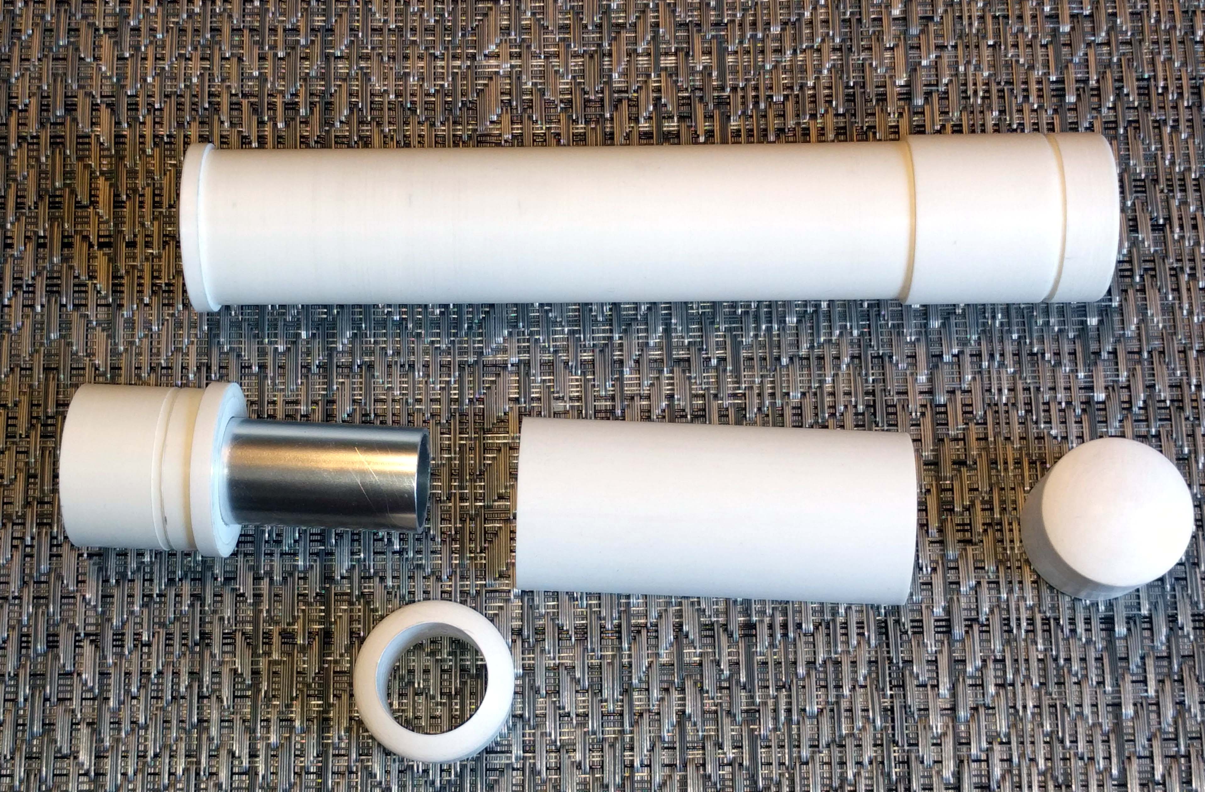

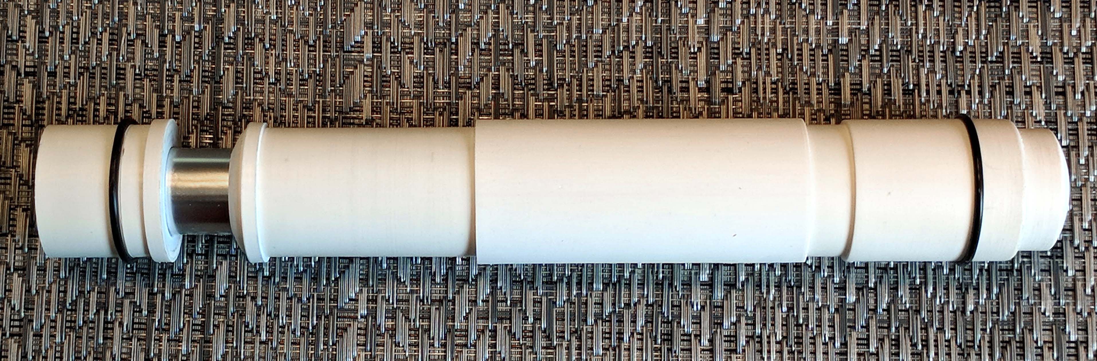

Progress so far.

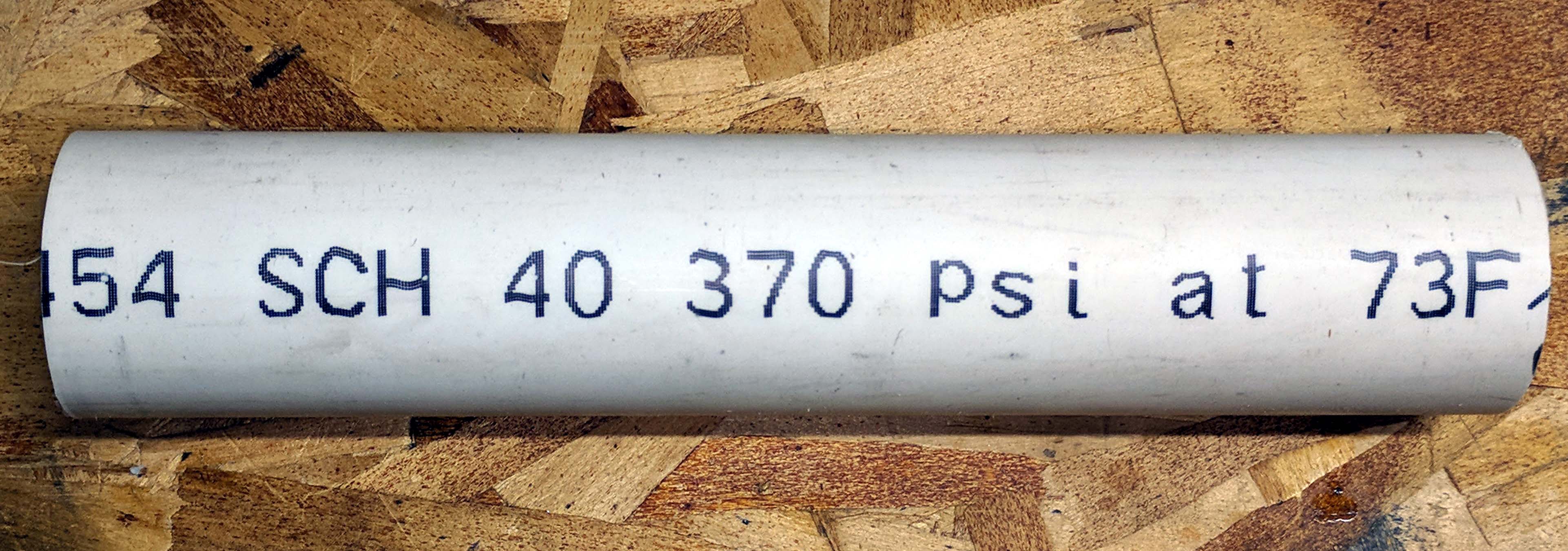

I went into this thinking that PVC, being white, was a natural, but once cut it gets dirty very quickly and not every piece is the same shade of white, so I'll be painting it.
End caps. Made from 3/4" PVC caps.
Emitter. I think I'll re-make this as I'm not satisfied with it.

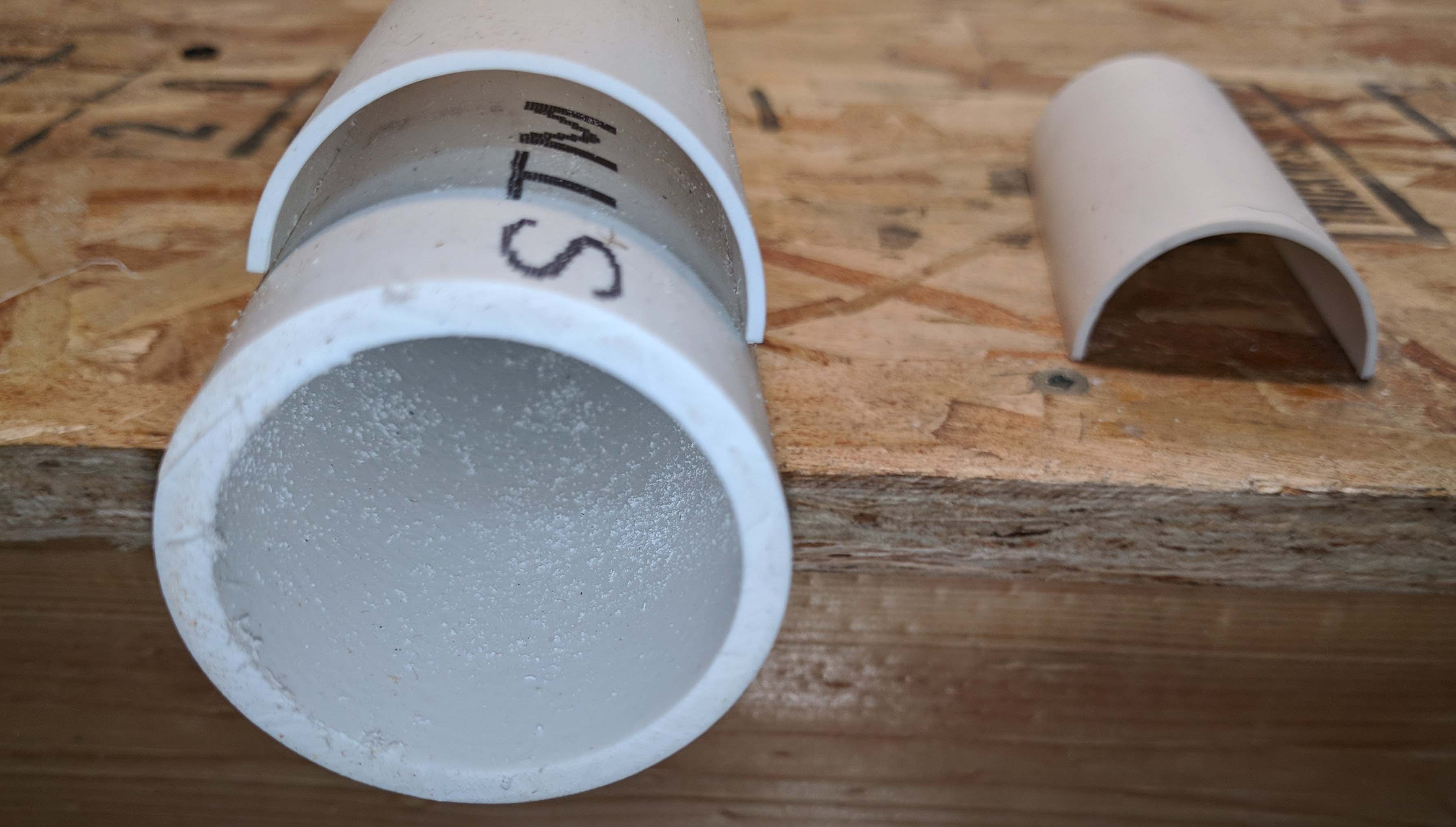

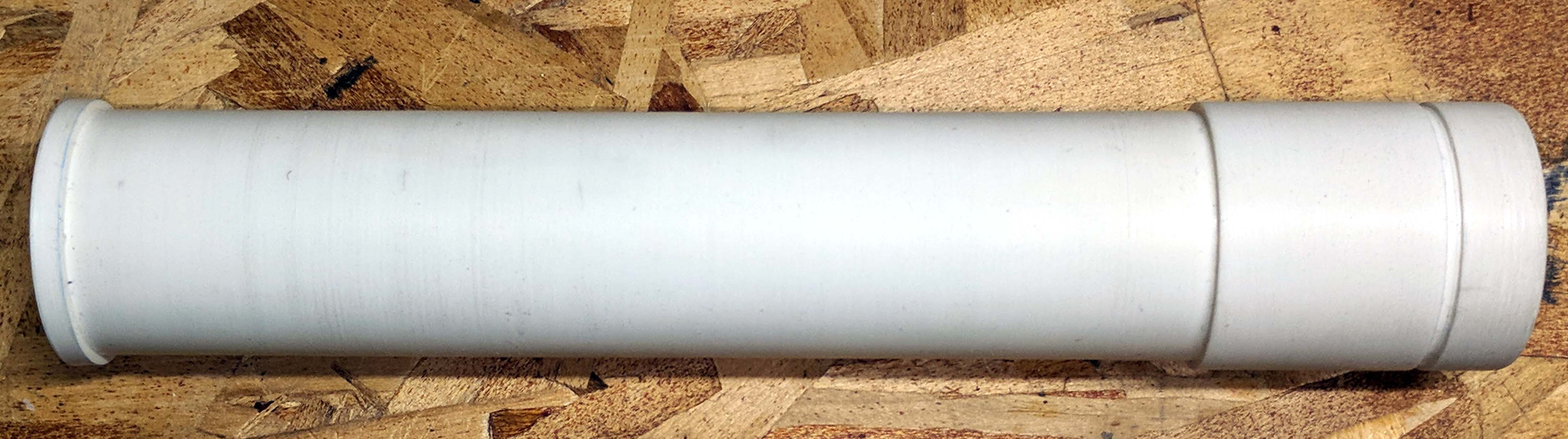

Main body.

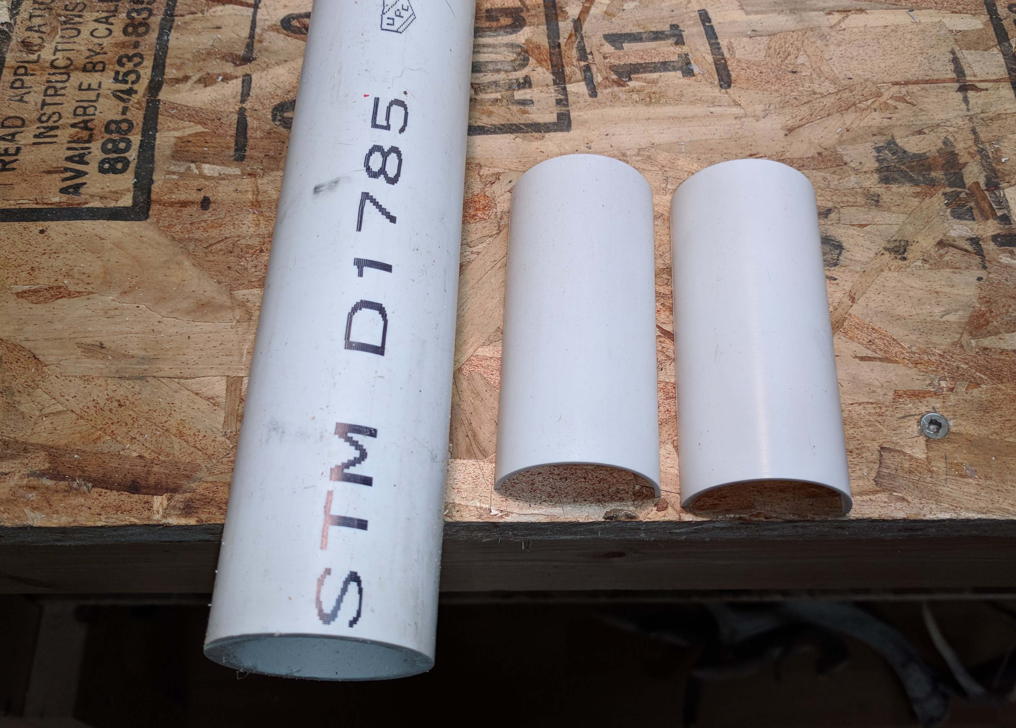

Grips machined down from 1 1/2" PVC pipe.
I like it! What are you thinking to use for the black grip section?
I'm planning on painting the cover with textured rubber truck bed liner. I'm going to do a pattern on the PVC cover before I paint it.
