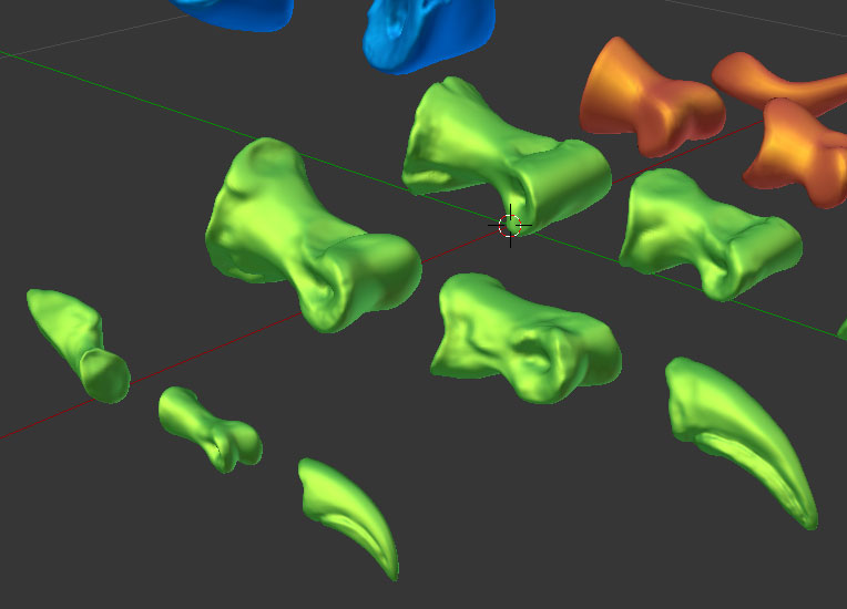

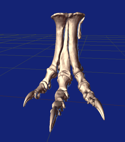

Blasting through the five digits, starting at the middle (digit III).
Innermost digits I and II sculpted and detailed, that just leaves the IV and V to finish. Digit IV has five bones, the most of all the toes. Digit V is just a vestigial splint in the form of a single bone, it's barely there.

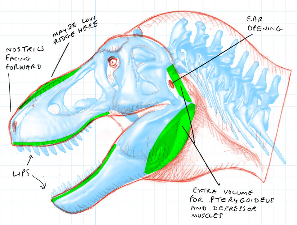

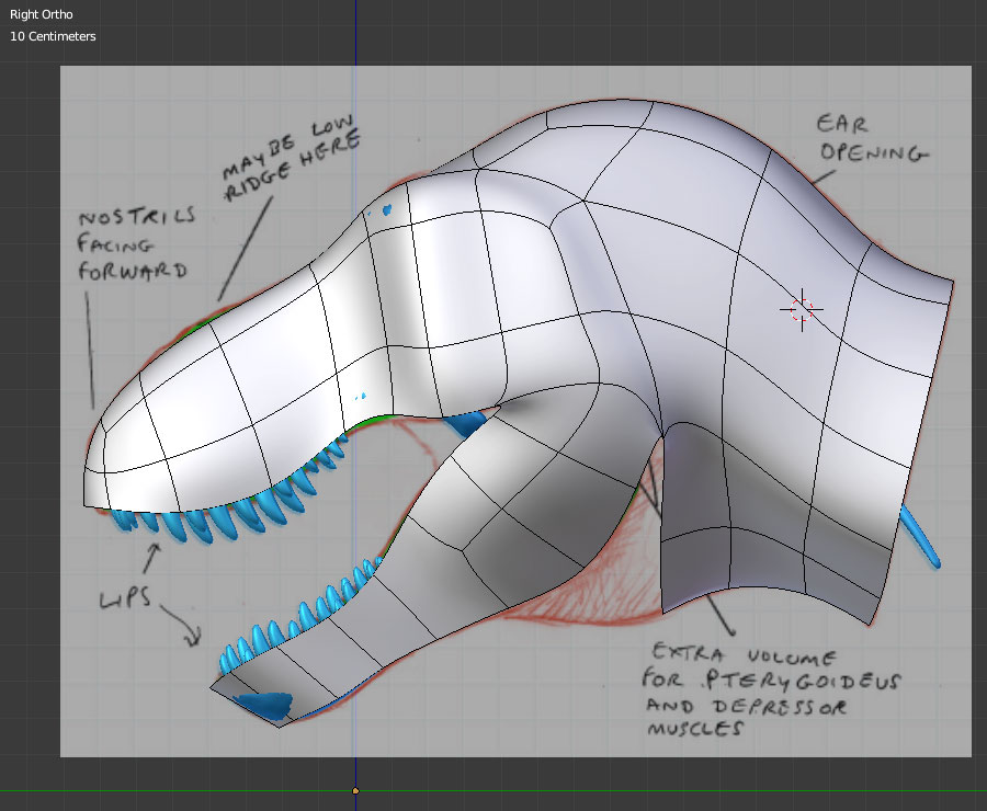

For the life bust I'll model a base mesh around the skull and neck which can then be sculpted and detailed for the final appearance. The intention is that this will be a life restoration that the bones fit into. I've made a little drawing over a screen-grab so I can 'think out' the life model.
I'm aiming for a close fit initially so I can increase volume at the sculpting stage. Having the underlying bones will also be good for getting elements in the correct position, for example the eyes can fit snugly in the orbits and the ear opening should be placed between the quadratojugal bone and the depressor mandibulae.
I'll build in a little extra volume in places so I've got some sculpting 'meat' for the lips and the jaw muscles. (shown in green).
Really looking forward to seeing that. Your work on the bones has been awesome to follow, so seeing you put meat on the bones and all the thought you put into it makes this really exciting.
Thanks, this part is a bit of a bit of a leap in the dark for me. Making accurate bones is just a case of copying nature, the life bust will be a lot more exploratory and intuitive from a sculpting point of view. Nice change of pace for me though.

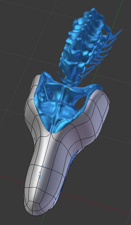

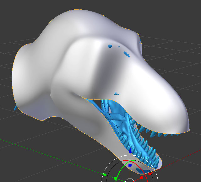

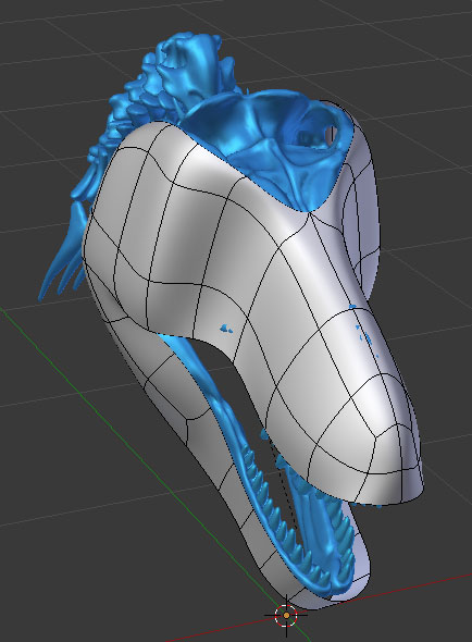

Made a start by modelling a base mesh directly over the bones. I'm aiming for clean(ish) structure with quad-poly grids in the 'hero' areas. Because this part is more exploratory and intuitive than the bone work, it's more important that the subdivided polys are as square as possible to minimise stretching. They're a bit rectangular at the moment but I'll add loops to improve this once the basic shape has been roughed out.
I think there will have to be a couple of areas where I'll break my own rules to add details, probably for the eyes, lips and maybe nostrils and under the jaw. This will be to make 'helper' form for these areas. Think I'll make the eye it's own mesh too.
Haven't spent enough time on this lately, too many distractions like life getting in the way. Might have a concentrated session over weekend.

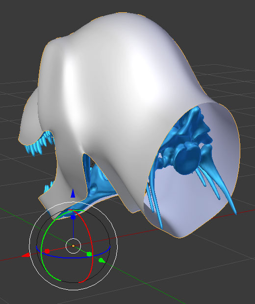

Got the neck and top of head blocked out. Many of the base polys still too rectangular for my liking, it's tempting to go in and fiddle with this now this but it would be a mistake to do this before I fully know where I am with the shape.

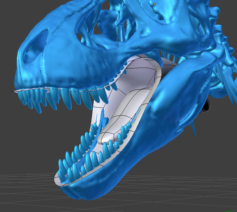

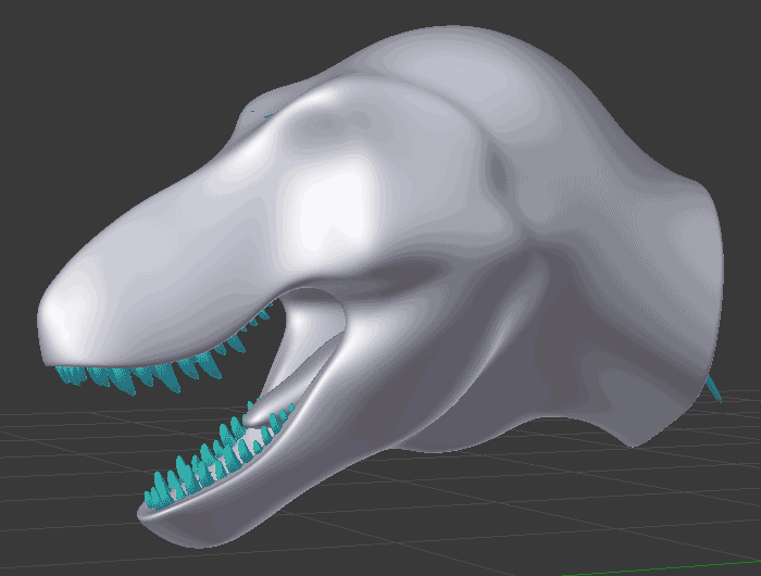

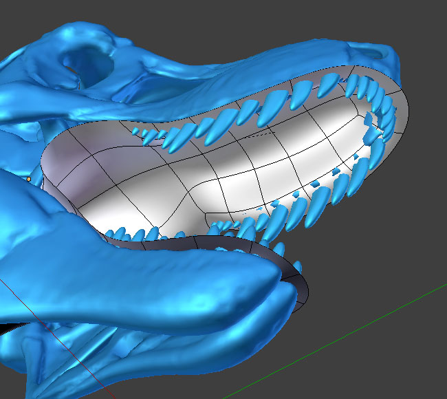

been neglecting the old tyrant again 'cause I've been pasting my new logo across my web presence, also started messing around with an Artstation portfolio. Anyway, made some progress poly patching and shaping the mouth interior. Latest theories are that dino tongues were crocodile-like so I'm going to keep rexy's tongue low in the mouth.
The transverse poly edges are positioned so they will ultimately be stitched with the exterior mouth polygons.
Still need to add some 'helper' definition for the lips somehow (yes, lipped version first), an extra loop should be enough.

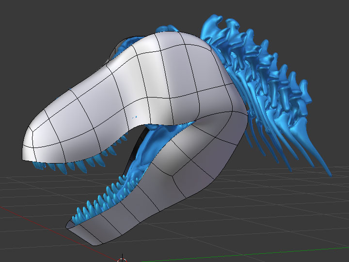

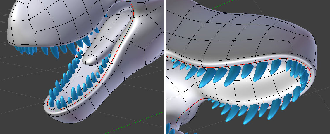

The life model base mesh is now a single piece. As planned I've cut an extra loop around the rim of the mouth (the red lines). When subdivided to high-poly this will give me enough definition to sculpt the pocket where lip meets gum, it makes the poly strips either side of the loop quite rectangular but I think that should be OK for this area.
Squaring up the elongate patches on the face and neck was fairly simple, a loop added here and there followed by some vertex editing to reclaim the form. Not perfect by any means but good enough to sculpt without creating stretched details.

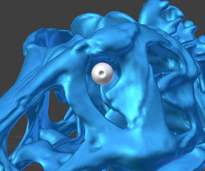

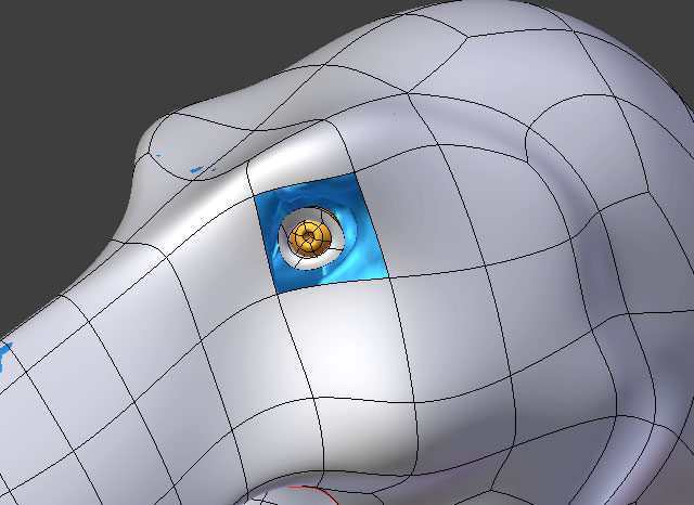

The patch encompassing the eye area has been positioned to bridge with the eyelid work I've been setting up. I'm finalising that now and should be able to post an update later today.
The eye section blended in without issue but I later decided to add an edge to allow form-fitting the mesh around the postorbital boss a little more snugly.

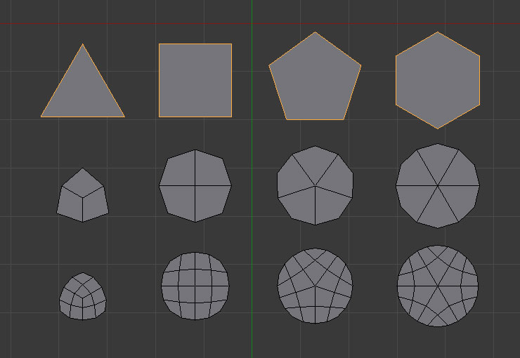

I really admire your work. What I wonder: why do you work with polygons with more than 4 edges? I always thought one should use no more than 4.
Ngons (>4 sided polygons) used to be more problematic but these days most poly modelling software supports them. Arguably some situations are better handled by quads (4 sided polys), especially structures which need to deform smoothly when animated. Some modellers still prefer all quad topology for everything and get great results.
It's true that triangles and ngons can cause artefacts or 'pinching' when subdivided but often this effect can be exploited to form details with fewer underlying polygons. The big animation studios are known for sometimes using non-quads in deforming animated models.
As I'm making static models for 3D print, animation and deformation are not an issue anyway. I'm using whatever topology will represent the shape best. Also with subdivision surface modelling, ngons and triangles in the base mesh will always be split into quads downstream in the subdivided model.
Apart from specific cases like animation, topology style is mainly down to personal preference. I don't think there's a right or wrong way to poly model. Do what works for you.
Hope this answers your question.
