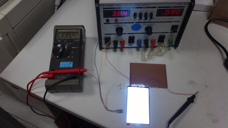

I'm modifying a replacement iPhone screen backlight panel for mine:
attachment.php
Full post here: https://www.therpf.com/showthread.php?t=276755&page=25&p=4387679&viewfull=1#post4387679
That is lit using 4 surface mount LEDs in series (removed from the backlight strip and mounted on a prototyping board), which are powered from a tiny 3V to 12V boost converter. I've got a super-slim 3V Lithium-Manganese cell to power it and switched using a reed switch and magnet. I'm waiting for my wallet to arrive so I can see how big it needs to be and if I can squeeze it all in.

The backlight panels are just a sandwich of plastic sheets, so they can be cut down to the required size (or find a phone with the right screen size and get a replacement panel for it).
https://www.therpf.com/attachment.php?attachmentid=786663&d=1515707473
