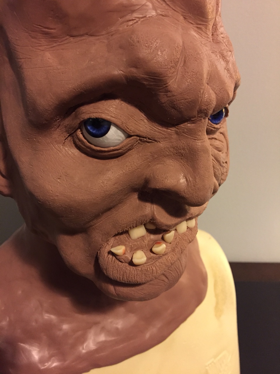

Hello, I'm new to making masks and doing molds and everything.
I'm a novice.
I have a sculpt (WIP) Of Jason Voorhees from Friday the 13th Part 4: The Final Chapter
This is the first sculpture I've ever done in my life.
I'm wanting to know what the best process would be to be able to take this mold and make a shell over it?
Or have a method of pouring silicone to create a mask out of my clay mold.
My concern comes when looking at all the dips and details in the piece.
What resin should I use? Will it damage or break my sculpture?
