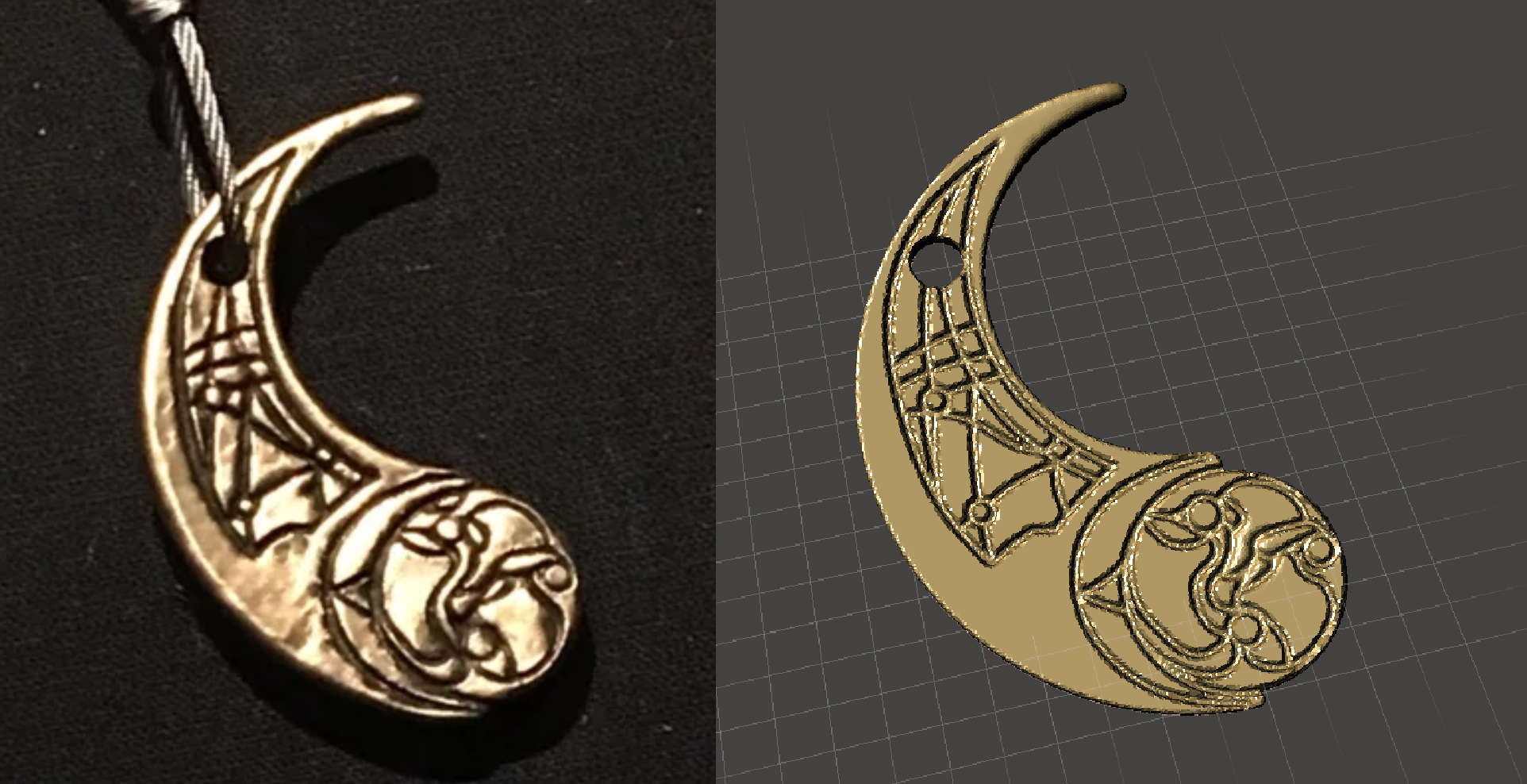

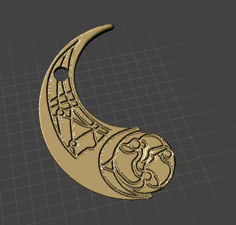

poking at the cad model for the necklace. Here's a little update. I restarted once I got the new pics. The new photos help a lot. I'm almost done the back side. Here's most of the front. Work in progress:

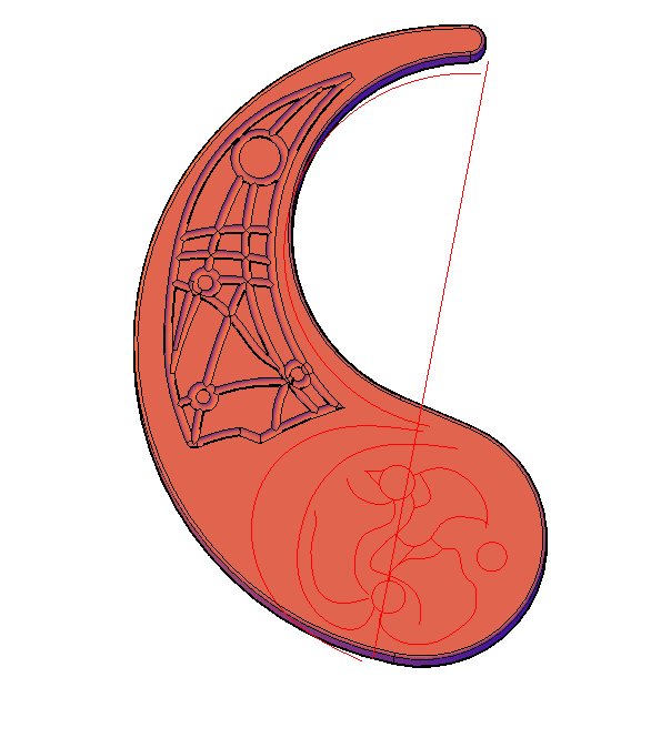

Updated Rose's necklace sketch:

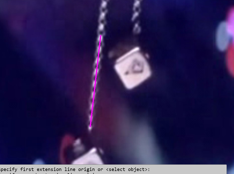

For the dice, I've been going on the assumption of 19mm, which is the larger one of the two common sizes (16mmv19mm cubes) for numerous reasons. In Kylo's hand, and Leia's hand it appears to be larger size, plus I think they'd use the larger of the two sizes to show detail better on screen. Plus from having these and holding them, 16mm feels too small and 19mm feels right.
Based on 19mm, I scaled this image so the dice were 19mm from edge to edge in AutoCAD, and then measured the chain length. That magenta line in the image goes across 16 loops and measures 62.5mm long. I divided 62.5/16 and got an average loop length of 3.9mm. I've found 3.9mm rolo chain. I was about to grab some but then I realized my measuring mistake... I hadn't accounted for the overlap of each link, meaning each link is actually larger than I had measured. The next step up is 4.5mm chain, so I might be going with that. It's pretty fuzzy when you zoom in this much so it's hard to say. I'll likely revisit this again before ordering chain to double check. When scaling the image to set it to the right size based on the size of the dice, you get into some fuzzy measurements when you're trying to pick which pixel is the edge of the die to set that 19mm length. So for now, I'm going to wait a few days before placing a chain order, and will measure a few times again in the mean time.
I've rescaled a couple of times and remeasured and I'm getting around 4.0-4.2mm for the length of measuring each chain link individually, so maybe 3.9 is still right, maybe I'll find a 4.0mm bulk to order. We'll see.
Yea, after a few more measures I'm convinced it's the 3.9 size, so I'm going with that.

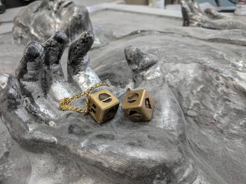

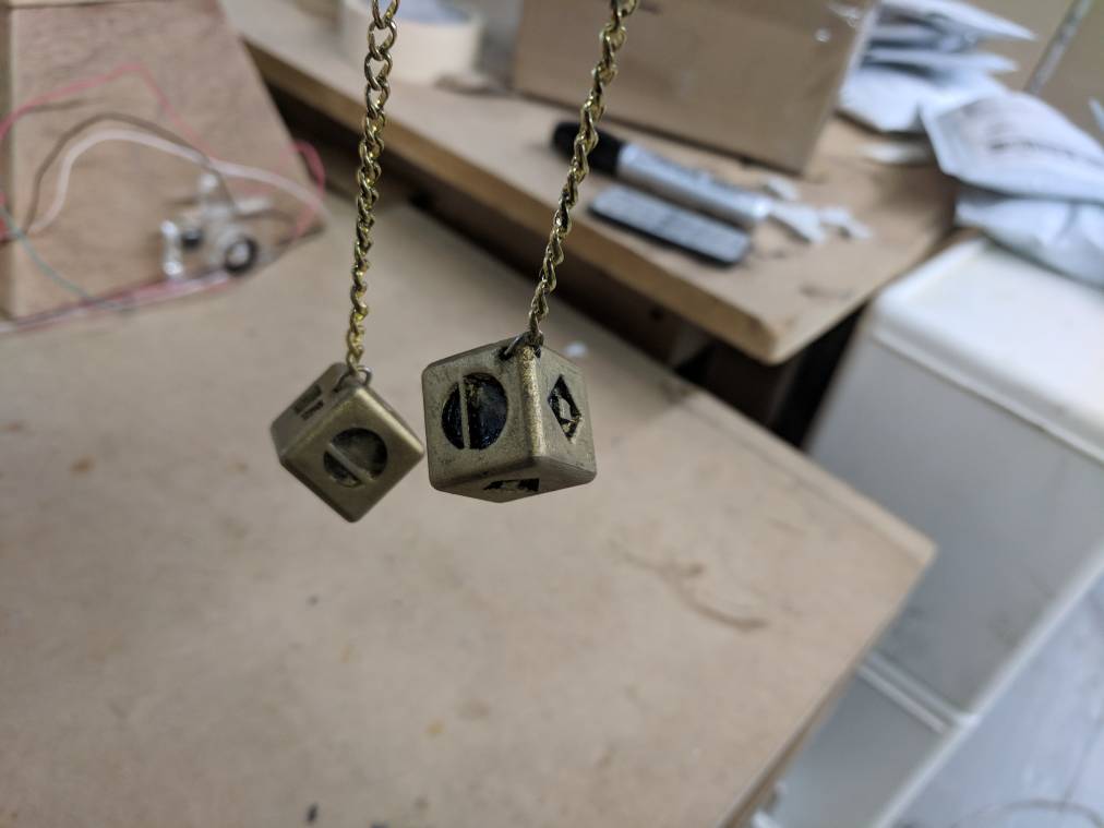

Exciting update on the dice! Here's the raw cast brass master.
This is an intermediate step.
It'll be used to make the silicone wax injection molds for the next step. Those waxes will then be put in investment for lost wax casting to make the steel version, which will be gold plated.
