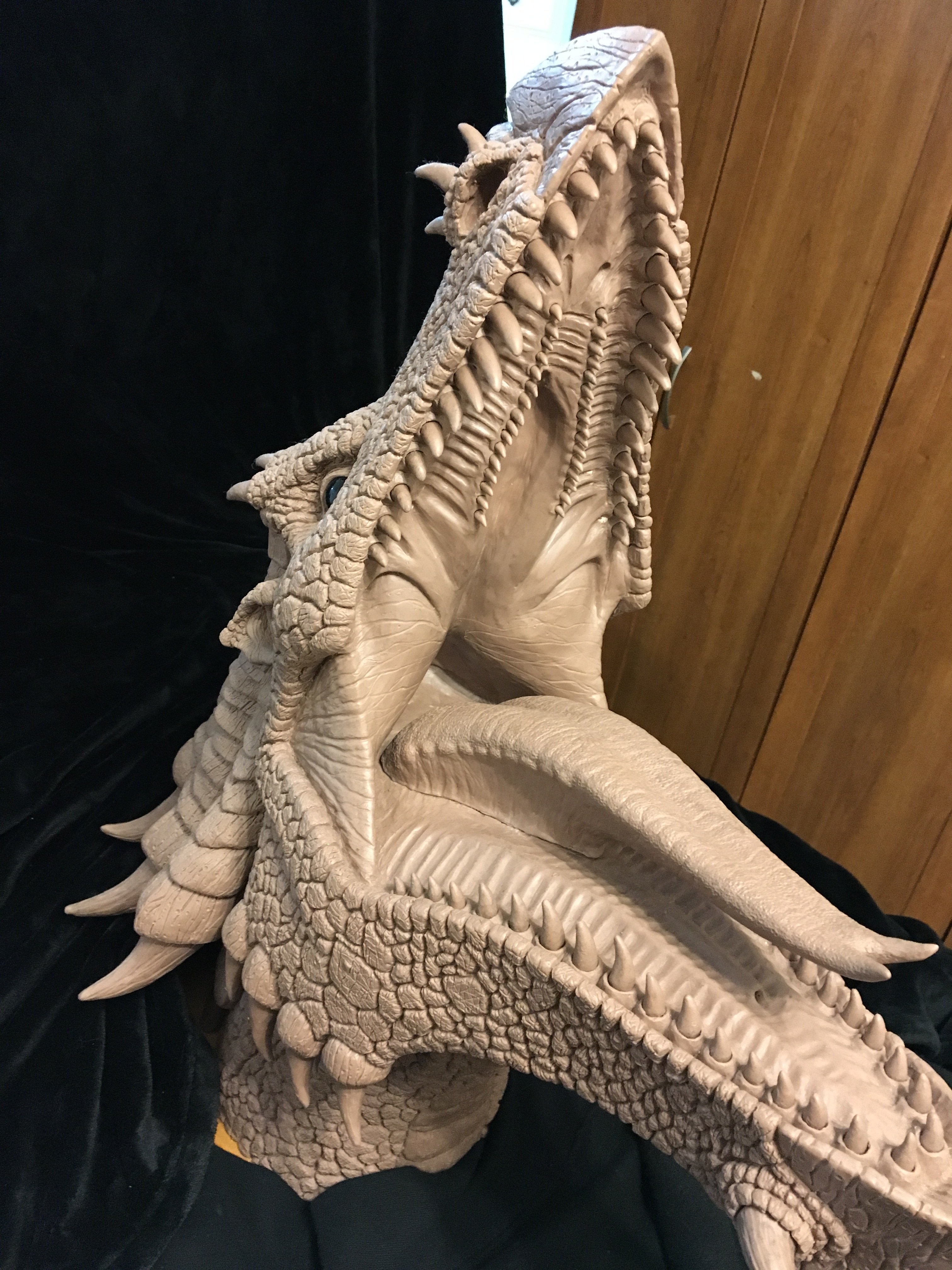

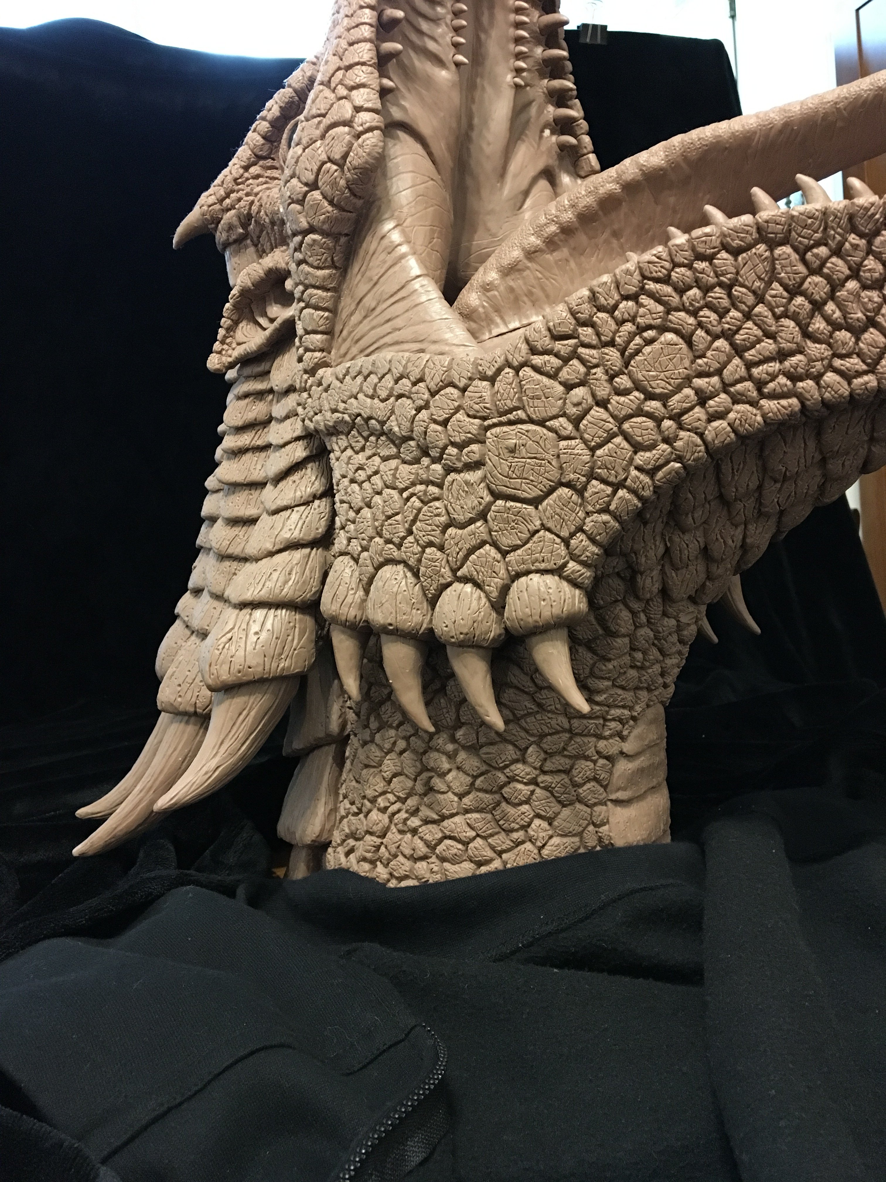

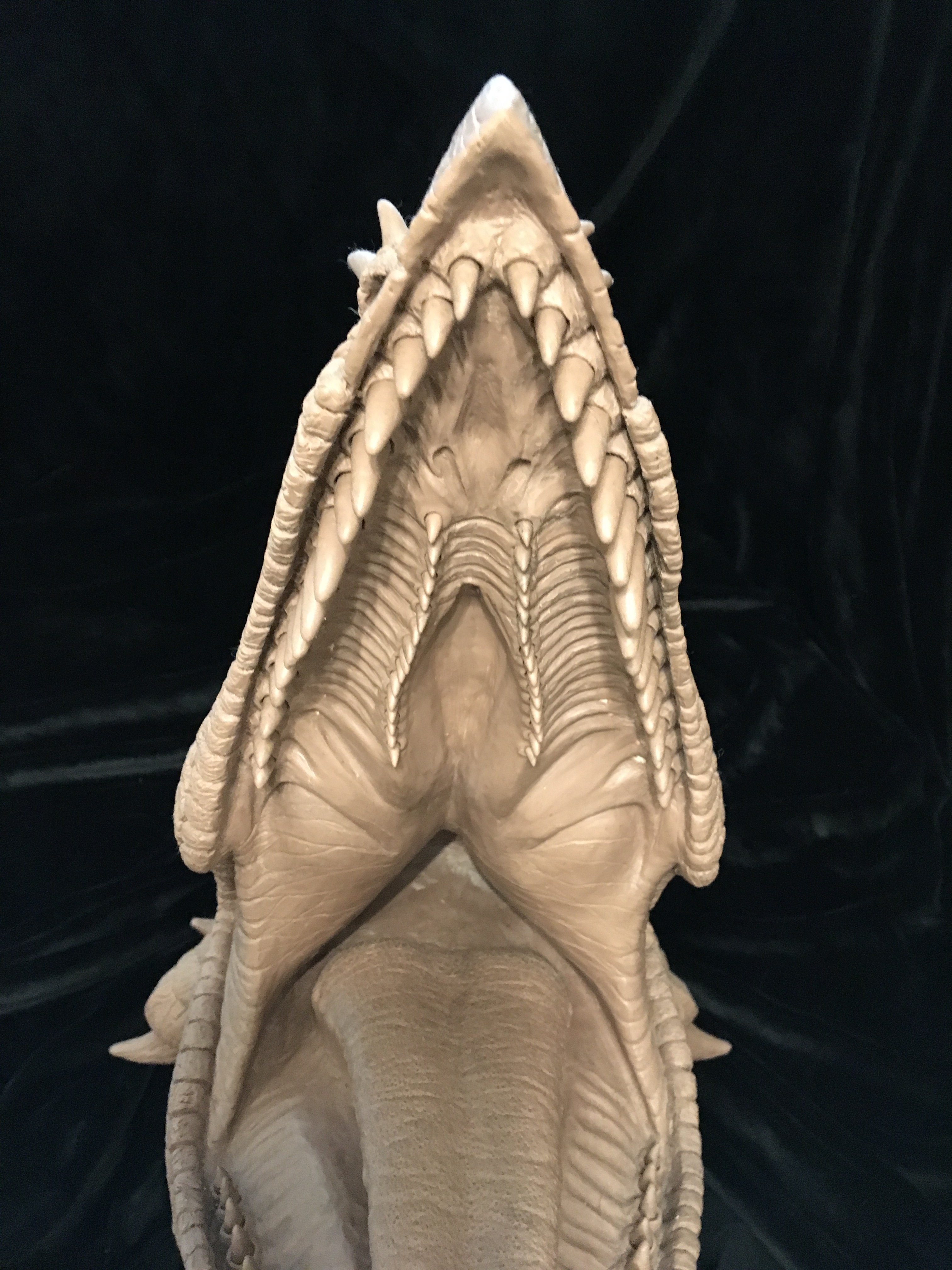

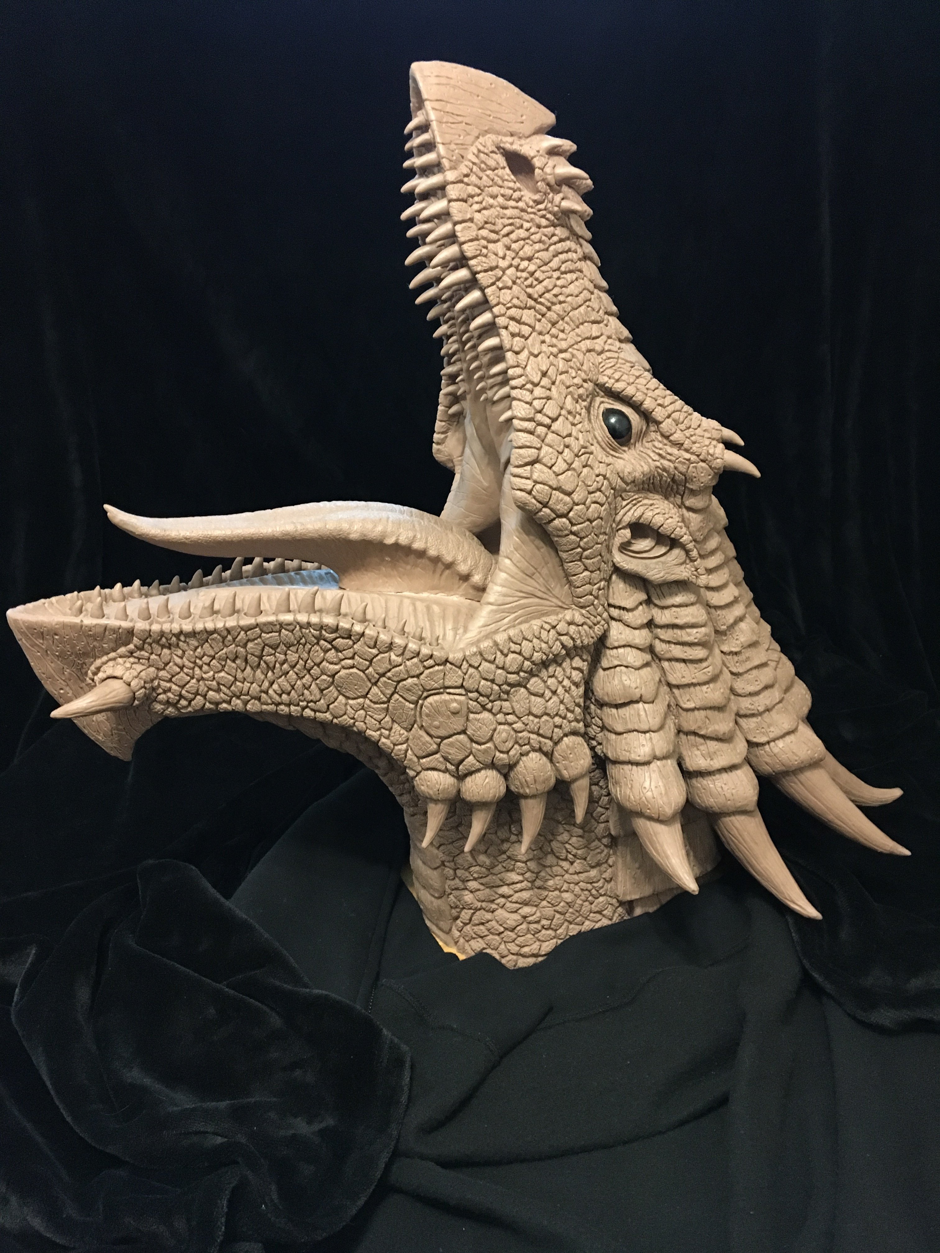

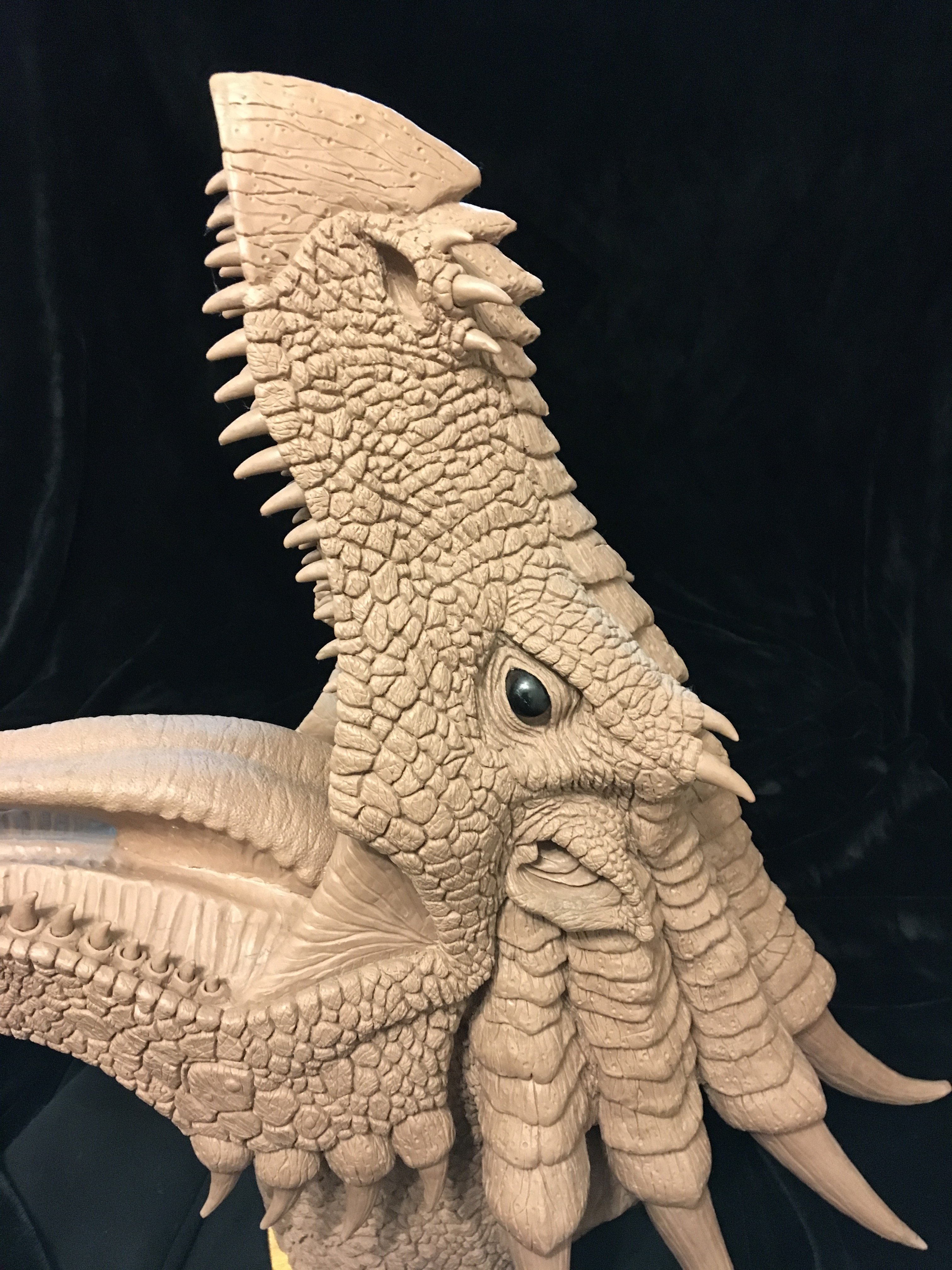

Howdy folks of RPF, I’m new here and saying hello from Canada!. Just figured I’d share some pictures of a dragon head sculpture I did. In the process of making epoxy molds and hope to have some realistic looking finished copies with dragon skin silicone skin and smooth cast 300 plastic horns all airbrushed etc. Hope you guys like it and will update progress of mold making soon. Look forward to make many friends on here and seeing what this forum has to offer. Stoked!.

Thanks buddy!. Yeah we have given thought to making a full body but that would be quite the undertaking as the head is about 2 feet tall. The goal is initially to be like a taxidermy mount like it is a hunting trophy.

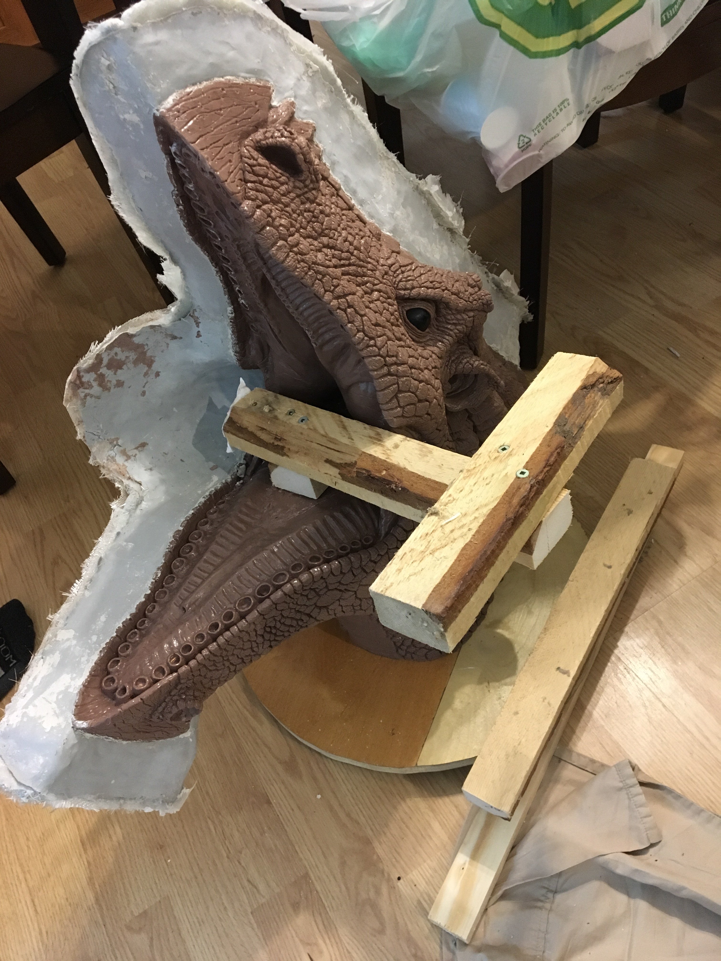

Thanks soo much!, yes we have already started making the epoxy mold and hope to be done within the next week or 2. Just waiting on an order of free form air epoxy. We used Frank Ippolito's Zoidberg project as inspiration for the mold process.

Thank you!. I am just about done making the mold. It's going to be a 5 piece epoxy and fiberglass with resin mold and I have 3 of 5 pieces complete. Will post pics of progress soon!. I eventually want to make the full body but considering the head is 2 feet tall that would be a massive undertaking for sure. We'll see. For now I am going to make the head so it can be mounted on a wall to look like a hunting trophy. May make a cool shield it can mount to and possibly add a sword, not sure yet. Thanks for looking :)

Thanks soo much bud!. I may eventually make a body but the head is 2 feet tall so that would definitely be a huge undertaking. Eventually it may happen. I am almost done the epoxy mold though so should be able to start pounding out copies soon and start painting. I want to do some with a surface layer Smooth-on Dragon skin silicone (ironicly it's named that ha ha) and the some 2 part expanding rigid foam to fill the rest of the mold, then I will airbrush it to look real. I have separate molds made with silicone (Moldstar slow) and the teeth will be made with smooth-on's Smooth-cast 300 plastic and painted as well. We plan to paint a few different themes like a fire dragon, water dragon, desert dragon etc. Should be fun!. Thanks for your interest buddy. :)

Sorry for the delayed response. I finally figured out you gotta click "quote" to reply to someone specifically lol. Never been on a forum before. To answer your questions, the head is a little over 2 feet tall and I am in Terrace BC Canada. Also I plan to make an epoxy mold (almost done), make copies with silicone skin and rigid foam core and plastic horns and teeth using smooth-cast 300 then paint them different themes and make them wall mountable to look like hunting trophies. Eventually I want to make a body as well if I can afford it.
