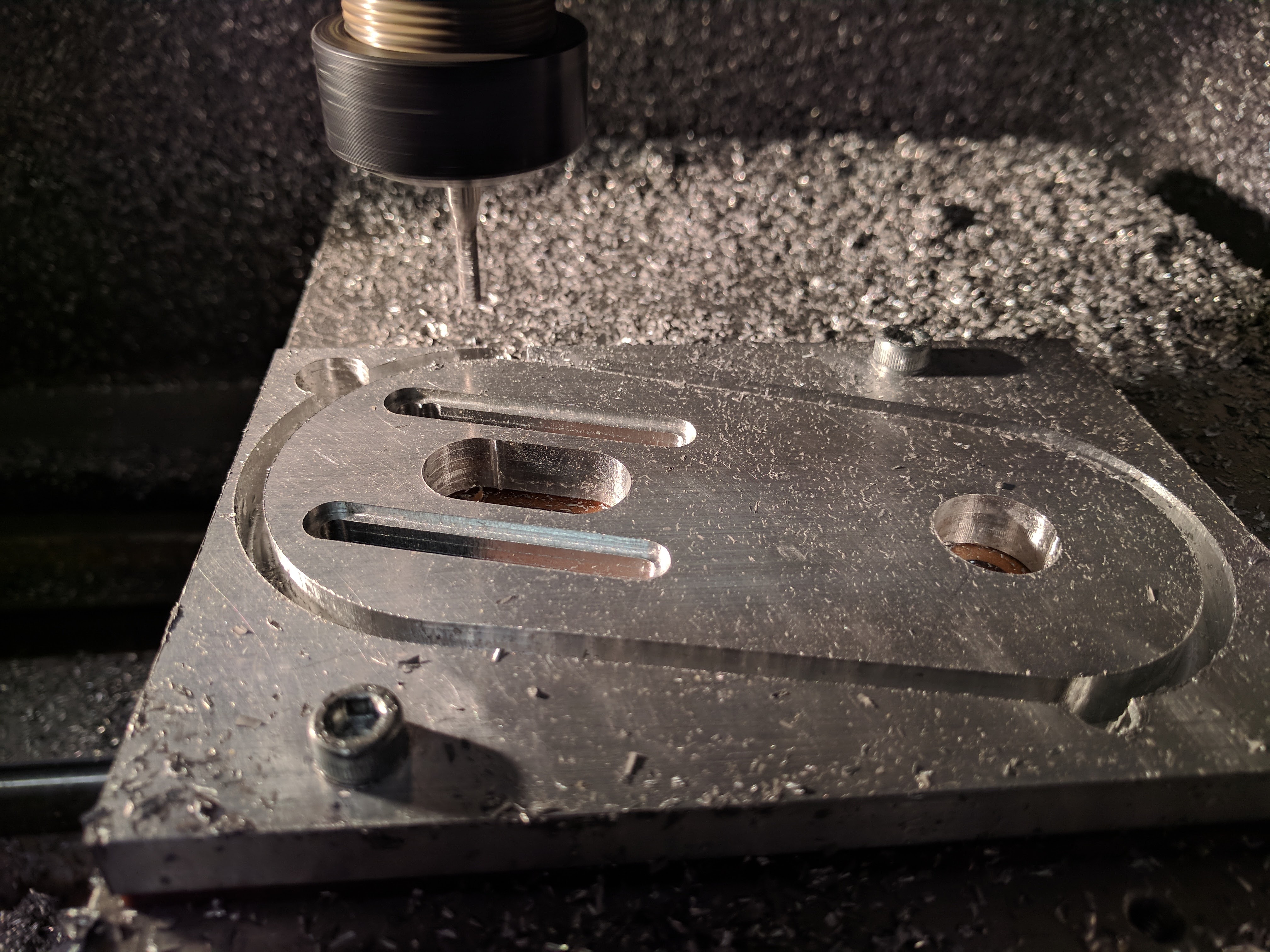

    Its about this time my mate hit me up and asked for a favor - he wants to build an electric skateboard and needed a motor mount making. So he gave me his measurements and i knocked it up for him
    Design process for anyone interested
    1. dodgy measurements on napkin
    2. draw design in Cad.
    3. 3d print to test fitment
    4. CNC out of Aluminium
    5. drink beer.
    Click image for larger version.
Name:	Skateboard mount v9.png

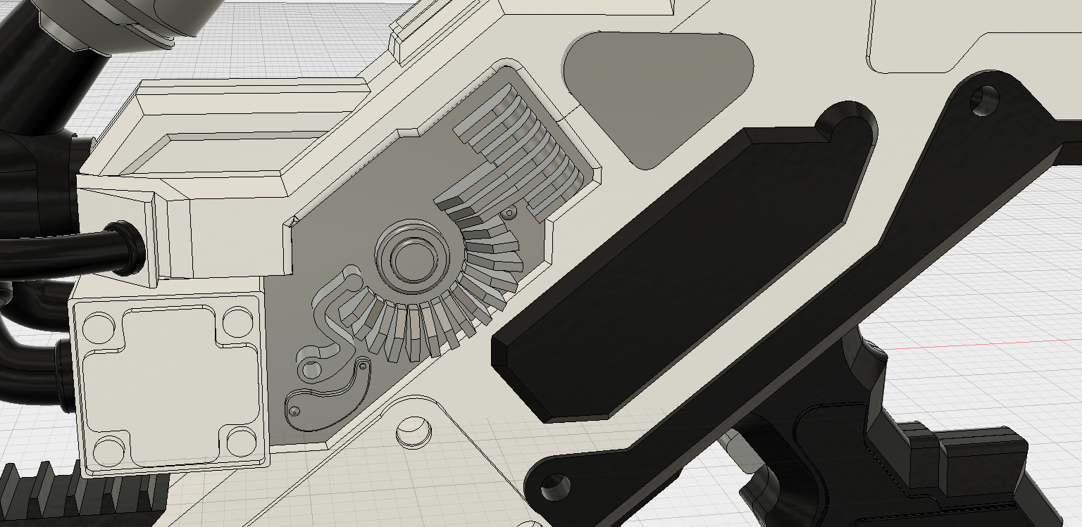

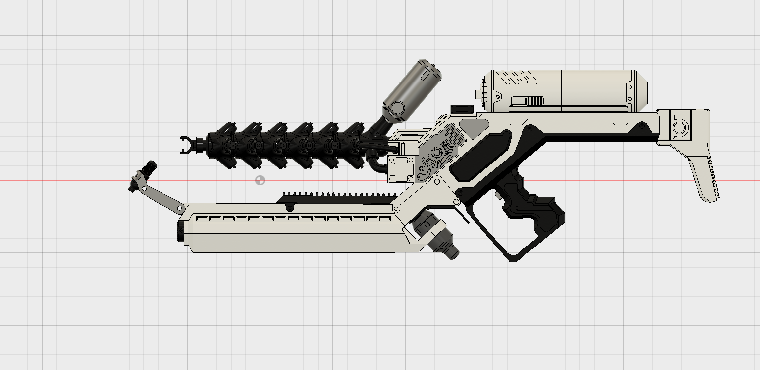

    Next up i had to draw those lovely organic shapes of the top barrel.... a few goes later and I am happy with the design

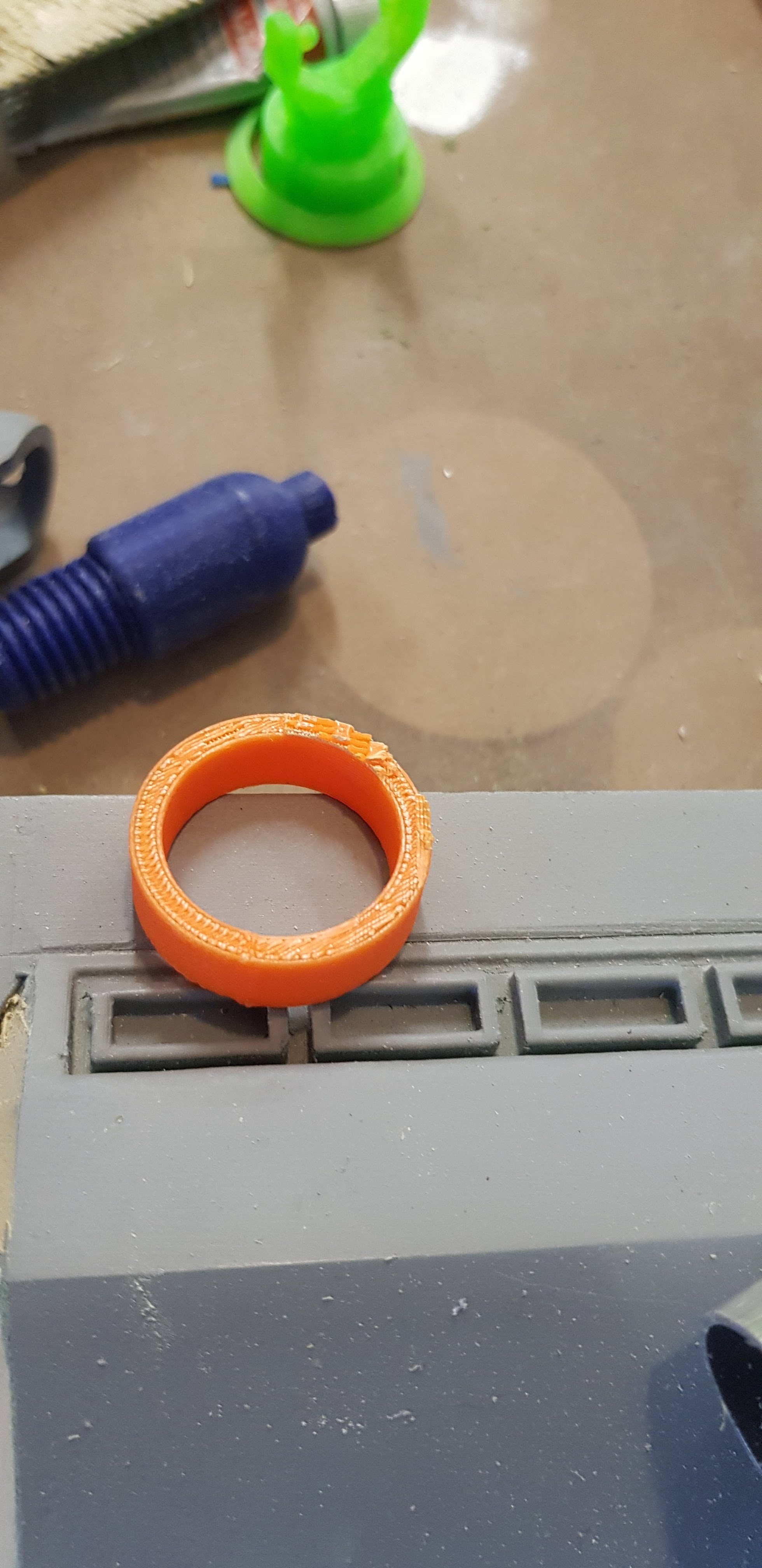

    been a while - project is not dead, just life has got in the way at the moment.
    I have started work on the top rail and when i drew it up in fusion, i didn't check the hardware store for tubing that was 30mm..... so i had to knock up some spacers to fit the 25.4 mm aluminium tube that was the closest fit :/

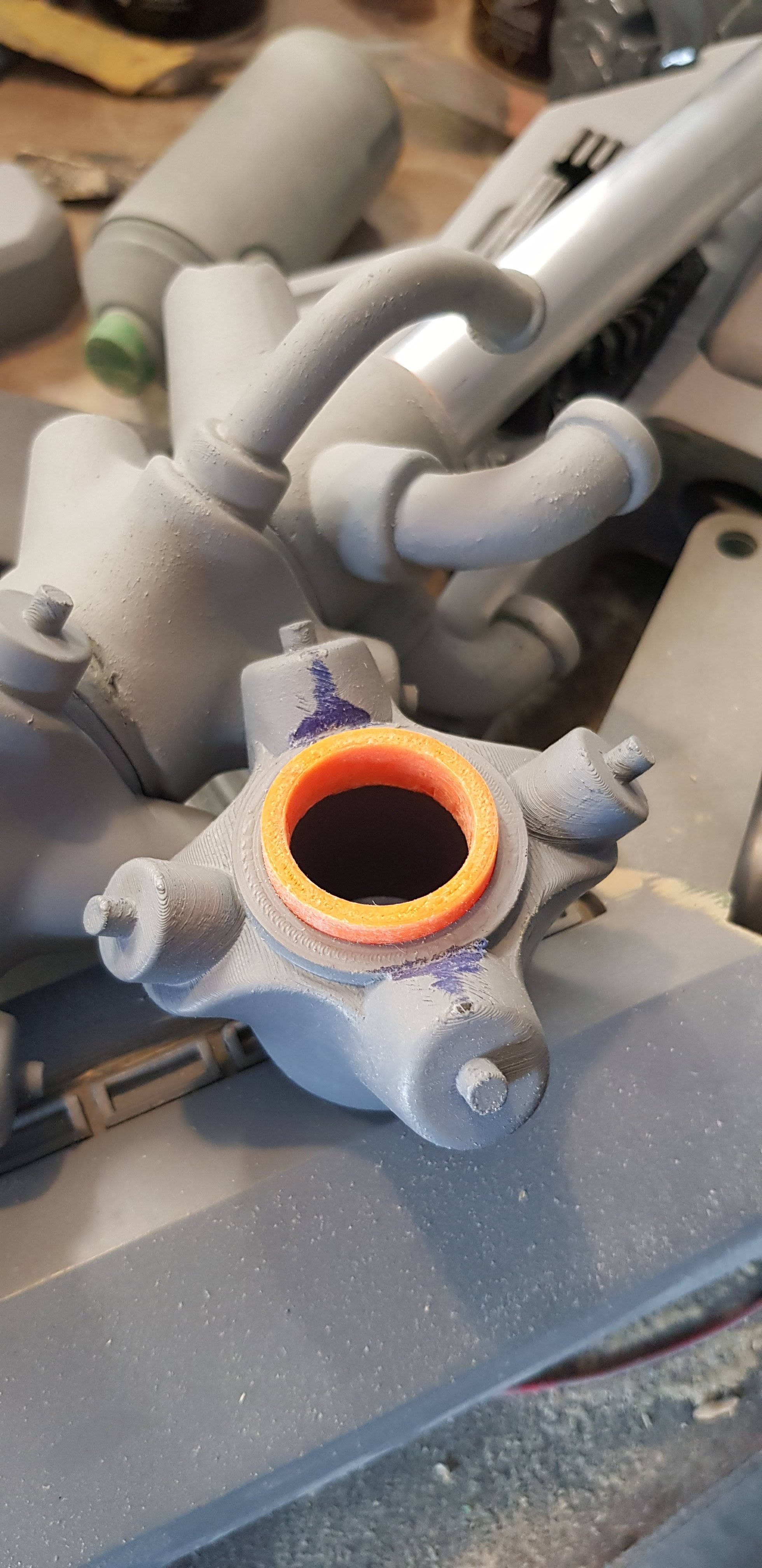

    Then in my rush i totally forgot to draw the hole for the tubing to go into .... so out with the soldering iron and epoxy
    A quick test fit and ready to glue it all together

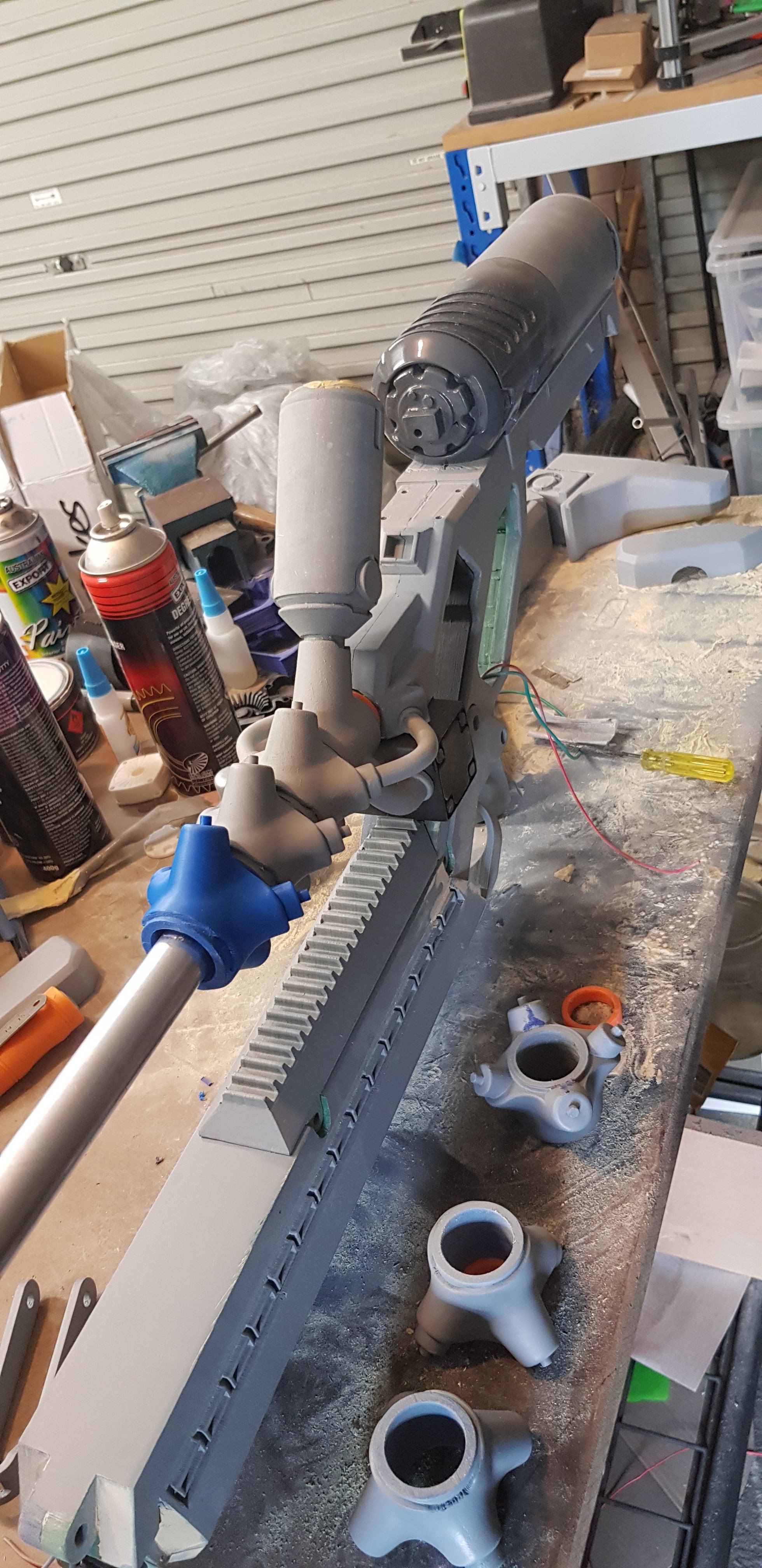

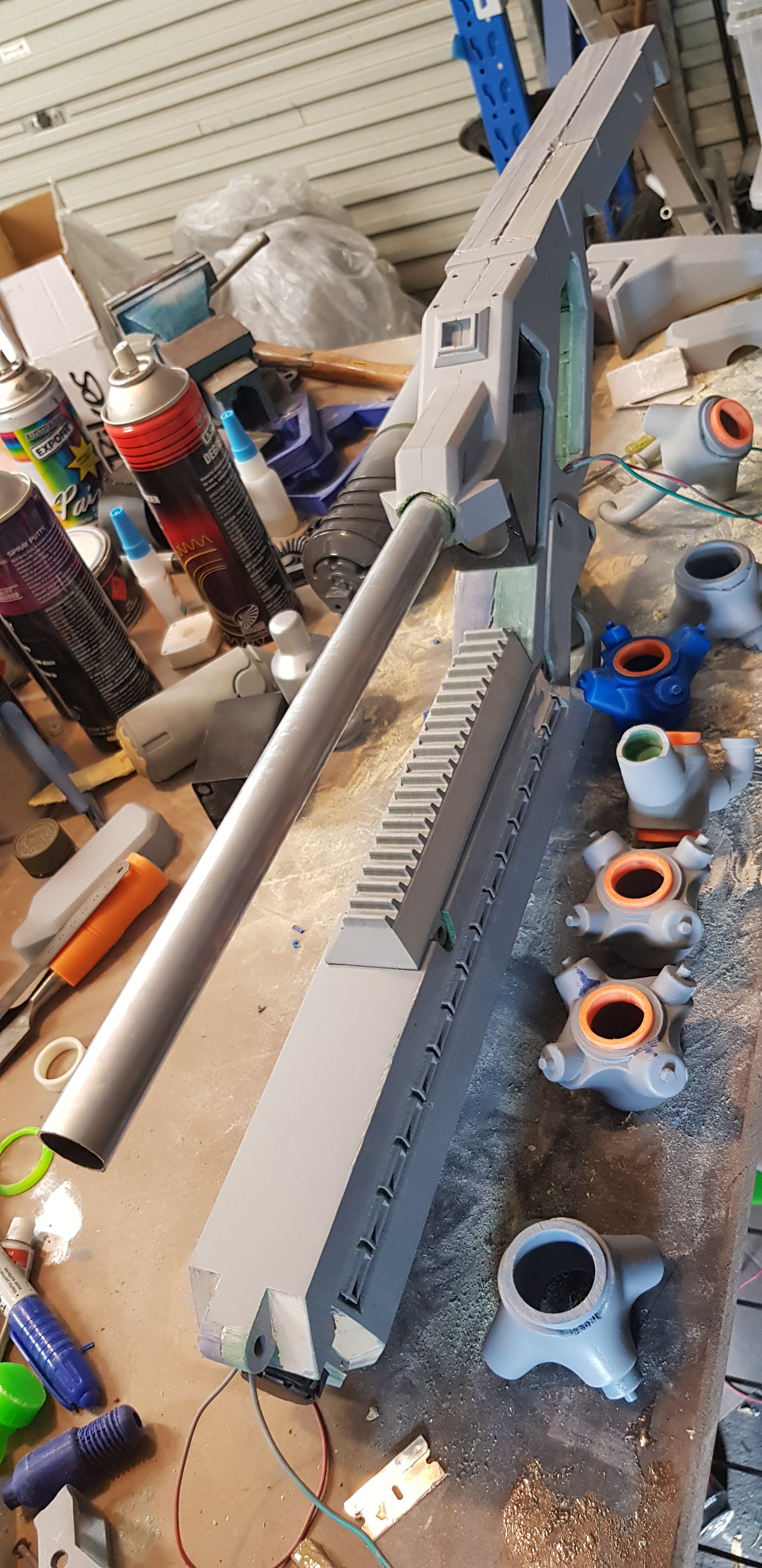

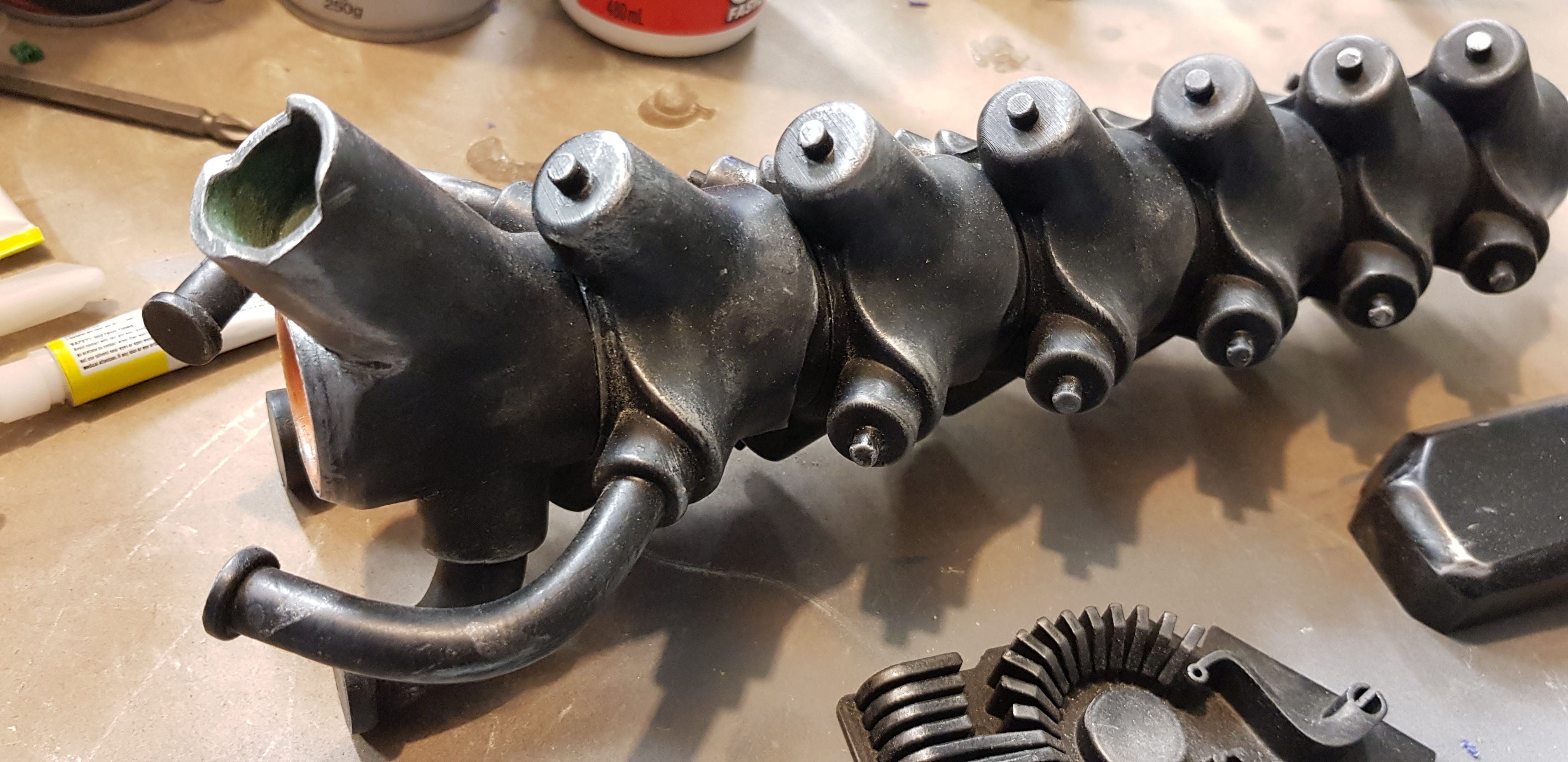

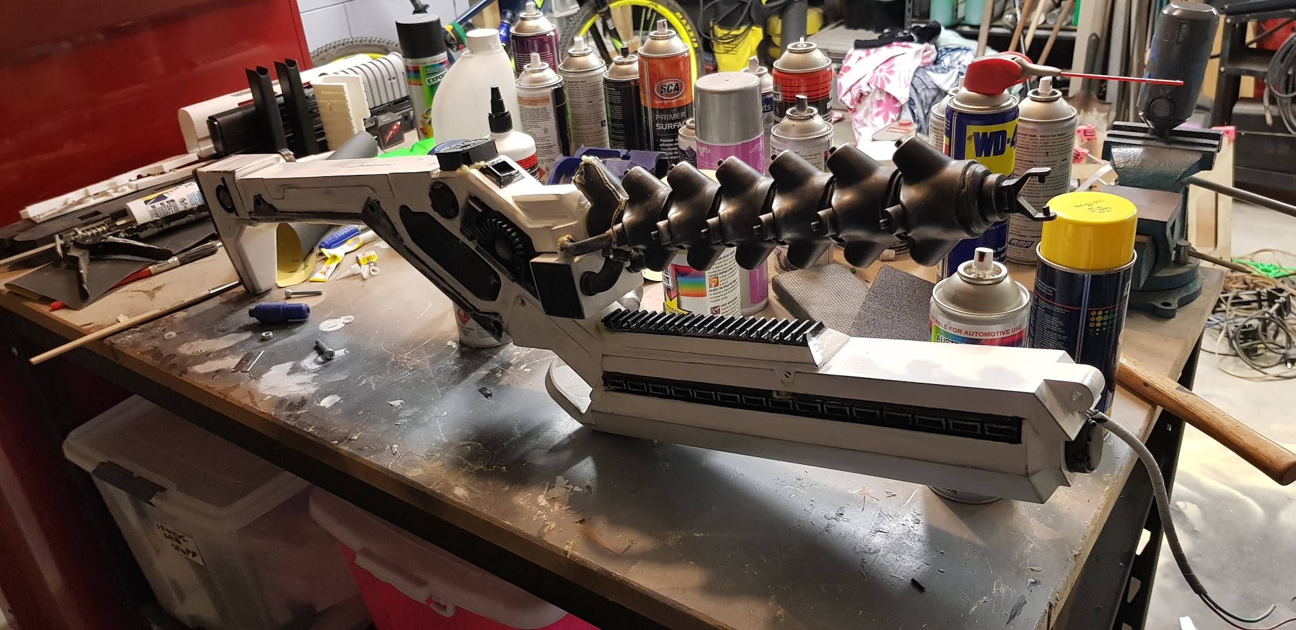

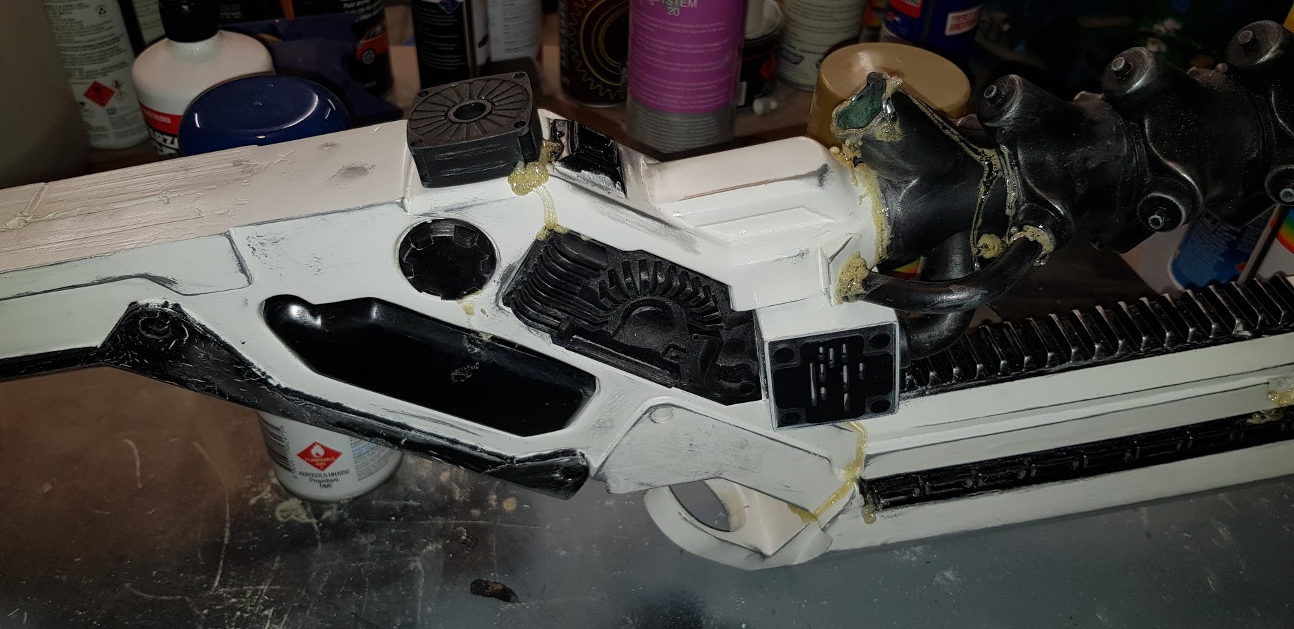

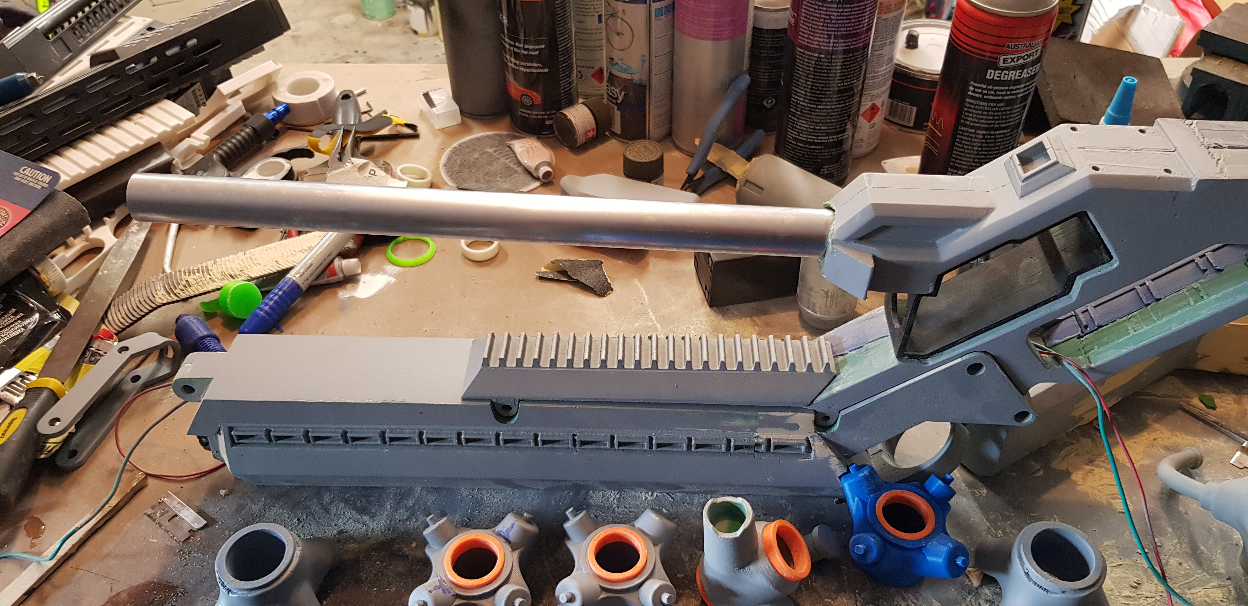

    Had a productive day today , finished the black bits and gave them a bit of weathering

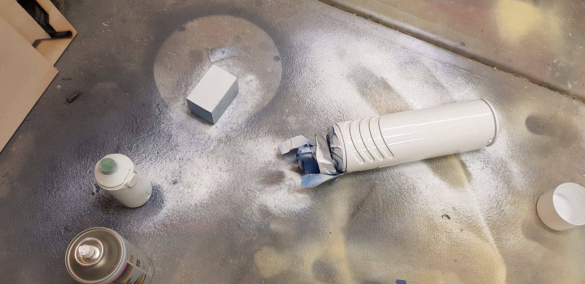

    Got a base coat of white on the gun and cylinders too
Name:	1fRgSWhCekixcWCqpiqInpoqO3GV_X21Z5qpGuSBN3OsUaPq9-sFPFmC3Bwvto2CynhEoXlouKy03CjF4ENrhOw5TgFb6xgT.jpg
Name:	76Y2oLoCSvq0Km6yRxsJrzXYbrd7Jhu0texoMrZe34Ut7AumFKY5OFriAAT-UwqImZyLZO5_sMtHo-1CODWIX8gwogrWZ7hC.jpg
