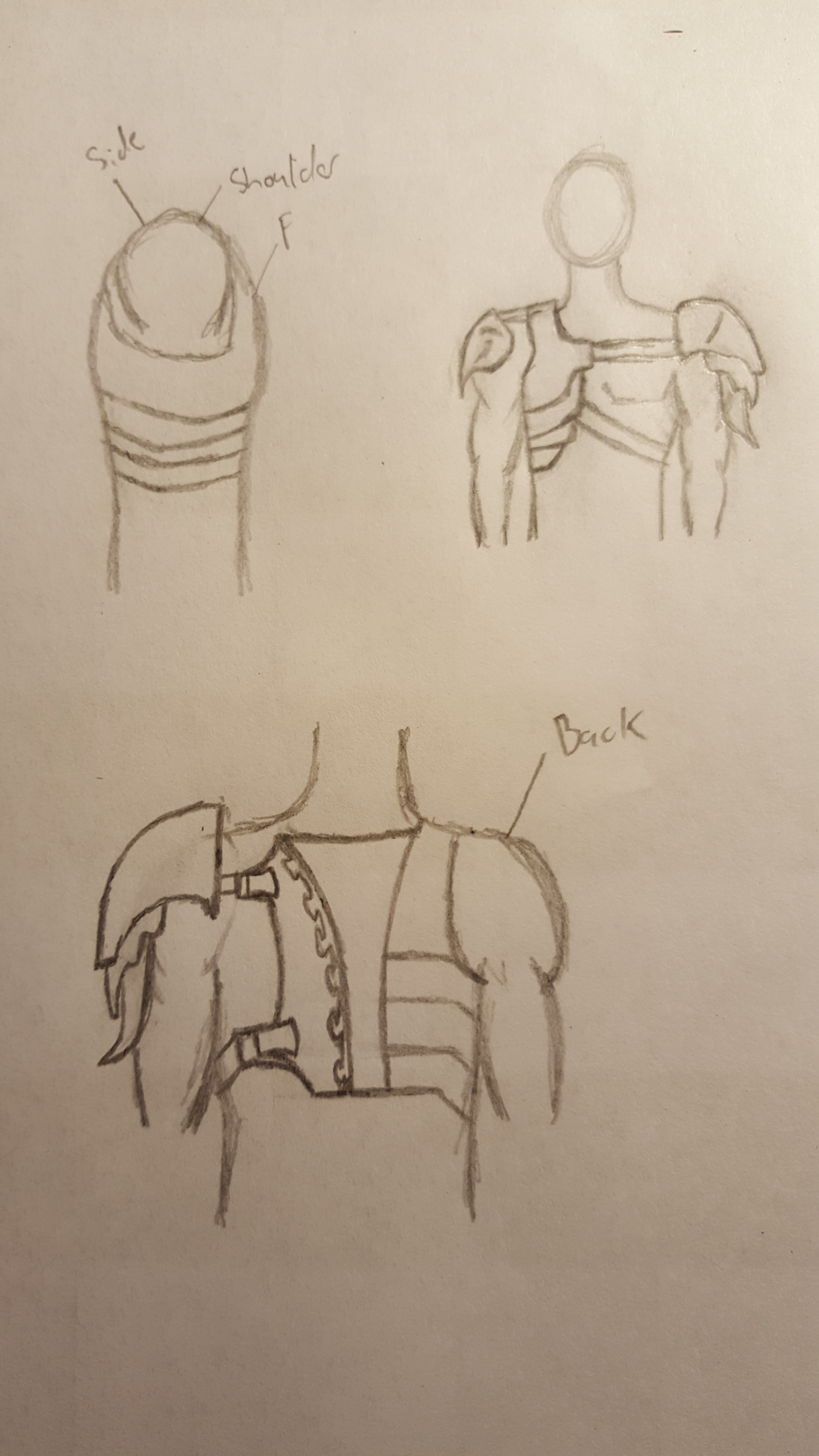

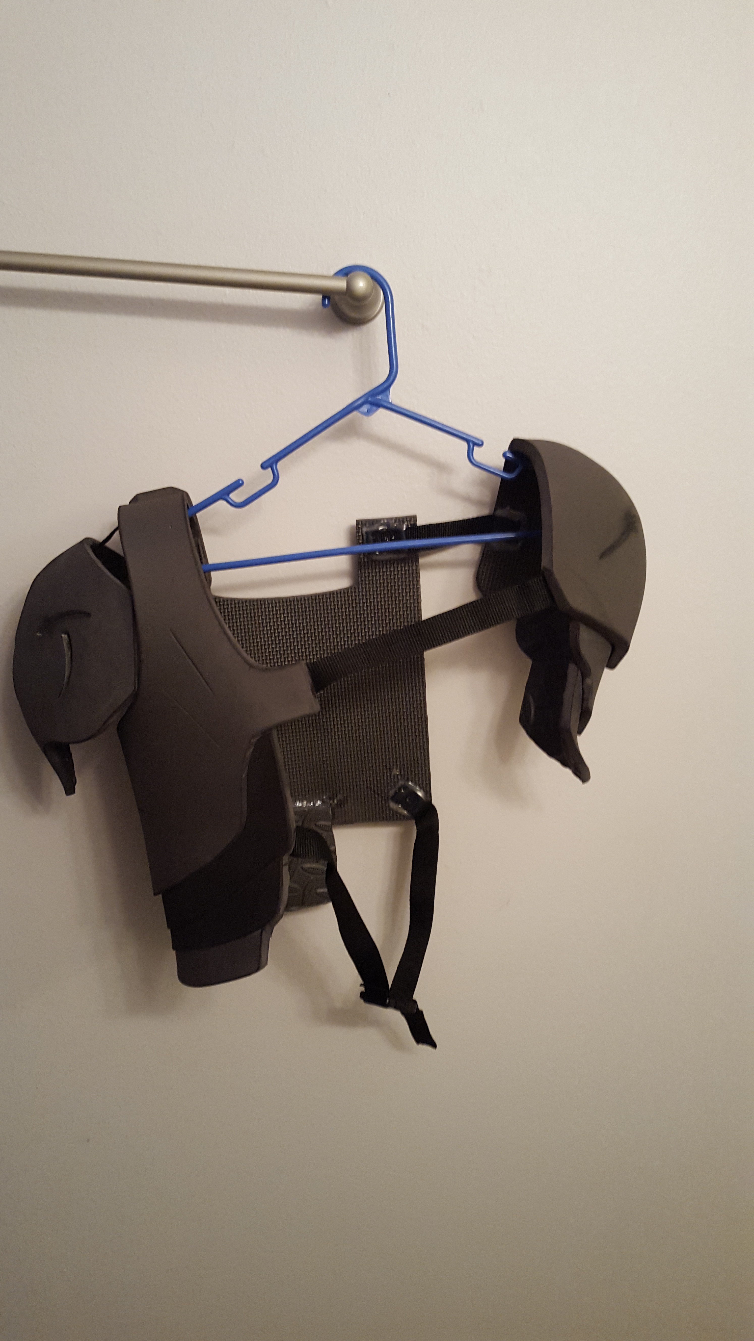

    Here is a picture of the first thing i ever made out of foam, just a few hours (maybe more than a few) after acquiring the few things I've suggested.

    I just realized that that's not exactly a great photo lol. Not much a picture taker. I was happy with the result and fit the way i wanted it to.
    I hope this helps. Please let me know if you have any questions regarding anything I've mentioned, or anything else. I'll answer what i can
