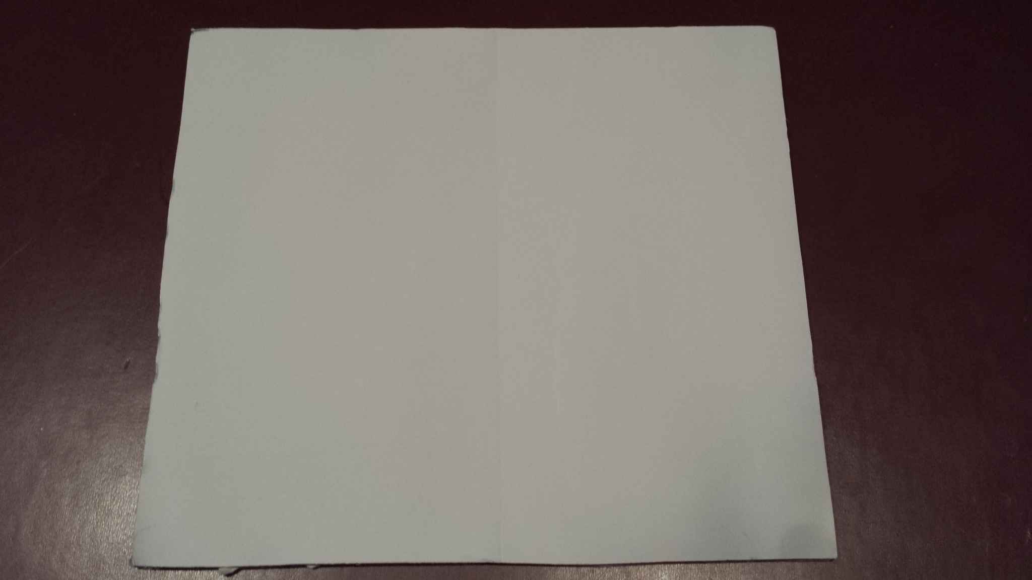

I sprayed a scrap piece with both DupliColor FP101 light gray and DAP1692 dark gray and then hit it with a few light coats of the Corax white. The Corax White to my eye is a very light gray. Looks very close to the DupliColor FP101. The picture on the right shows it darker but in reality it's a little lighter. Going to do some pre-shading with dark grey lacquer using my air brush around the window areas and the raised detail. Once dry do a light sand to smooth out any overspray and then a few light coats with the Corax White.

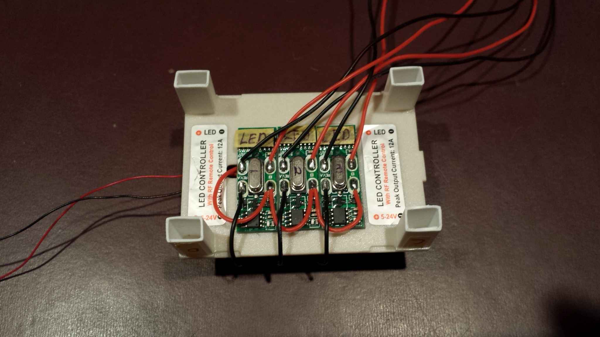

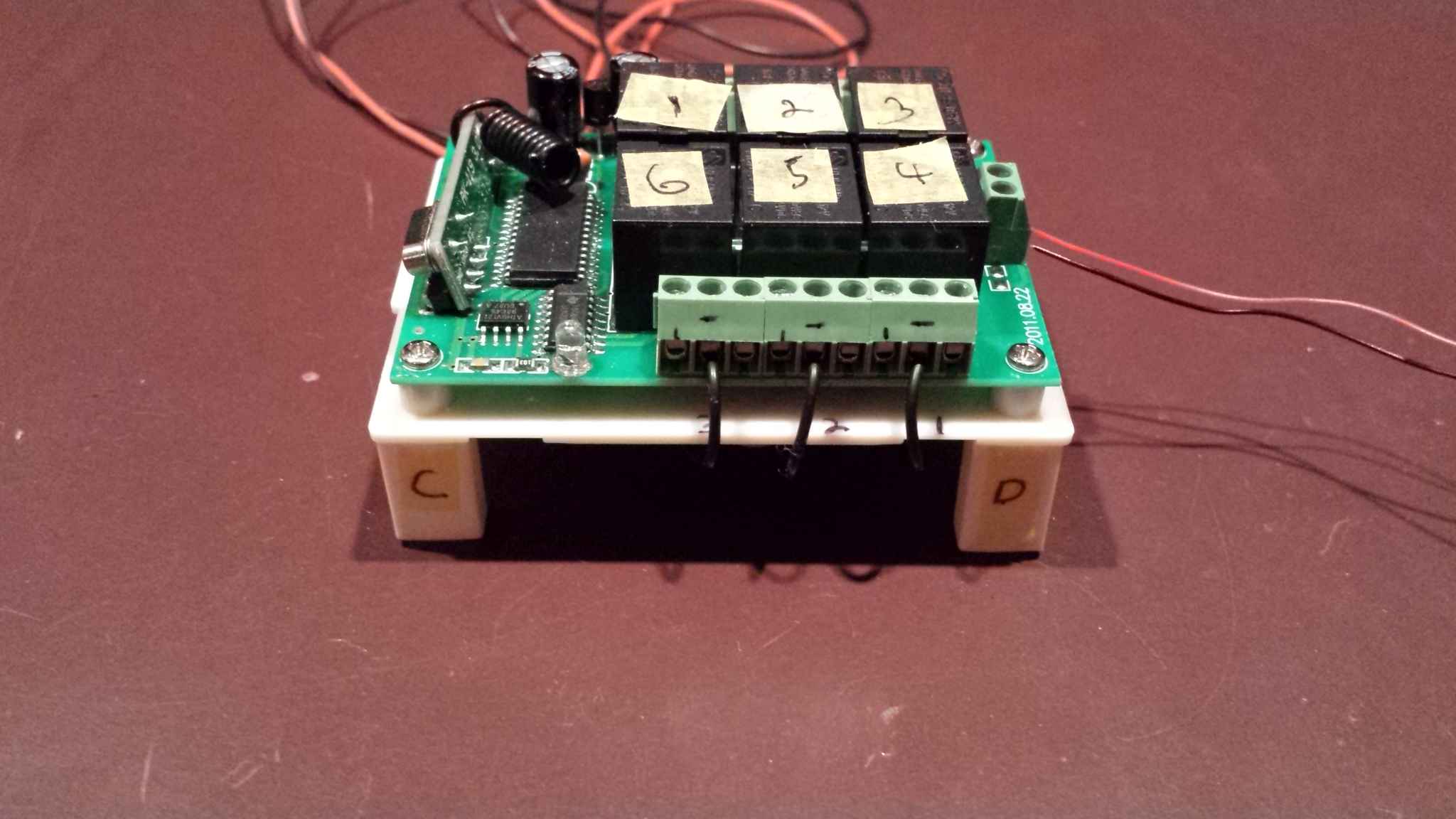

Below is the 6 channel RF relay switch that with turn on / off independently the main lights, hangar bay and engines using a single remote (buttons 4, 5 & 6 in toggle mode). It will also be able to operate the Lasers and Sound clips with buttons 1 & 2 in momentary mode. I have also wired in (3 )RF remote dimmers to channels 4, 5 and 6 so those sections can be dimmed separately. I will set the dim levels with their remotes to what I like and leave it alone.

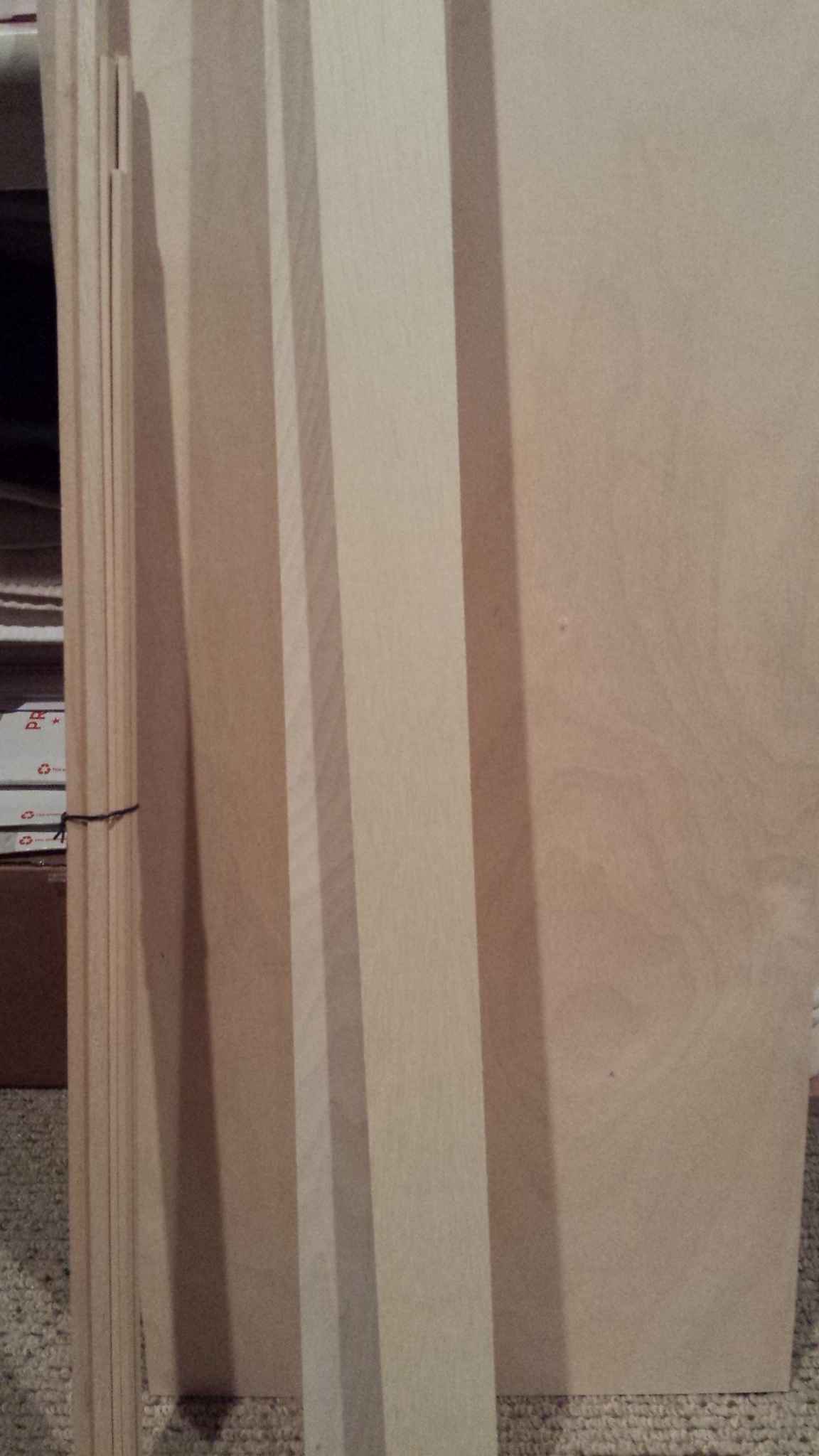

Wood for the stand that I will be tackling shortly
View attachment 791556 View attachment 791554

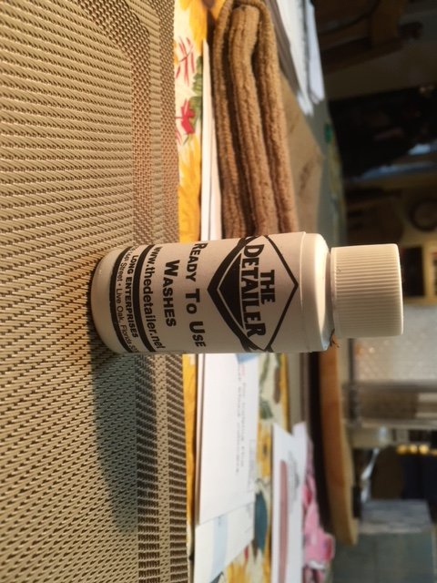

looks fantastic! :thumbsupI wish I had though to do that as well. you ISD is going to look so much better than mine :thumbsup the wash is called, "the detailer" little white bottle with a diamond logo printed in whatever color is in the bottle. I'd load a pic but I'm home sick and my lap top is a POS

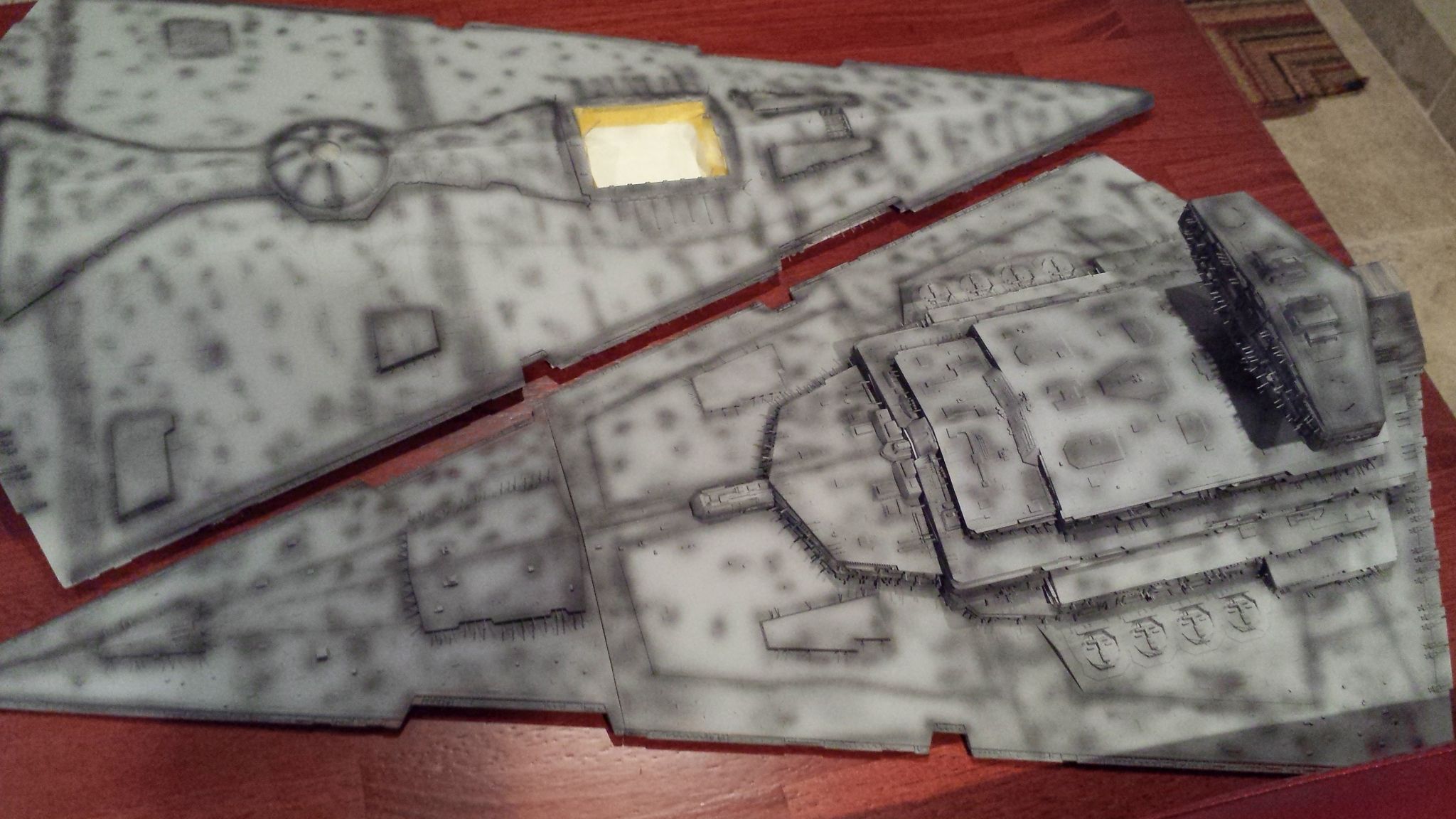

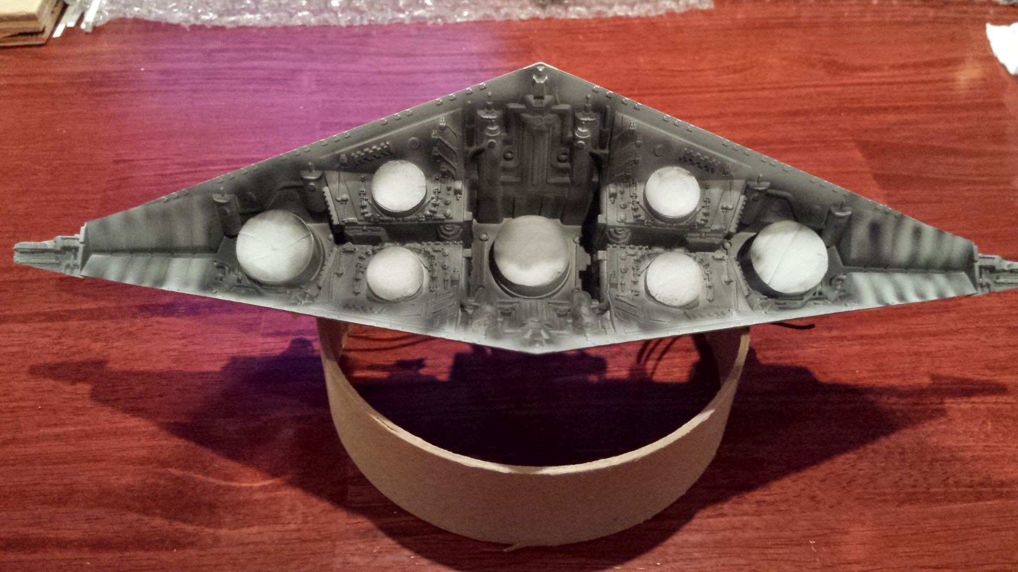

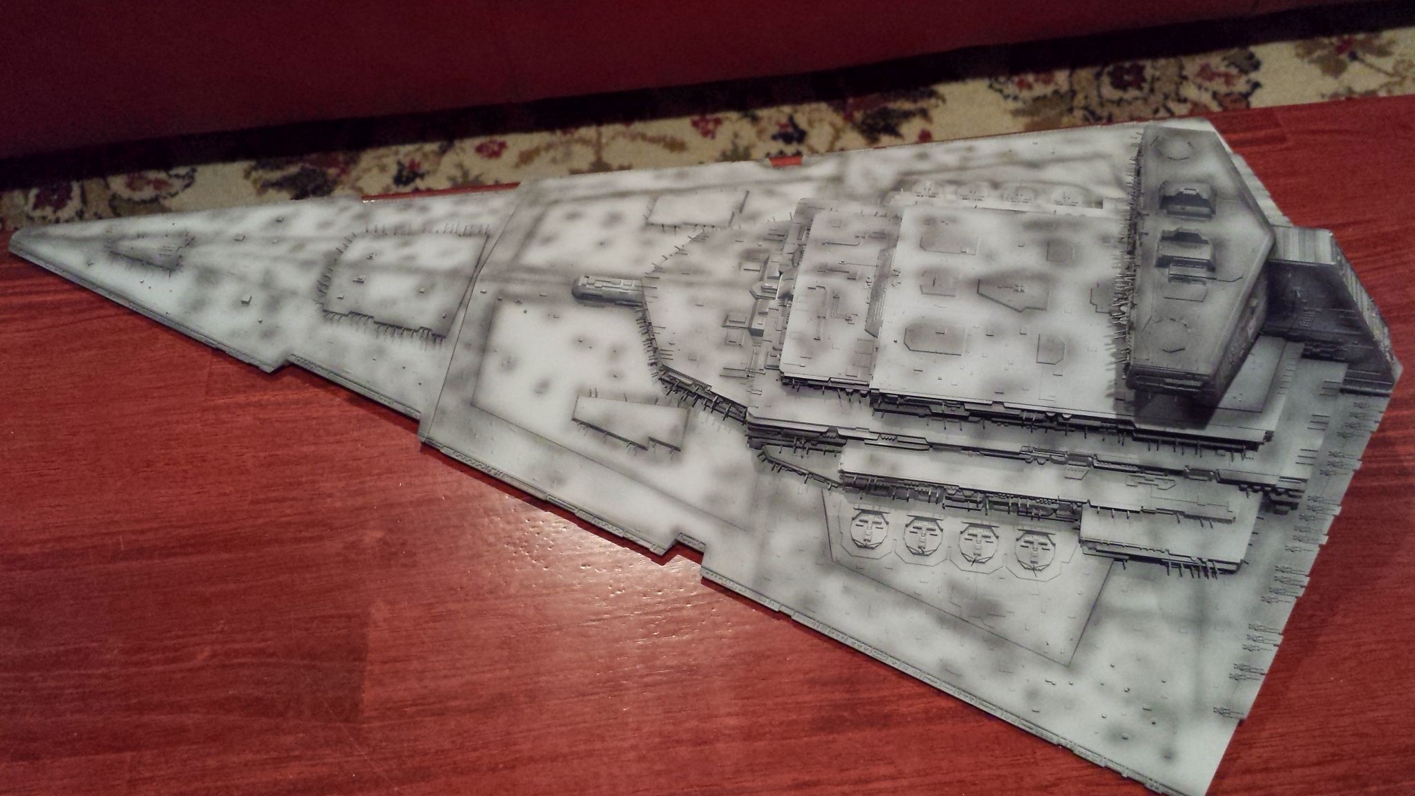

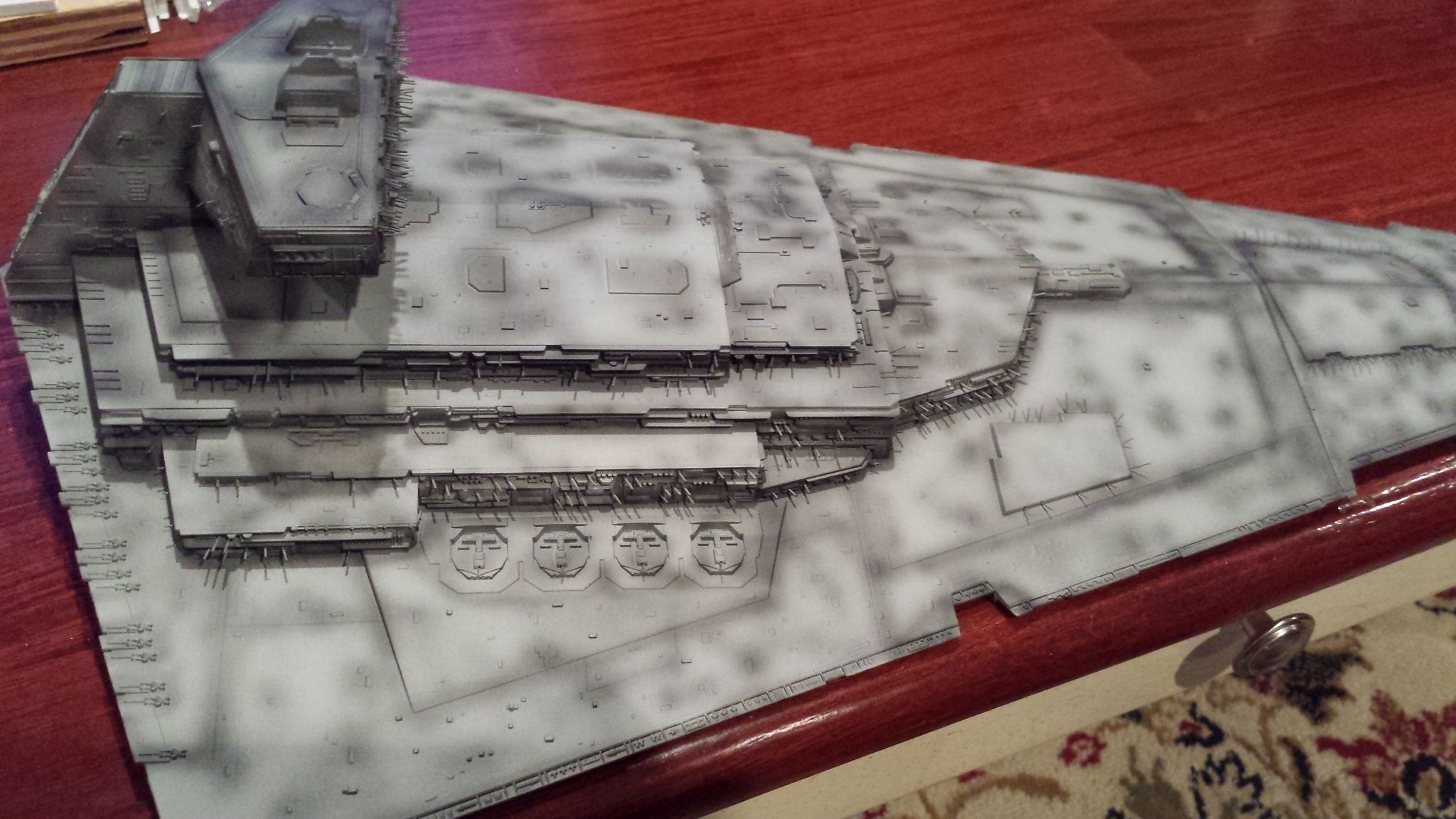

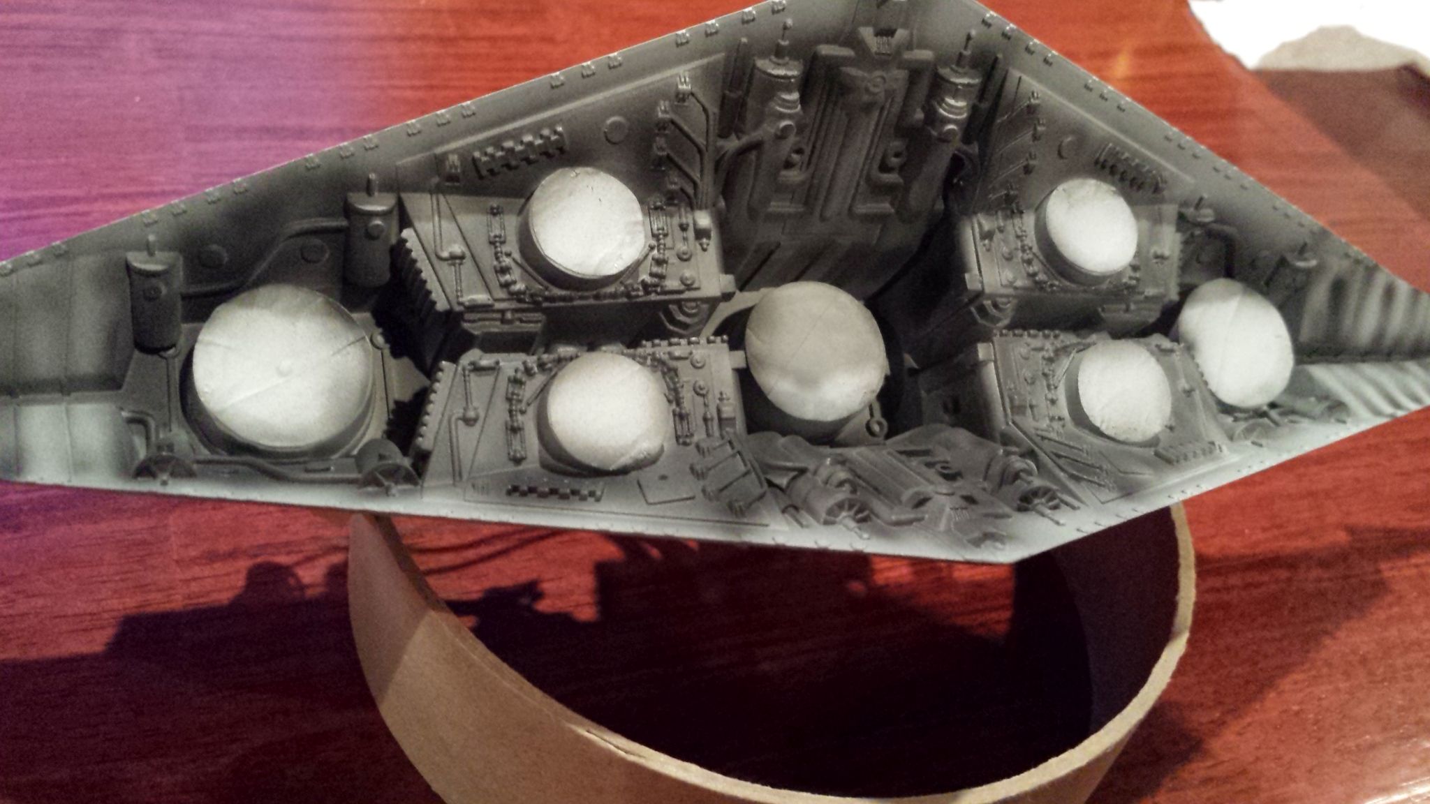

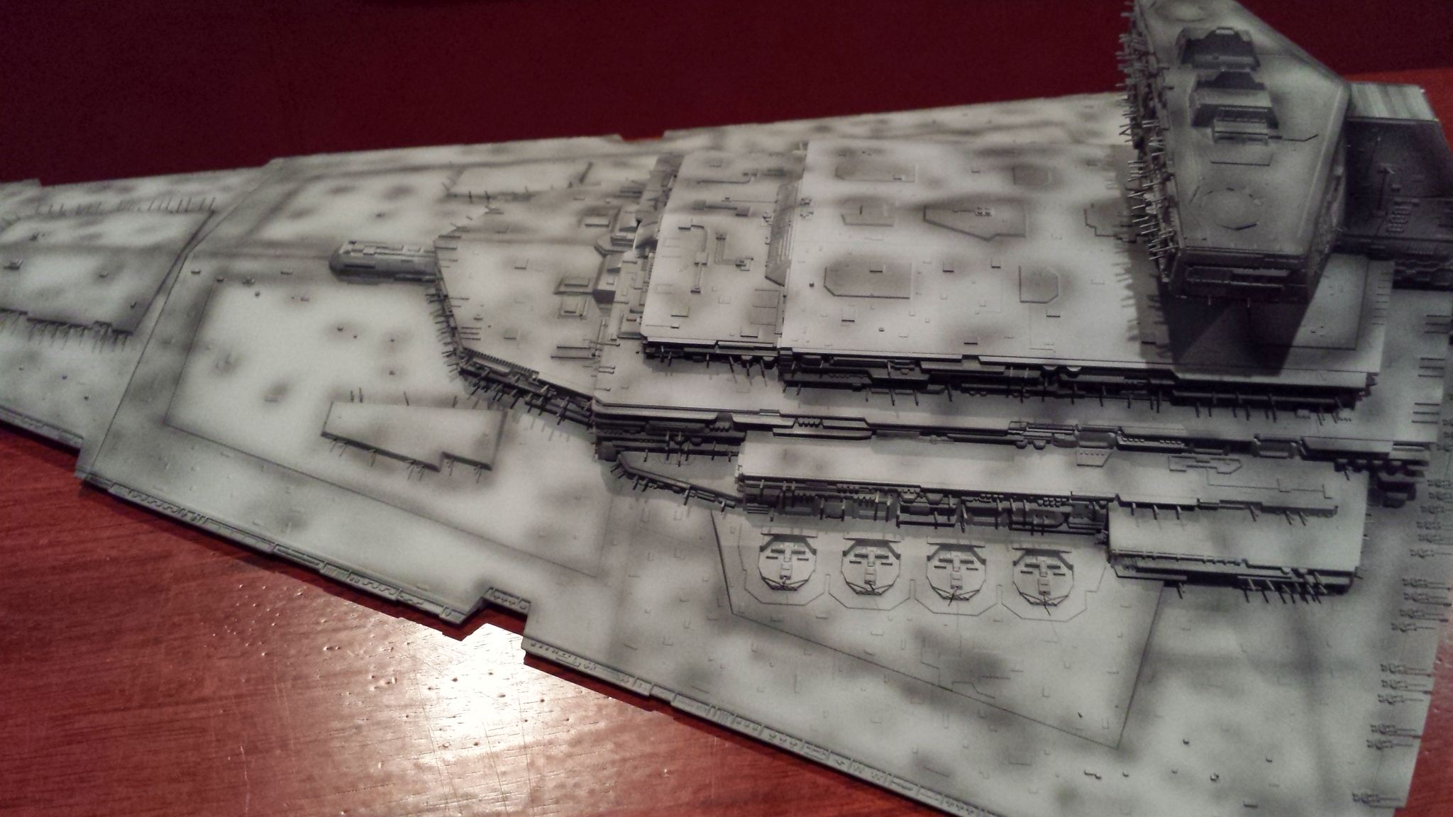

Just finished pre-shading. It looks like its all over the place but the top coat will cover most of it and hopefully you will just see a hint of subtle shades of gray randomly all over the ship. Then the wash should bring it all together.
View attachment 791716 View attachment 791717 View attachment 791718 View attachment 791719
View attachment 791720 View attachment 791721 View attachment 791723

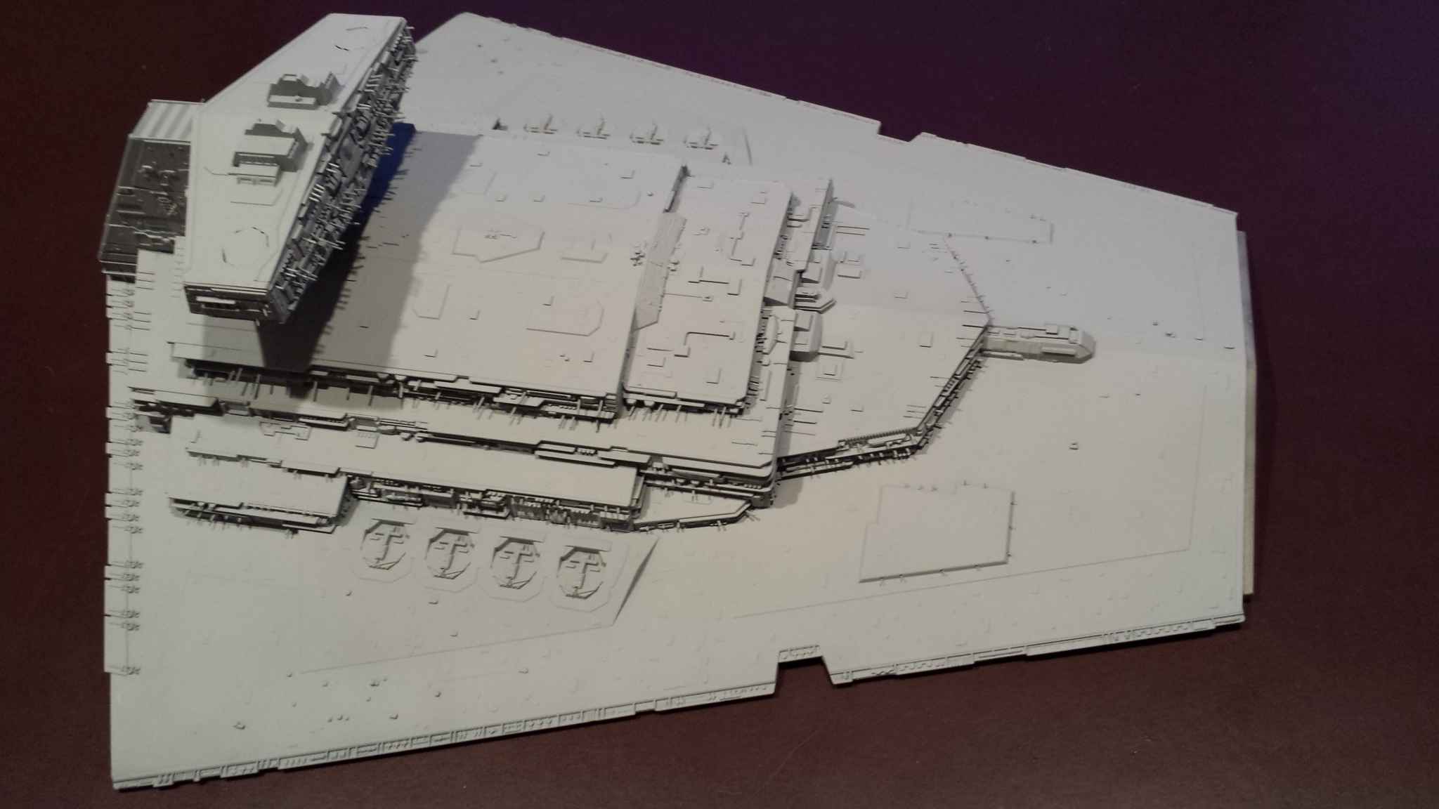

Corax white applied. That stuff covers really well. I sprayed a very light single coat and it basically covered all the pre-shading I did. With that light coat of Corax white it dried with a nice smooth finish!

I also cut all the wood for the stand......so in between I will put that together paint and detail it. I have a few surprises that I will not divulge until the end

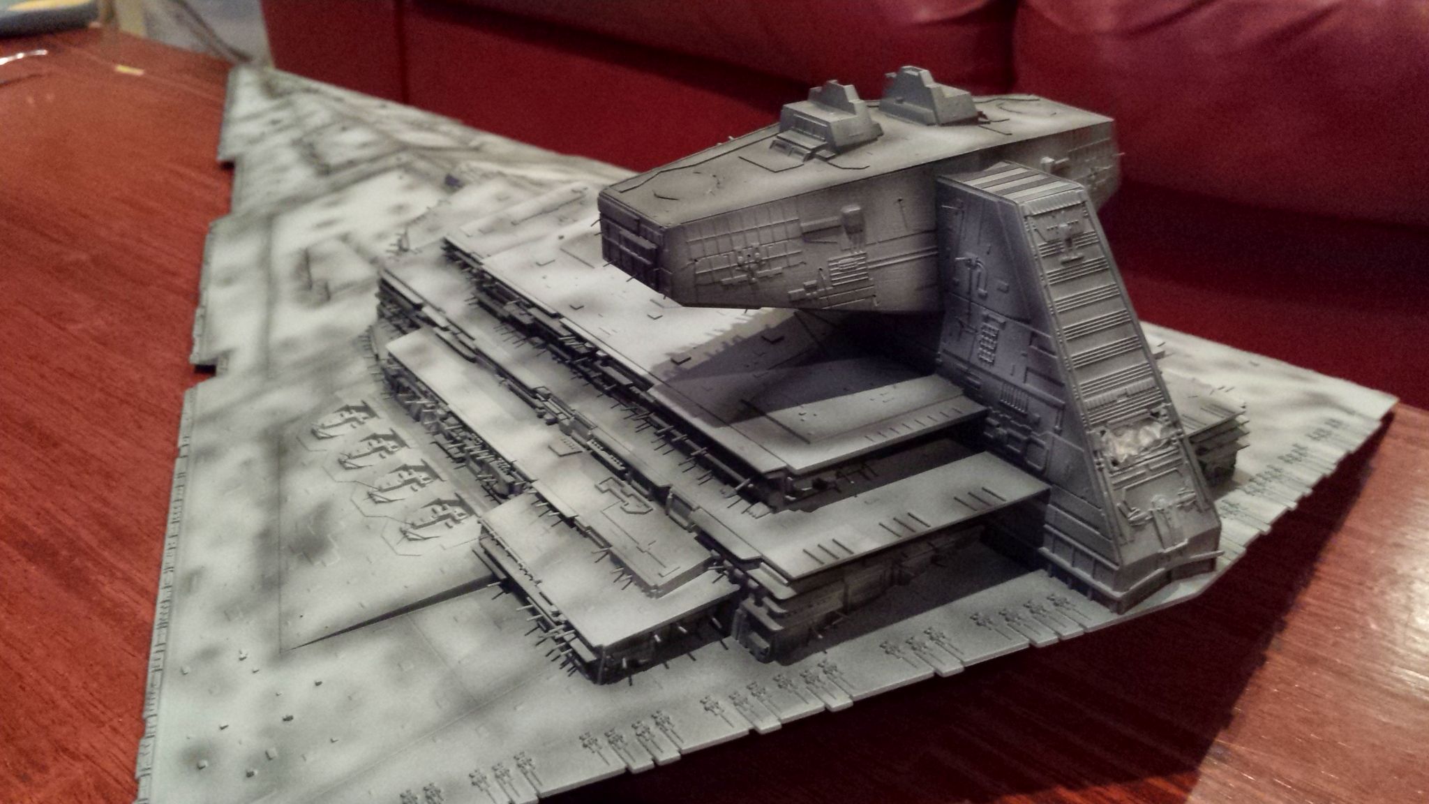

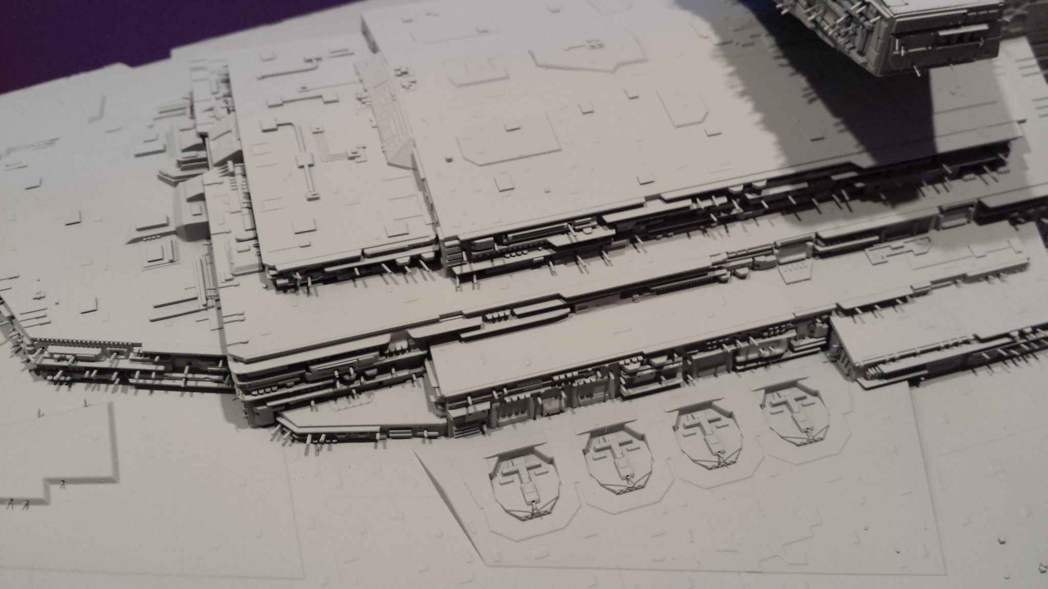

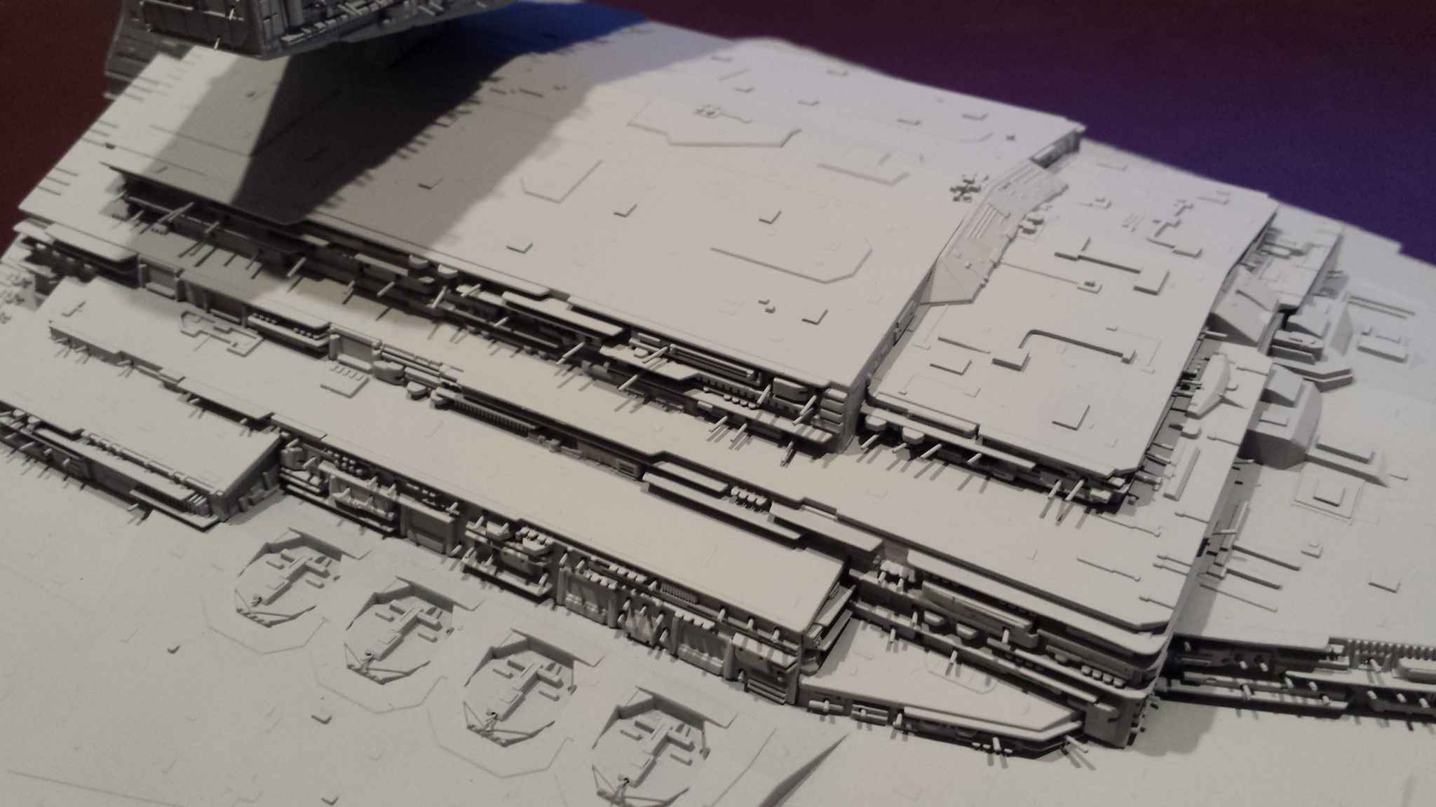

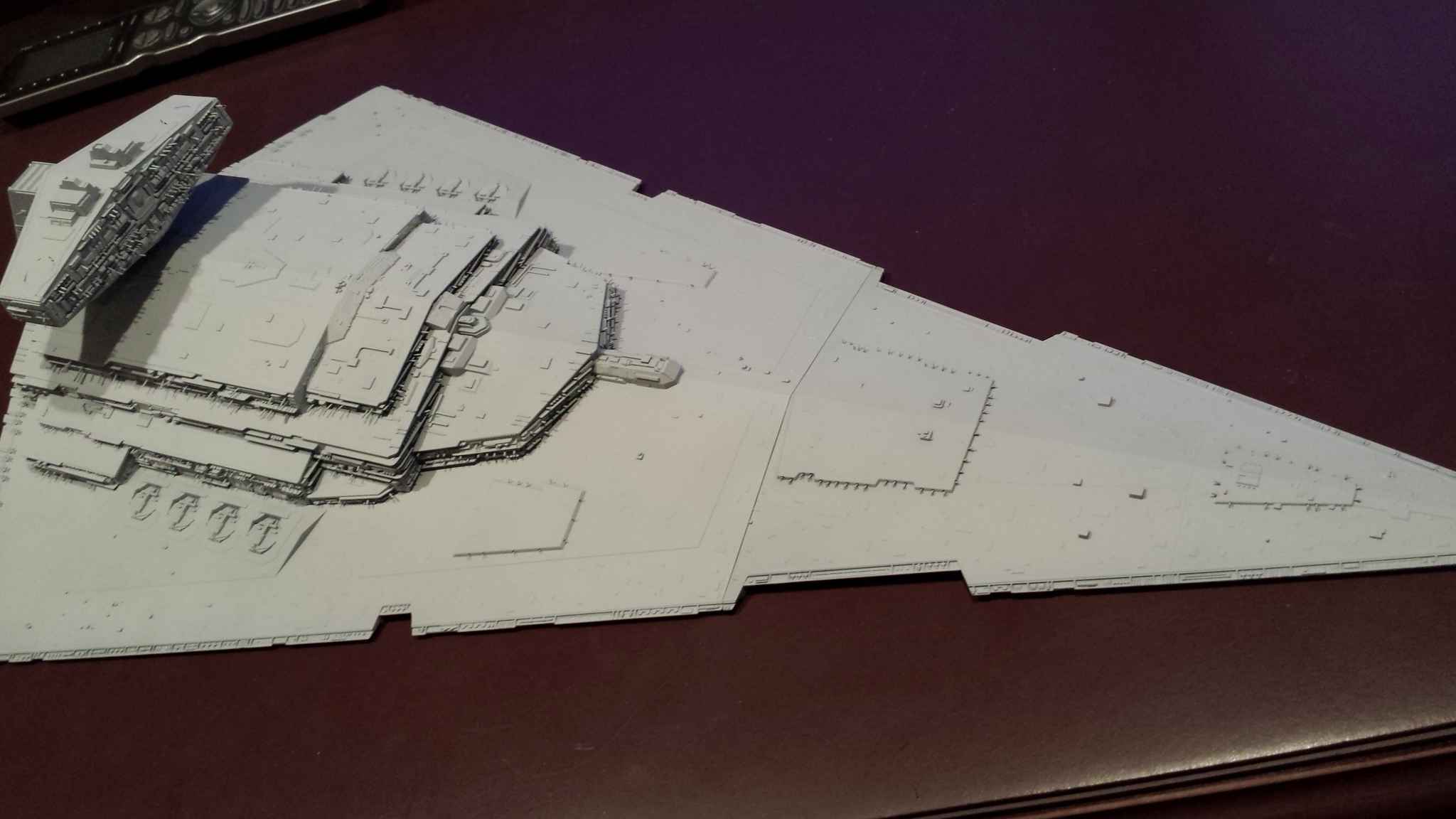

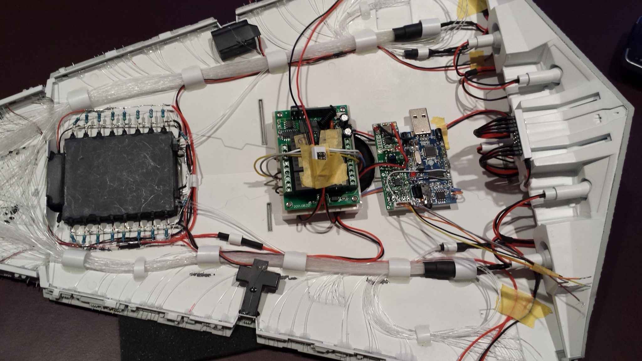

Pictures of the Corax white base coat applied......Almost finished connecting all the wires to the electronics in the main hull. Should be finished with that by Friday. Still waiting for the paint for the wash to get delivered.
20180207_075503smaller.jpg 20180207_075600smaller.jpg 20180207_075608smaller.jpg 20180207_075621smaller.jpg
20180207_075613smaller.jpg 20180207_075632smaller.jpg 20180207_075711smaller.jpg
