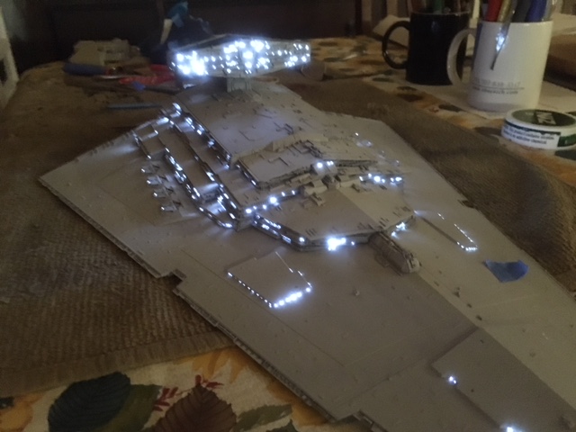

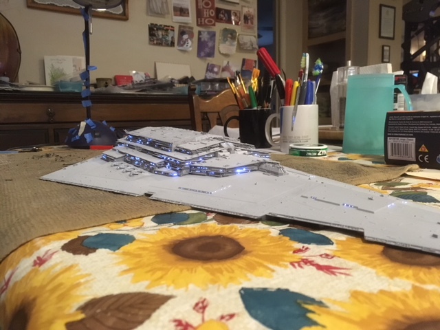

1/2700 Star Destoyer on the kitchen table
Great work!
Thank you for sharing!
I see you use the same "method" for fiber optics that I do!, You calculate about 50, start drilling where you think they should go and end up with 100 lol
LOL, that's the way of it, I guess the worst that can happen is you can run out of FO...like I did :lol
Great work!
incidentally, I had a 1000ft roll of .25mm FO for this thinking, yeah, that'll be plenty...I knew I wanted lots of light points hence the .25mm. But I did run out, of course you will have excess you trim off, but I used another 100ft I found in my stash, then I found I needed even more. lucky for me I came across another 250ft I didn't know I had and I'll be lucky if I don't run out again. Unbelievable huh :confused

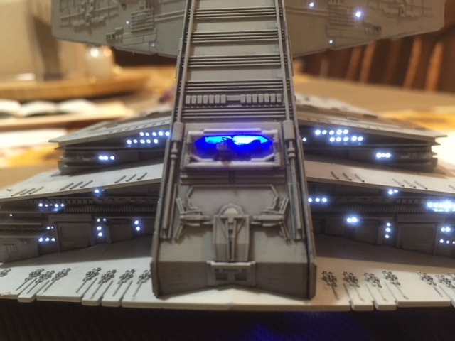

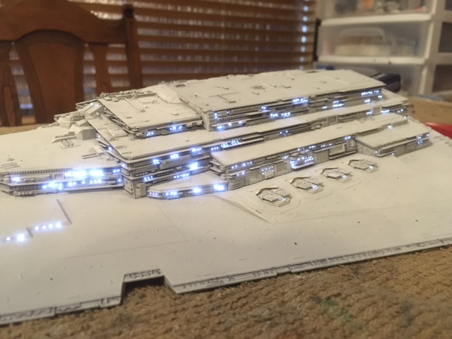

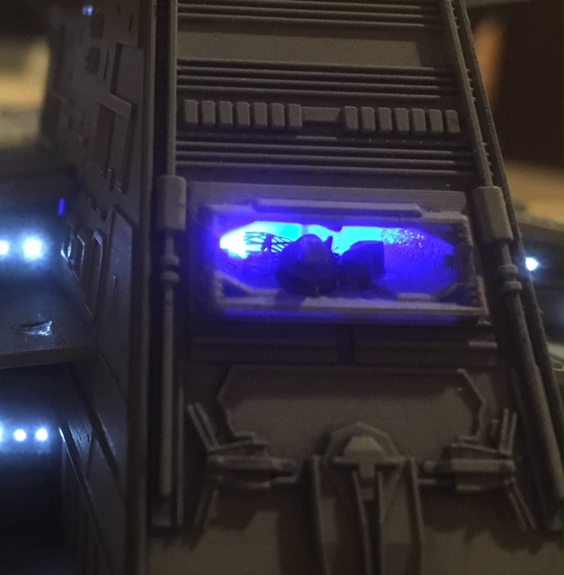

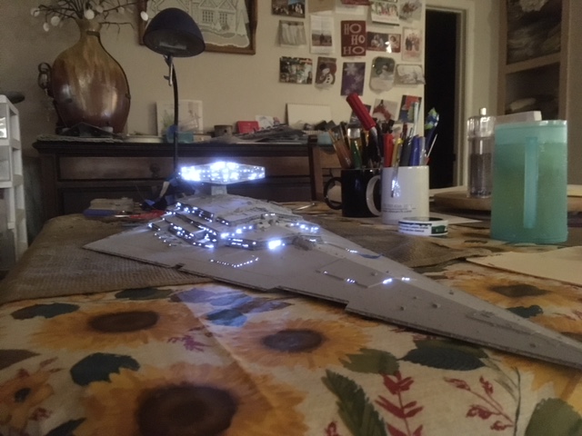

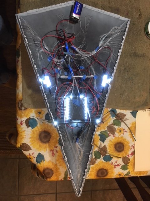

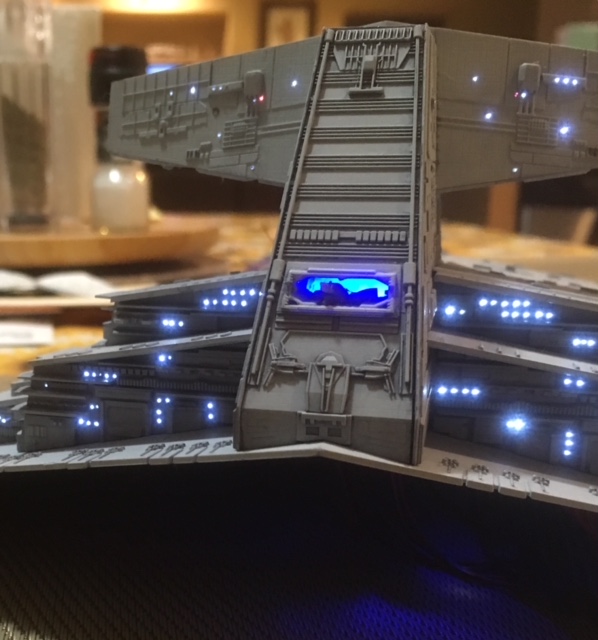

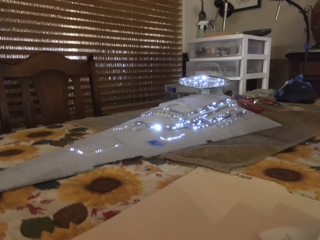

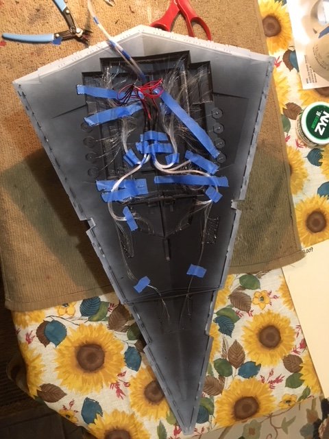

ISD UPPER1.jpegISD UPPER3.jpegISD UPPER2.jpegISD UPPER4.jpegISD UPPER5.jpegISD UPPER2.jpegISD UPPER7.jpegISD UPPER8.jpegfinally...took long enough to get all the FO organized and routed so it'll stay out of the way and make final assembly cleaner. Still much to do. I haven't test fit the engine panel yet, but I hope none of the FO in the rear will be a problem.

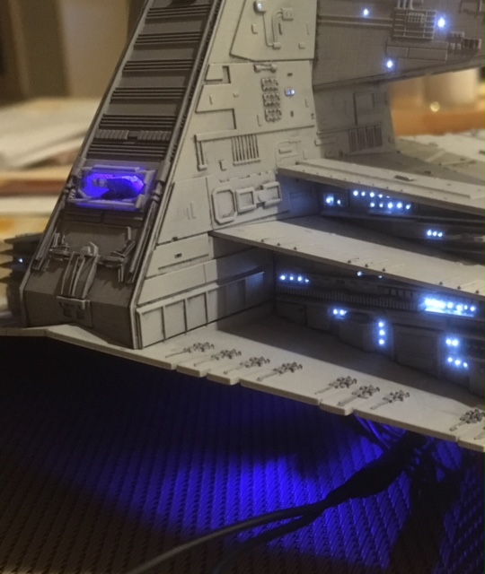

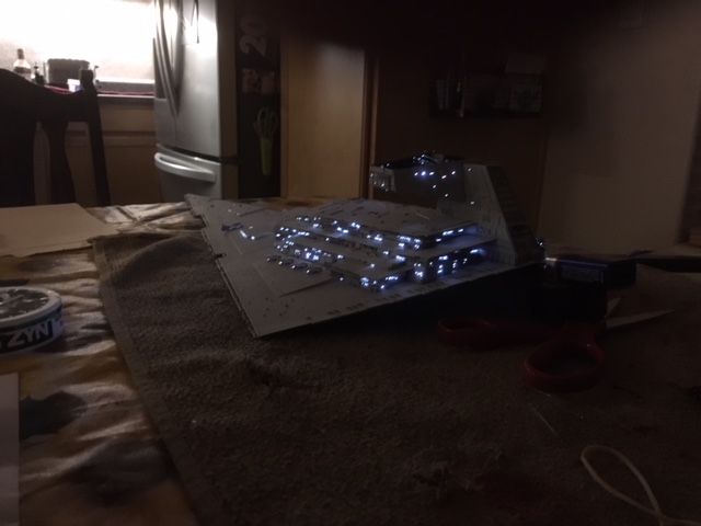

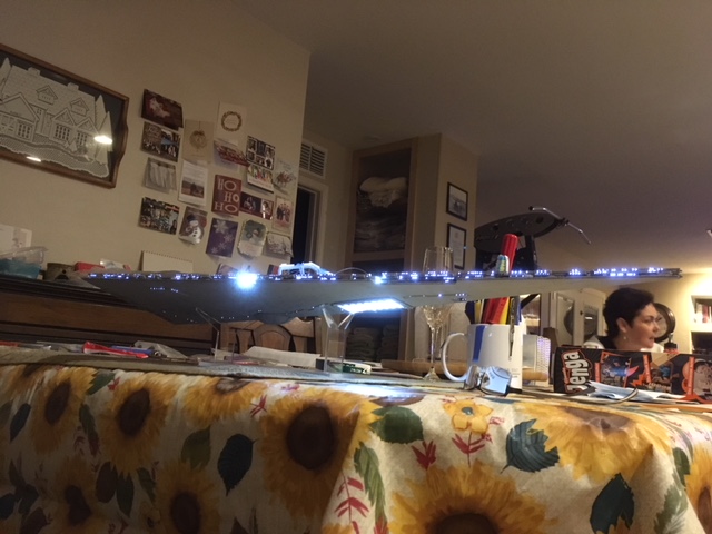

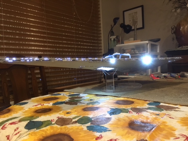

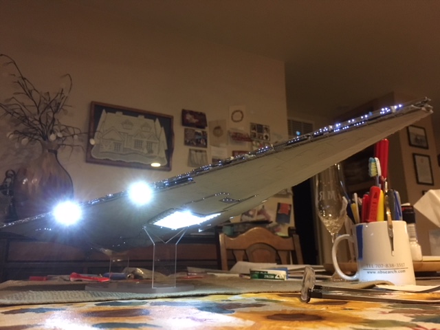

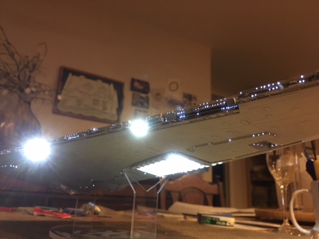

ISDNYE1.jpegISDNYE2.jpegISDNYE3.jpegISDNYE4.jpegNew Years Eve...we had the neighbor next door over, her and the wife ran their yaps endlessly, but that afforded me so valuable work time at the other end of the table. this is a shot of the upper before the tower, with the ceiling light on, less glare. and the lower all tidied up with it's additional 1.5mm of trench.

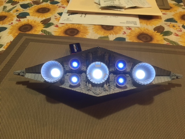

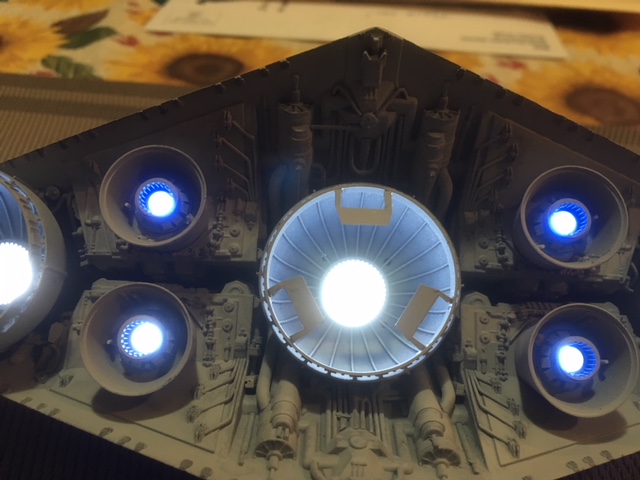

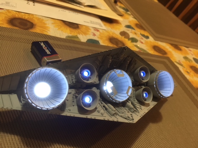

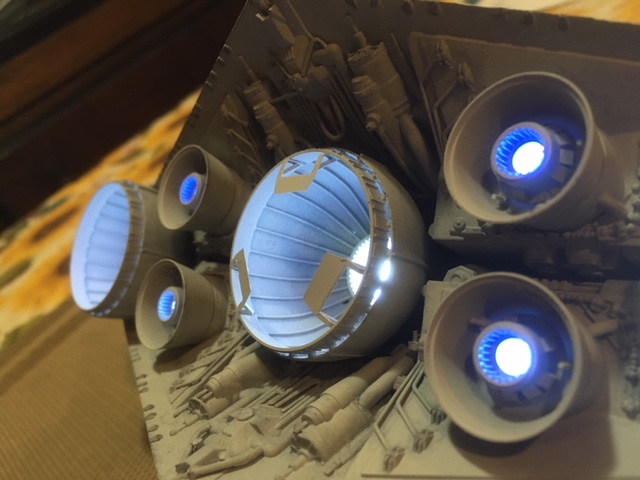

ISD engbells1.jpegISD engbells2.jpegISD engbells3.jpegISD engbells4.jpegISD garbage1.jpegISD garbage2.jpegISD garbage3.jpegISD garbage4.jpegGood morning my friends, I humbly submit to you, for approval or critique, engine lighting (and my scratched bell baffles) and my garbage chute. The blue light in the chute is a flicker, gives it the illusion there's activity of some sort further back. Now, I thought these baffles were on the HDA PE sheet I ordered, evidently not. So, I can do another 6 and call it good, or...and be honest...if these look kinda ehh...or flat out like crap, tell me and I'll order the other sheet...assuming there is one.
