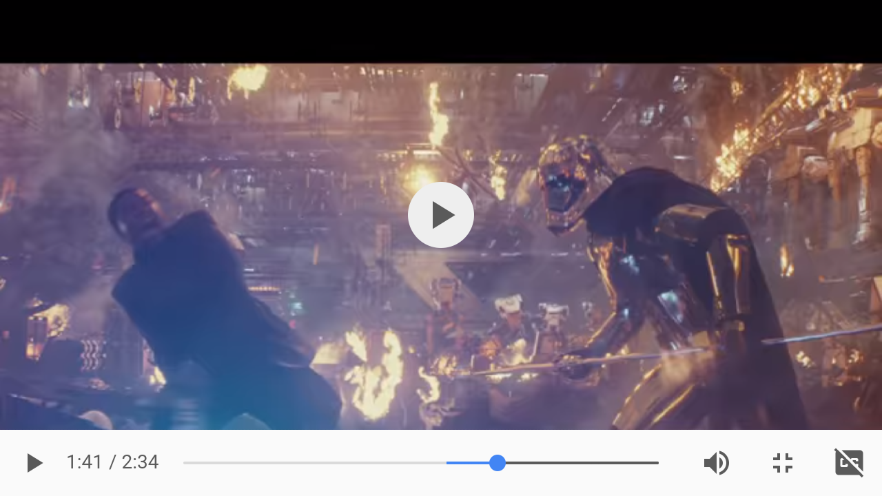

I have to figure out from the pictures available what the dimensions are and what the breakdown of sections is.
From the receipt you see I have a 1 inch by 2 inch by four foot pine craft board (which in case you didn't know is actually a 3/4"x 1.5"x 4' because they're dirty liars, but that doesn't matter for this project) and a 3/4 inch by four foot poplar dowel (actually 3/4 inch). I have a total length of 8 feet
Gwendoline Christie is 6'3"according to imdb and even though in the pictures she isn't standing straight up at full height it's still almost a head above her (we can also assume it's not 100% perpendicular to the ground, also any angle would extend the length).
most people are 7.5 heads tall 6'3 is conveniently 75 inches making her head 10 inches so about a head above Christie is 7'1 I'm gonna call it 7 because I have to eyeball and from the pictures I definitely see some overlap area between the flatter side she holds on to and the business end (ends both sides come to a point).
The wider middle section which will be the pine 1x2x4 craft board(the body of the spear) is from her just under the top of her shoulder to her knee 4 1/6 heads (on my body proportion picture) I'm rounding it up to 3.5 feet leaving 3.5 feet for the spear part or business end... the dowel section (1.75' per end or 21 inches) checking my math with the head method from the knee down is 2 heads or 20 inches and we are guesstimating the tip is a head above her head so that's also 2 heads or 20 inches there's the unaccounted 3rd of a head for the section from chin to top of shoulder which works to 3 and a third inches (take 2 of those inches and add to each 20 inch business end making it 1.75' each)(I think the other inch is from my rounding 7'1 down to an even 7) then I have a 1/3" margin of error which I can totally live with.
So I need to chop my dowel into two 2 foot sections and chop 6 inches of my pine board (I may leave an inch to 1.33" for the spare I won't decide till I attach one end of the dowel) I want to seat the business end into the base pretty good so I'm going to put three inches of dowel into the craft board two inches glued and an inch I'm going to join and glue (sorta I'm not that good I'm gonna angle cut and glue more so it's really really locked in). 3 inches off the length of 2 for is my 1.75 foot goal.
Note: if I had a lathe I'd sharpen the points before glueing but I don't so I'm holding off till the end it's gonna be an arduous process. The business ends look to be sharpened for four or five inches at the end.
Also do I shave off any width from the body? I think I might take up to a half inch off. It's not the easiest thing to see how much wider the body is from the dowel. I'm not going to make that call yet either of anyone has info I'd welcome it.
Once that's done I'm gonna have to a: drill the detail holes (hey if anyone knows the info on those things, I'm all ears) then b: start the process of shaping the pine rectangle of the body into oval or football shape. Then c: sharpen the points d: aluminum foil tape it. Sounds easy as pie so I'm expecting Murphy to show up any time. I'll keep you up to date on what goes on. I'll try to put the pics of Phasma up and my sketches on the board.
