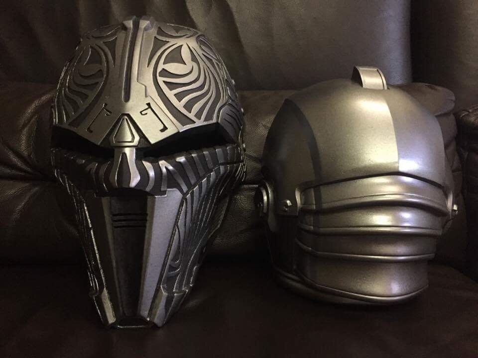

Its been awhile since anyone posted anything on Acolyte.

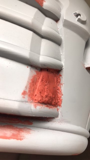

So I thought it would be nice to share what I have done.
How it all started.
As there isn't any maker in Asia, and I heard some feedback about what is currently available is too tight for some..
I decided to embark on this journey to fix a few issues.
1 - more room inside
2 - produce back piece of mask
3 - quality Asian prop
I have a different scale and size comparing with other makers.

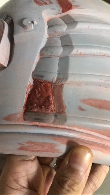

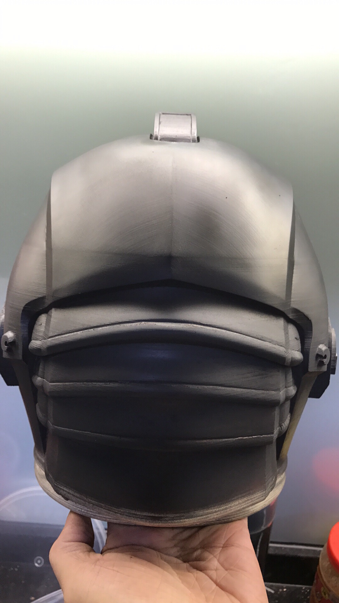

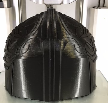

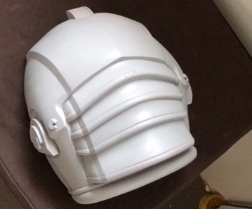

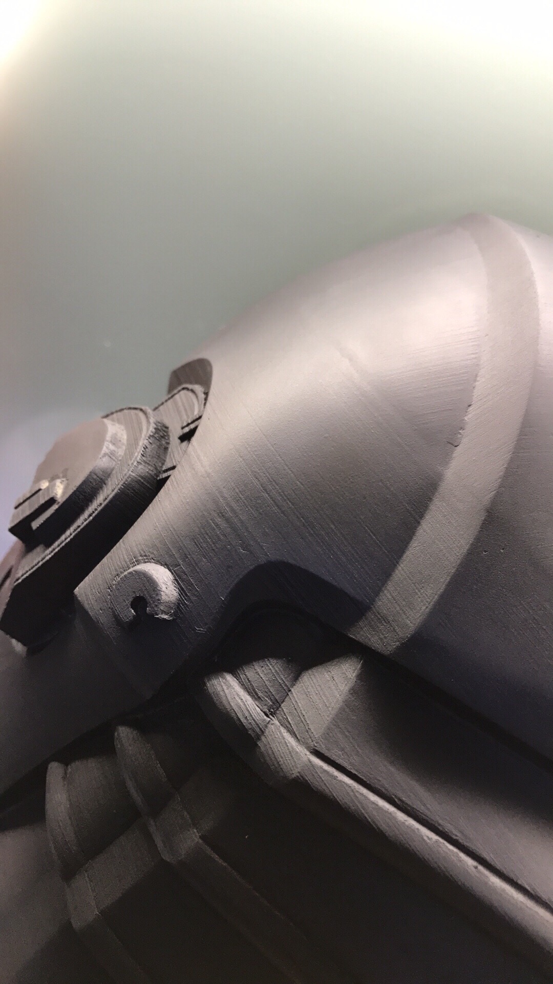

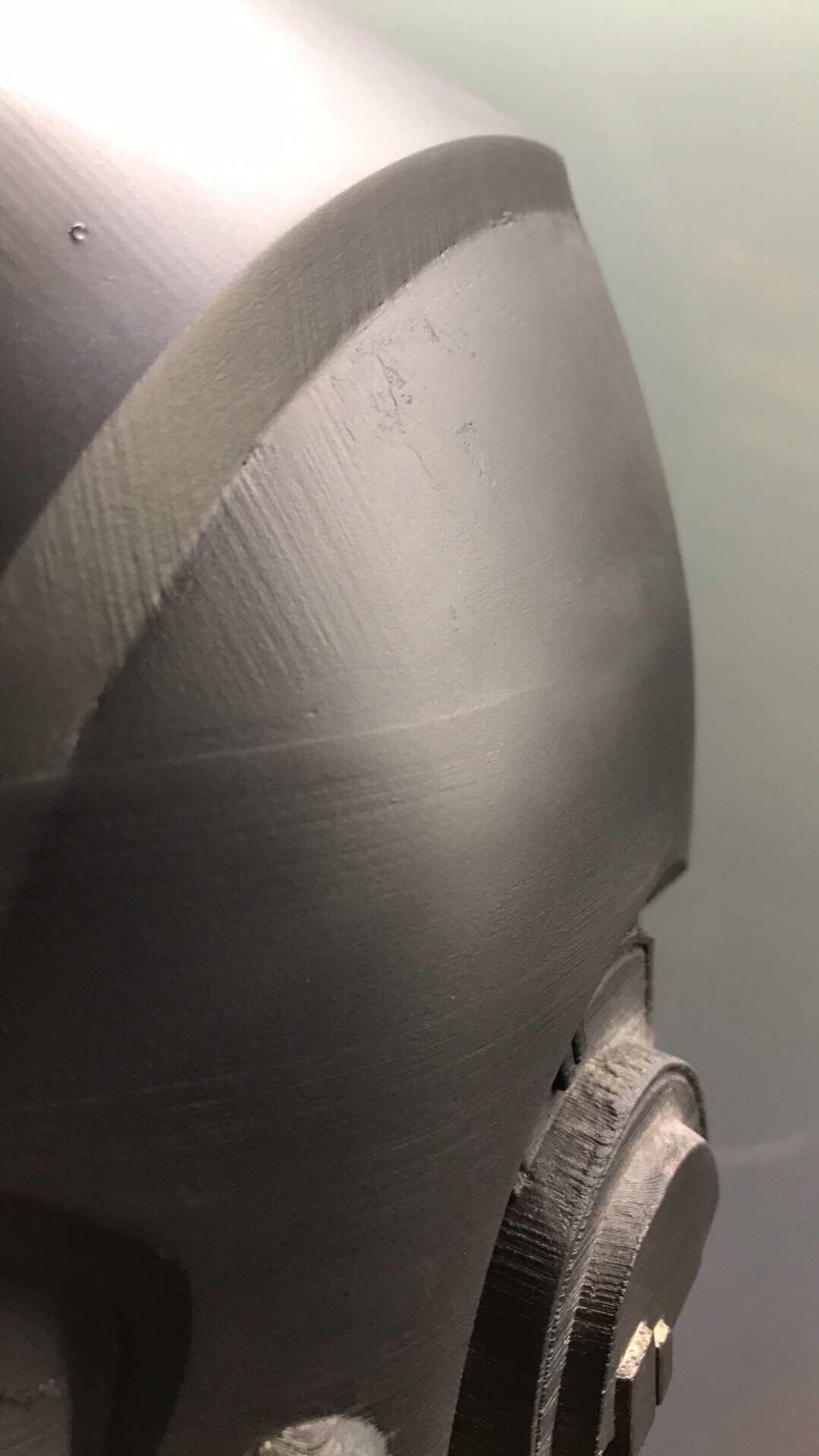

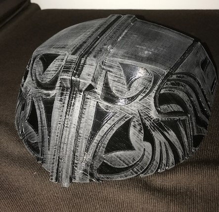

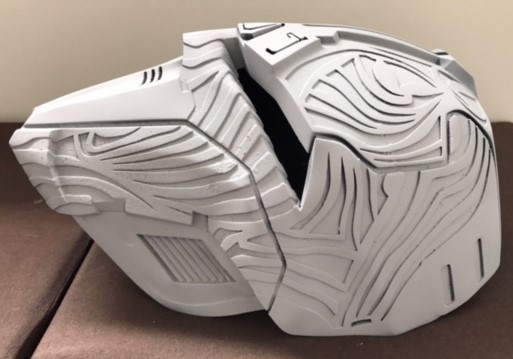

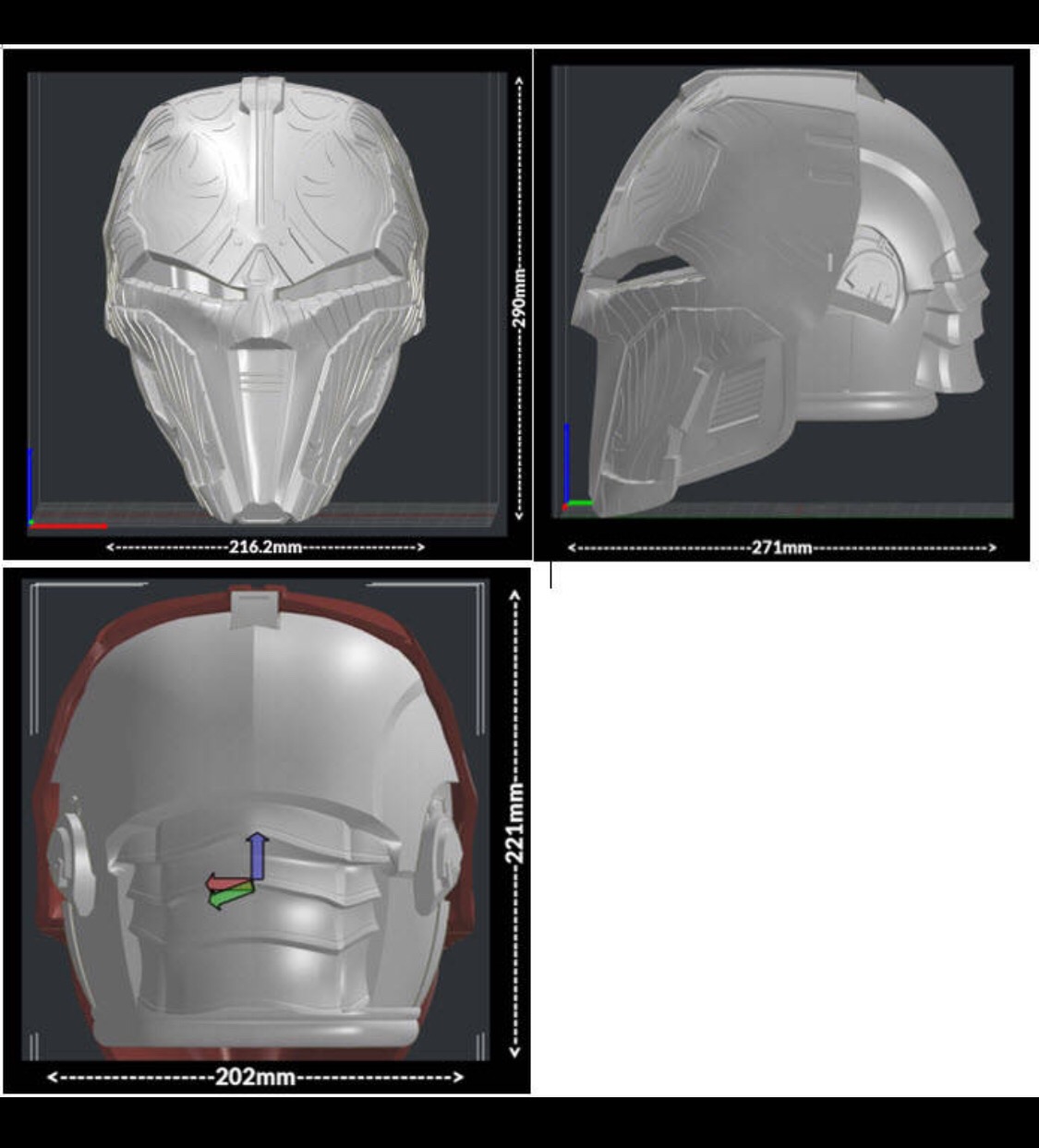

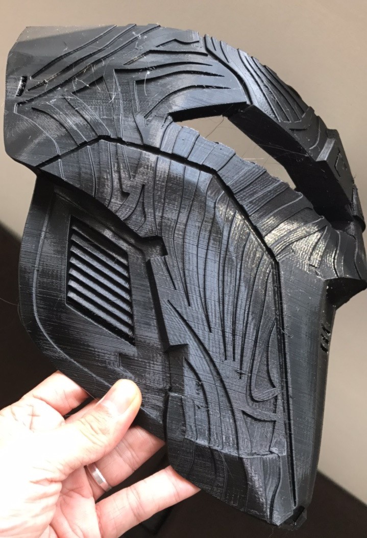

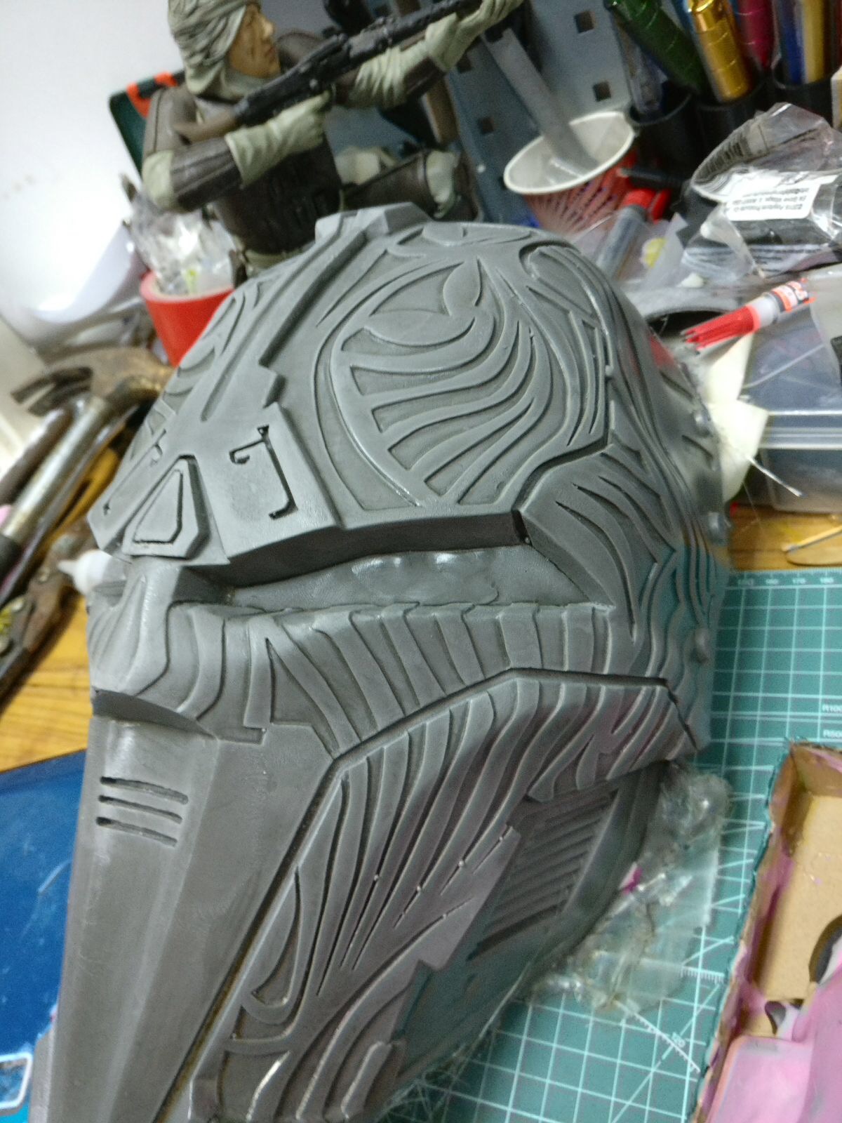

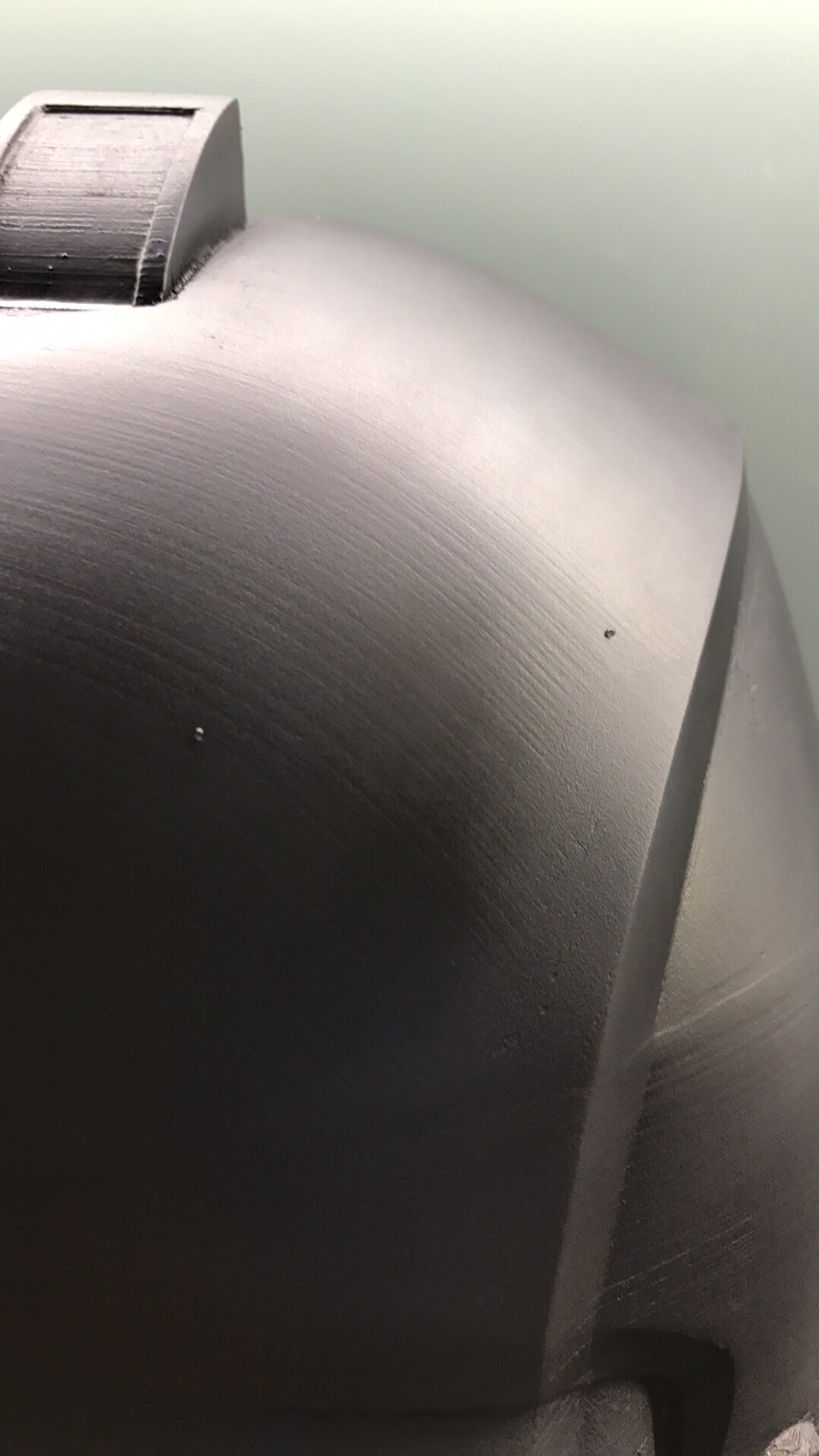

back piece was modeled and printed as 2 pieces.

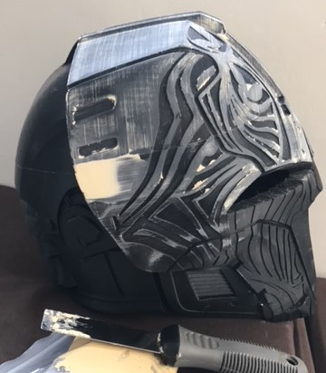

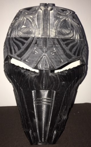

Test - fit before post processing

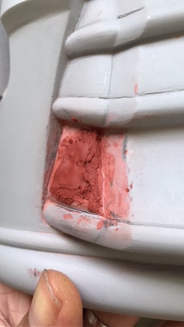

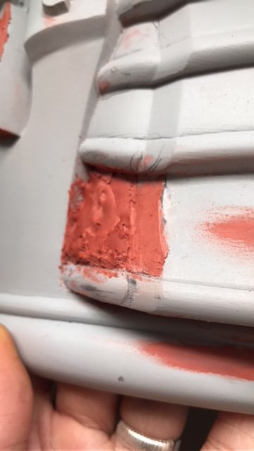

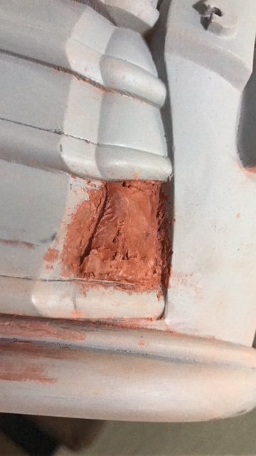

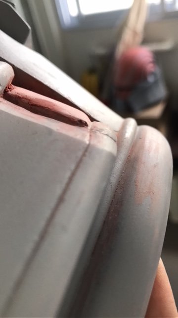

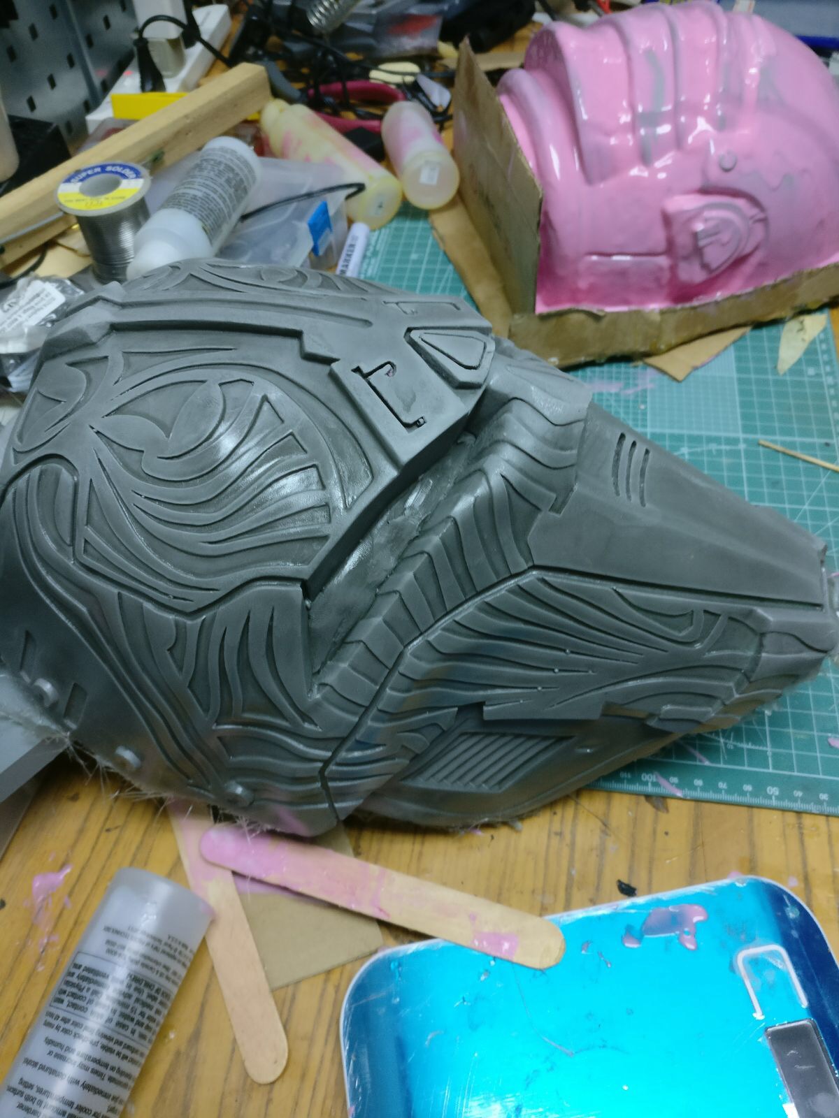

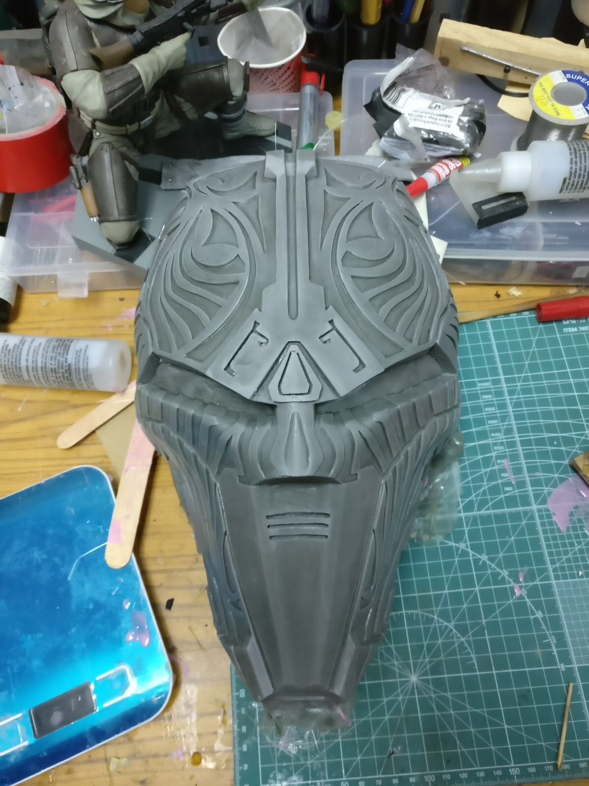

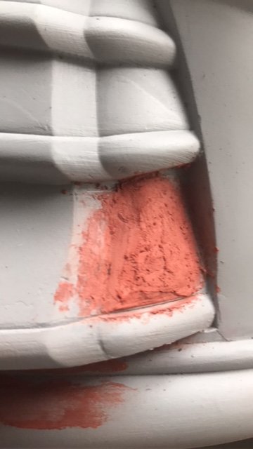

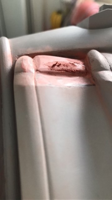

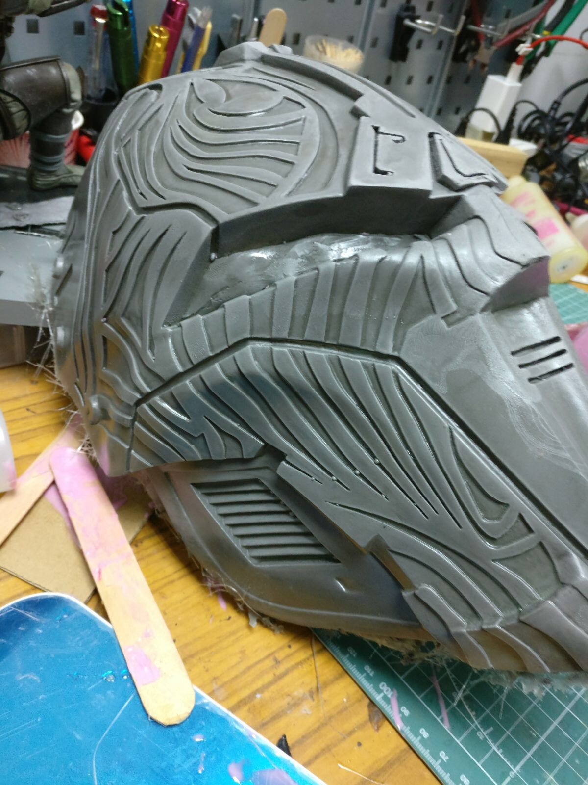

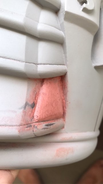

additional details were then hand sculpted while post-processing the print
IMG_8976.JPGIMG_8975.JPGIMG_8627.JPGIMG_8626.JPGIMG_8624.JPGIMG_8623.JPGIMG_8619.JPGIMG_8618.JPGIMG_8609.JPGIMG_9021.JPGIMG_9022.JPG

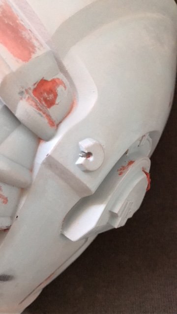

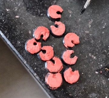

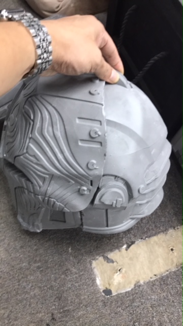

Nuts are being installed after the back and front pieces are well post-processed.

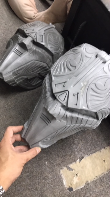

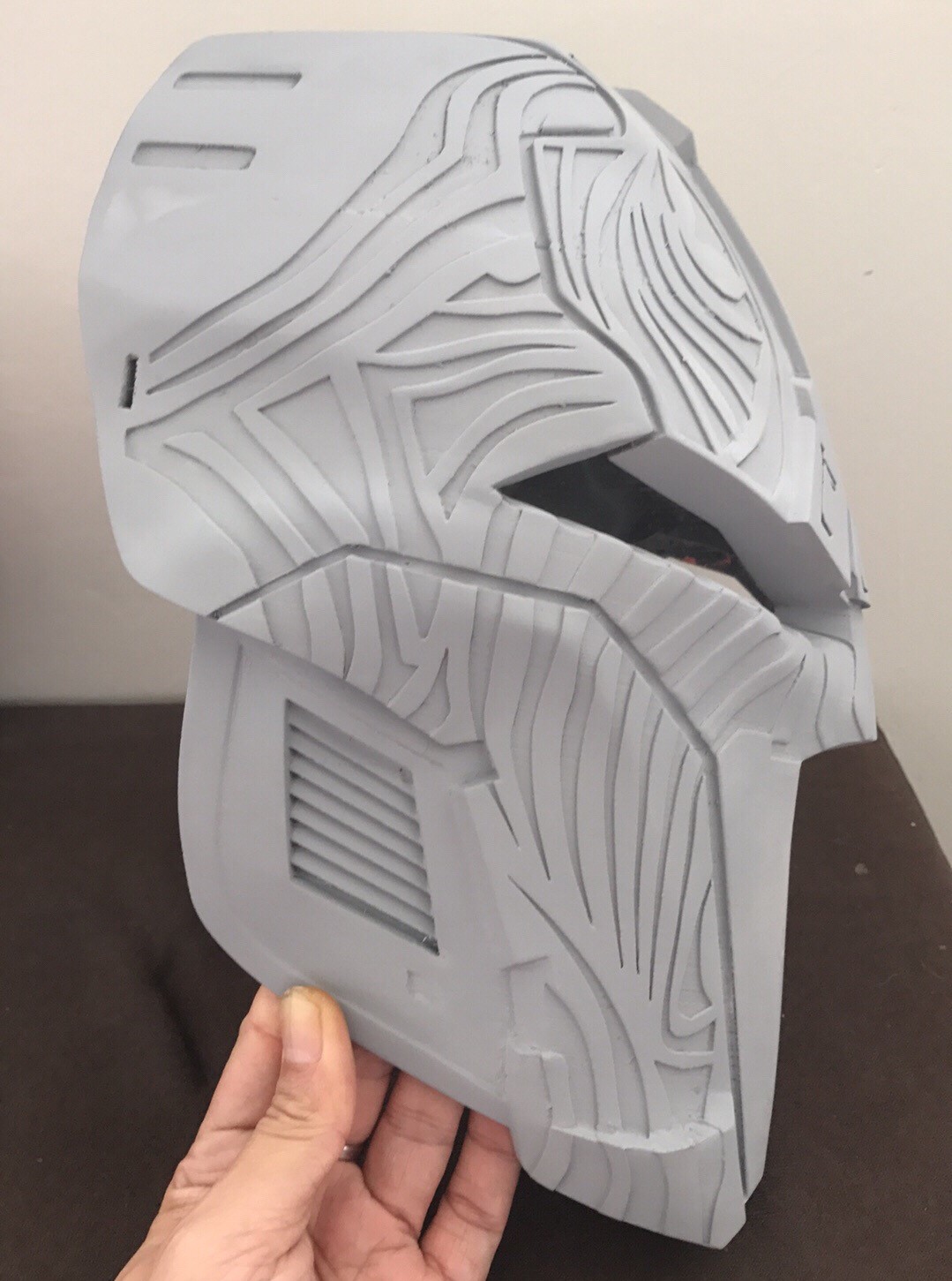

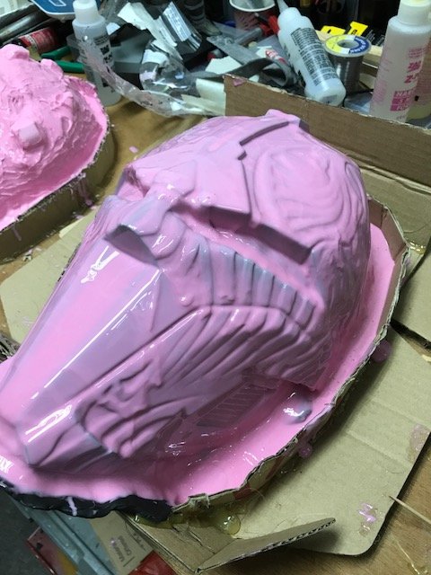

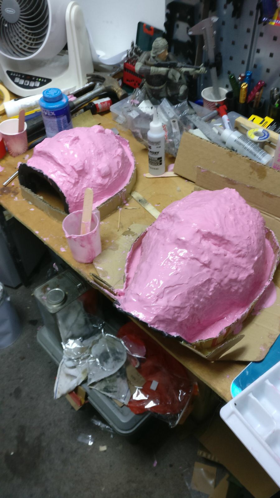

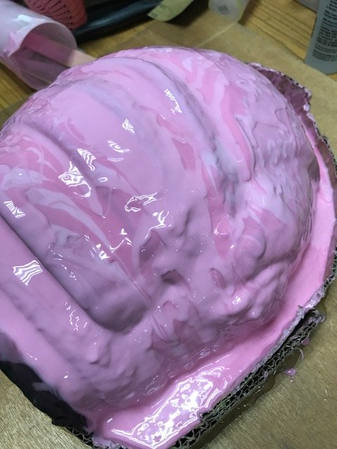

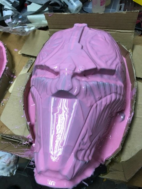

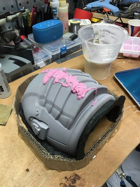

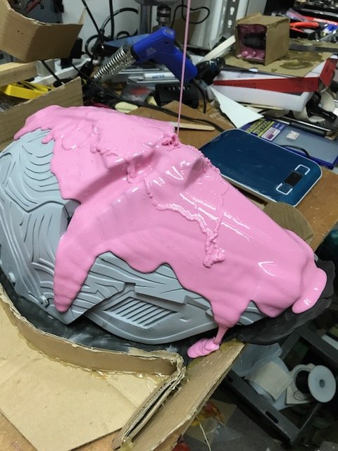

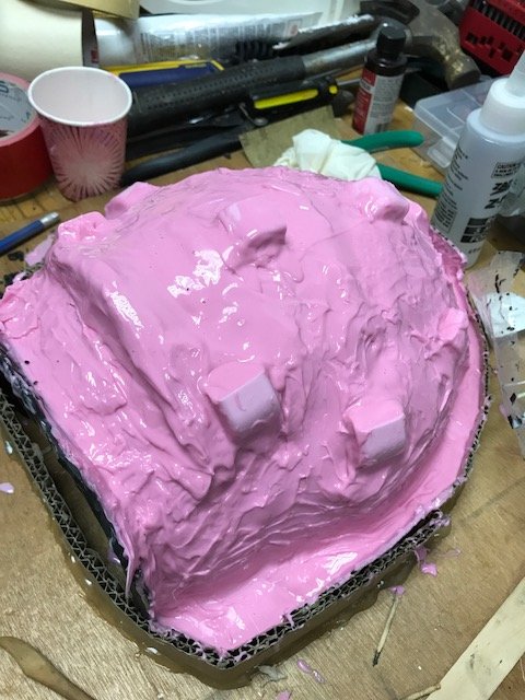

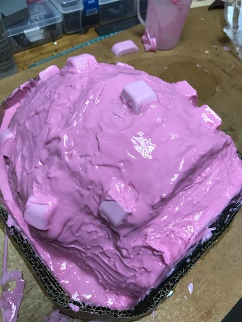

After several rounds of post processing and priming, the master is finally ready for mold making and casting.

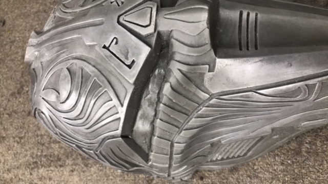

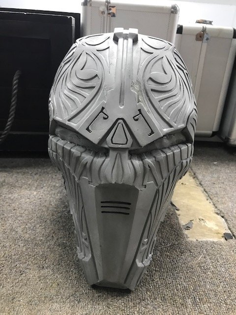

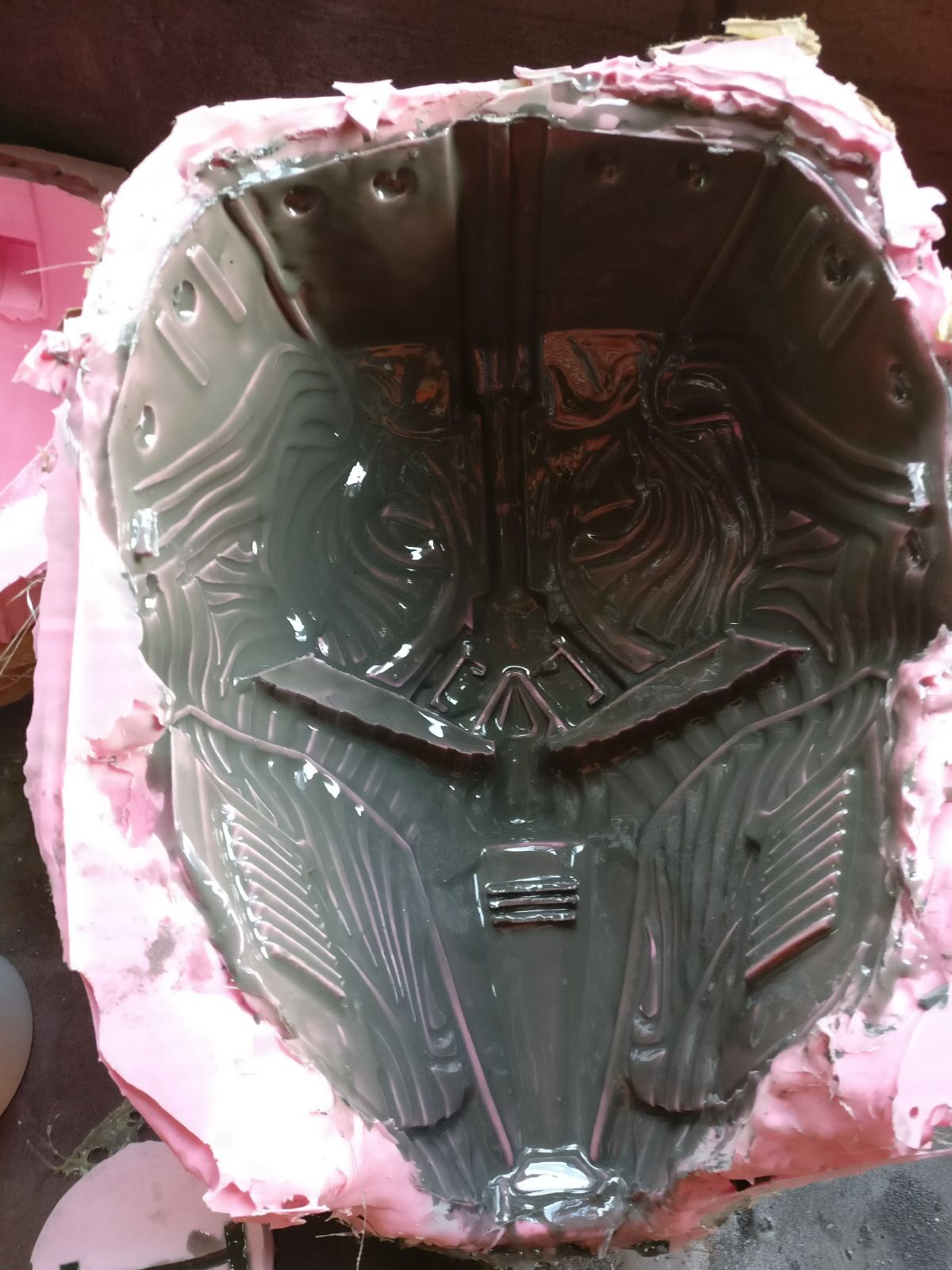

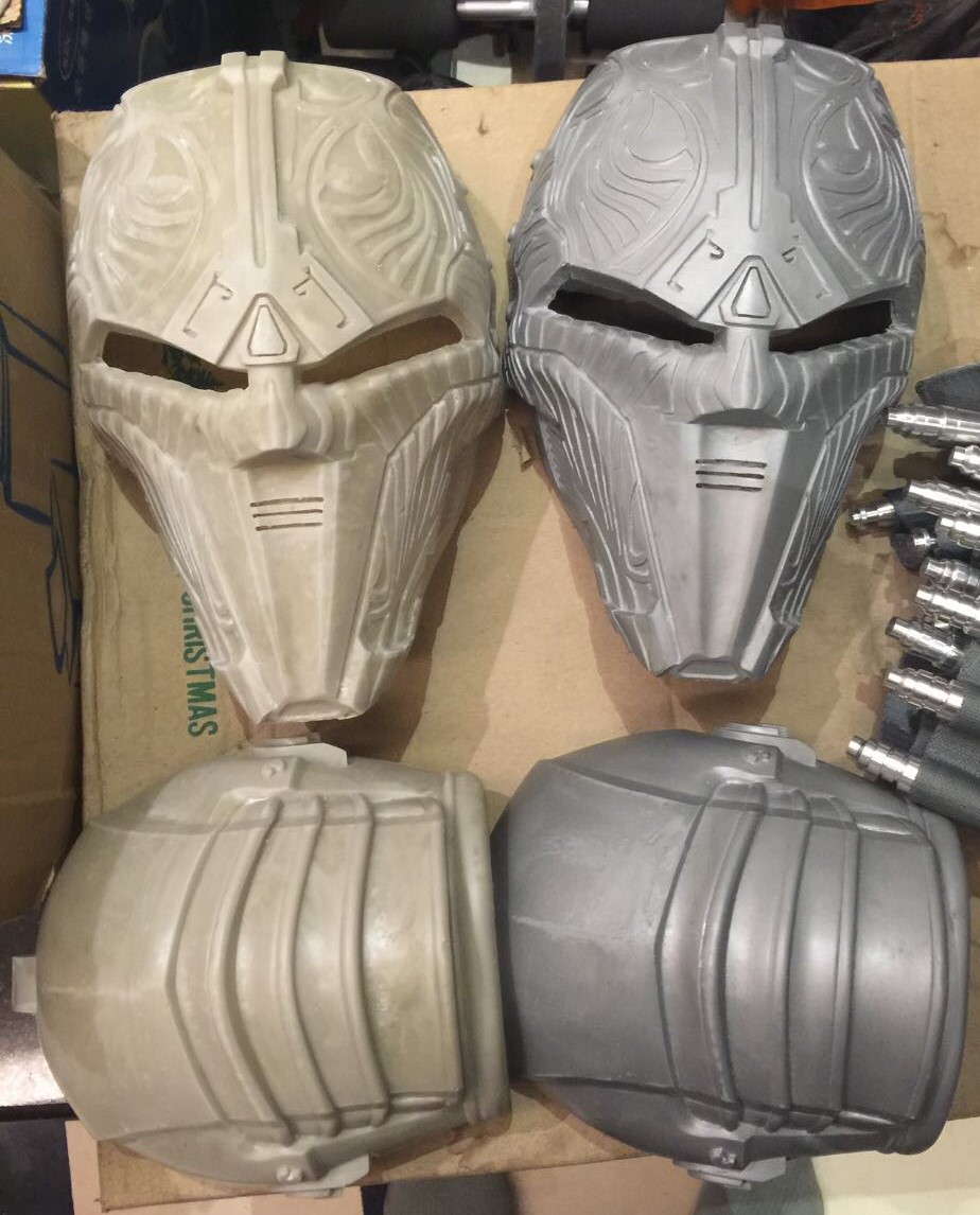

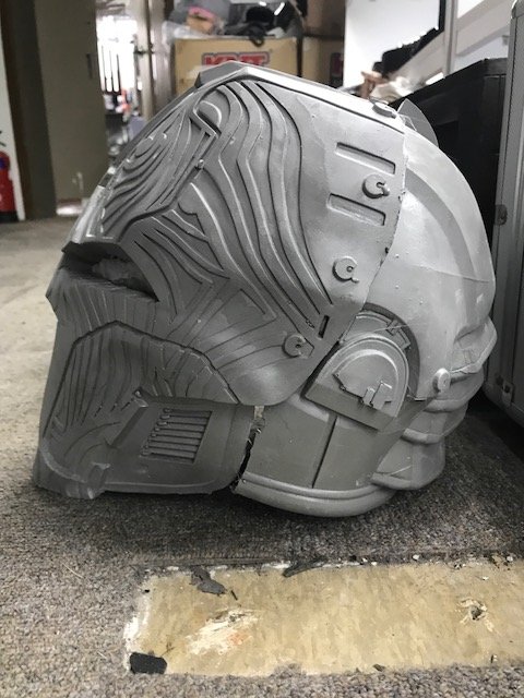

First test on cold cast pull.

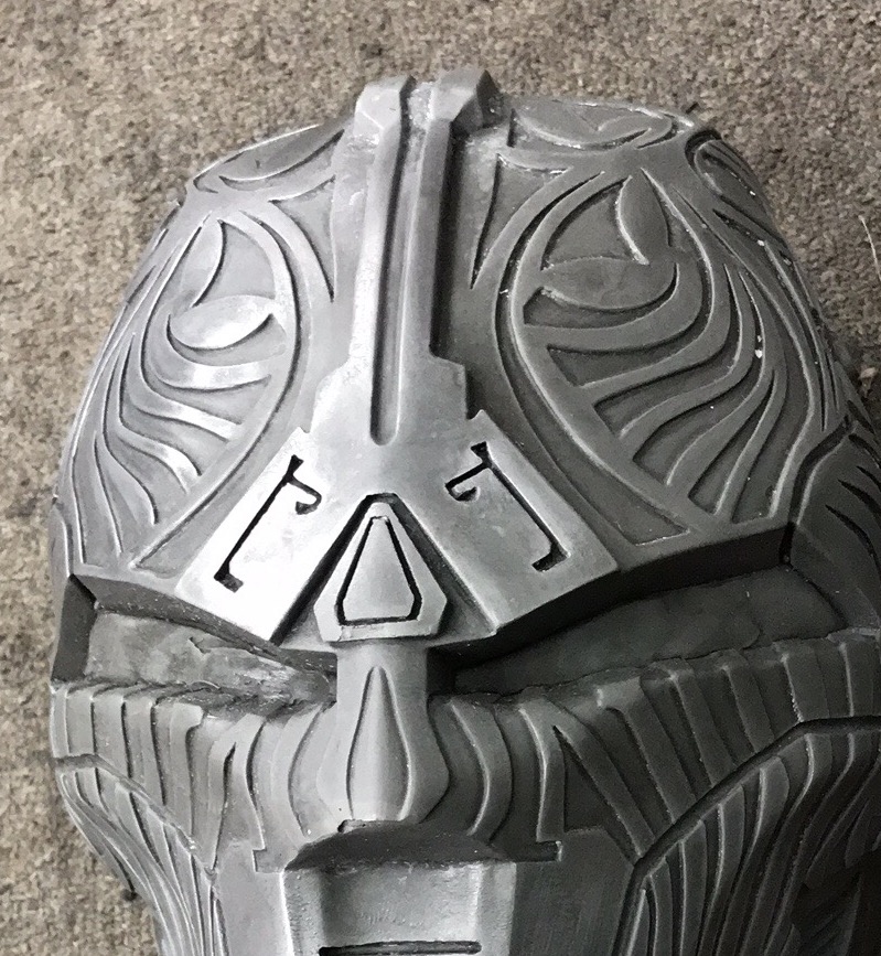

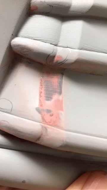

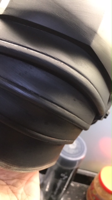

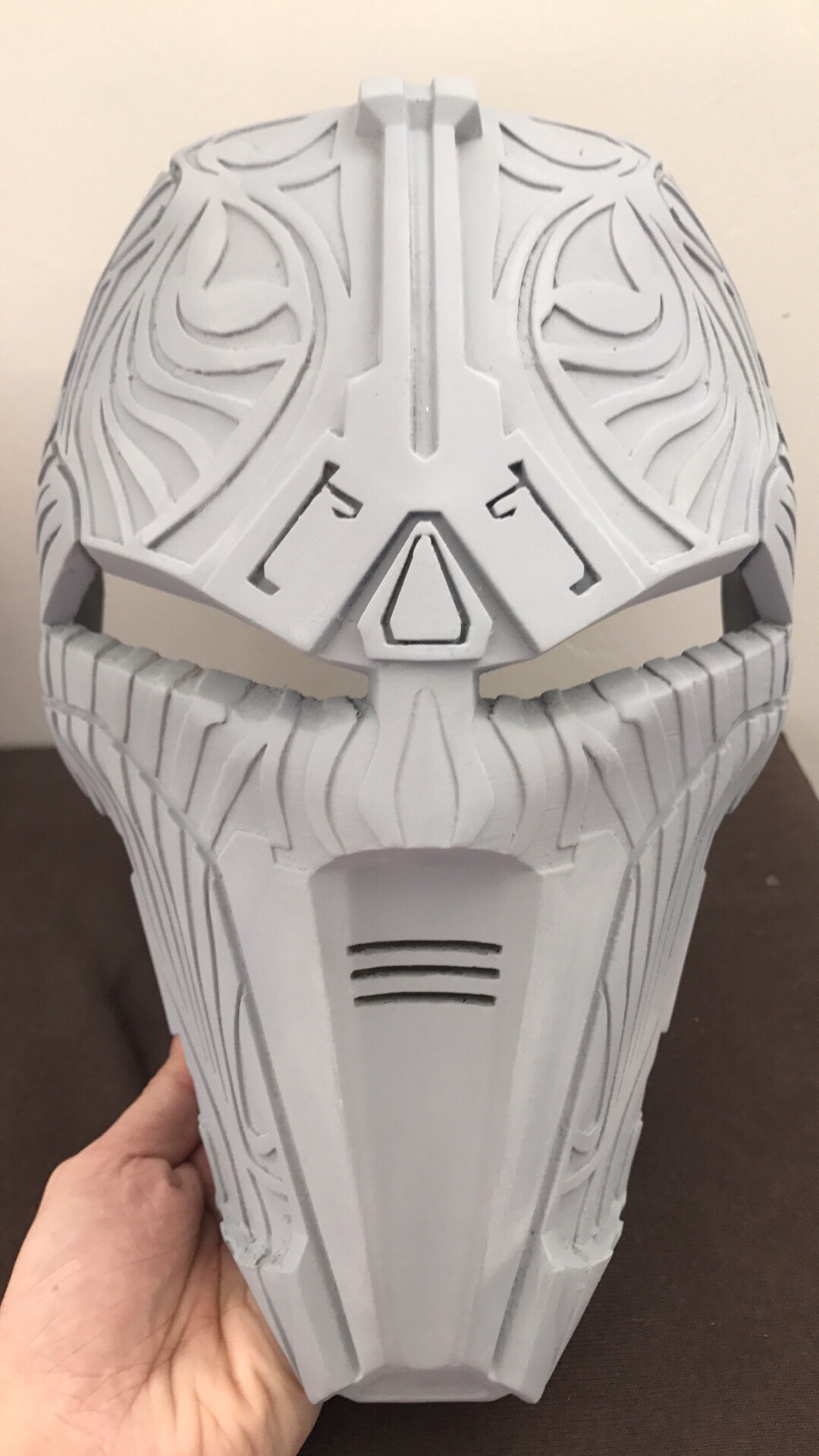

After some buffing with 00000 steel wool and test fitting.

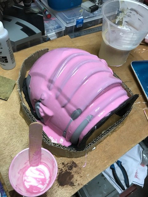

First mold gave way after a few pulls and made a new mold with normal resin and cold cast
