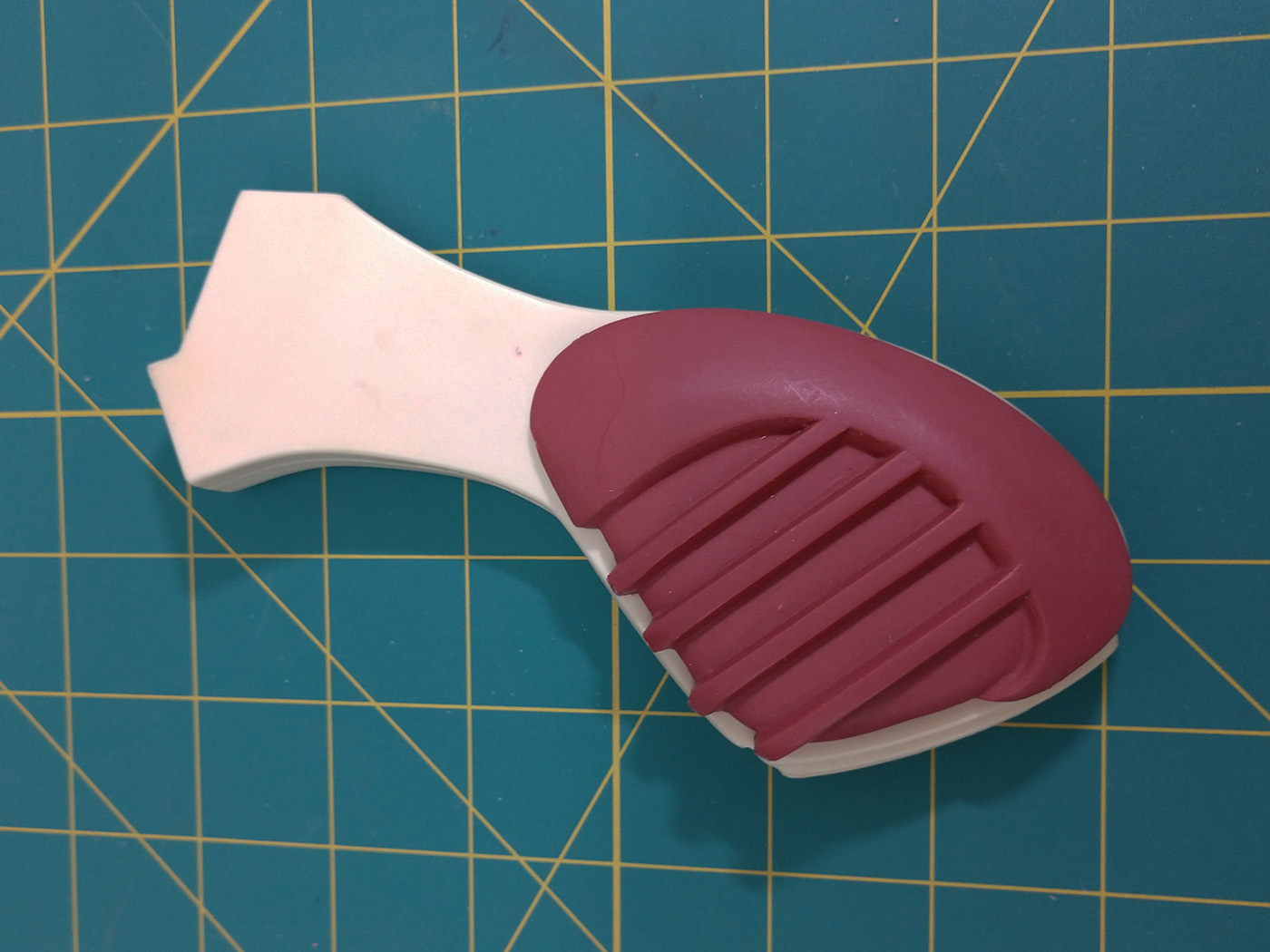

F franco358 Active Member Jul 13, 2018 #61 Thanks , these were just regular test castings , I'll pressure cast the next parts .
Sluis Van Shipyards Legendary Member RPF PREMIUM MEMBER Jul 13, 2018 #62 I've never done more than a two part mold. What was the reason that part needed a three part mold? I'm just curious.
F franco358 Active Member Jul 13, 2018 #63 I had a deep recess near the trigger area, that went almost to the back. Too big of an undercut . I wouldn't have been able to pull the part out of the mold.

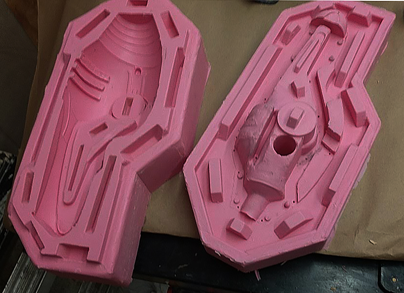

F franco358 Active Member Sep 16, 2018 #70 - - - Updated - - - Finally started the mold for the main body. Still more keying to do and Clay up work.

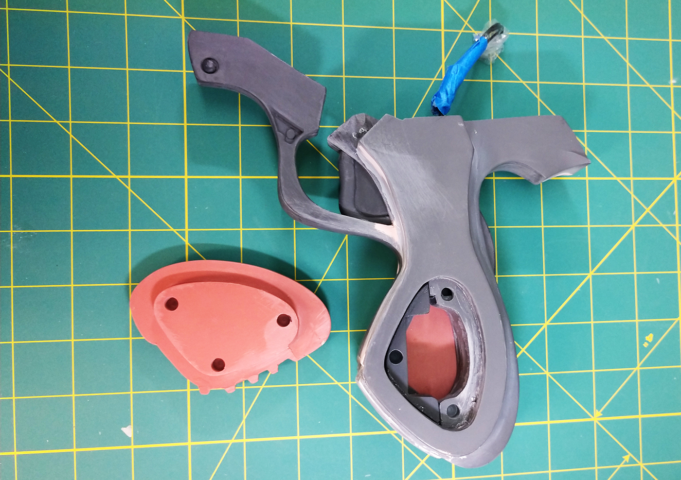

F franco358 Active Member Sep 28, 2018 #74 - - - Updated - - - A test fit of the parts , note the parts still have bleeder and pour spout stubs so the fit is just loose.
