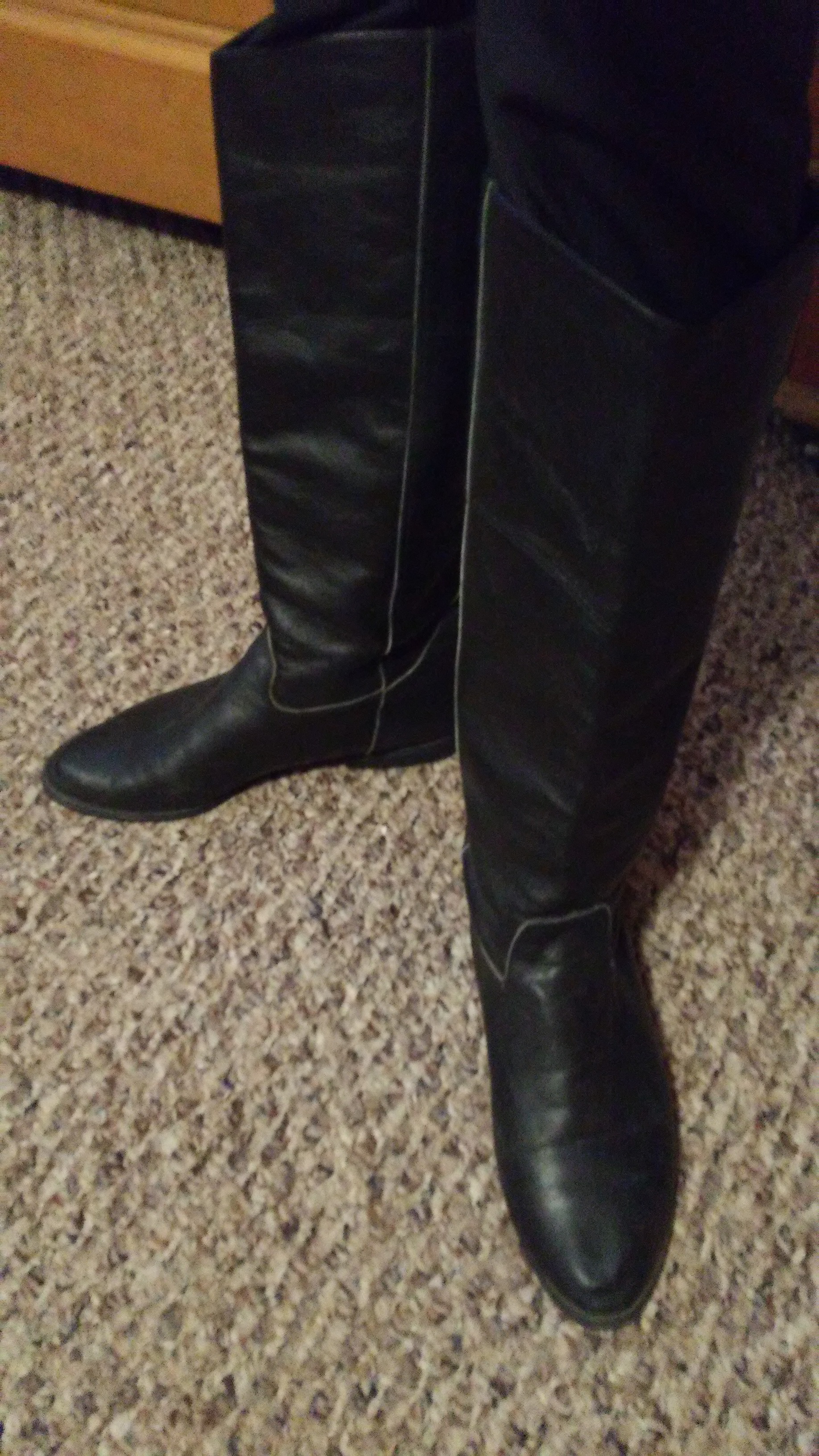

    BOOTS!
    As far as I can tell in the blurry dark screen shots, Sorsha's boots are practical for a warrior princess. Flat sole (Contrast to all the warrior women of modern movies who have to wear wedges?), black leather, knee high, pointed toe. They pretty much look exsactly like the Nockmarr solider above. Practical.
    It's almost impossible now days to find tall boots without zippers, so I ended up purchasing some 80's ridding boots and they work perfectly.

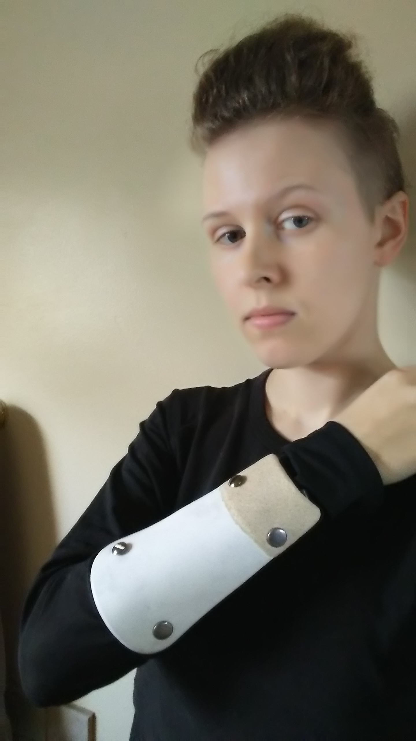

    BRACERS
    You never see enoough of her bracers to know anything except that she has them.

    I ended up using the last two pictures the most for references. It looks like she has half-shell hard bracers strapped on over leather full bracers. I have a better picture of her ridding off on her horse that shows the outline of the leather bracers, but it's the wrong file format to upload. (Sadness)
    It also looks like the part of her bracers more toward her hands might be slightly raised or lowered from the rest of her bracers? It looks like that in the second photo there.
    The straps for the bracers appear to be riveted on with four rivets, two on either side, toward the front and back as you can see in the bottom two pictures.

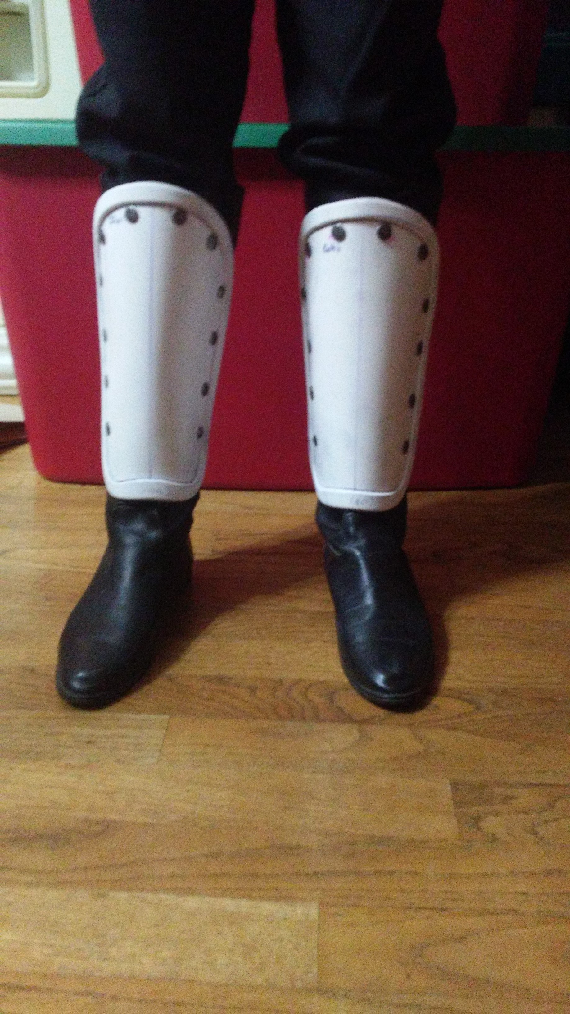

    I've opted to do a combination of leather and plastic for her chestplate. The breastplate itself I am using a modified fencing protector covered in Terraflex, and the straps are leather which will be painted to look metal. I plan to cinch this whole plate like a corset in the back, so it's form fitting and comfortable (relatively), and I'm honestly baffled about how else to make it close. Metal straps would be too uncomfortable for a full day of wearing, plus leather will at least have a little give it.
    MINE.
    Leather Bracers: I used 3 oz tooling leather for these, dyed USMC Black, which I'll use for all the leather. They've been wet shaped to fit my arms (I have a "arm dummy") and the edges have been rolled for comfort. I decided to tool a little something into them before hand just to give the kit a little more detail. I came up with a simple design based of General Kael's chest circle-doo-thing, which you can kind of see in the last photo. They lace up the outside of the arm so the lacing is hidden under the metal bracer. Also, ick, the bracer in the last picture is the one I tried a new technique for shaping the wet leather that a friend had recommend to me and it did not turn out, so the edges look blch. I swear I'm better at this leather stuff then that!!
    "Metal" Bracers: I work almost exclusively with Sintra, Terralex and Kydex, so most of the armor you see here is going to be a combination of those three. The basic shape I drew out while staring at the reference photos, and then transferred from paper to craft foam to see how it worked out. The craft foam curves similarly to sintra, so I usually do templates out of it first. Then I traced, cut and sanded the 3mm sitnra before shaping it with a heat gun. I added a little later of Terraflex (the tan part that looks like warbla) to the front for kicks since her bracers looked raised there.... Then I attached my leather straps with rivets on one side and Chicago screws on the other (so I can actually get them on and off). They're surprisingly comfortable. I may or may not have worn them all day...

    Here's where I ended up with the chestplate strap things. It took me 3 tries to get to a point I was happy with them, and that's mostly why I've been silent. They're kind of key points to the costume and there was a lot of measuring, frustration and not-working-correctly going into them, but I think I'm finally happy! They'll eventually end up weathered steel color like the chestplate itself, don't worry! We're going to give everything a black base coat to start with anyway before painting becasue she's so dark.
    I've picked up the stuff to do the straps and padding on the shoulders of the chestplate as well, so I'll be working on that as soon as I get done adding her cod plate to the bottom of it, which is where I am now.

    Anyhow. That's been most of my past week. I did get my boots - Vintage 1980's ridding boots - I still think it's funny calling them "vintage" becasue common it wasn't that long ago!! But they fit great and are pretty much perfect for what I need --
    Click image for larger version.

    Alright, where were we? Ok, so I did up the shin plates.
ID:	786251Click image for larger version.
    They're 3mm sintra base with another later of sintra around the edges, strapped on with leather straps. And of course the pretty rivets.
