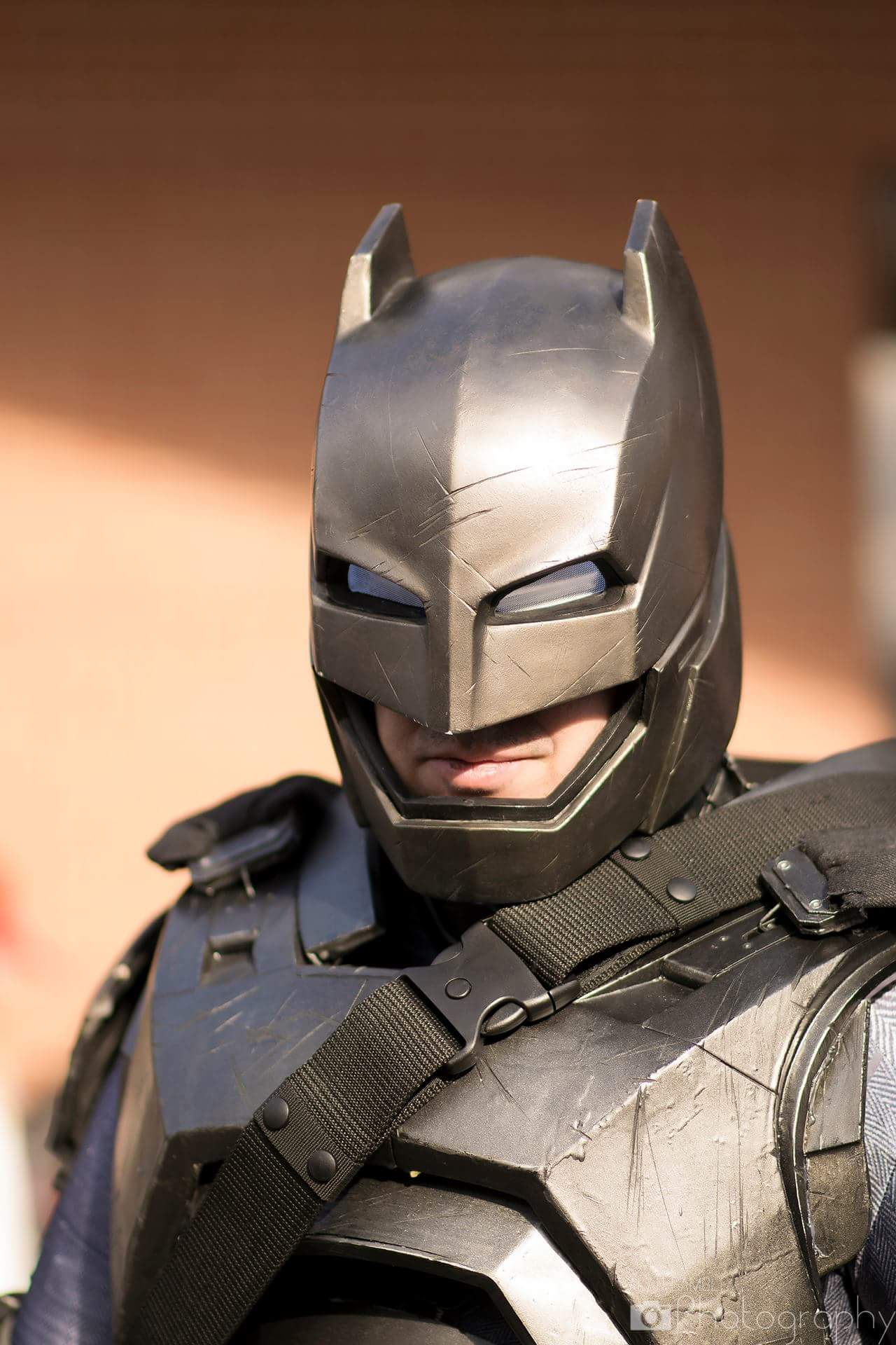

I concur the EVA foam might be the easiest option - the are programs like Armoursmith Designer and Pepakura Designer that will allow you to convert 3d OBJ files into patterns. If you are wanting a glossy finish on your EVA foam there is a product called Flexi Paint (search for their FB page or web site). As its name suggests this paint is incredibly flexible and doesn't seem to crease or crack. I have attached a pic of my Lego Batman costume - while the head is 3d printed in ABS plastic and finished with high gloss paint, the body, arms and legs are made fron EVA foam and finished in black Flexi Paint.
By way of comparison I have also attached a pic of my DOJ Armoured Batman suit - this suit was fully 3d printed in ABS plastic and finished in a Rustoleum rattle can ( Flat Soft Iron).
Hope this helps
