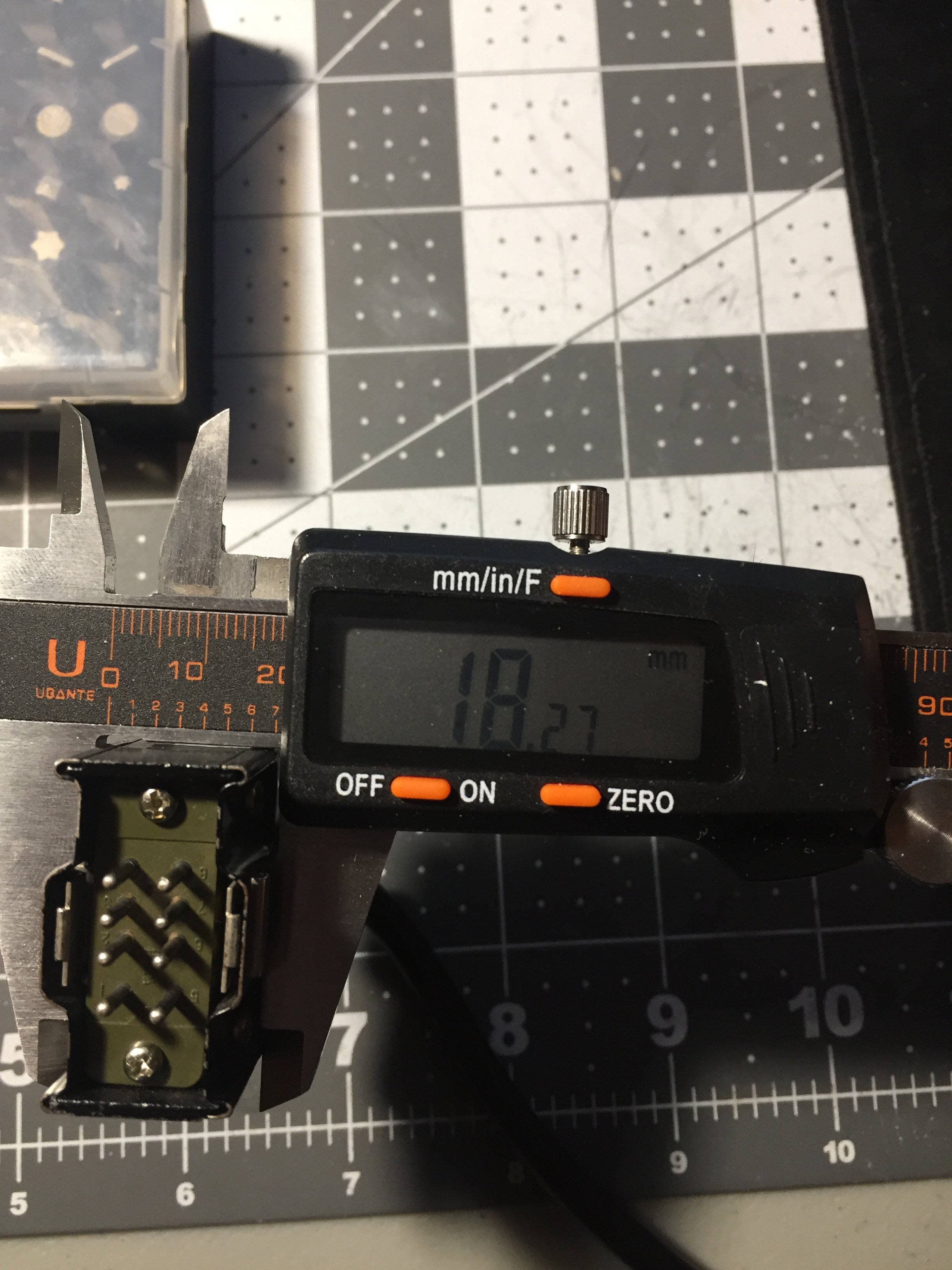

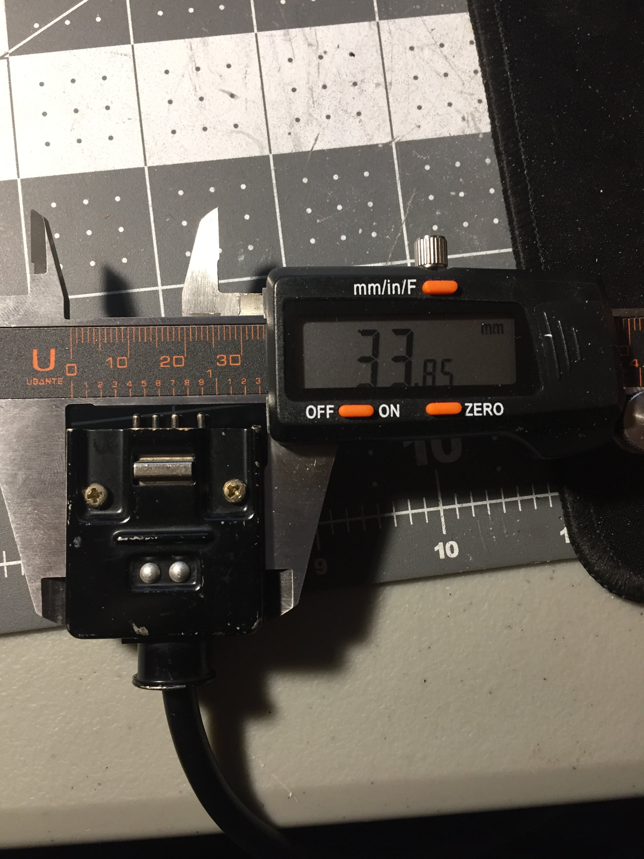

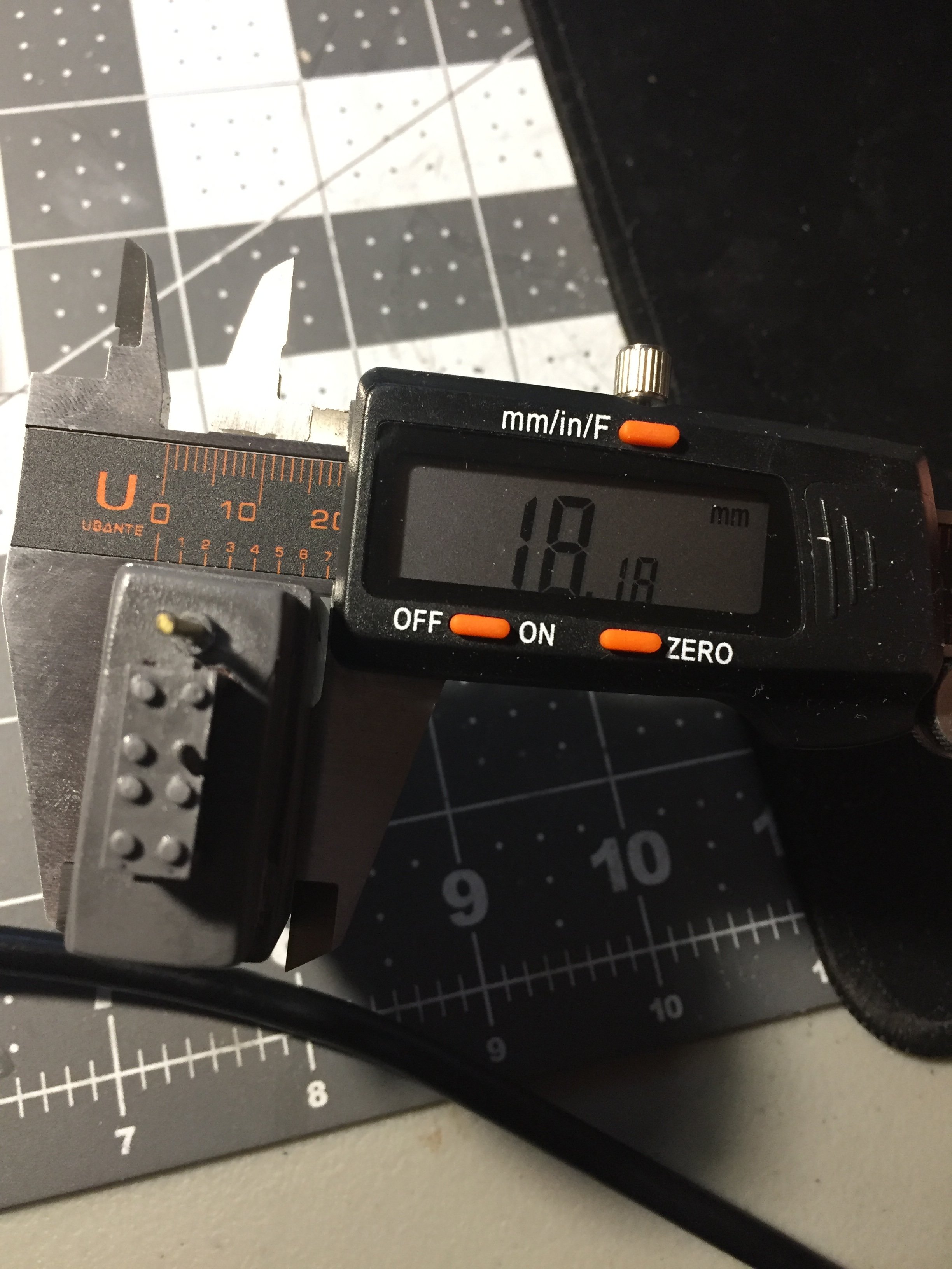

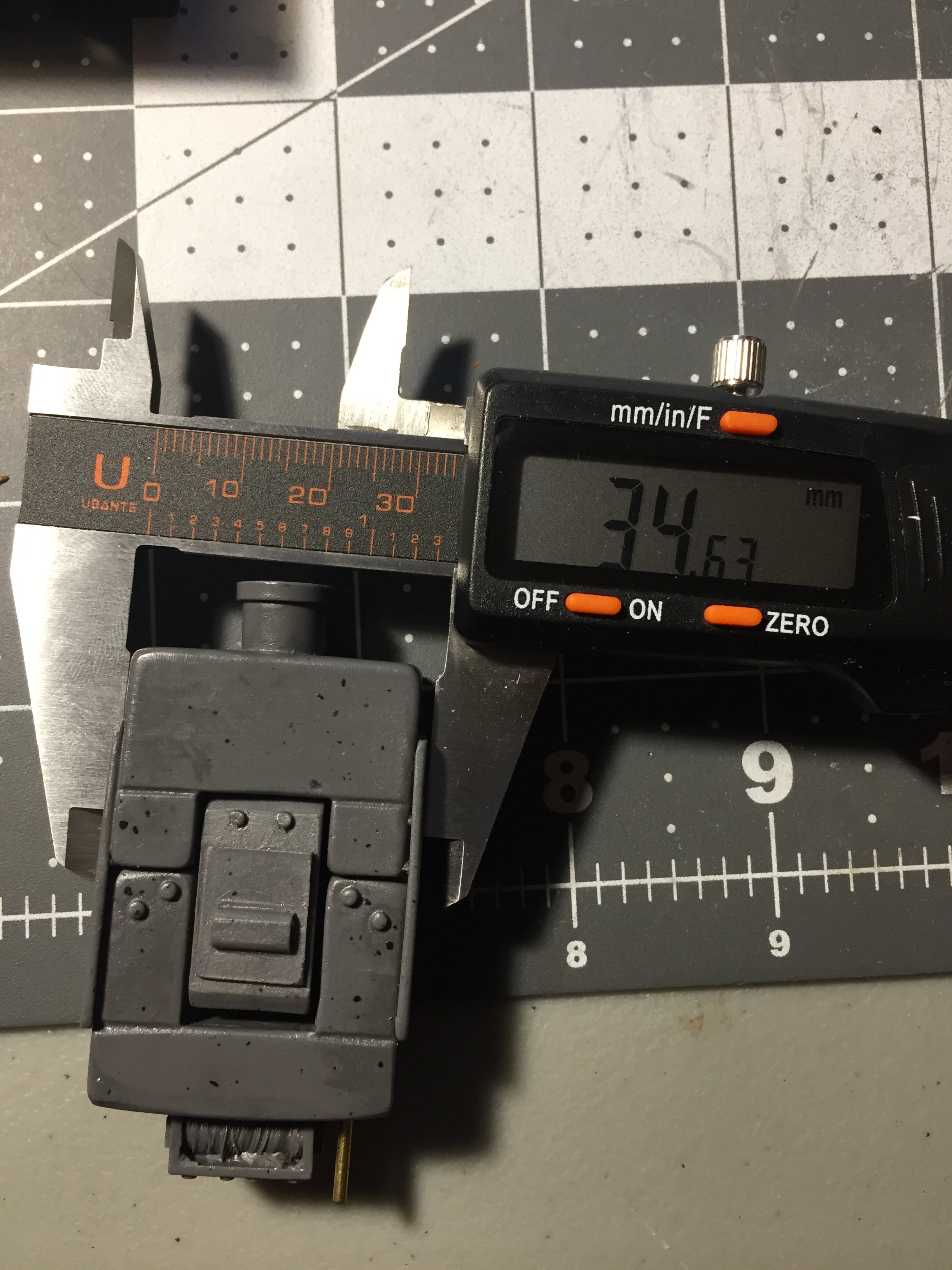

idk if the old stock ( long tab) measures different than the new stock (short tab) but using troopers resin box as a reference my box is very close size wise to cast box.IMG_9626.JPGIMG_9627.JPGIMG_9625.JPGIMG_9624.JPG

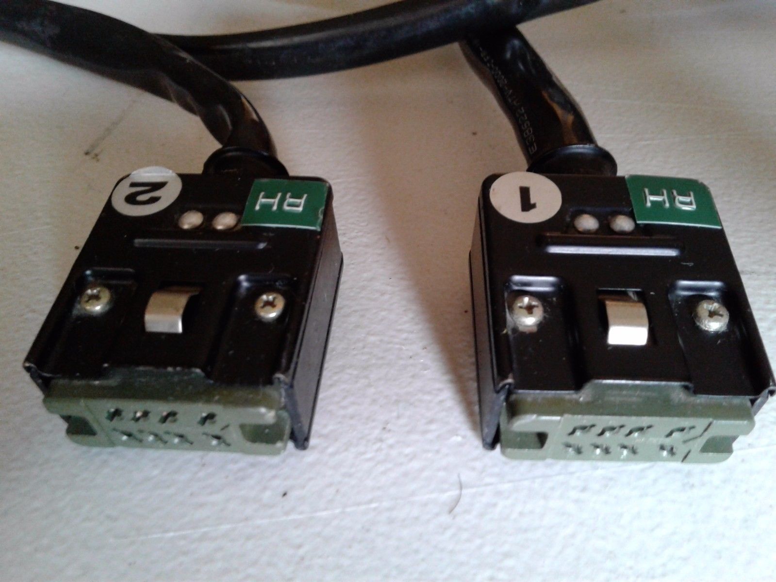

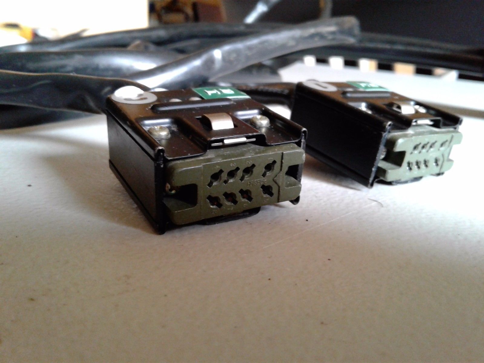

Here's two pics of a pair of female boxes I have on the way just to have on hand for comparison....
Did they take a female connector like this apart and turn it around and put into a male connector??? Need to see what the other side of the female plug looks like, that's one reason I bought them.

When I get them, I'll take one apart and post a picture of what the back side of the green plug-in looks like. I'm wondering if it has the 8 small prongs sticking out that the wires clip to similar to the Ibanez female port.

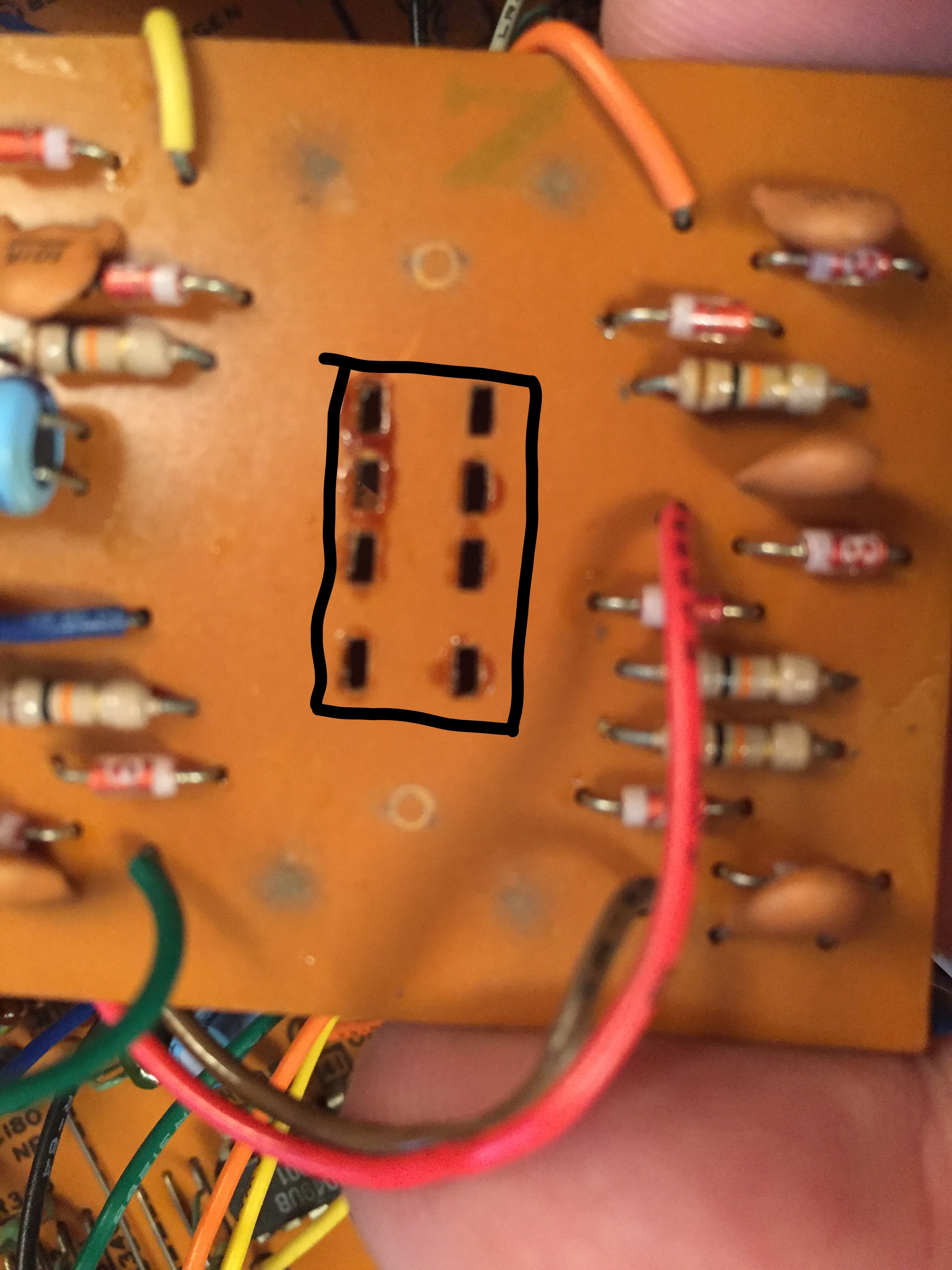

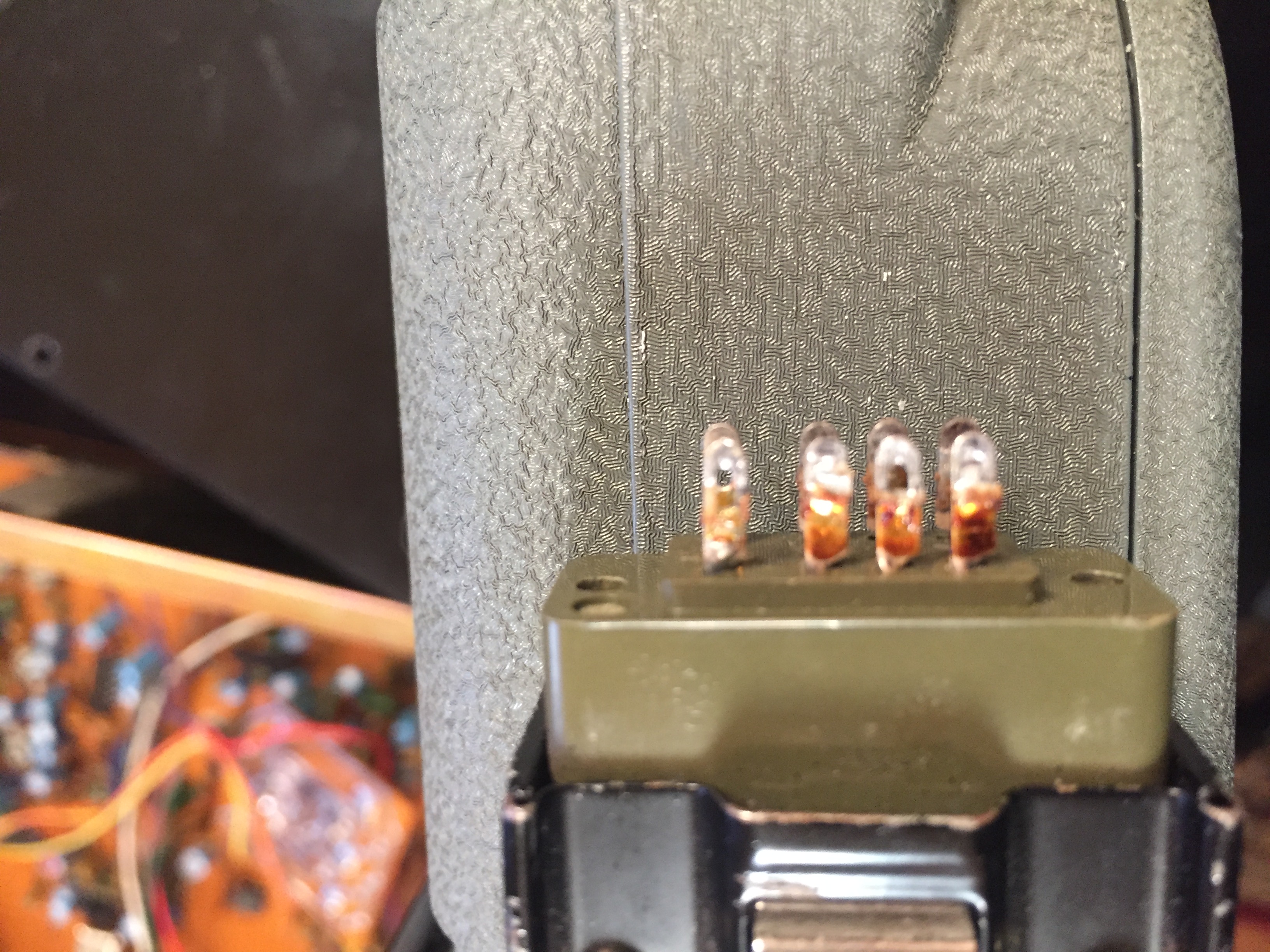

Think this is it guys! it's not copper wire. I unsoldered the female plug from the board. my board was orange like many boards of the time ( my exactra 20 board was orange also) I used solder wick to get most of it off but then had to use a heat gun to get all 8 pins hot at once. In doing so some of the orange board melted a tiny bit and was left behind on the pins. Looks right and makes sense. Now all there is left to do is cut out the board around the 8 pin holes and paint it black.
Now this is off the ue400 right?
It sure likes right. Just need the board on it
