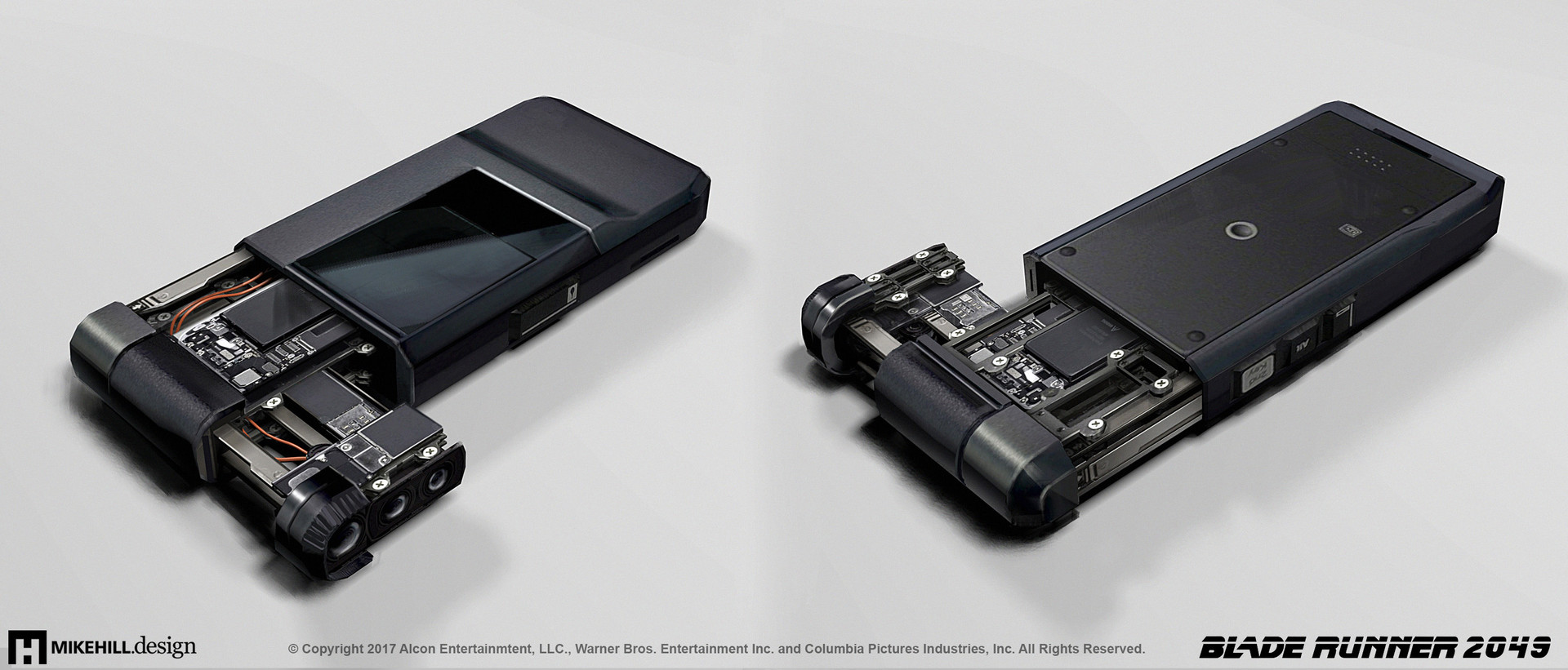

Thought you might find this concept art interesting.
I happen to think that design is way more interesting than what they ended up using in the film. That said, the added complexity of two pop-out elements is probably more than enough of an explanation as to why they went with a much simpler design. I'll probably still steal the button labels from the concept, though ("Alt", etc).
