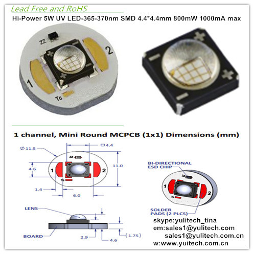

It's also common for high-power surface mount LED packages to have 4 or 6 solder pads, allowing multiple connections for the cathode and anode to allow enough current flow, e.g:
Those wires are pretty thin - I could see them doubling them up to get the current to get an LED bright enough for the camera with on-set lighting..
It's just a thought as I's seen that purple/red tint come up before when blue LEDs have been photographed.
That's pretty neat! I would have honestly assumed the additional solder pads would be more for the purpose of chaining them in parallel, rather than anything pertaining to current.
