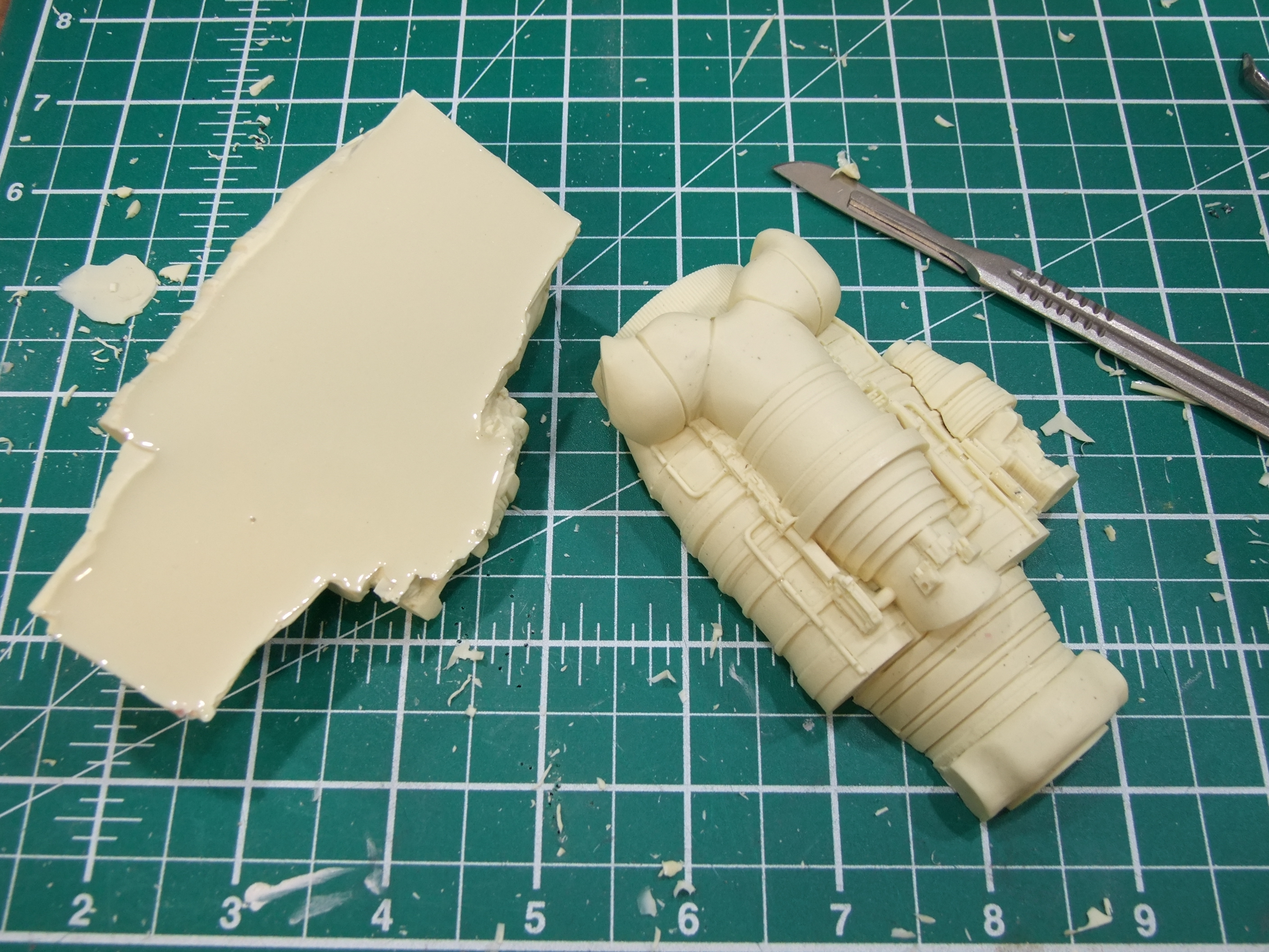

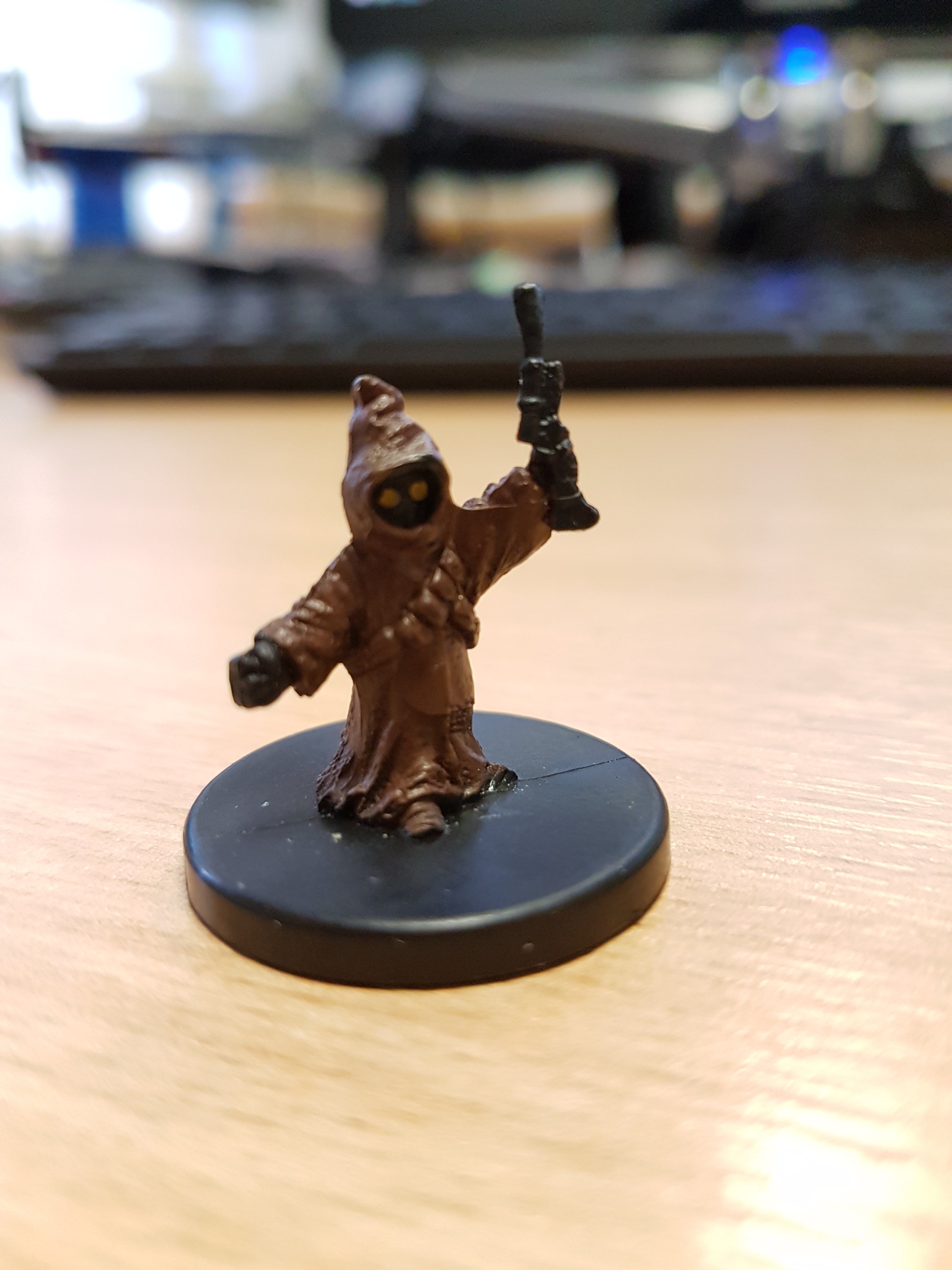

    Oct 13, 2017, 4:18 AM - Jawa SAND CRAWLER - 1/96 Randy Cooper Resin Model #1

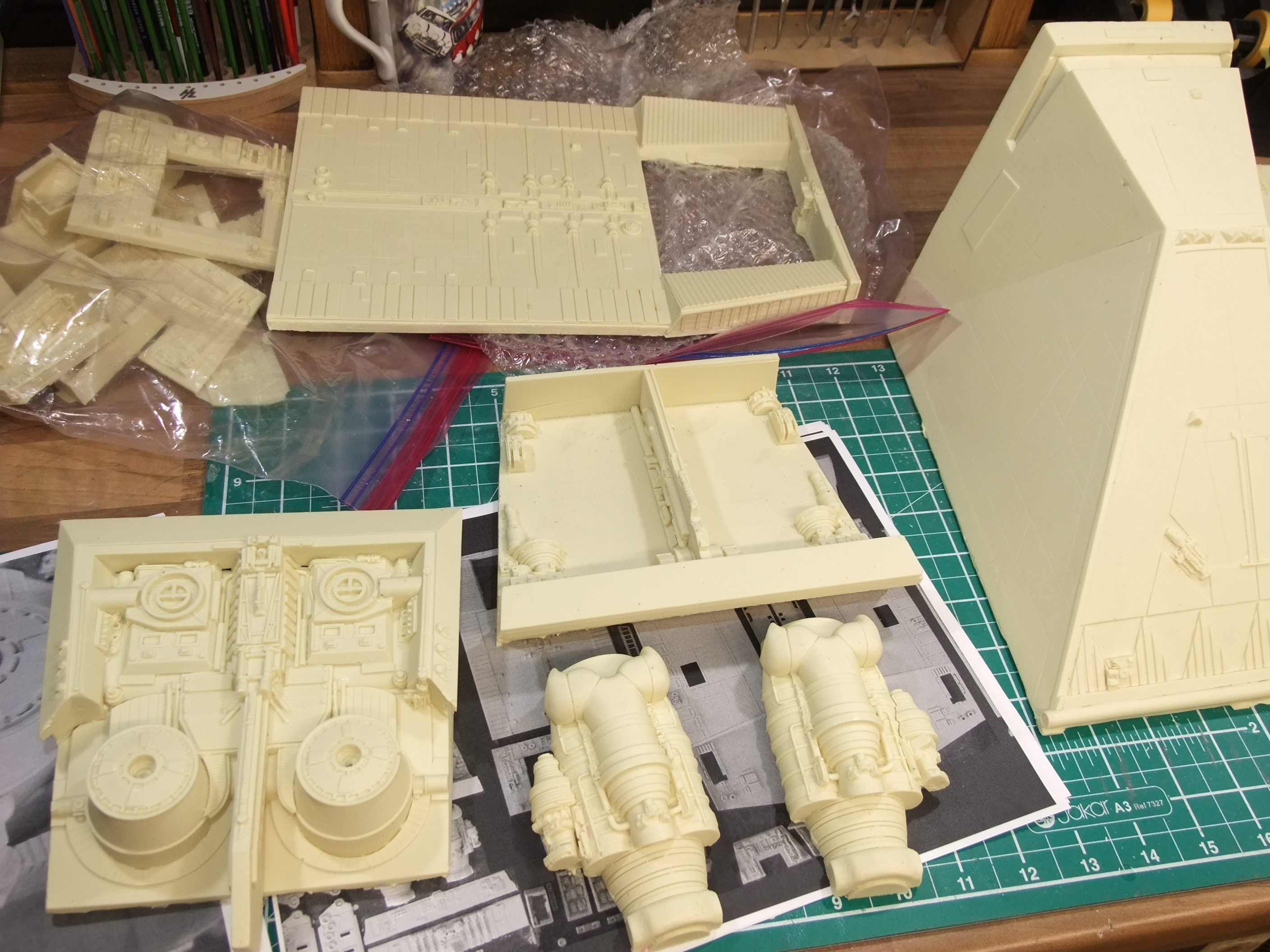

    With the Randy Cooper Star Destroyer model now completed, I have started work on his Sand Crawler which I believe to be about 1/96 scale. I'm just at the very earliest tidy up stages but are immediately enjoying the build and feel really charged up and ready for the massive resin journey ahead of me.
    OOOODEEENIE !

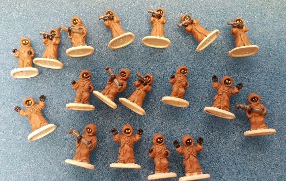

    Oct 13, 2017, 10:32 AM - Re: Jawa SAND CRAWLER - 1/96 Randy Cooper Resin Model #2
    Cool, I have been eyeing one of these since it is about as lose to 1/72 as we would probably ever see
    Is one of the micromachines Jawa figures?
    Those (and other micromachines figures) should be be good enough to display around it since they tend to hover around 1/76 to 1/87

    Hi Blake H1
    Thanks for the words - the Jawa is part of the West End Games 25mm Star Wars ANH sets from 1989. I have some micro machines figures too, these work well
    regards - JOhn

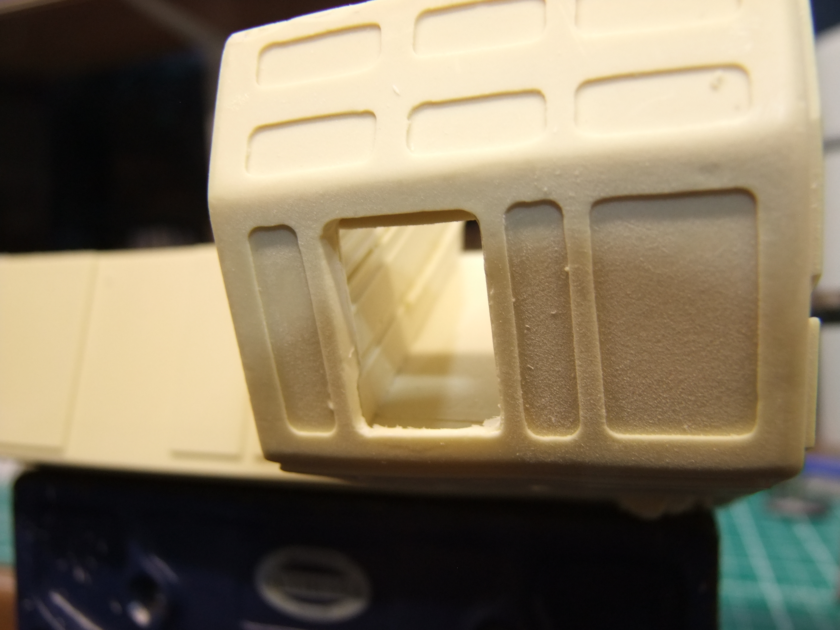

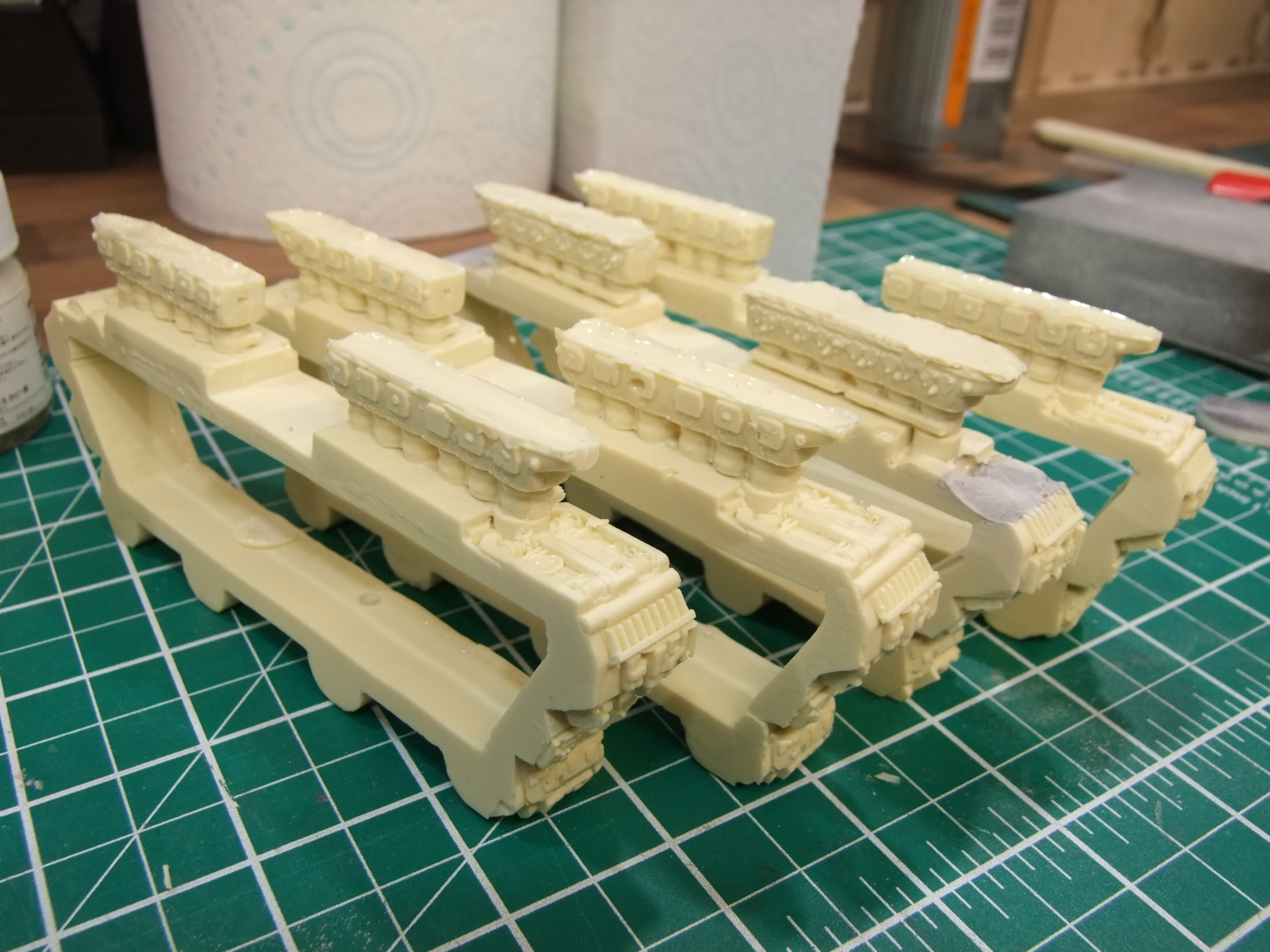

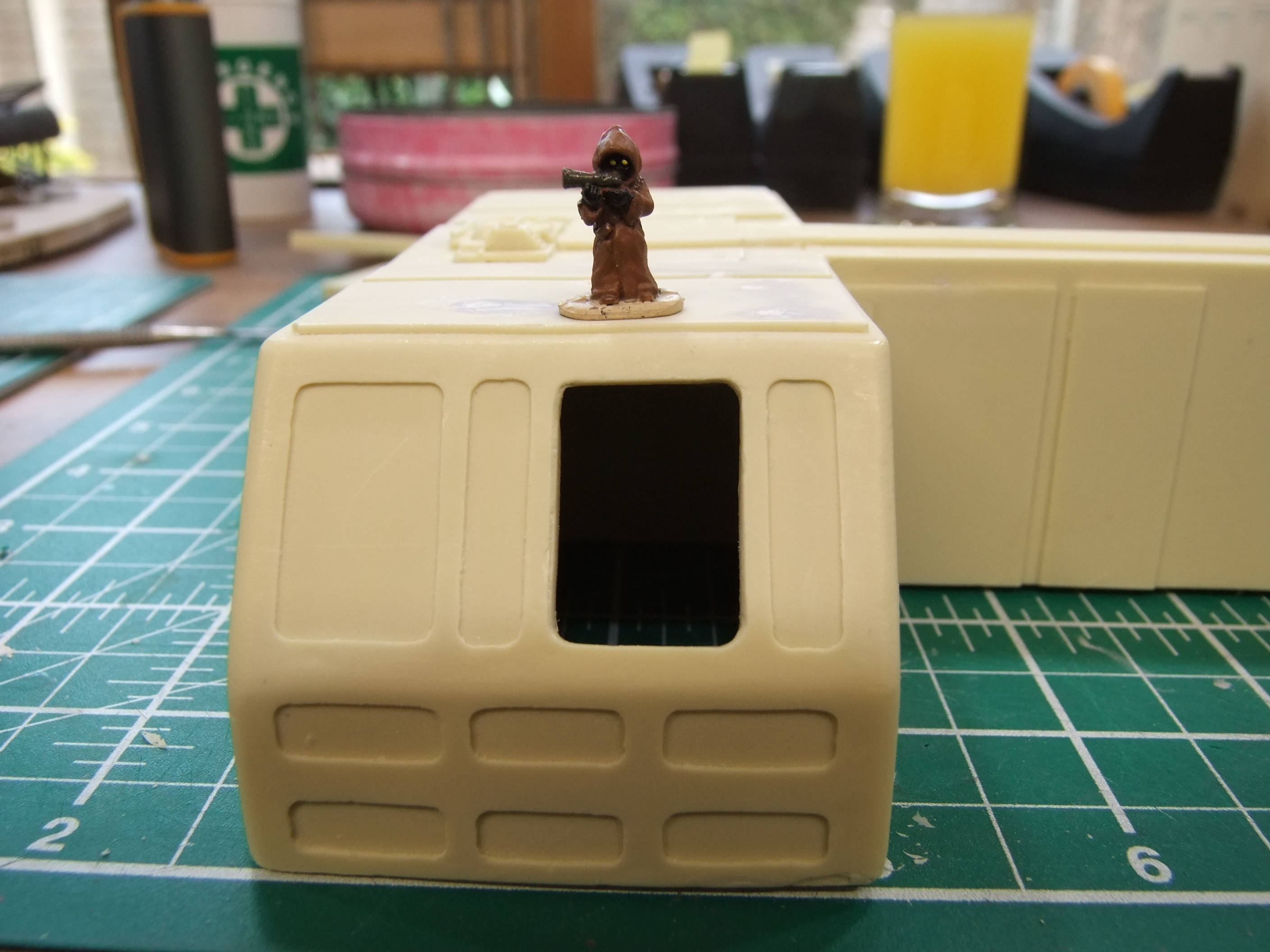

    Oct 19, 2017, 11:02 AM - Re: Jawa SAND CRAWLER - 1/96 Randy Cooper Resin Model #7

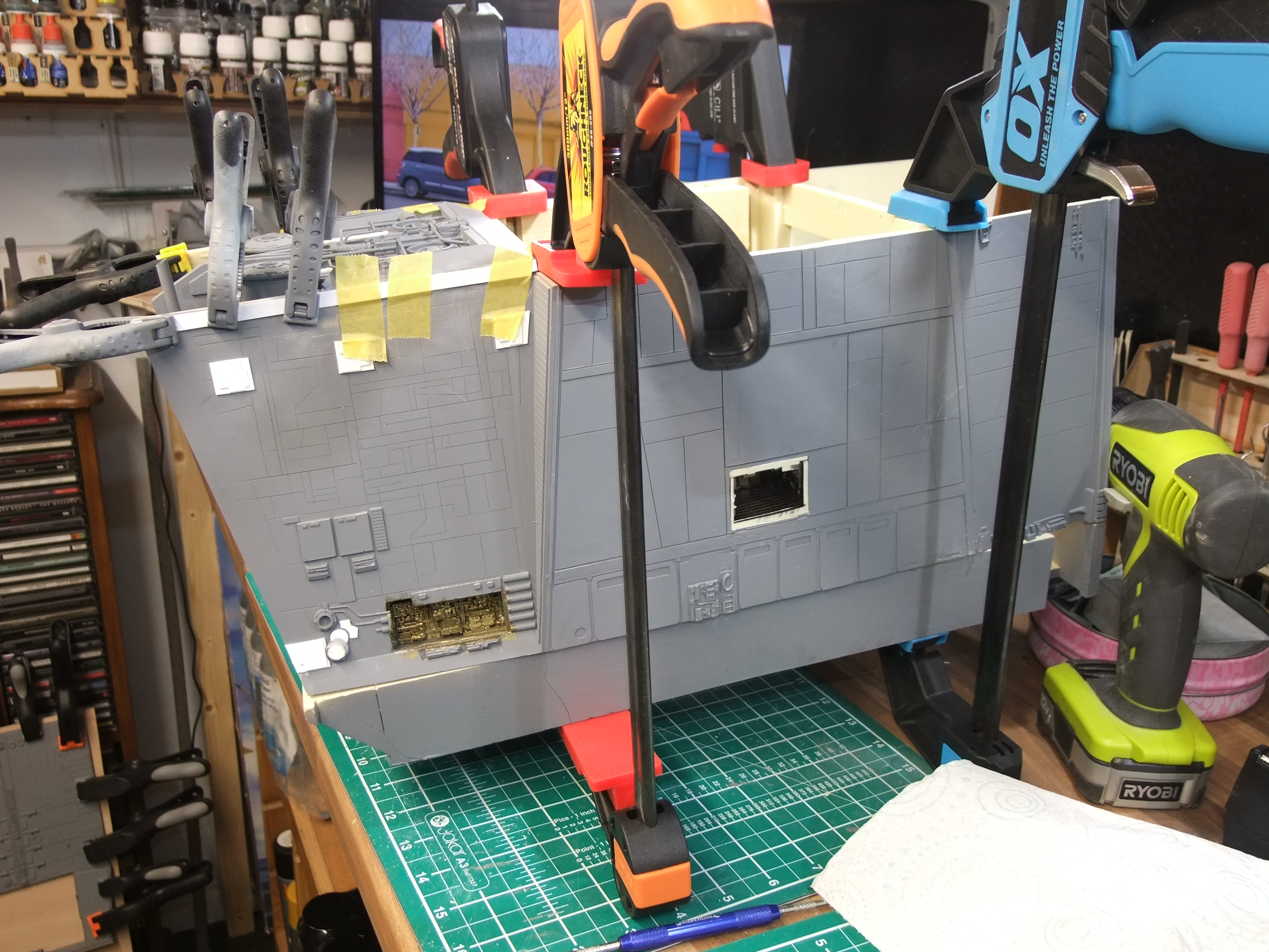

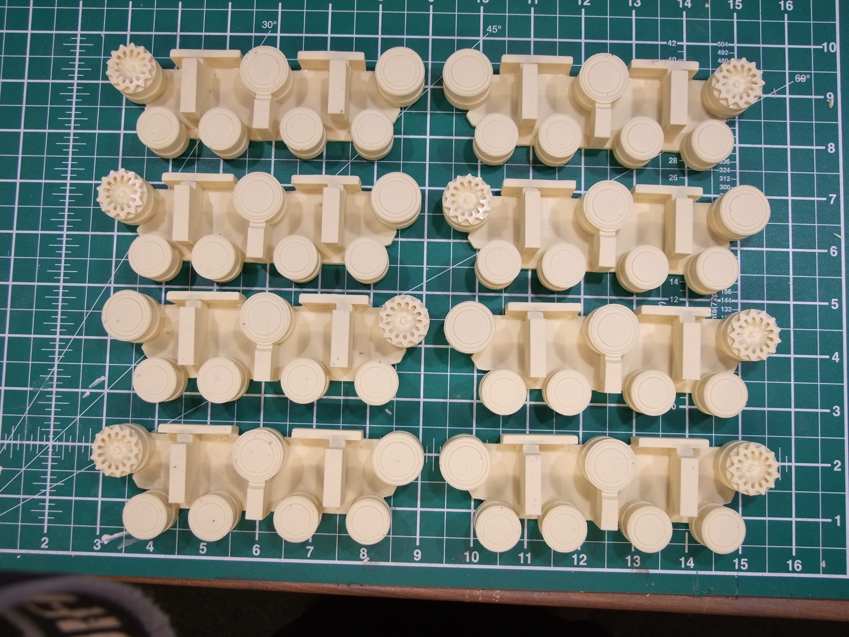

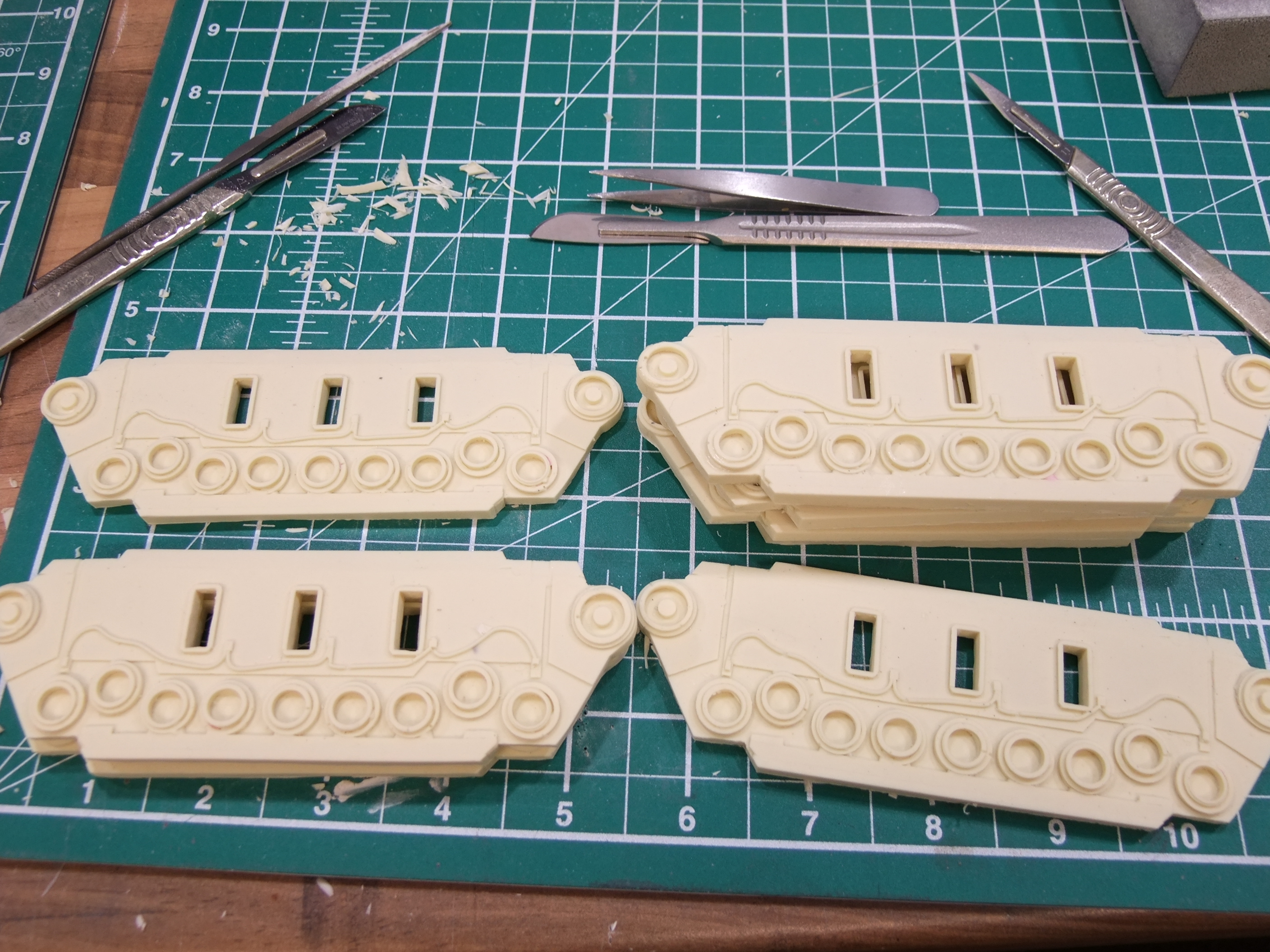

    A good few hours spent tidying up the wheels and bogies, and I have a family of little 12mm high brown smelly desert rats to add to the finished diorama now...

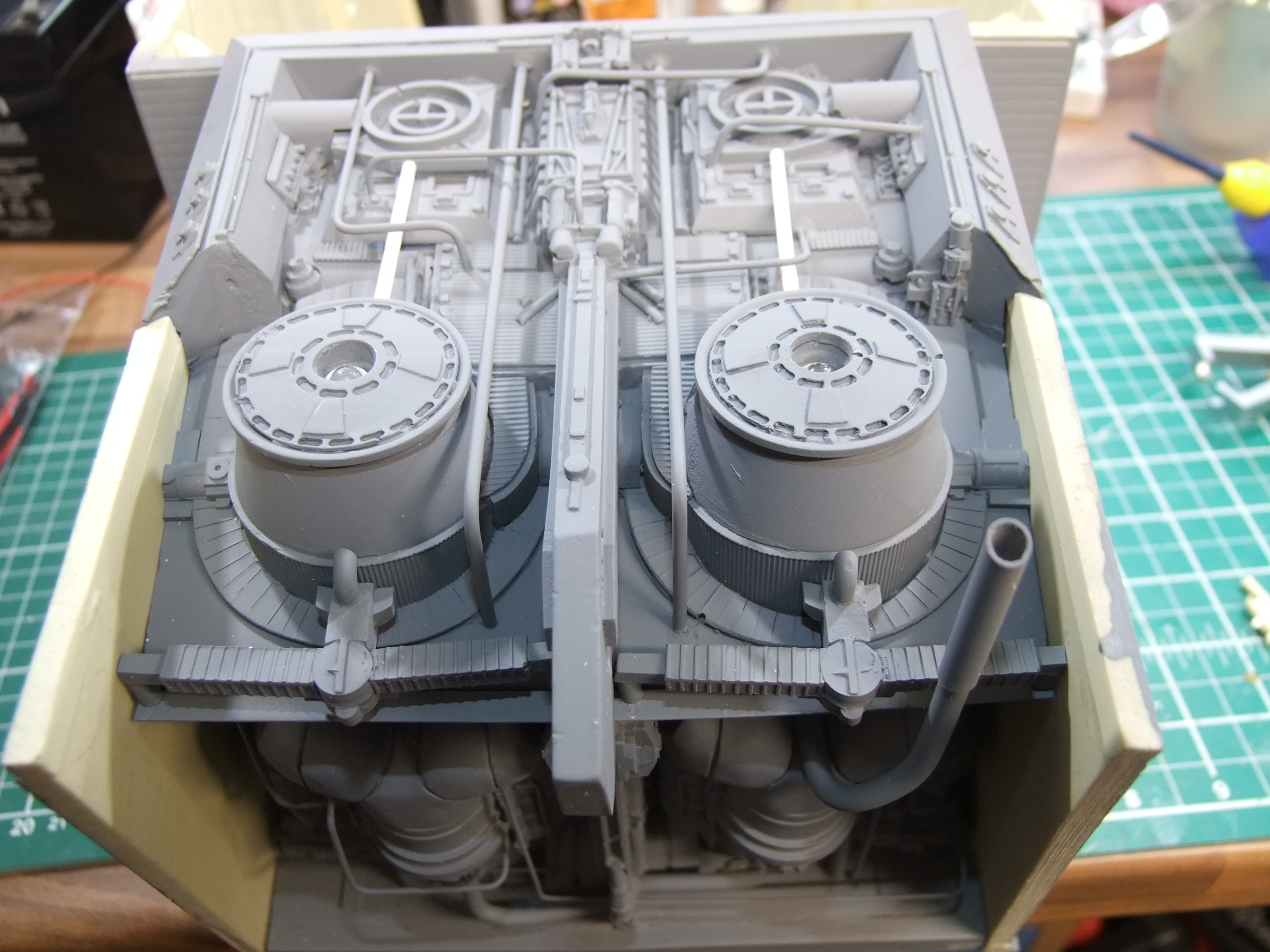

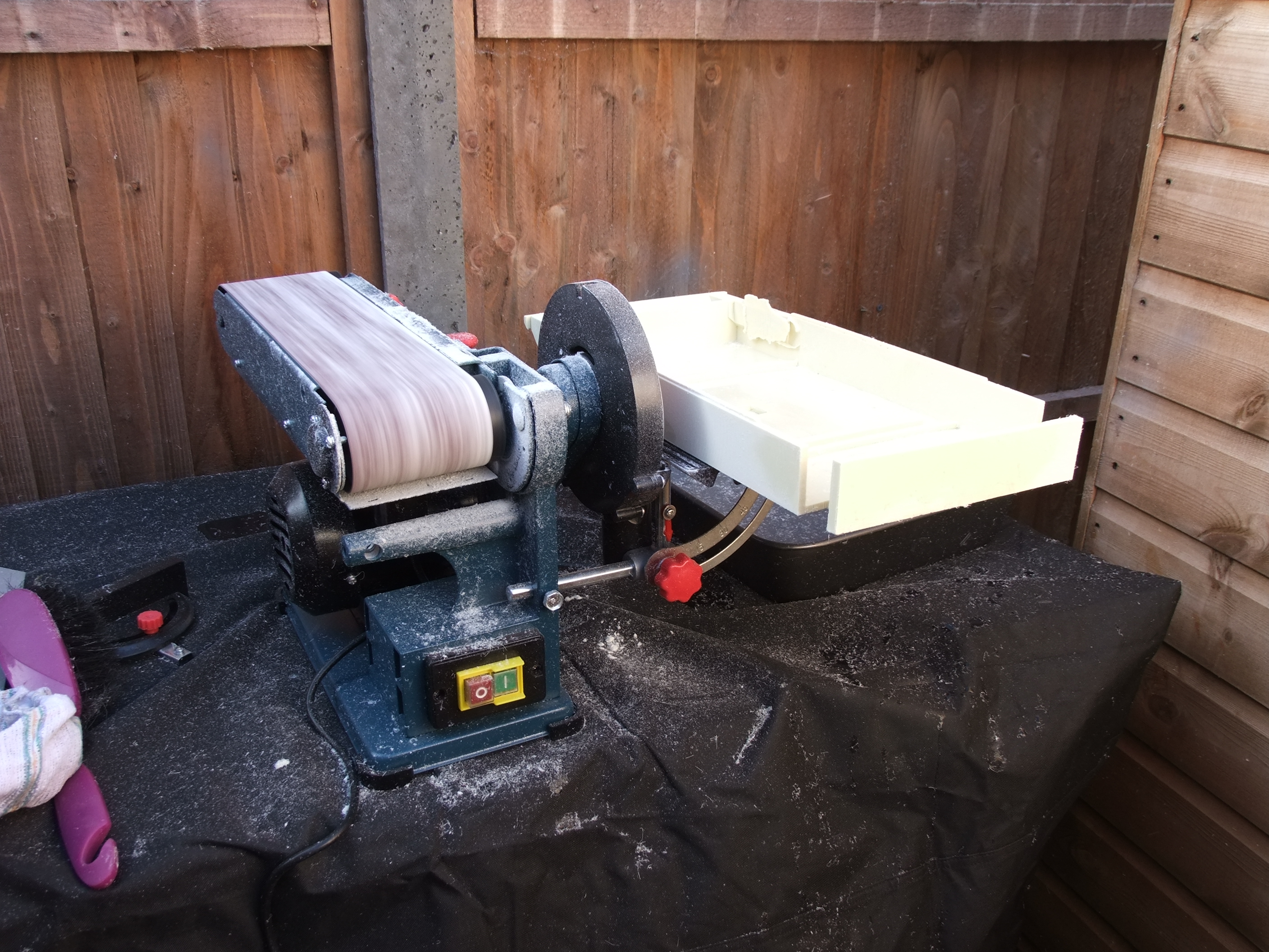

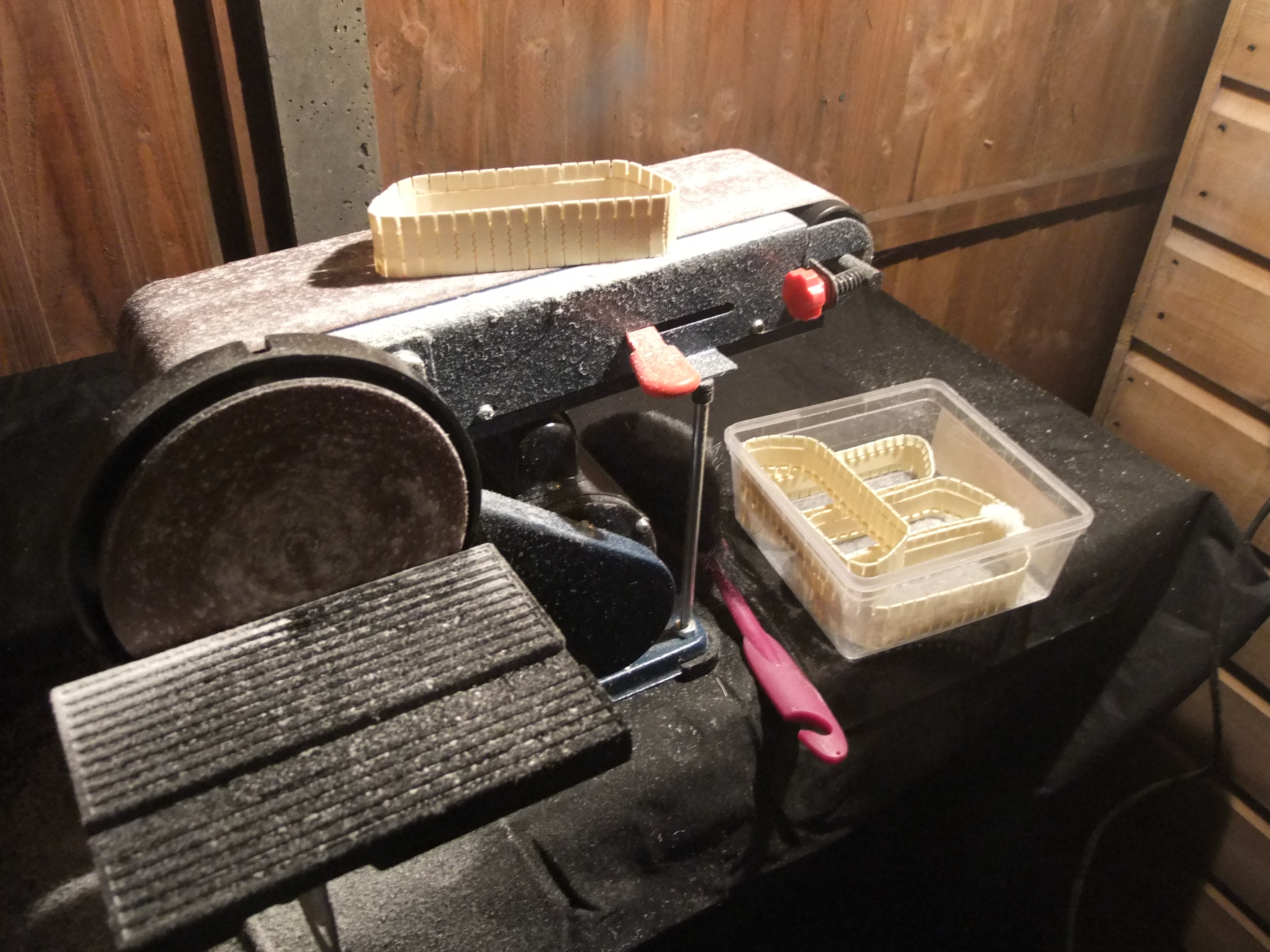

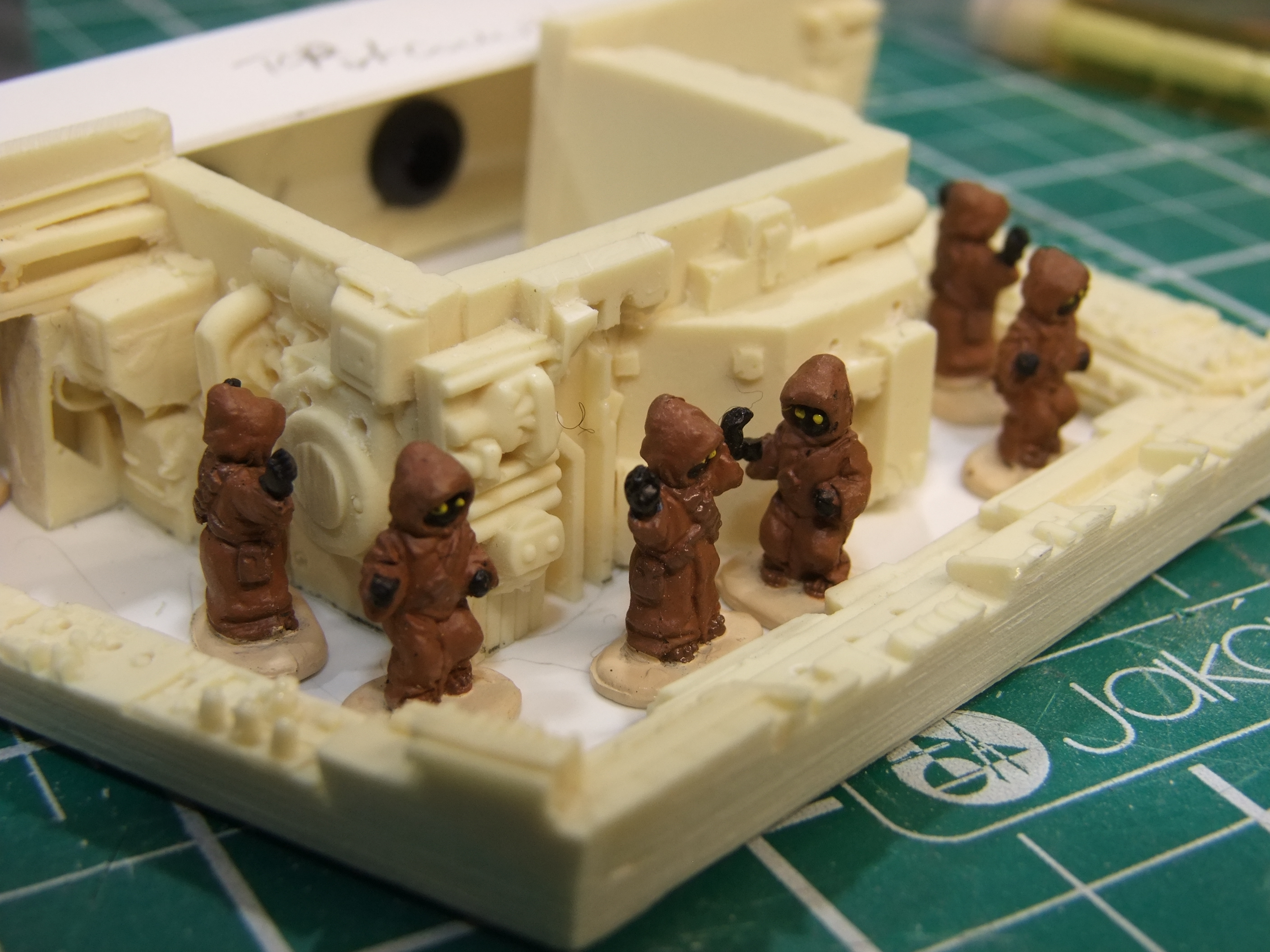

    Oct 25, 2017, 8:51 AM - Re: Jawa SAND CRAWLER - 1/96 Randy Cooper Resin Model #10
    Many dusty hours spent outside in the blustery UK wind and rain this last weekend has got me through the sanding process - now with all parts tidied up and ready to assemble. I just need to band-saw the crawler track teeth out and tidy them up - there is a lot of resin flash in between each tread link. The cockpit is drilled out ready for LED and fibre optics too now.
    Utinni !

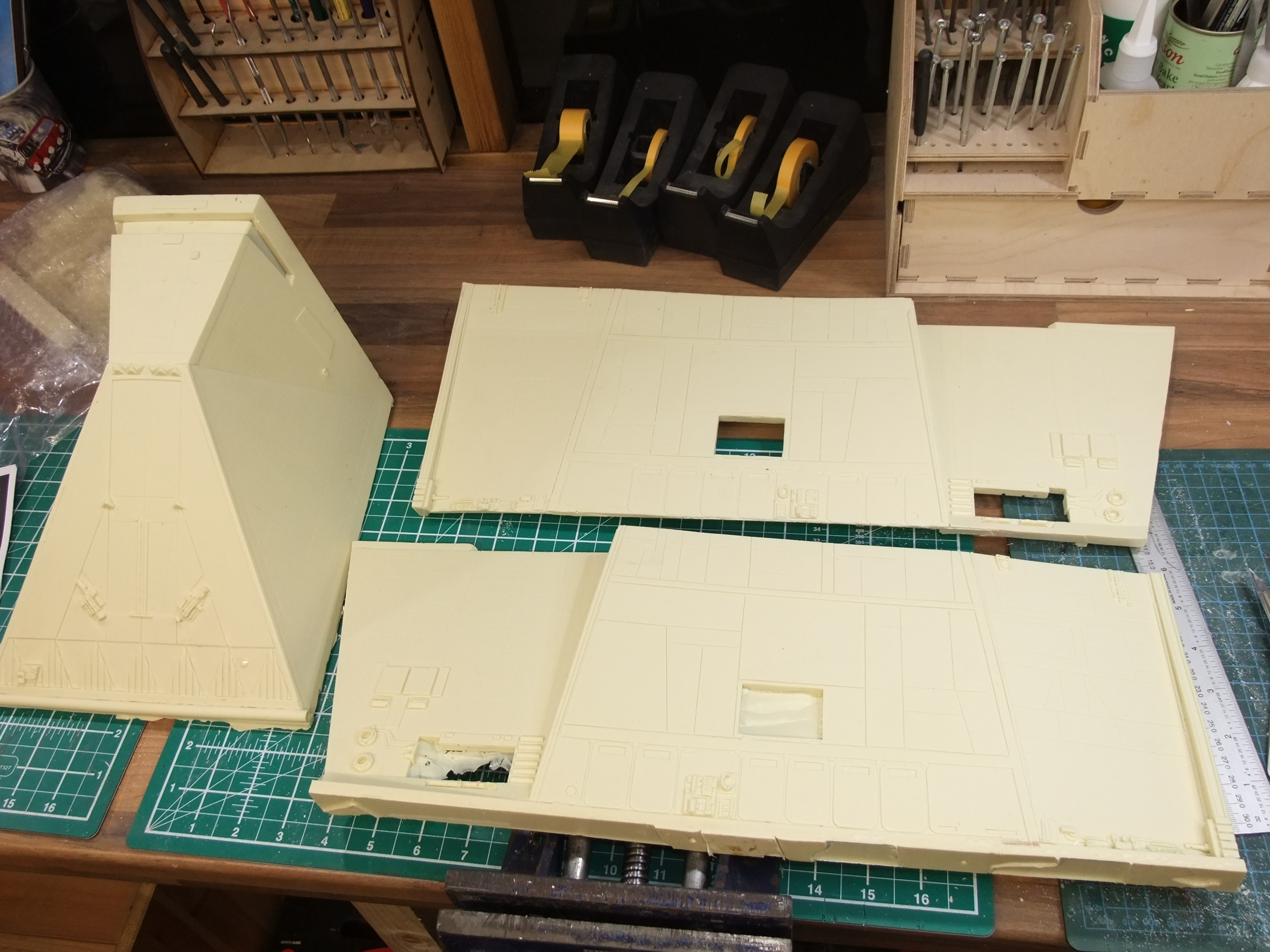

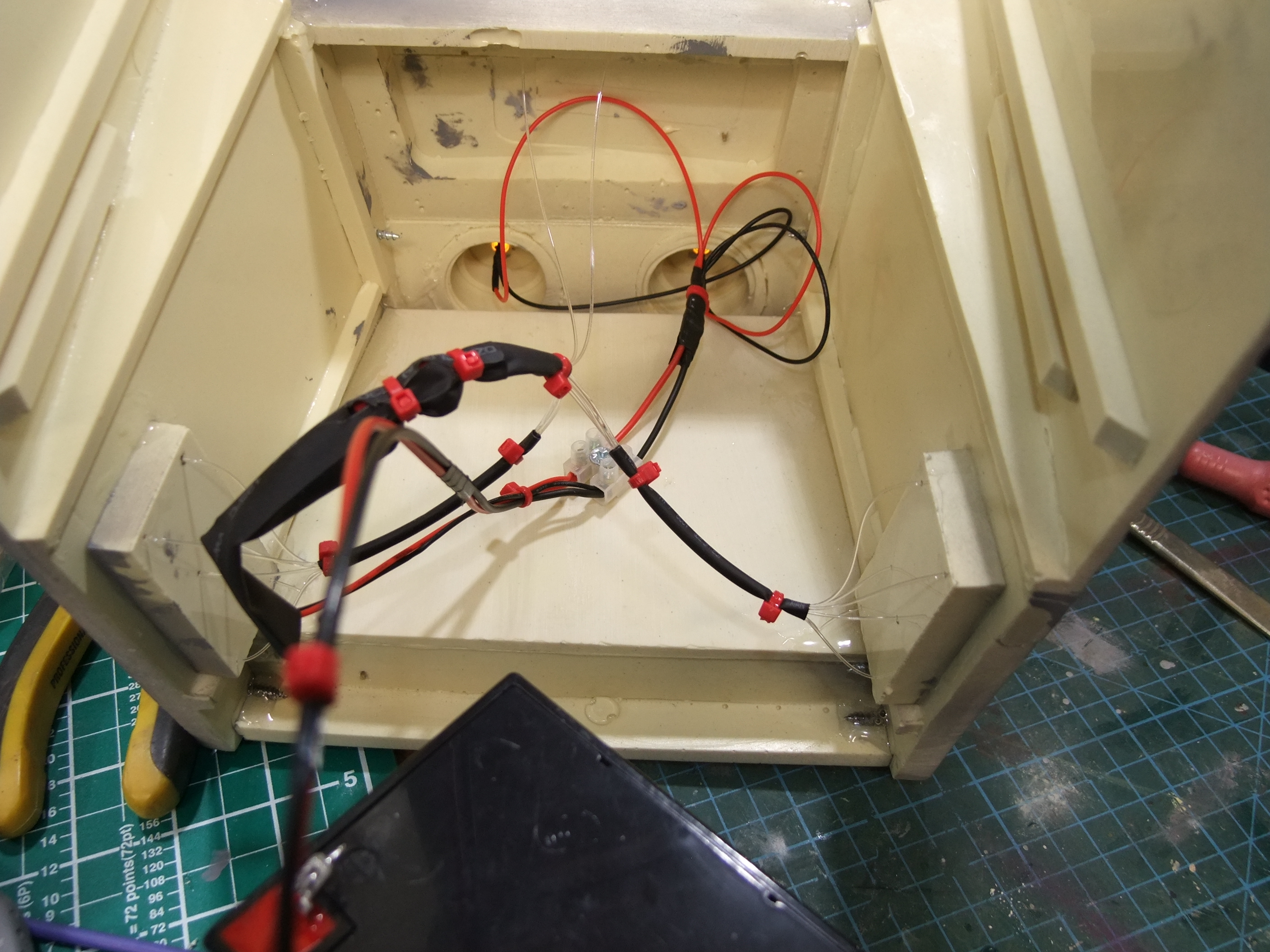

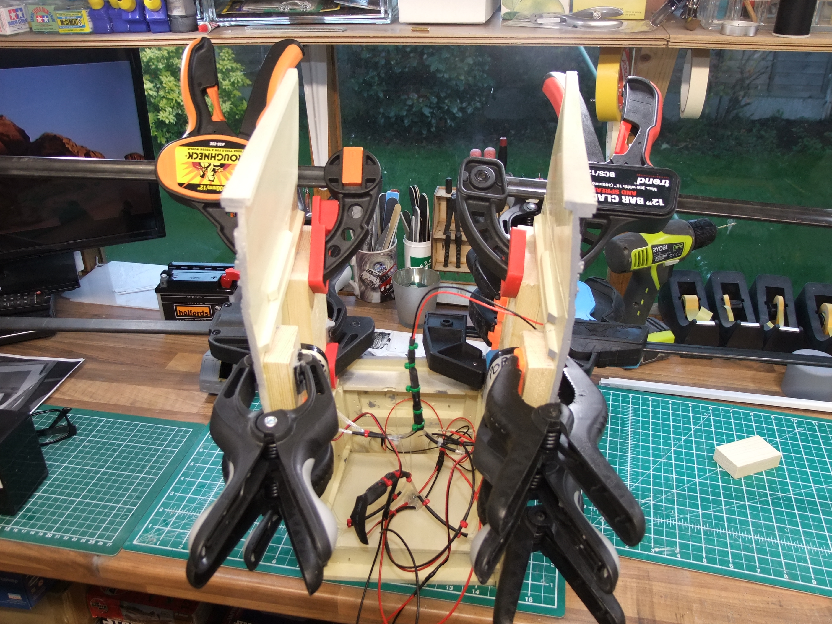

    Nov 8, 2017, 8:21 AM - Re: Jawa SAND CRAWLER - 1/96 Randy Cooper Resin Model #13
    Hi Mellowtiger

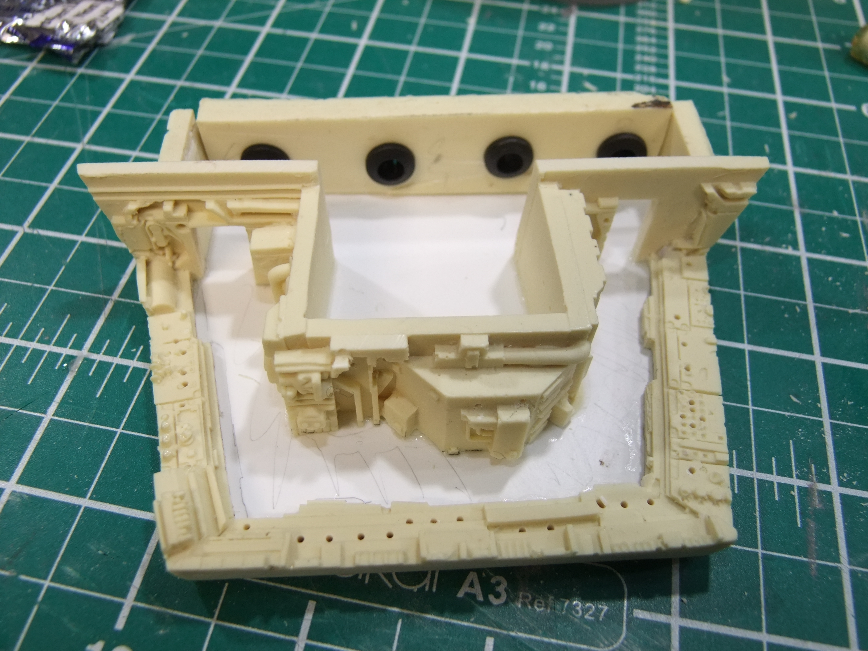

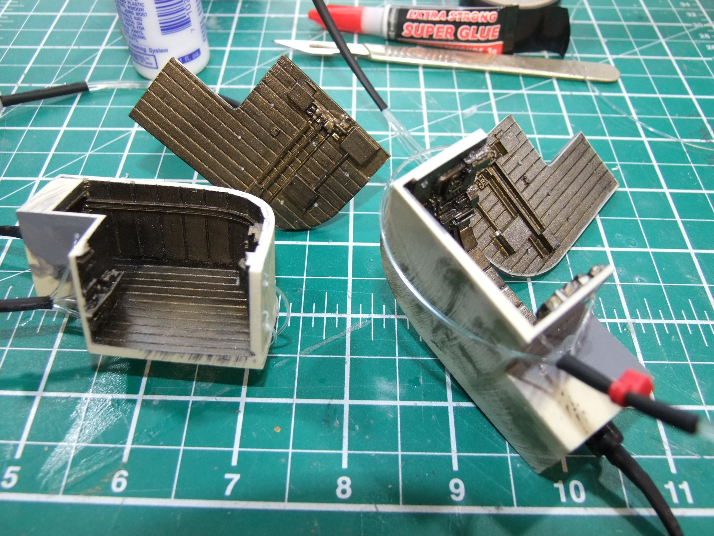

    its good to know I'm not alone out there building this big shoe box. The cockpit floor was half missing - a bad pour at the moulding stage, it looked like Randy had poured the resin into his moulds on an uneven surface as most of the parts were thicker at one end than the other - but that just adds a challenge and makes it all the more fun for me - Randy's kits have really divorced me away from nicely designed CAD drafted perfect fitting kits and turned me into a more self sufficient creative builder for a change, and I have found the whole experience quite refreshing. I'll drop some update pictures for you (PS good luck getting the upper box section to fit on the lower tray - that was a bitch of a fitting last night which I have not pictured yet as it is drying still)

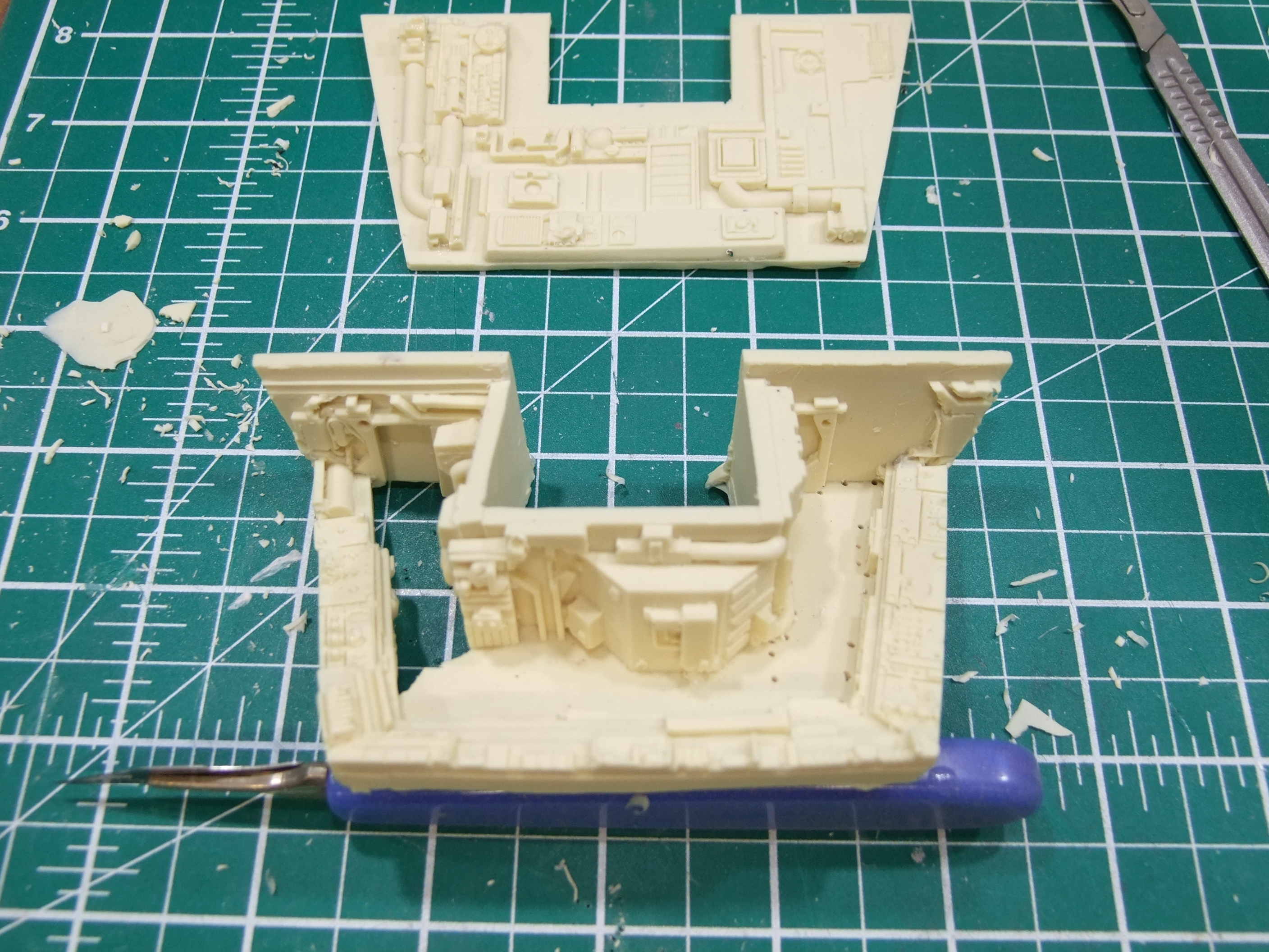

    thanks for the link - will check it out - this kit is turning bitch on me - there is a major twist in it and I am going to have to make a slim wooden top frame to keep it square (despite much heat treatmenting)
    The skew in the body is recoverable but will add unexpected time to the build (mind you, I am kind of enjoying the challenges as the occur now)

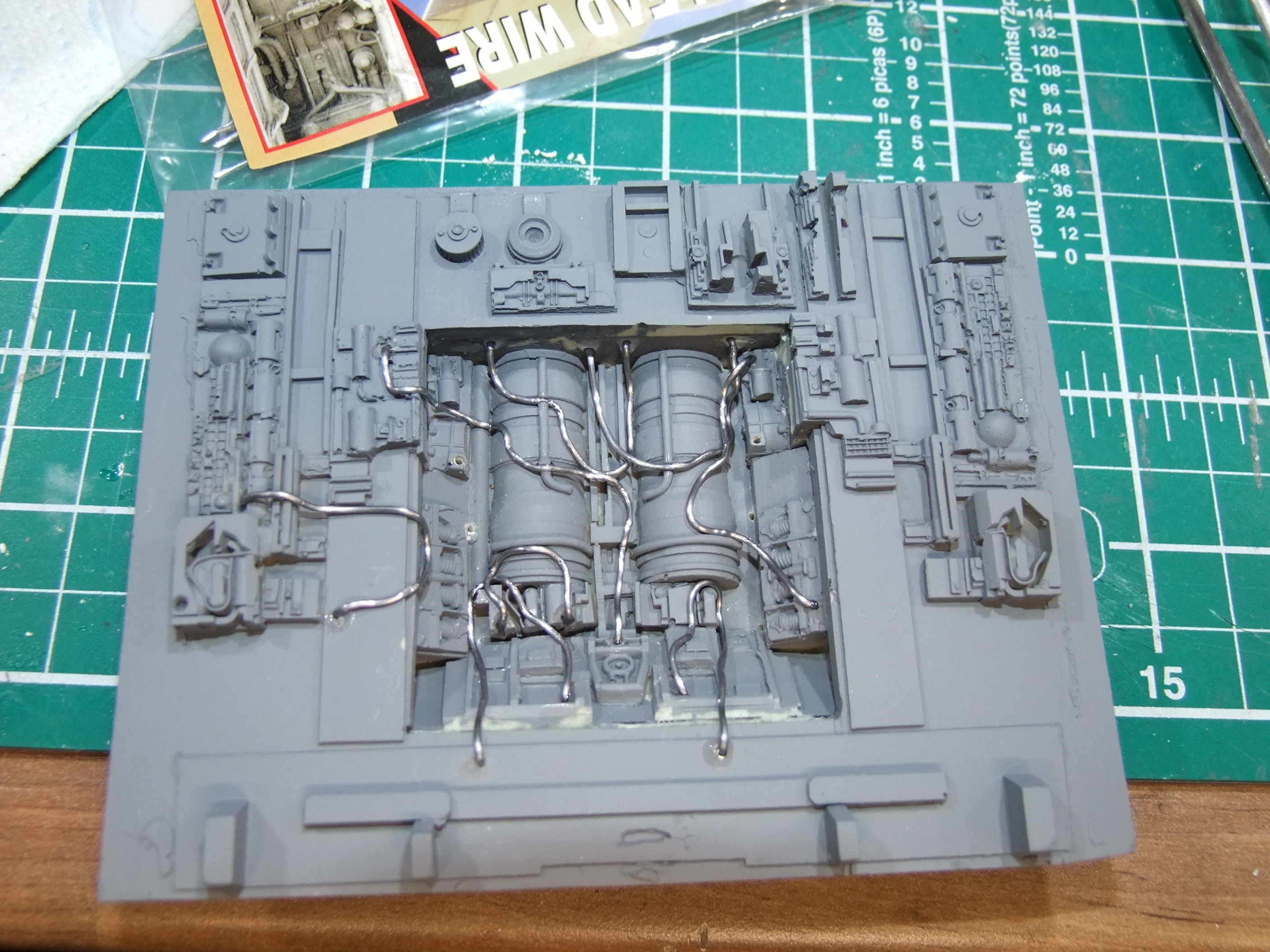

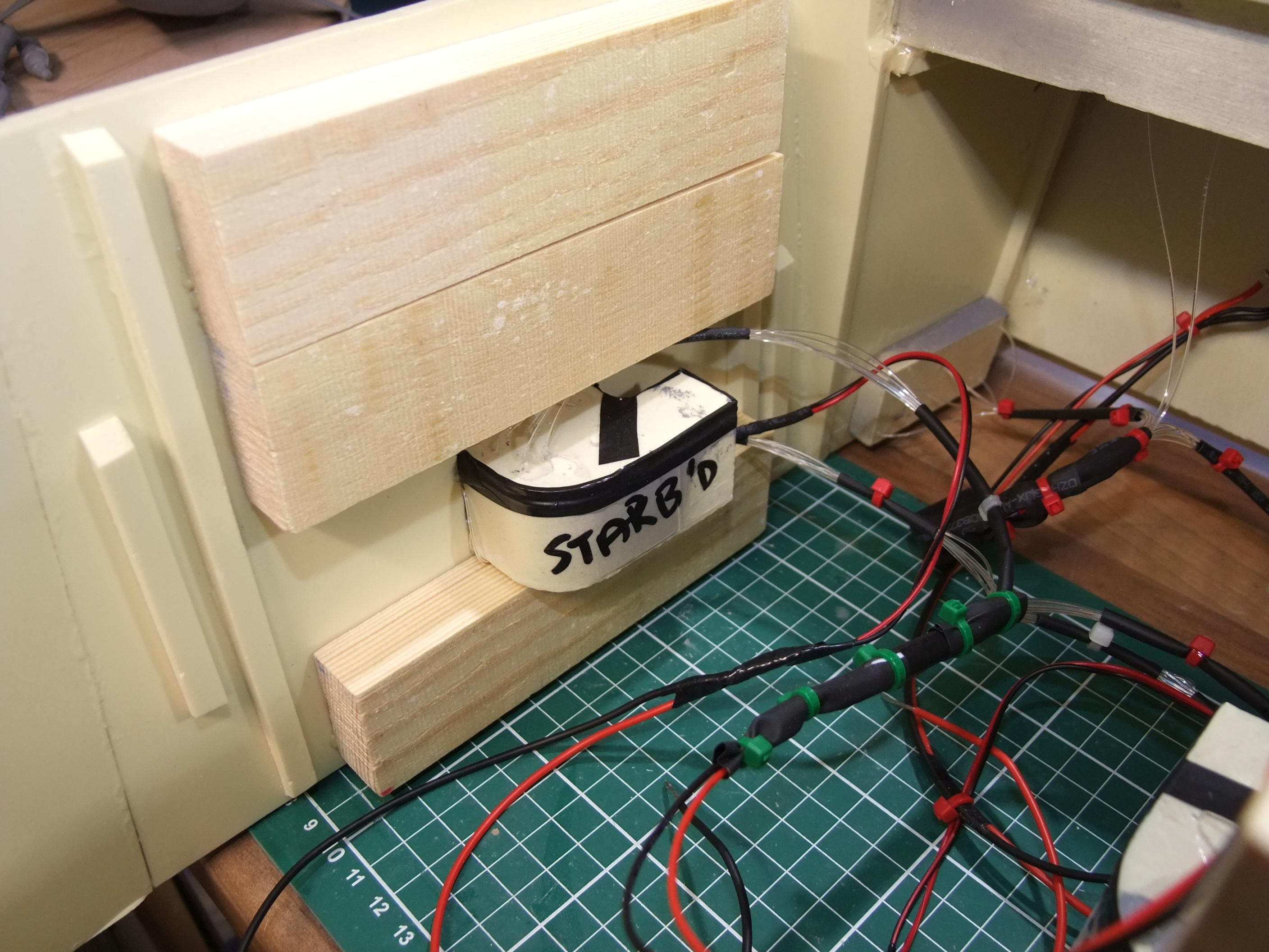

    Dec 7, 2017, 9:08 AM - Re: Jawa SAND CRAWLER - 1/96 Randy Cooper Resin Model #20

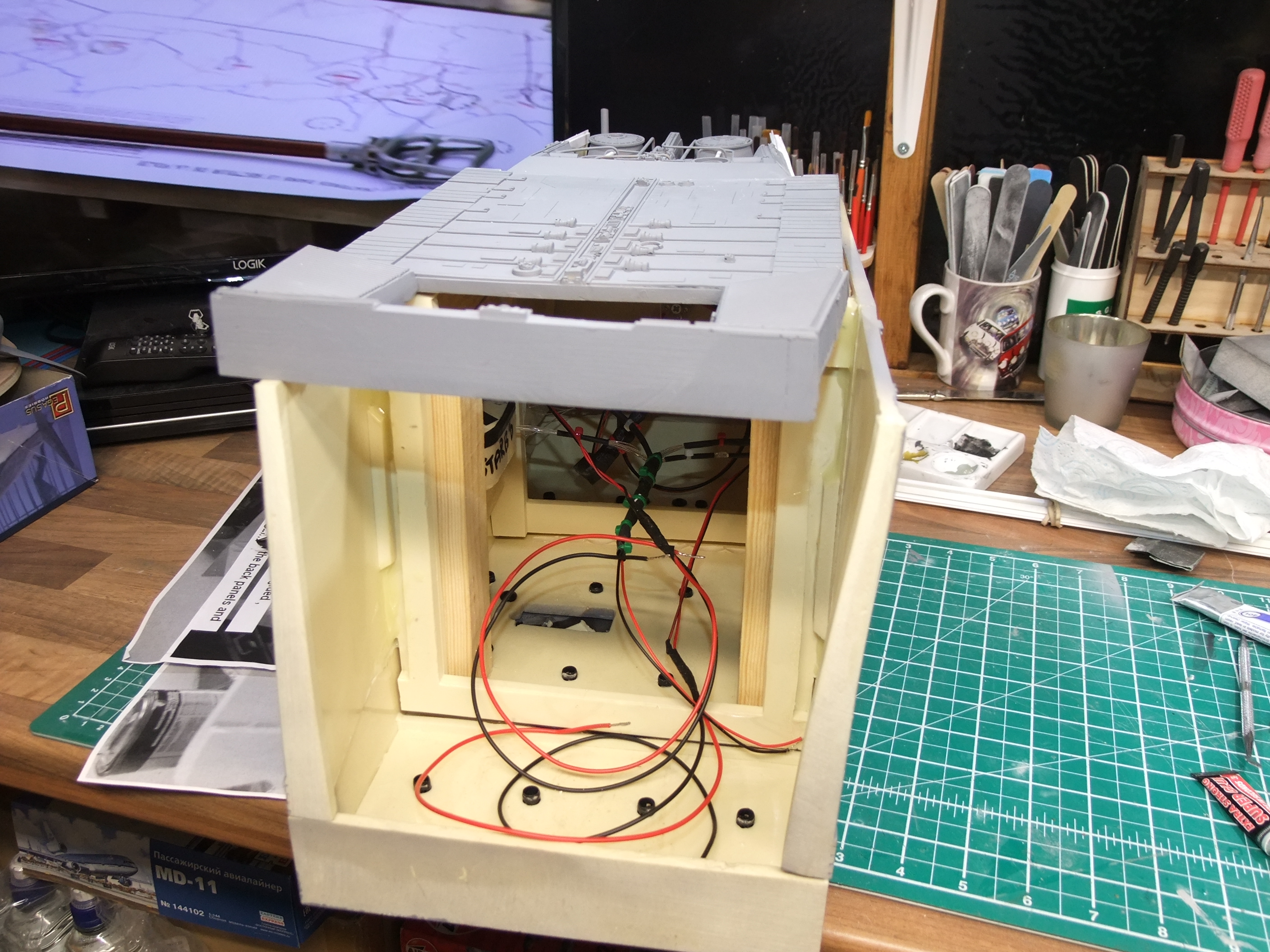

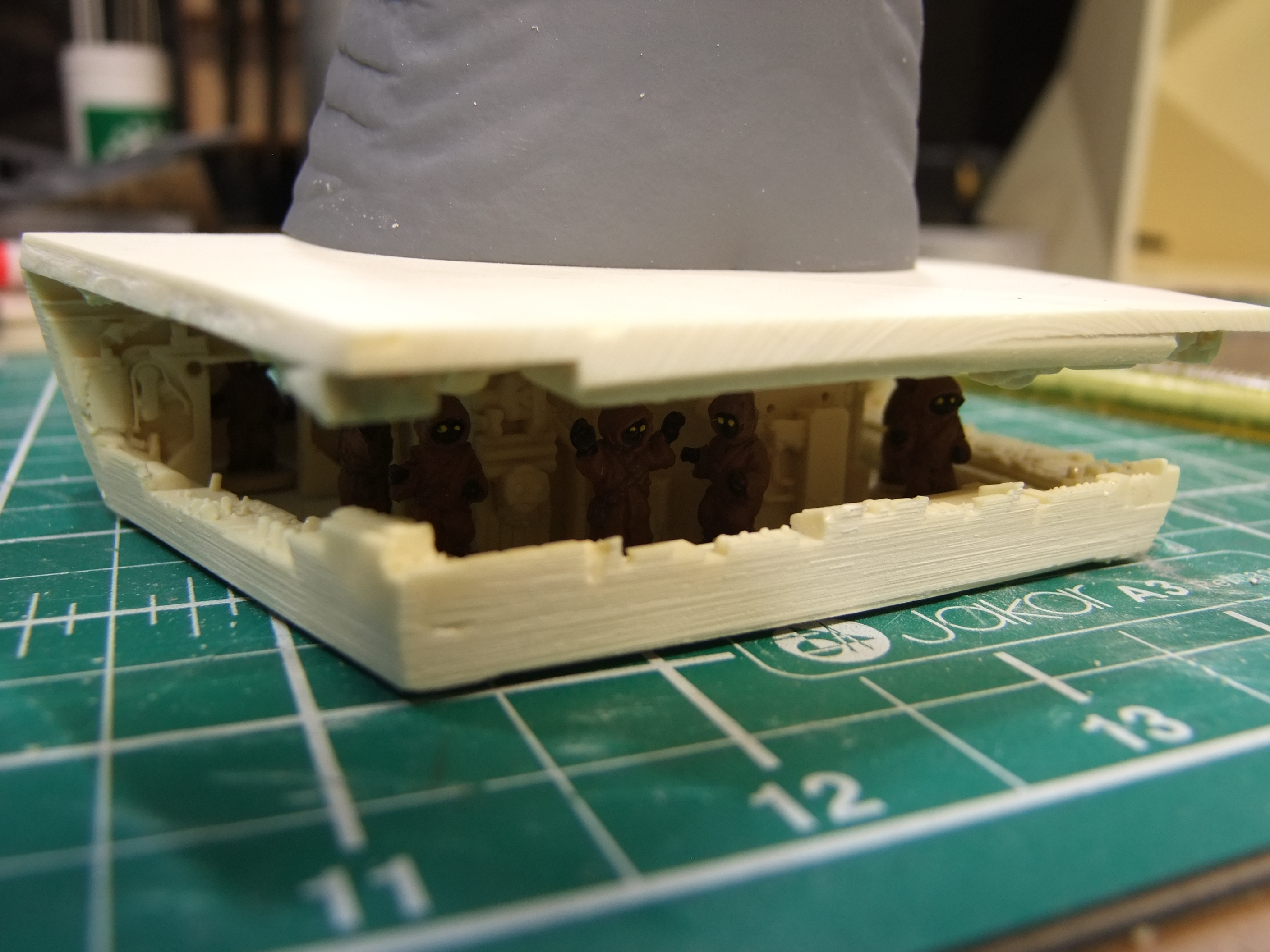

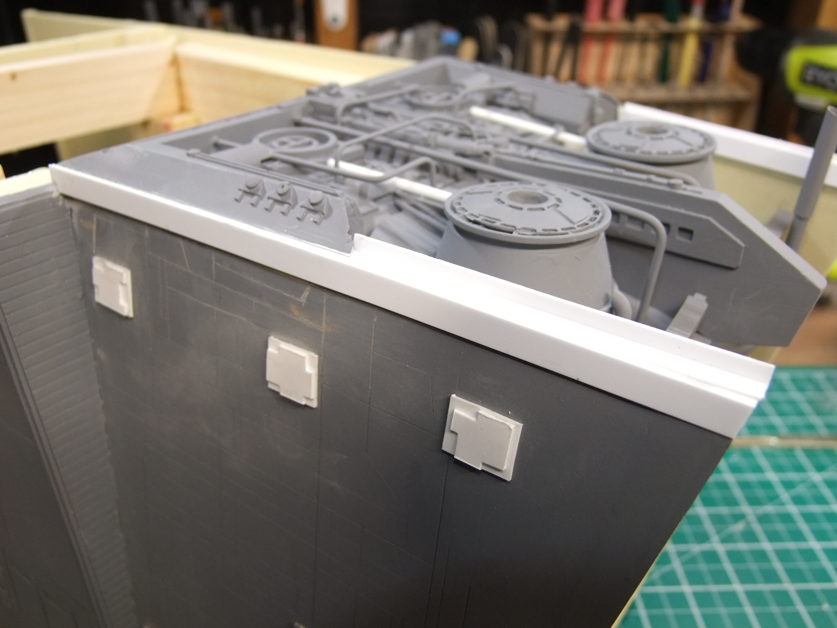

    looking more like a big box now - coming together rather slowly - I keep getting distracted each night and have been watching Peaky Blinders right from S1 again bring the WIP to a bit of a crawl...

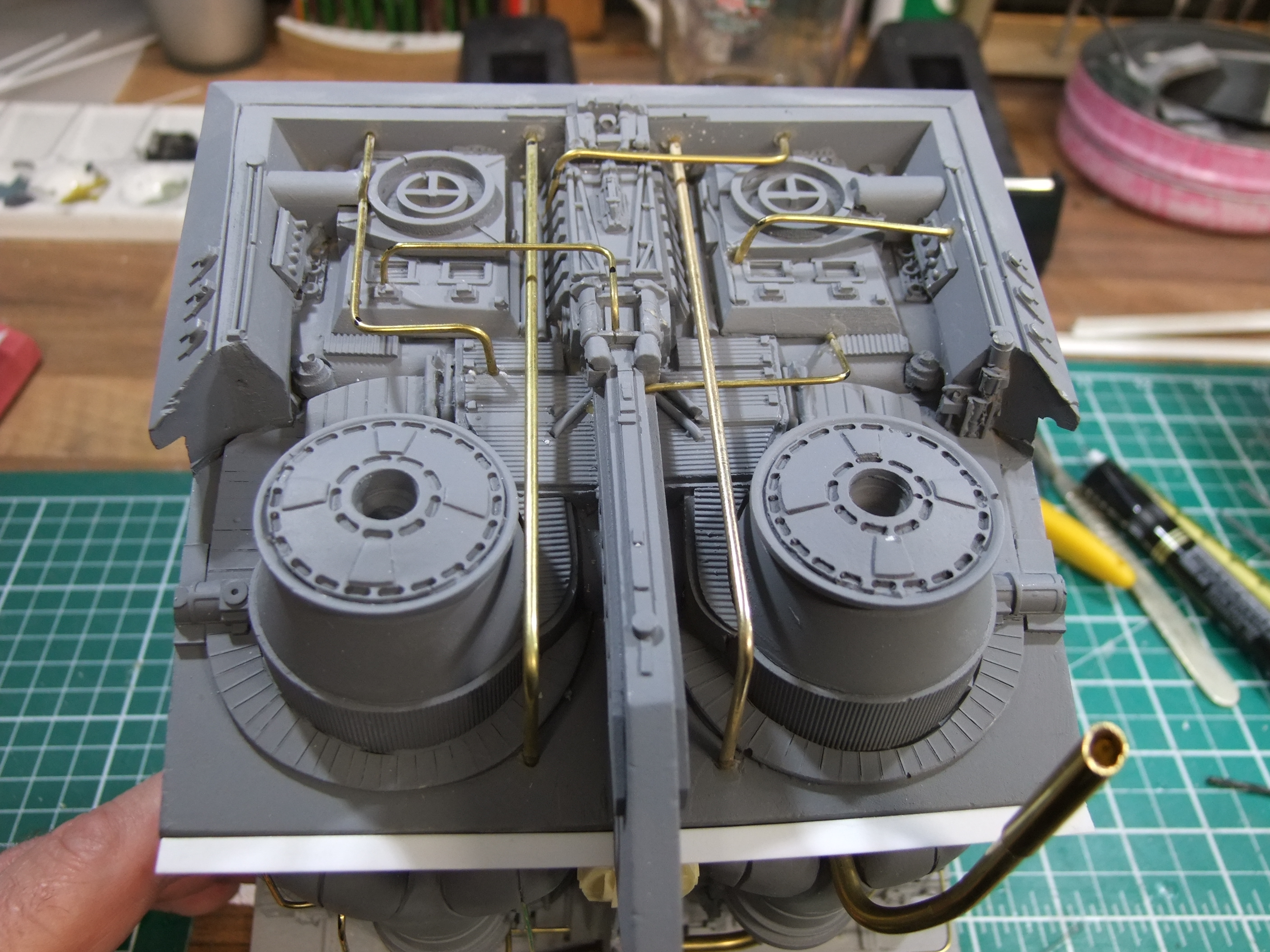

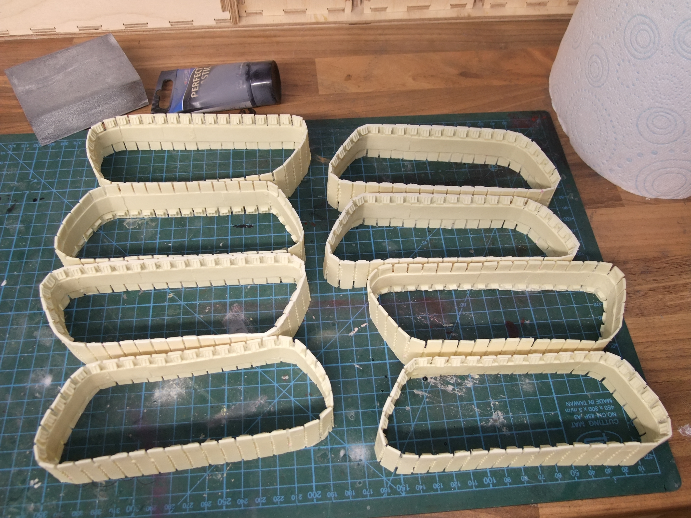

    Dec 20, 2017, 8:14 AM - Re: Jawa SAND CRAWLER - 1/96 Randy Cooper Resin Model #22

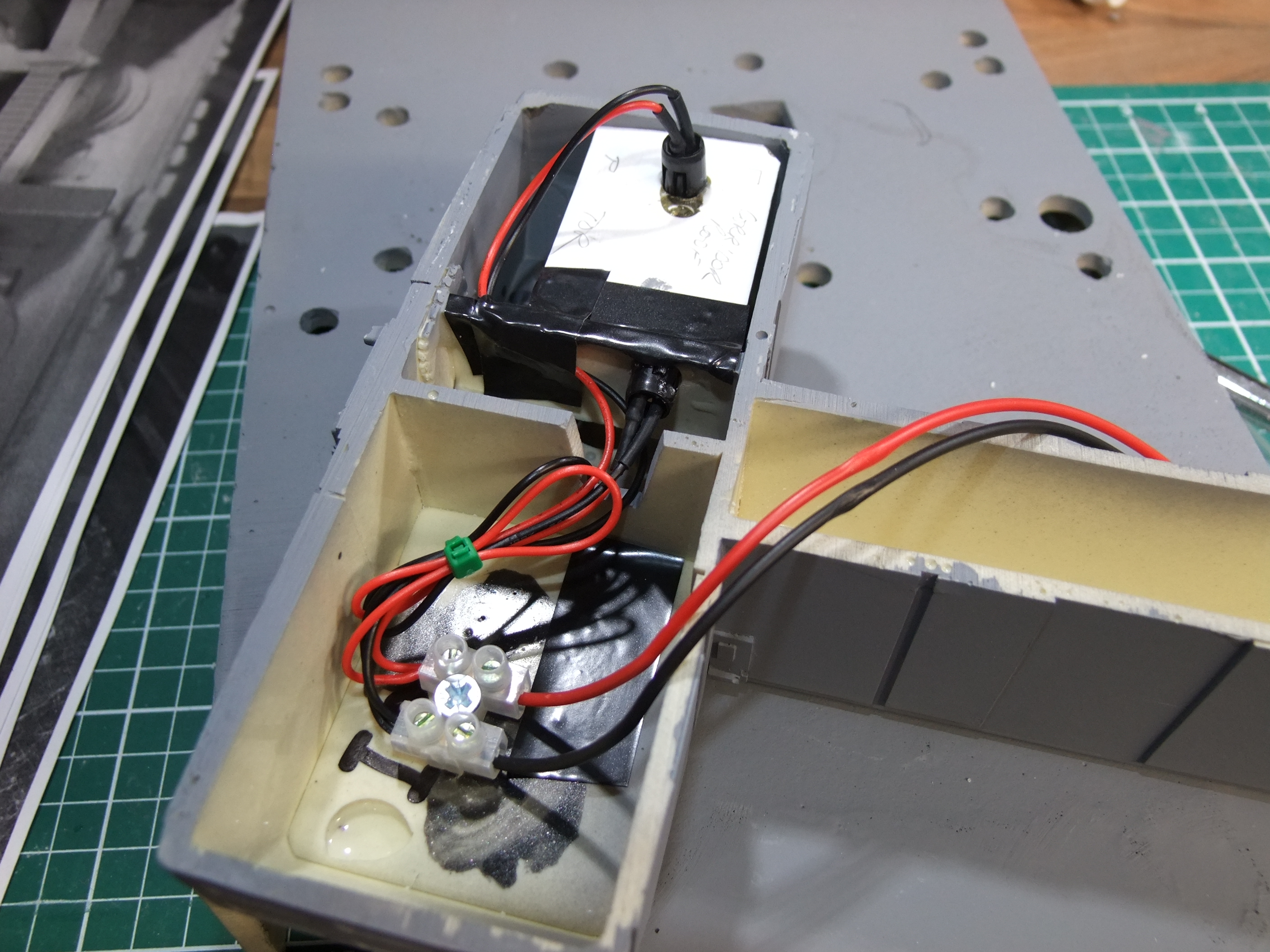

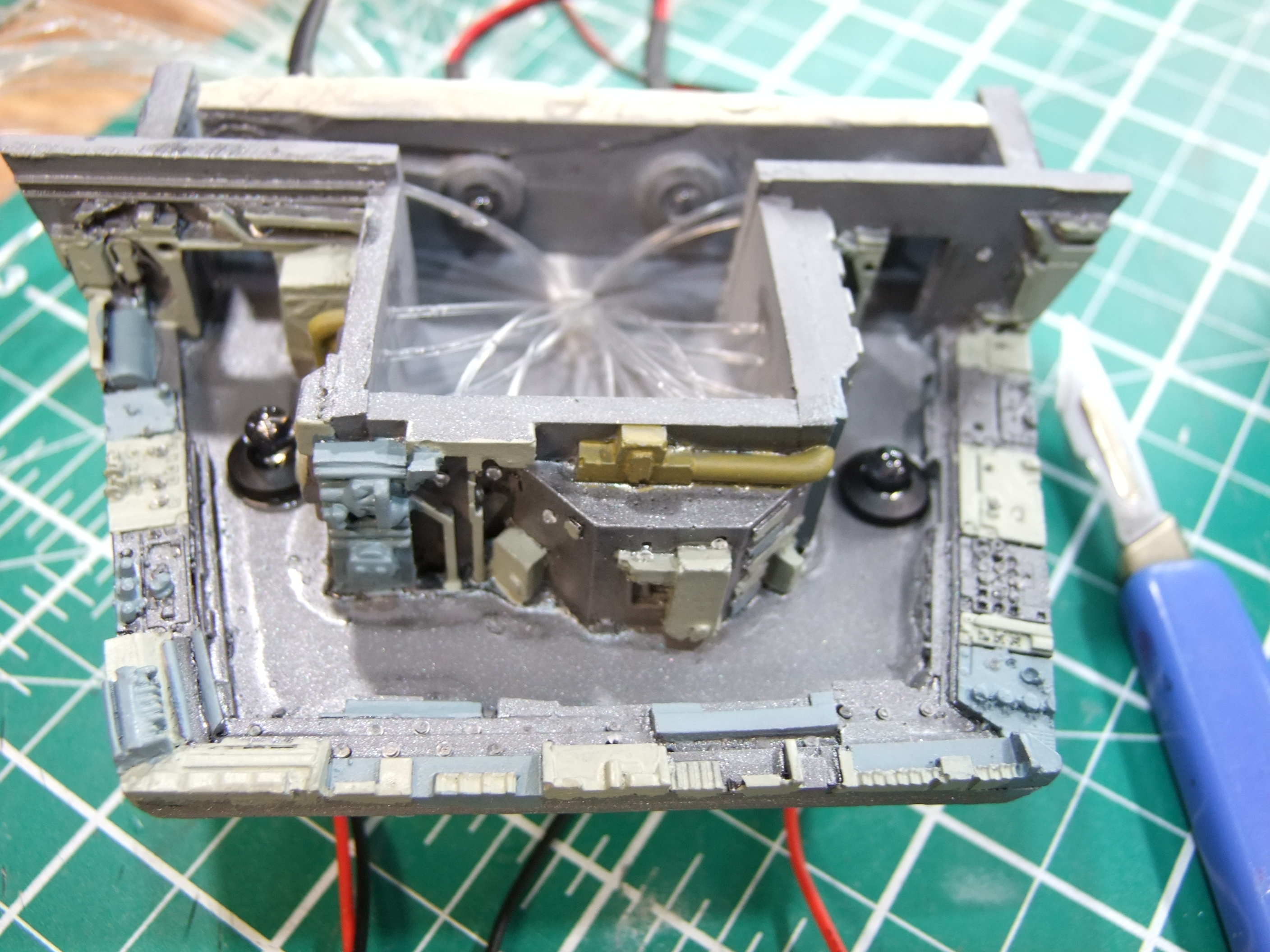

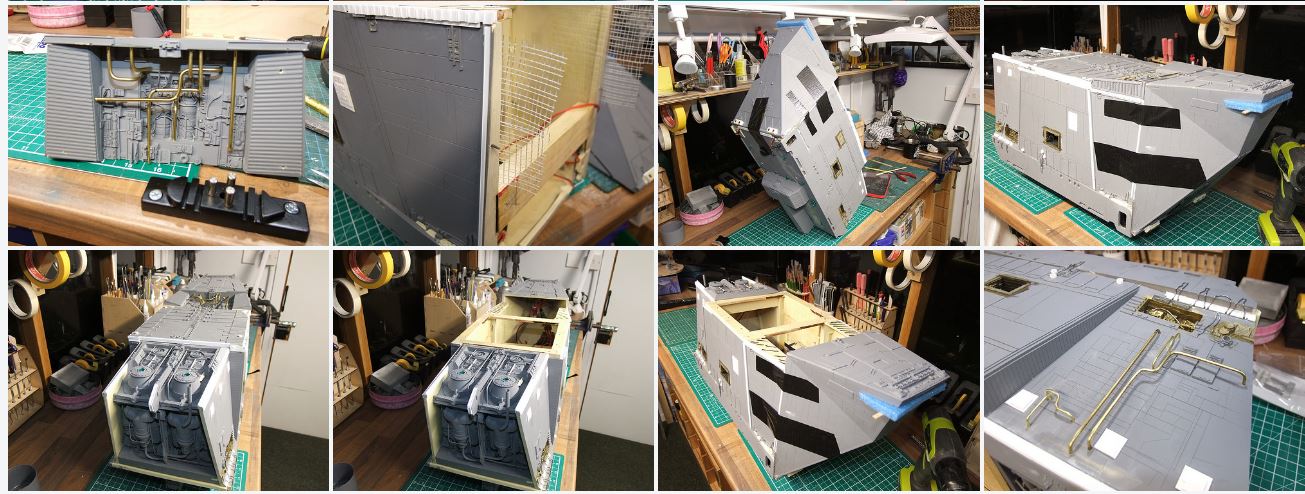

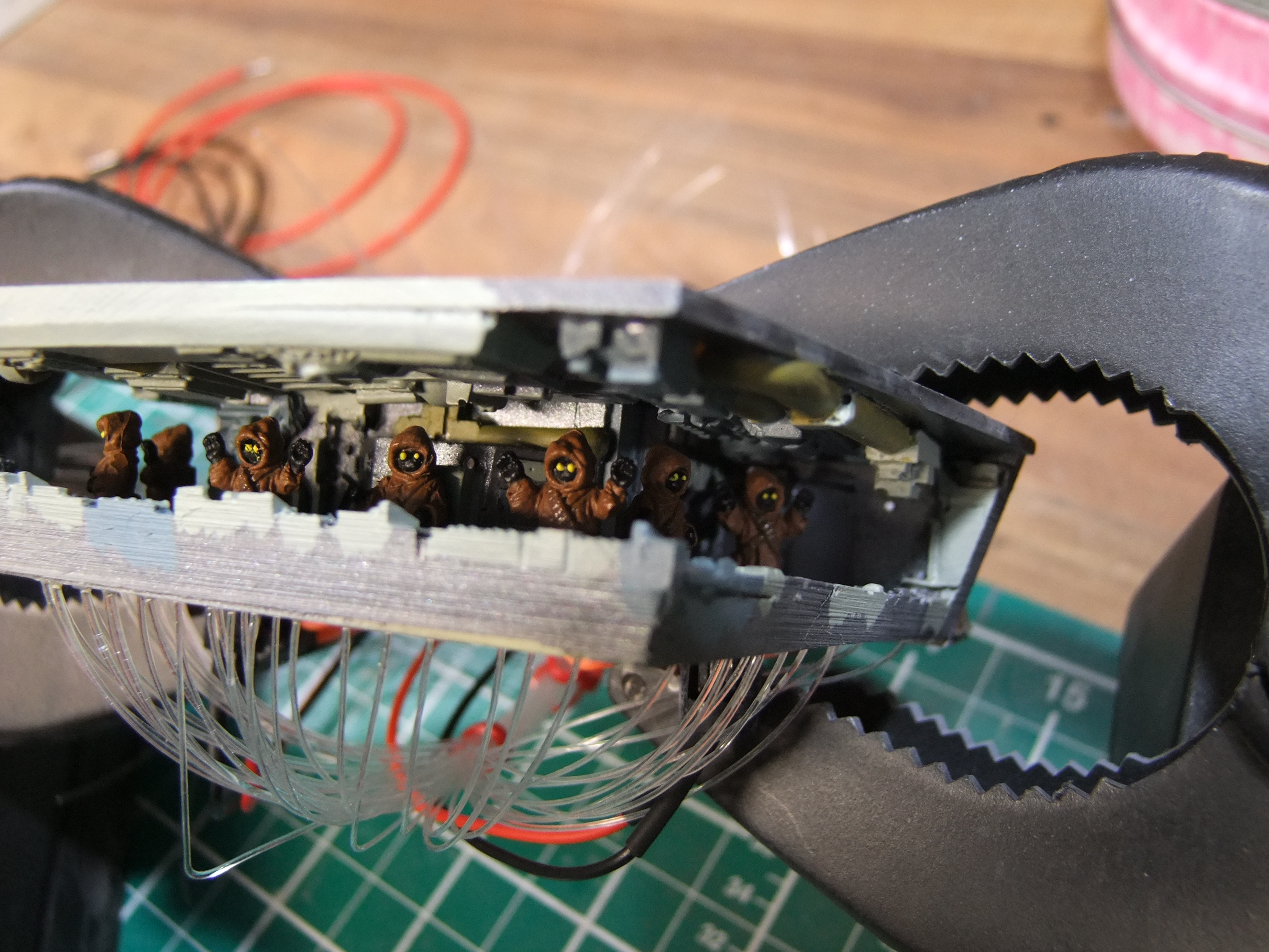

    The UK weather has been cruel to the UK modeller and not allowed me too much work on the Crawler since the snow a week or so back - I got to the stage whereby I needed to prime and spray outside my workshop just as the snow flakes started to fall so this has fallen behind a bit.
    I managed to get the 4 main drive bogies attached with some re-enforcing nails to use as pins to secure the upright attachment into the floor of the Crawler. The brass and copper ad-lib pipework is complete and I have hand built the control tower window frames too.
    With the base coat of grey primer now finally on and ready for the various shades of brown and weathering, I am hoping to get further work done over the xmas break.

    Mar 16, 2018, 9:34 AM - Re: Jawa SAND CRAWLER - 1/96 Randy Cooper Resin Model #25
    Its all coming together very slowly but I'm nearly done now - just need to add the treads and complete the diorama base now - which is just as well because Randy Cooper texted me last night to confirm he is about to post my new Star Destroyer kit that he has spent the last year or so updating and is now finally putting into production.
    OOTINIE...
