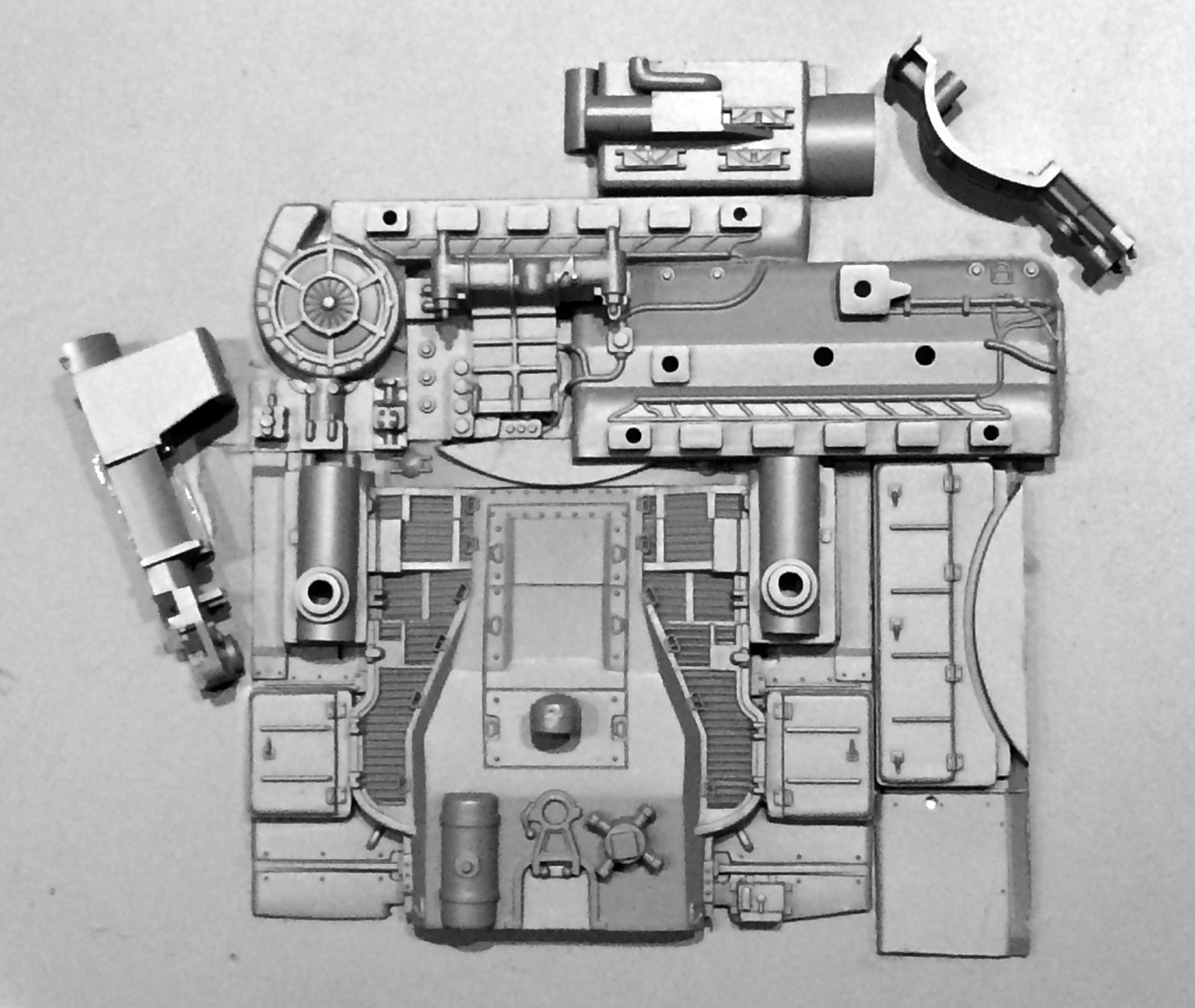

    I'll start here with the Mandibles, as they were the first part I constructed. I'm going mostly a full styrene/kit approach for Greeblies on this, and only casting parts when absolutely necessary.
    Starting the Mandible
    Click image for larger version.
ID:	764891Click image for larger version.
    Filling in the Pits
    Sidewall details
ID:	764896Click image for larger version.
ID:	764895Click image for larger version.
Name:	STB Mand11.jpg
ID:	764893Click image for larger version.
ID:	764892Click image for larger version.

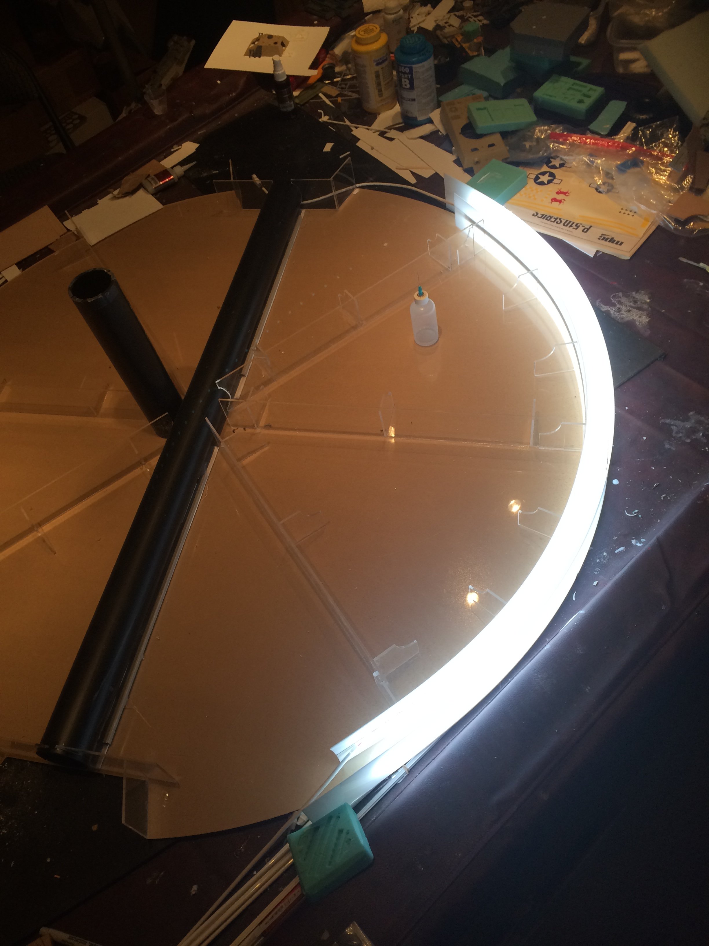

    6" Dish construction and now in primer. I realized they 'routed' out the Plastruct dome for this, so I copied that approach, then cut out the rounded raised lip to make it flush on the two sides. Lined up to match as best possible to the Sealab/IX part. (I still have to clean up the filler nubs in the Saturn V cone.)

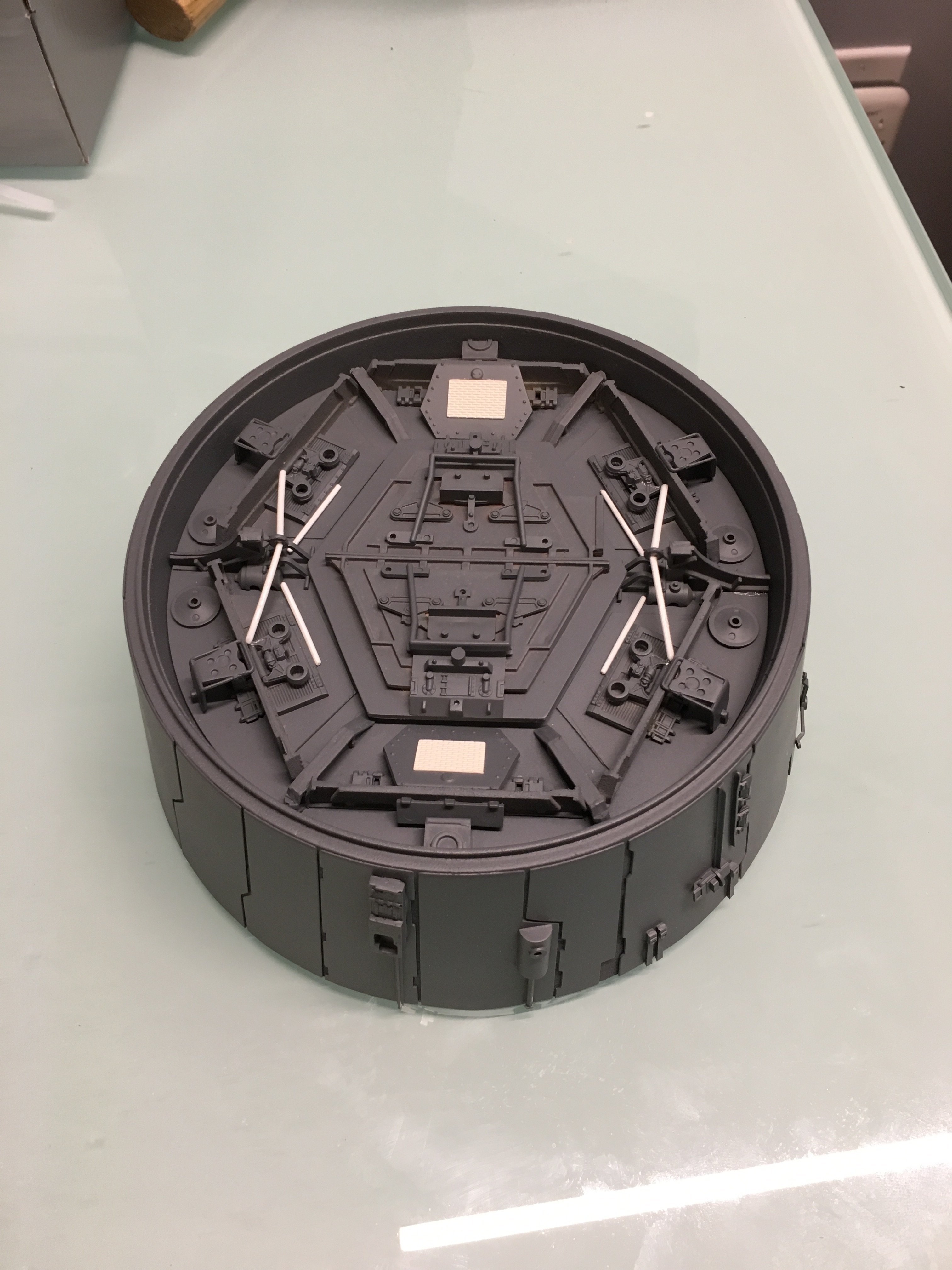

    So here's some more background on the project. These are the maintenance pits and the bottom platform under construction.

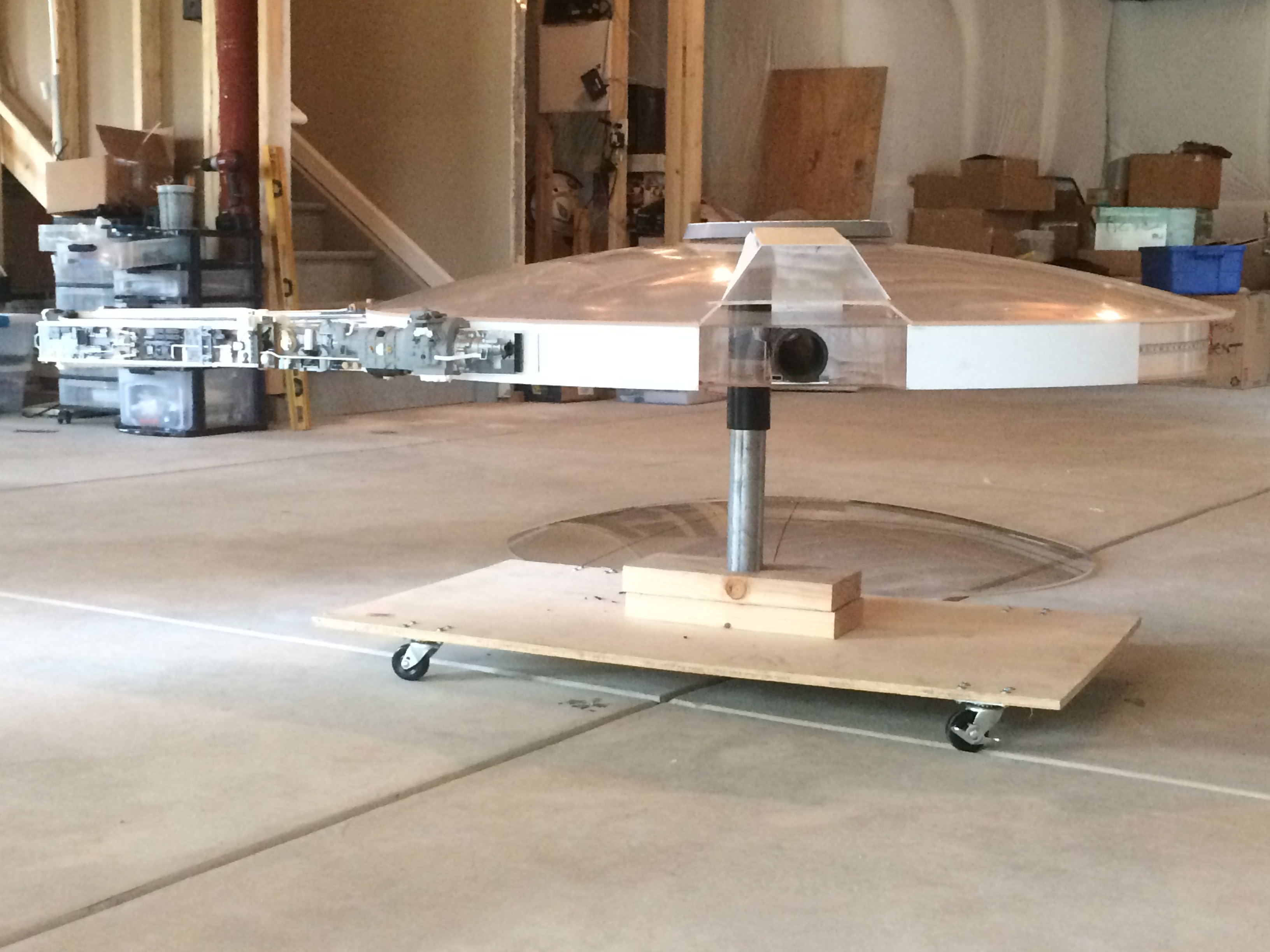

    Getting close to real time now... Here's a few shots of the main hull approach I'm taking. I started with the 'hamburger patty', built around a 2" PVC pipe so a 2" steel muffler pipe can go in across for carrying, then I have a vertical pipe that has a metal rod on the top/bottom to work as a stop for the steel pipe, but allows me to mount it vertical up/upside down. The lighting is just a nice bright white LED light strip that will be accessible if needed. The "Buns" I did similar to the original. I had them custom formed/blown (it took 12 attempts to make 3 good hemispheres) I am currently bonding the two 'bun' spheres to the patty, should have pics this weekend. I'll then add a 'extension' strip that emulates perfectly the overlap of the sphere including the 'lip' shape. More details on that on next update.
    Patty Taking shape
