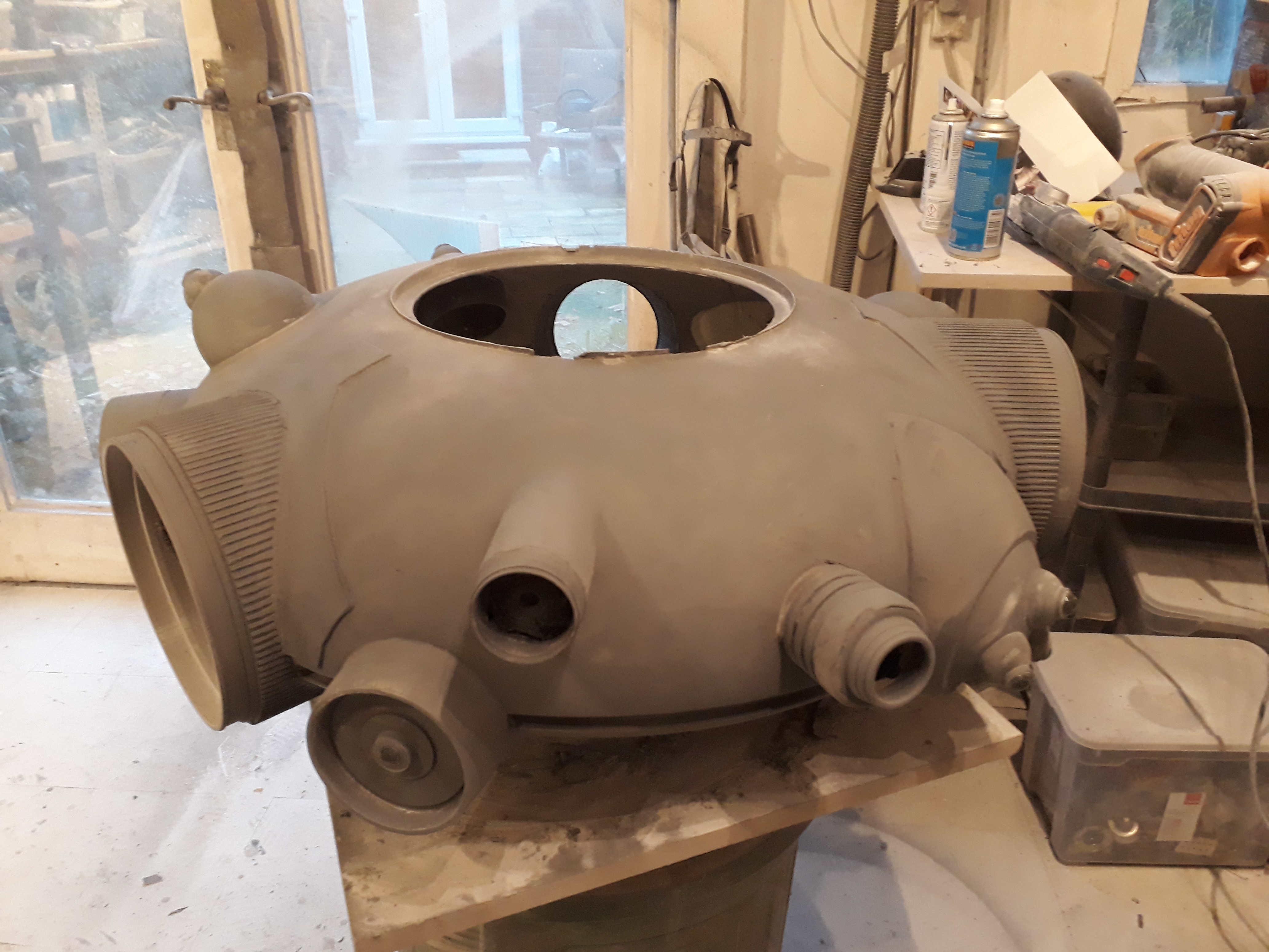

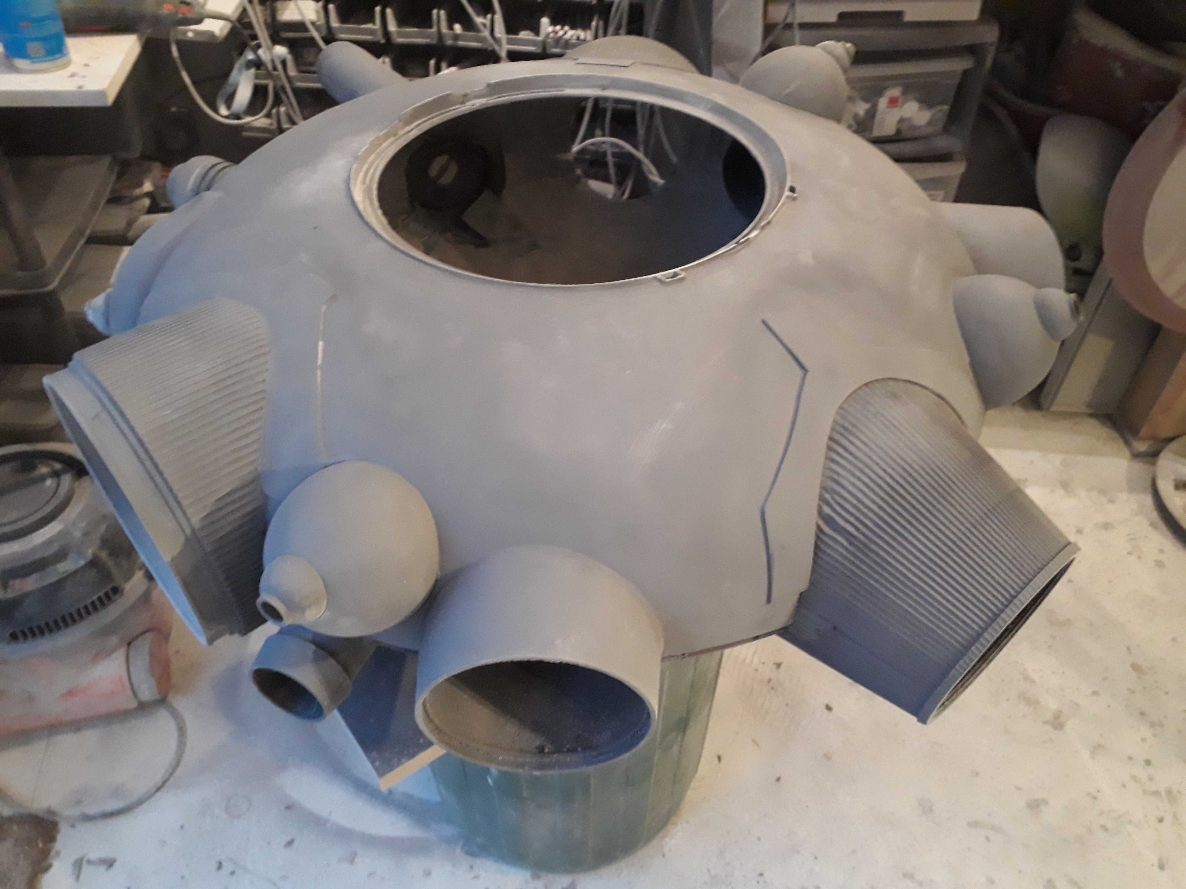

OK slowly making progress. Probably about half way thru finishing the head...got nearly all the 'eyes' on and some of the armoured skins.

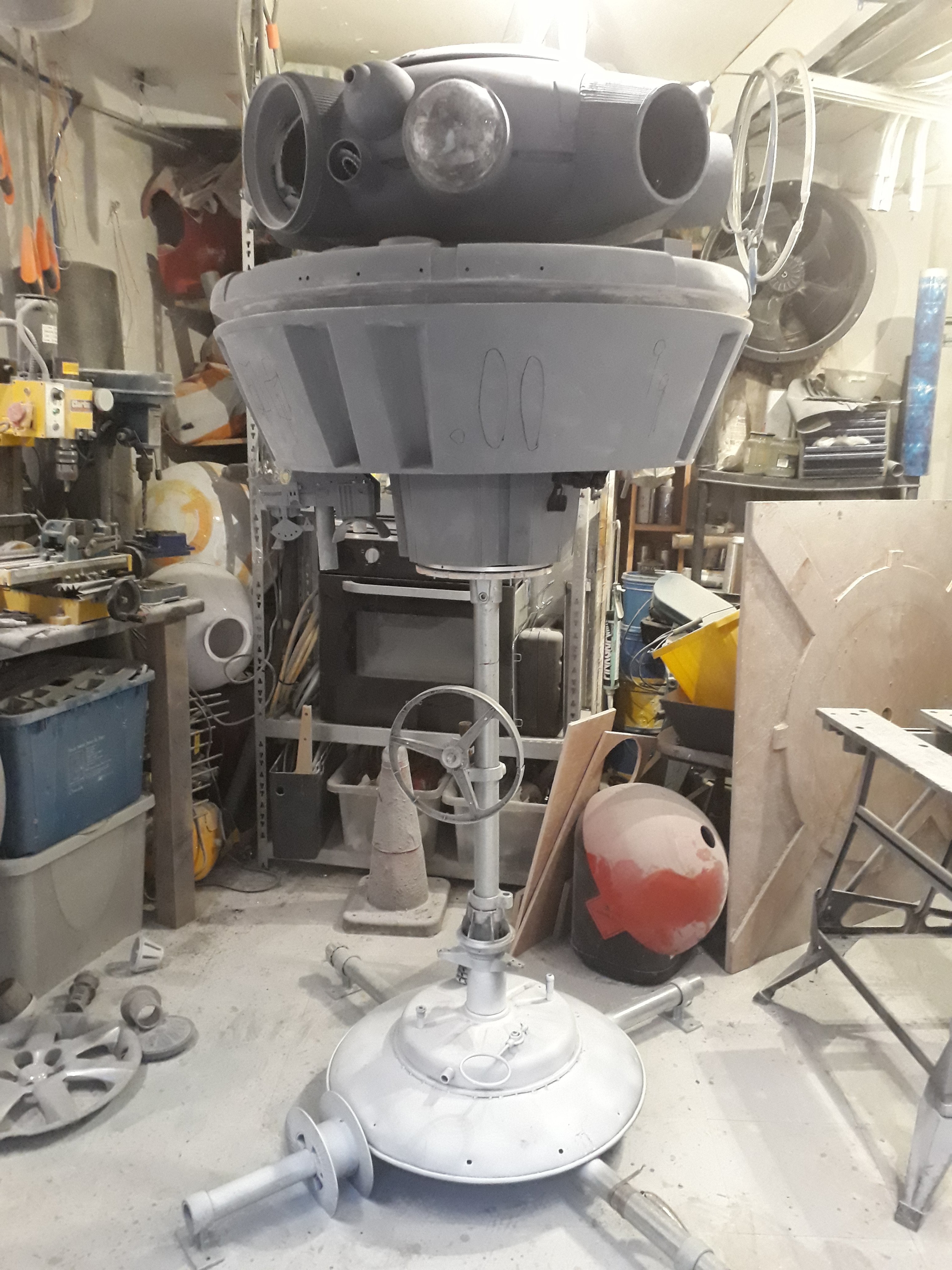

Also had to re-think my prop leg. The original pole I used was ok but allowed for to much wobble when the whole droid is spun. So I constructed a scaffold cross joint with pipe clamps to handle the weight and make him really stable when in motion
