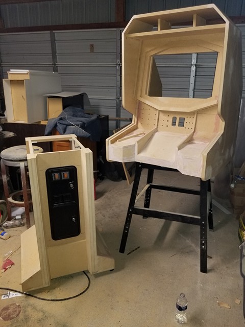

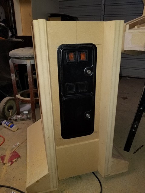

Actually, after I posted a bit ago, I decided to go outside to the shop and mount the coin door. On the next one I'll definitely cut out the hole before hand.....providing I have the door already.

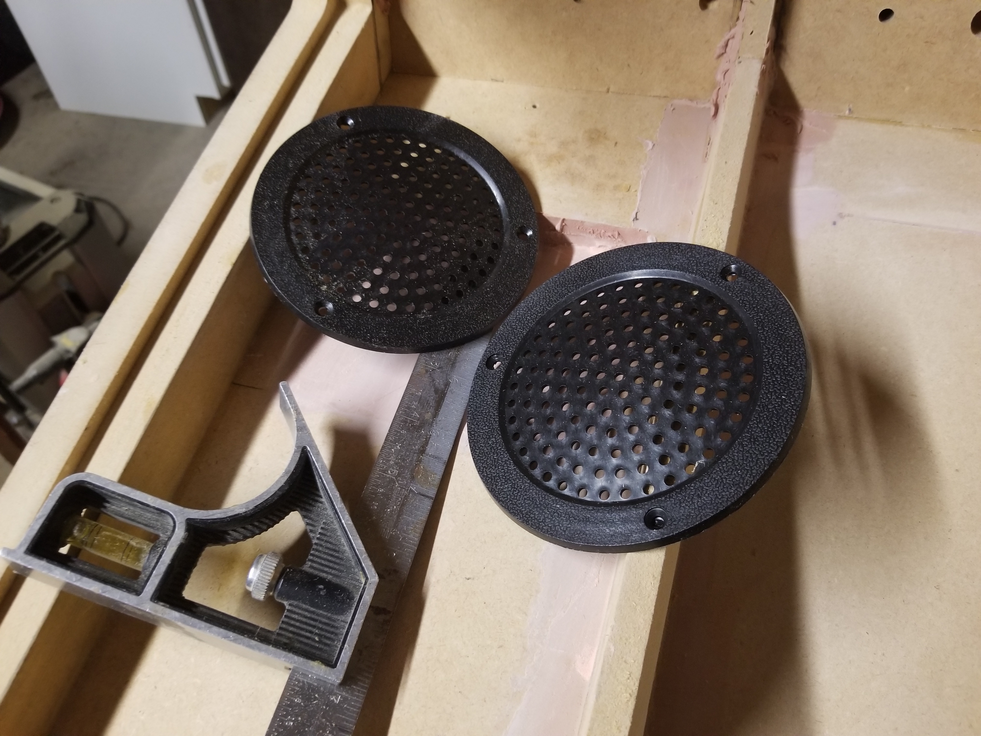

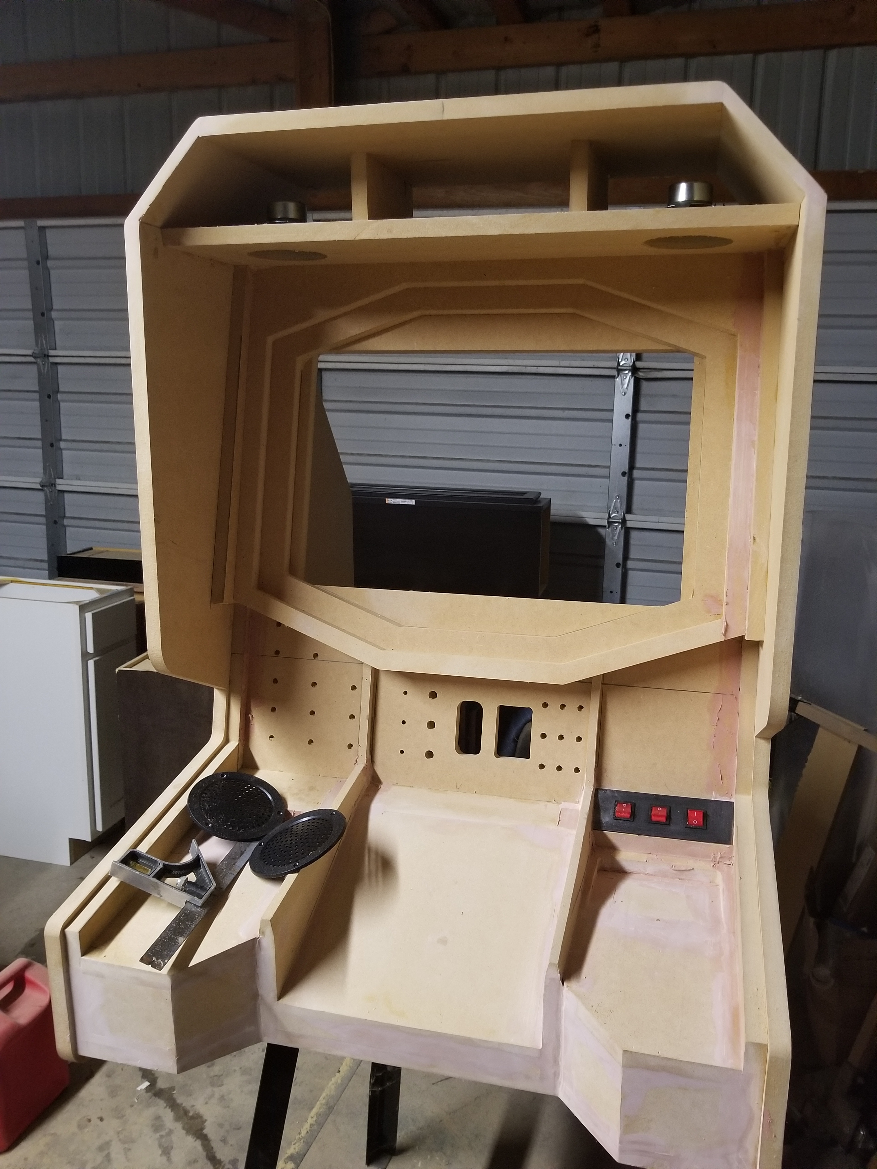

Well the wife is having me remodel the bathroom, so I haven't had much of an opportunity to get outside and play with this much, but some parts came in the other day, so I spent some time last night installing them.

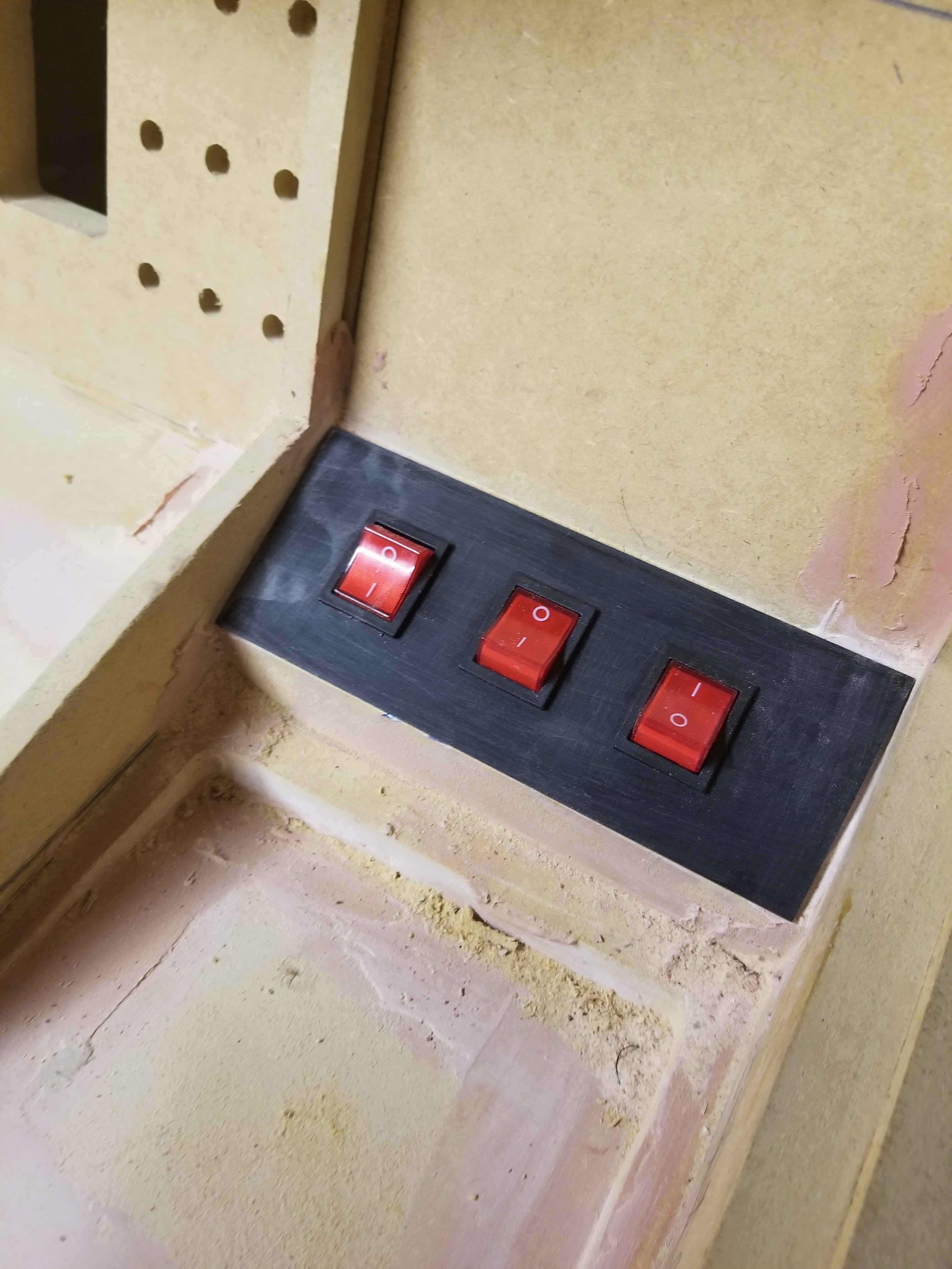

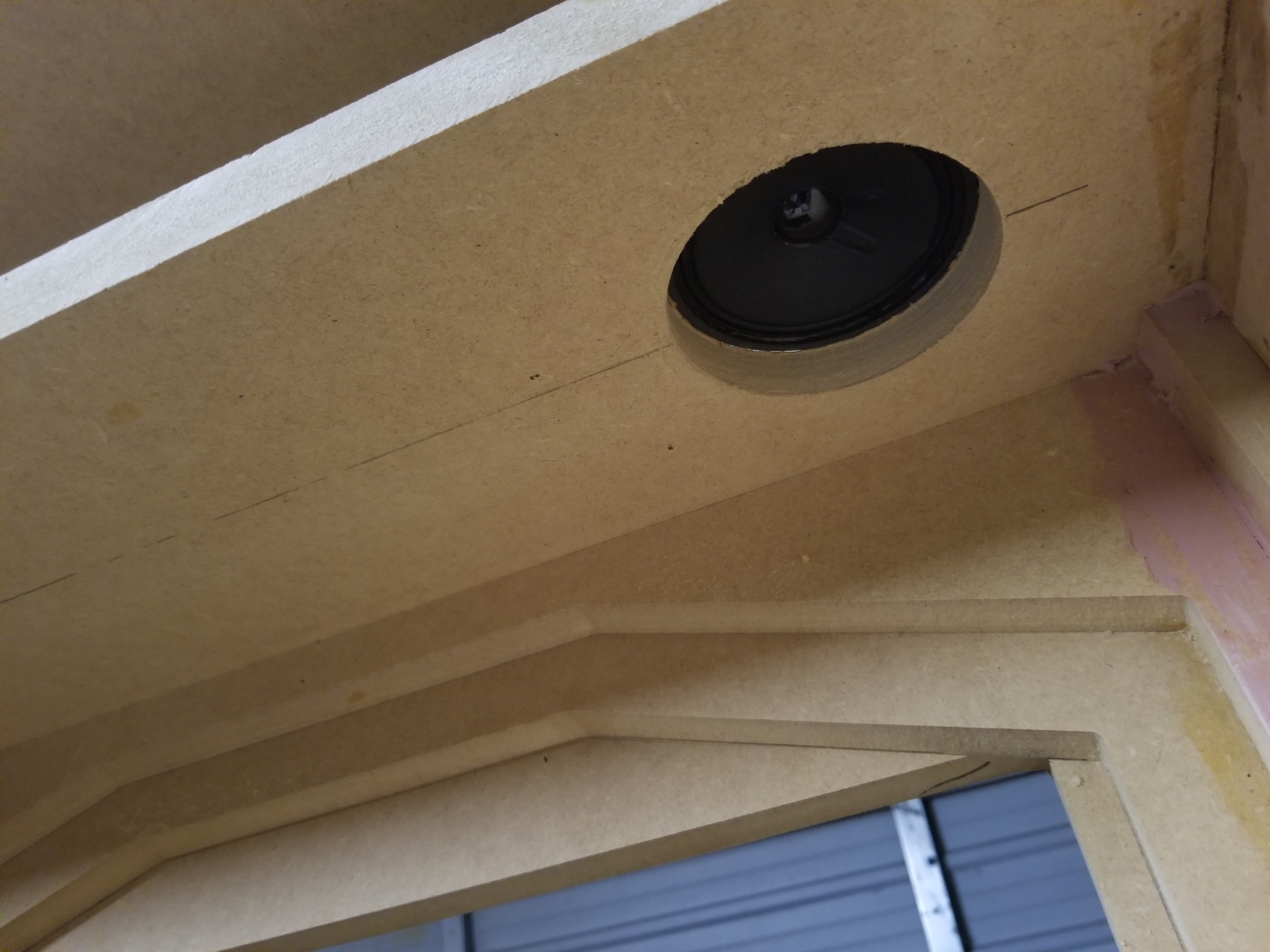

For the switches I laser cut a plate that I will epoxy to the cabinet and blend in with some bondo, and decided to add real arcade speakers to the marque area, so I cut holes for those too.
Not a tremendous amount of work, but it's something. I still need to cut slots for the t-track and figure out how I am going to install the joysticks once those come in. After that I'll take it someplace warm and paint it.

Is the right most switch supposed to be reversed?

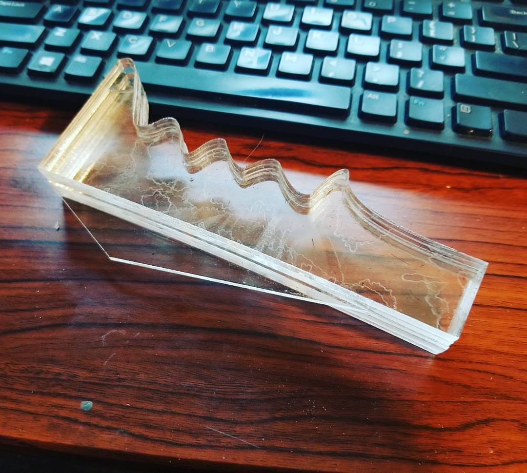

Alright....I can finally move forward a bit more. My joysticks came in. Now I can figure out the hole placement for them and finish the clean up on this. I also got bored last night and drew up a joystick that is as close as I can get to what Philip has. I don't expect this to be permanent, but it will be a nice placeholder until I get a more accurate one.
