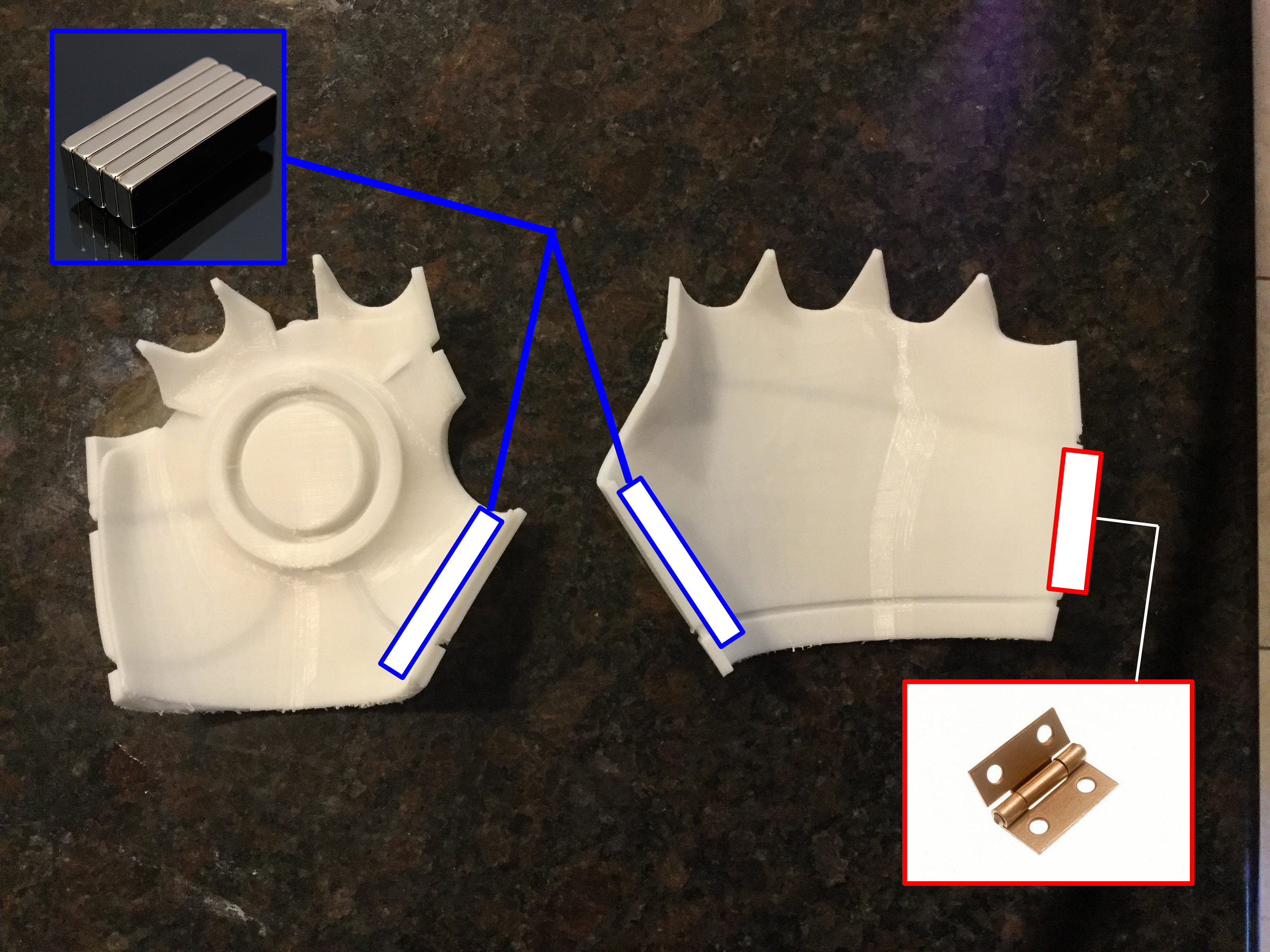

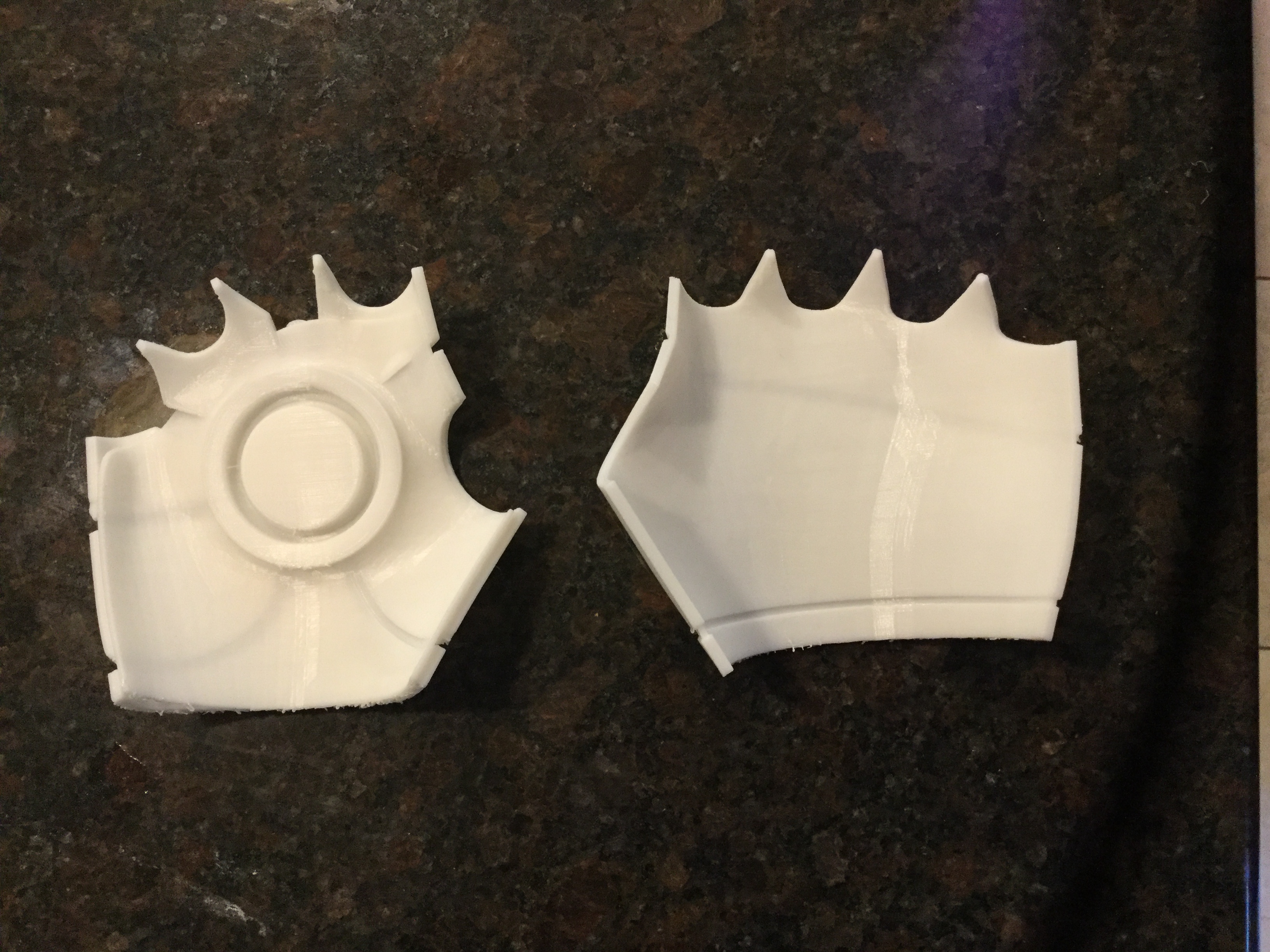

I'm totally new to this and have decided to tackle an Ironman Mk46 Build using 3D printing. I have the files and all is going pretty good but have what I hope is a simple question. The hand is in two parts...pic attached. I know it sounds simple, but I'm having a heck of a time figuring out how to put them together so they can open and close when putting it on. I've tried straps, magnets, hinges...I can get it kinda working but I get the feeling I'm missing something. So...rather than reinvent the wheel...

Can anyone suggest a solution? If you can post pics to show me, that would be awesome!

For my first 3d printed Iron Man suit (mk43), I cut a very small section out to clear a small hinge on the outside of the hand and used rectangle earth magnets on the other side to keep it closed. Works just fine for me. Hope this helps. Best of luck on your build

Thanks Tony...will give that a shot. I tried a prototype kinda like that but with smaller magnets...it wasn't staying closed. Seeing your suggestion, I think that will solve my problem!

I used the hinge and magnet technique on my own gloves. Try sourcing neodymium magnets with a decent contact patch and at least a couple of kilos of pull.

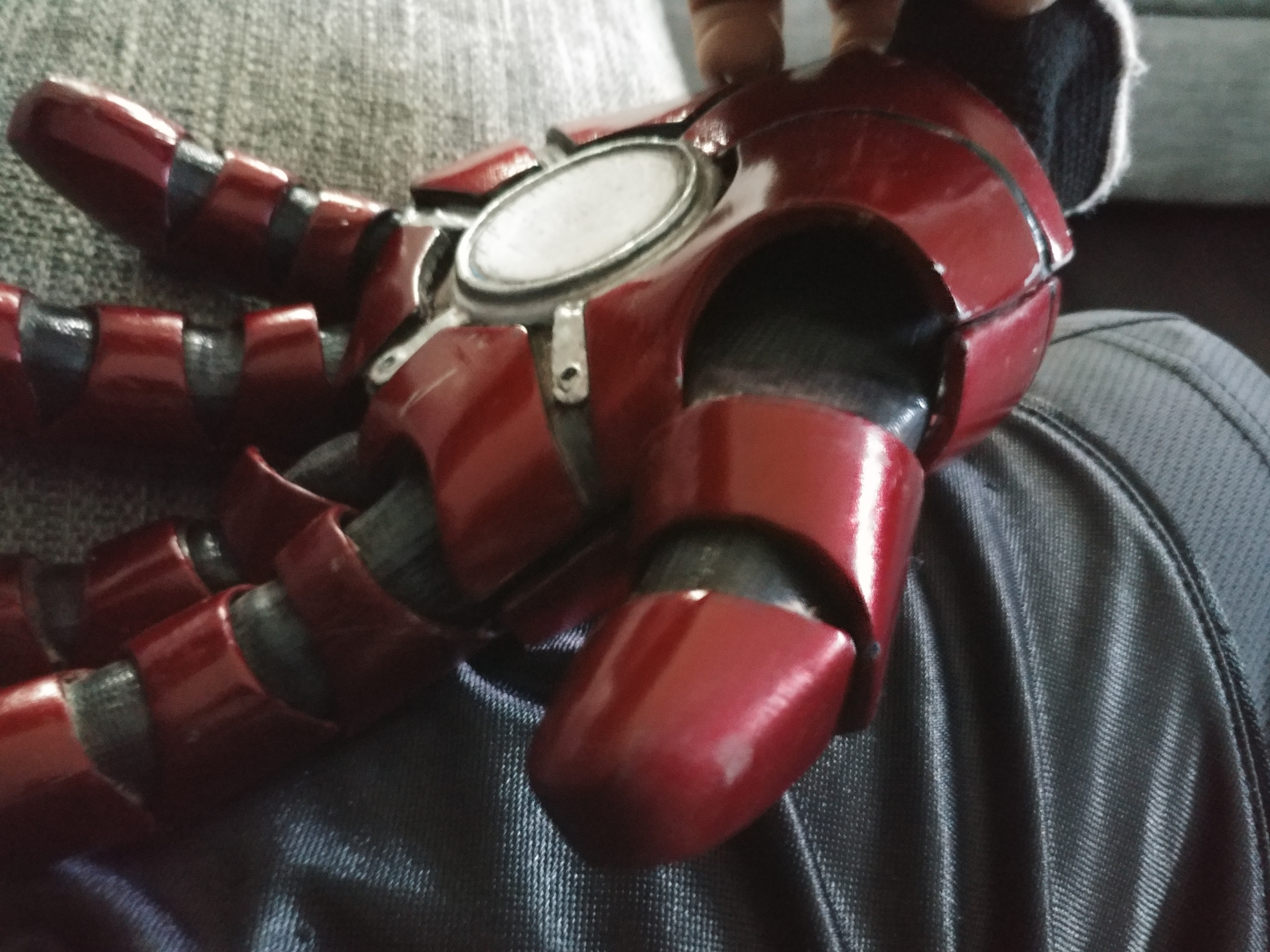

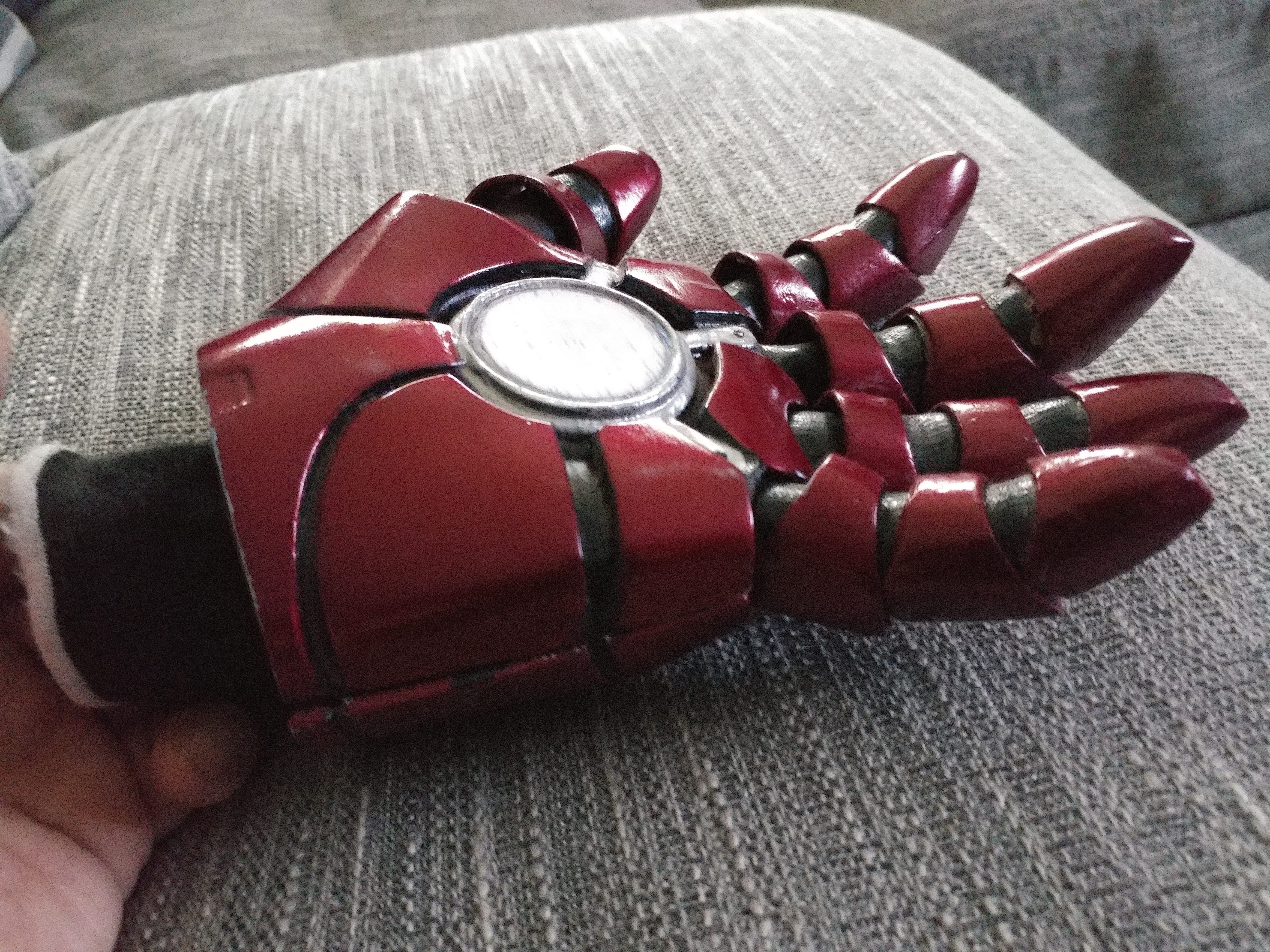

I found that using elastic along the inside of the two halves ended up being my resolve. I did do the hinge and neodymium magnet setup and it would pop open whenever I made a fist :(. Got tired of it; after last year I decided to give up a bit of cosmetic accuracy for a suit you can wear without worry of pieces popping off lol. The whole glove slips on; the halves stretch over then pull back together. There IS a visible seam on the side of the palm but hey...when your handing candy to a 5 year-old in an Iron Man suit trust me they don't care one bit lol. If someone has a more secure way to mount the magnet I'm all ears....and yes this place is awesome. Tons of good people and knowledge. I normally lurk but with such a good community I feel compelled to give back a bit. If it helps someone, awesome. Here's the glove:

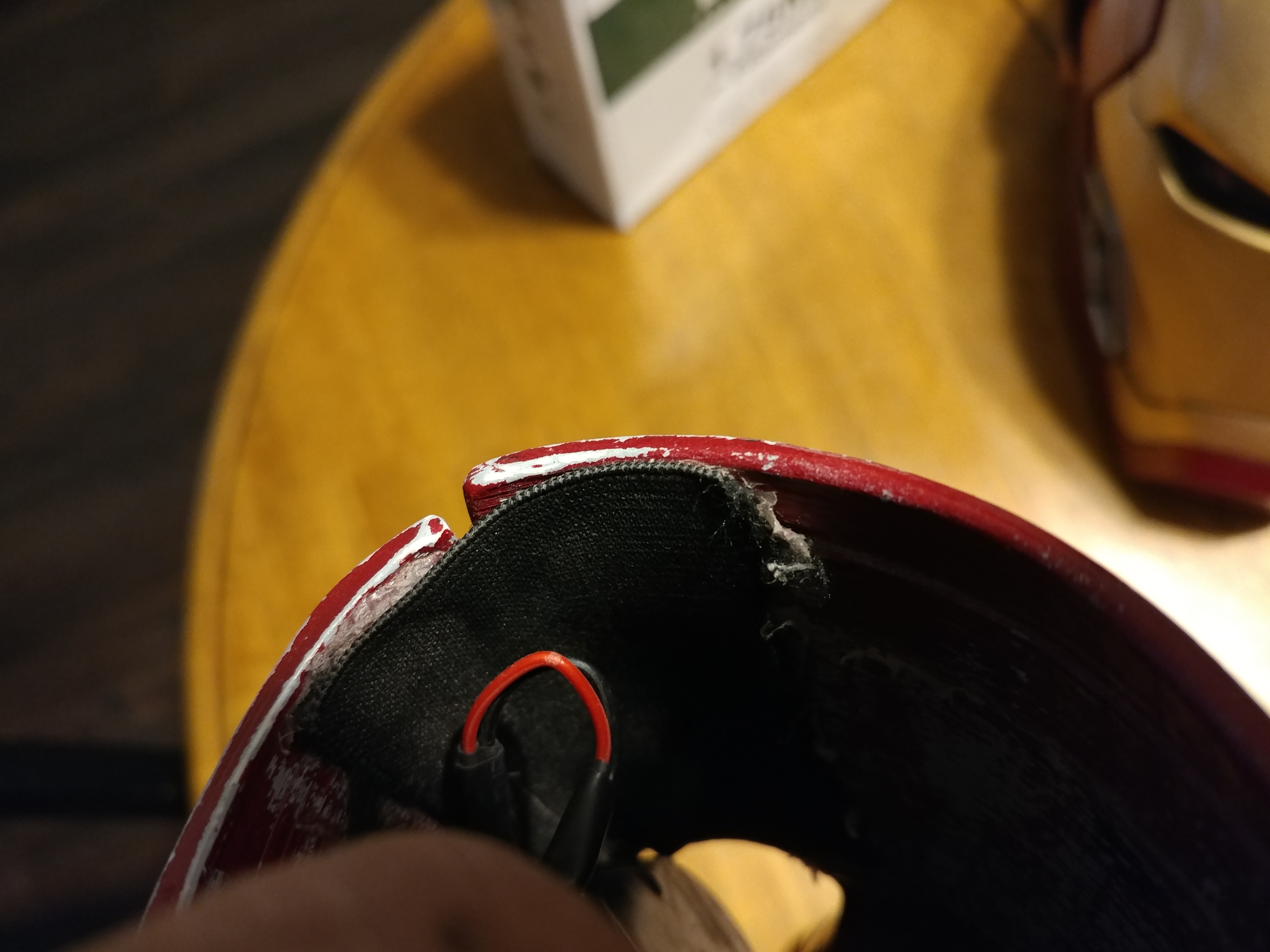

Great looking mk46 gloves. Can you show details of the elastic closure please?

Have some miles on them. Nothing fancy...wide strap hot glued in place on both sides. Having given this some thought I may bond a new palm to a new glove and magnetize the top piece. Have the new hands printed just not the time.
