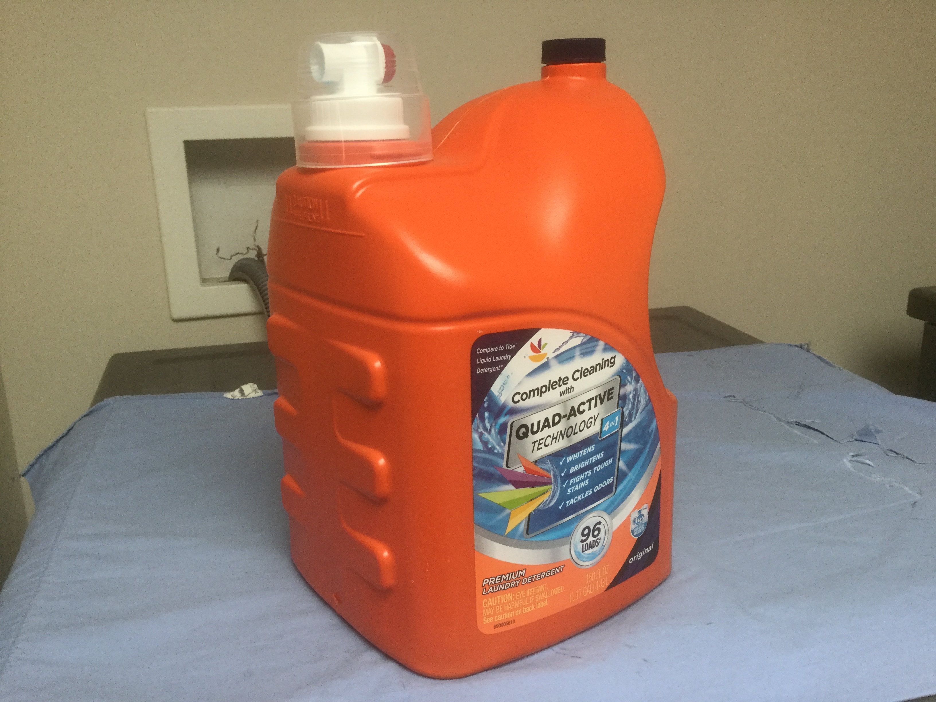

I started out with 2 laundry detergent containers from my recyclables bin.
Using a scissor I cut the containers down.

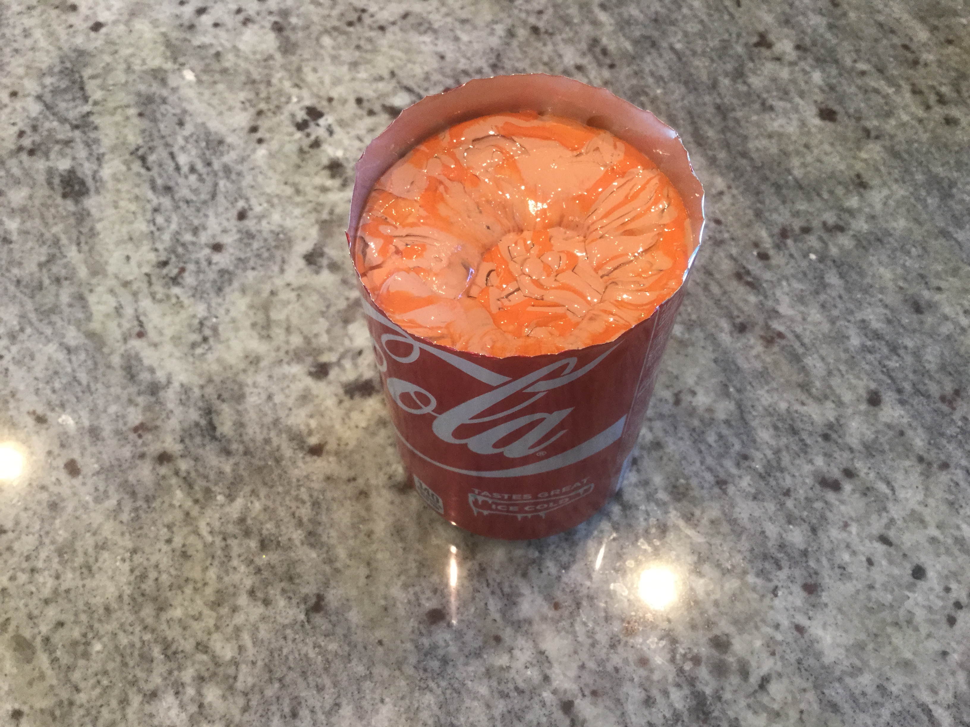

I cut the top off of a soda can and put the plastic clippings into the can.
I baked the clippings in the oven at 350 degrees. Here is how it turned out.
I must say that while the plastic was melting it had no odor whatsoever. However, there was a slight hint of the perfume of the detergent. More to come soon.

The Piranha; the hot plastic when it came out of the oven is not pourable. It's a hot lump that is flexible and pliable but it is not a liquid.
x197; I used an old toaster oven, which I use for hobby purposes. If anyone else tries this I recommend the same.
The plastic shrinks quite a bit after it has cooled off over night. You can see this by the gap between the plastic and the can. The fact that it shrinks so much as it cools is something to to take into consideration whe doing this
The lump of plastic slides right out of the can.

I haven't gotten around to trying this myself yet, but I've looked at other examples on the web. Some people will use something to compress the plastic while it is still molten so that there are no gaps or voids once it has cooled down. Some people cast it in cylinder shapes which they can turn on a lathe, which I think is pretty cool... if only I had a lathe :D
Yep, the best way to avoid gaps is to compress the material while soft. Wood, MDF molds or plaster can be of use. Clamps of course are a must. Make sure to use some kind of vaseline or wax paper between the plastic and the mold for easy release.

joberg; That Is good advice. I used a clamp to compress the plastic when it was hot.
