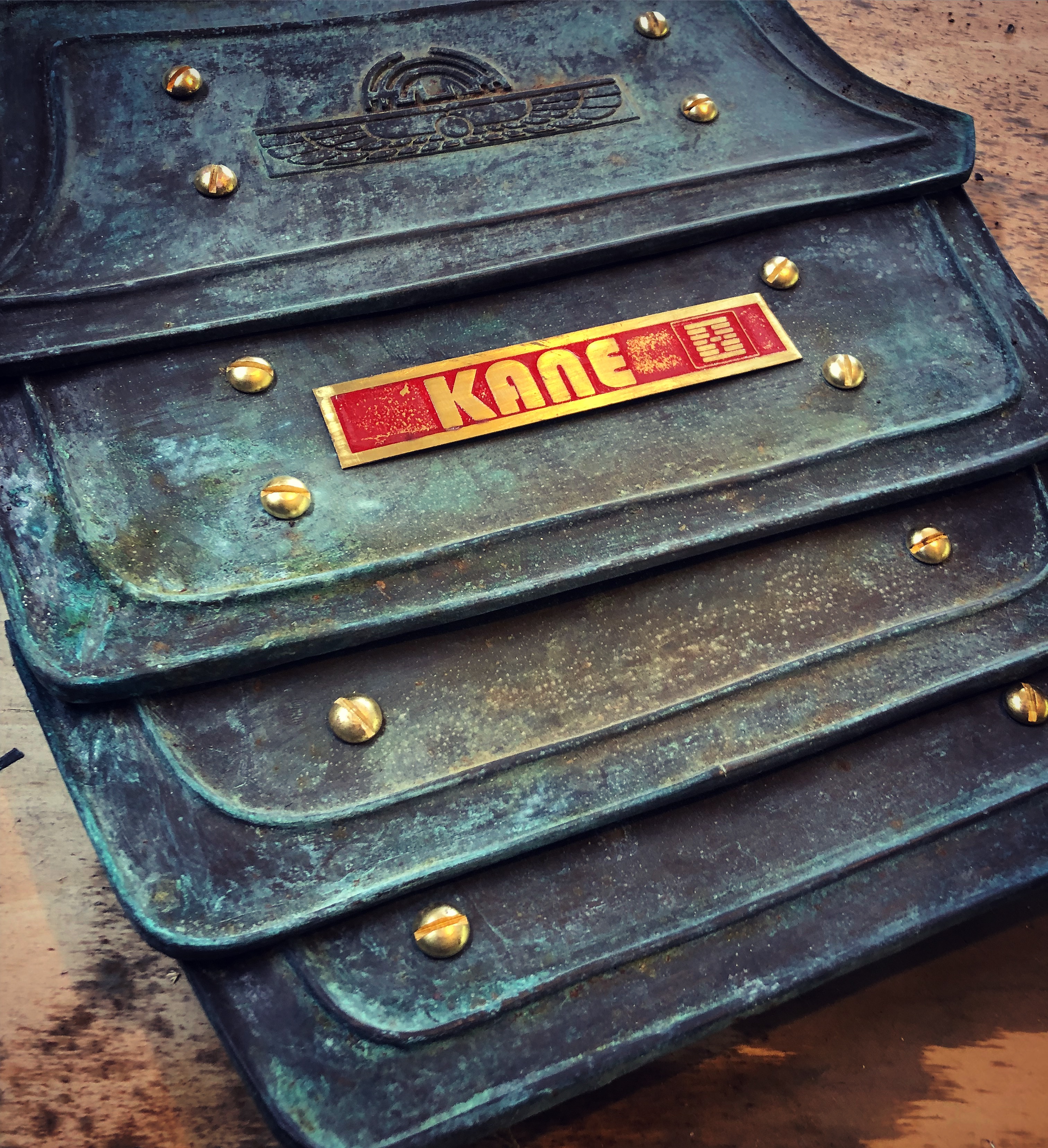

thanks! but no, all the parts are cold cast bronze , you buff them with paint thinner and steel wool. then spray down with vinegar and salt , wrap in cling wrap and it patinas. then i heat them with a heat gun and it speeds up the patina process.
Wow!!! Nice. Turned out spot on.

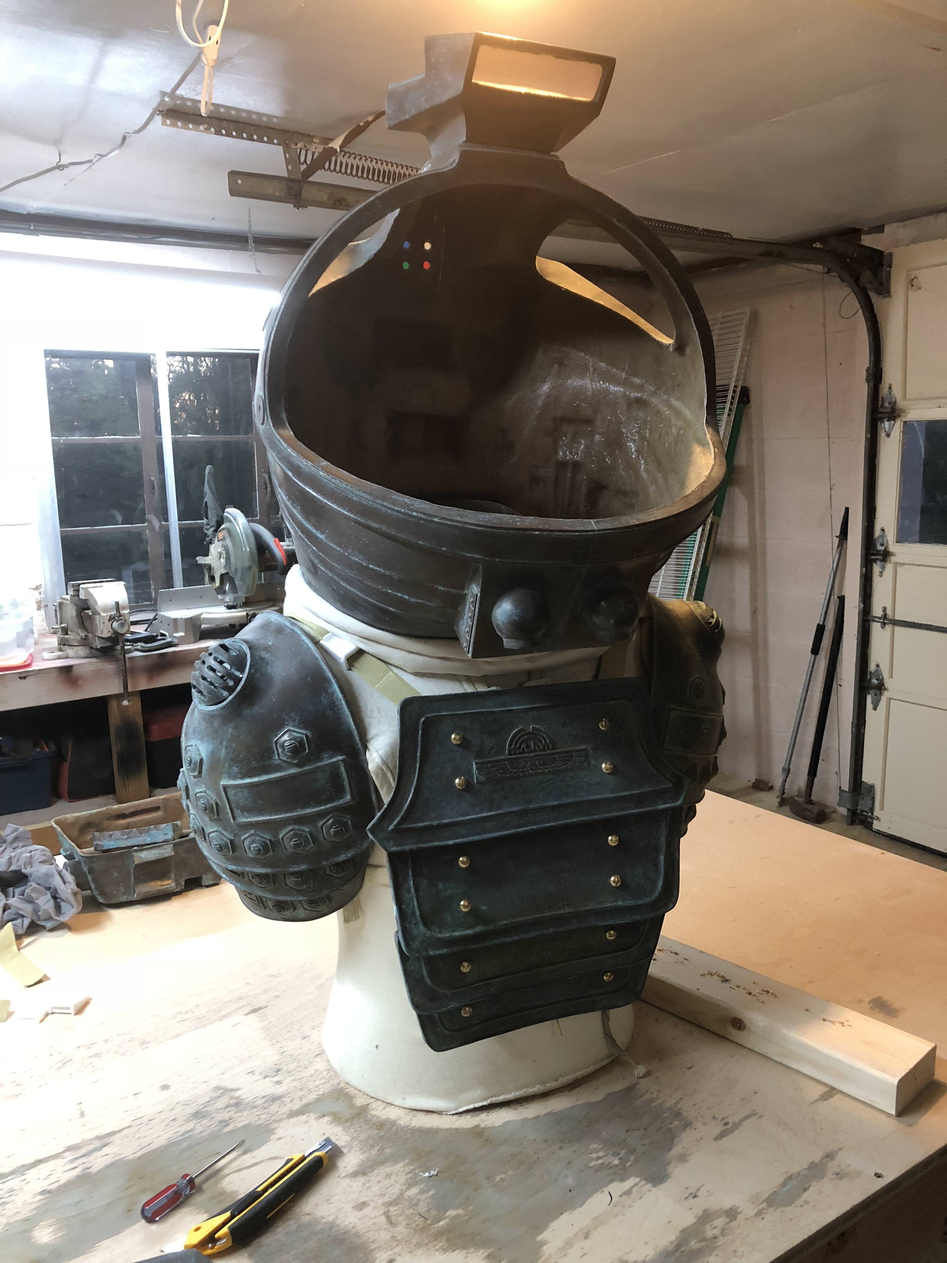

thanks, big update.
starting the interior , not many good photos of the inside of the helmet. so i am basically finding some parts and just going with what i think it is and of course both side are different...LOL
i plan to 3d render all the control panels on the inside but laying them out in foam and wood first for sizes.
on the dummy ..
wrist bands.. these turned out pretty good.
me wearing the suit so far.

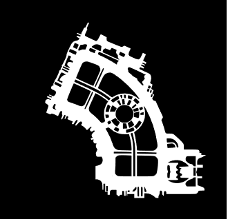

Thx for uploading the etchings!!!
I hope it’s ok that I use them for my EVA suit project ?!
I’m planning to 3D print them, just a millimeter in height, so that the material is flexible and I can glue it on the helmet...

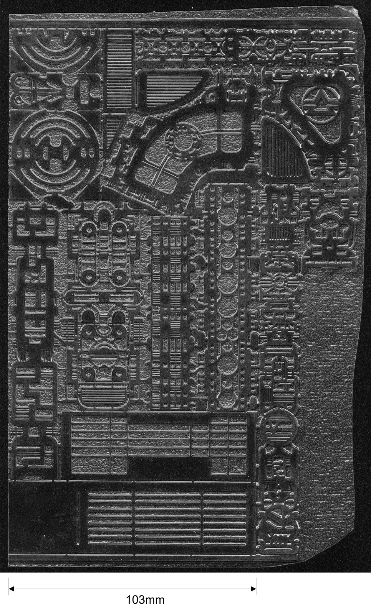

Testing one of the etched parts from an experiment.

One of my earlier etching attempts. Researching glues at the moment to make sure this thing stays on.

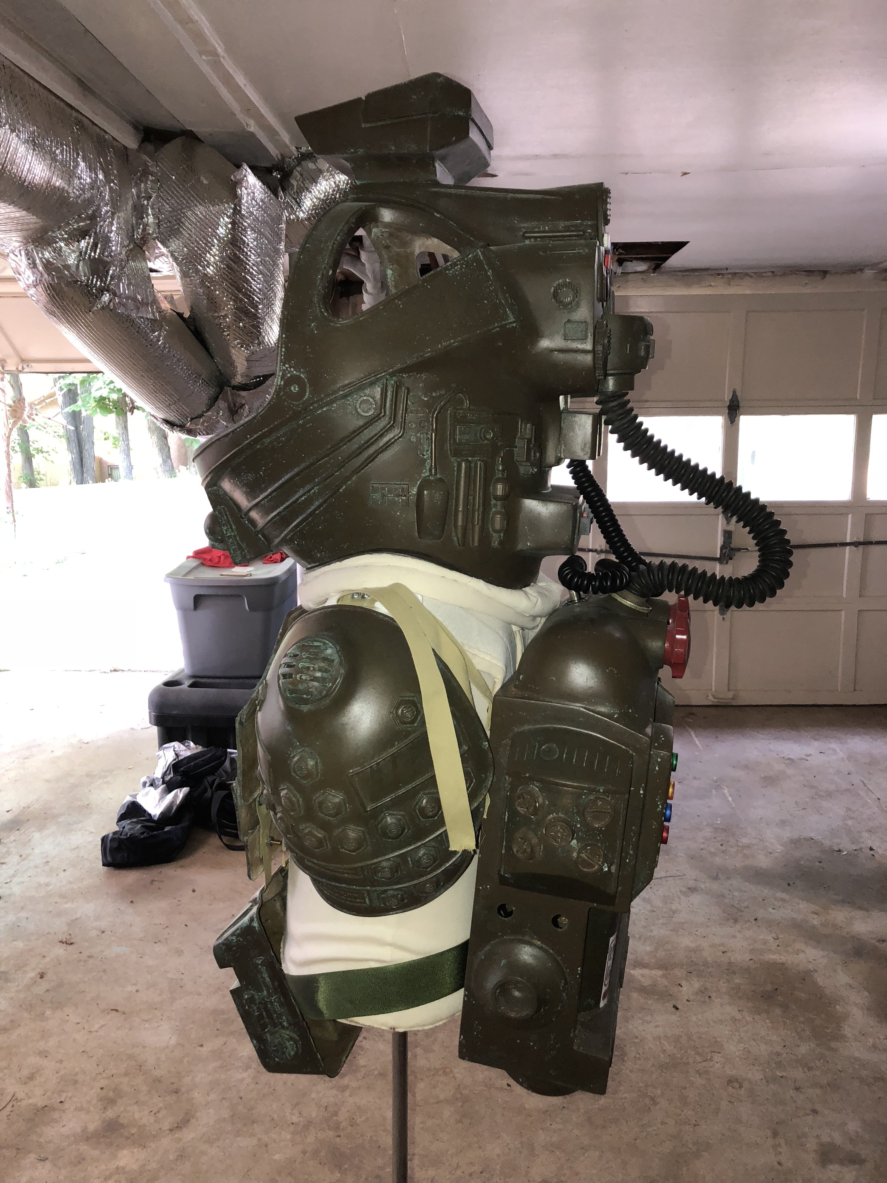

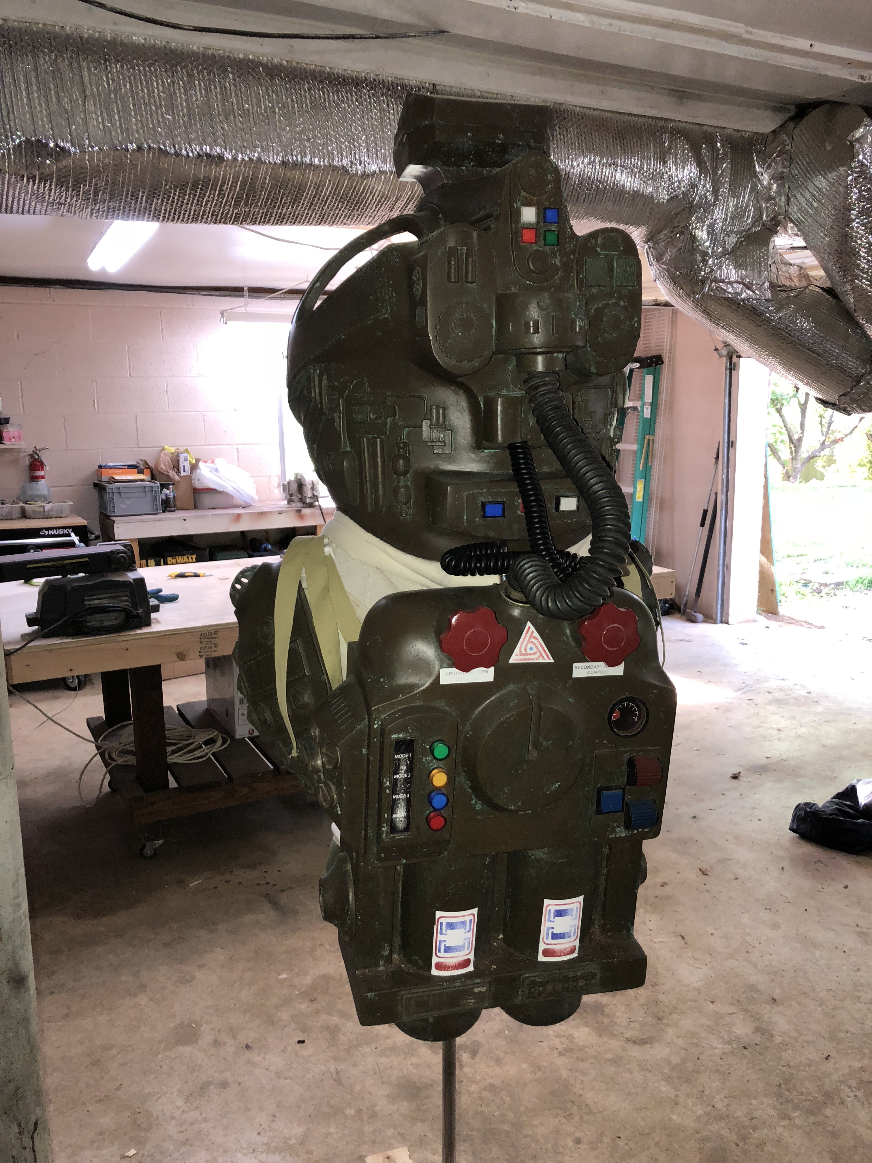

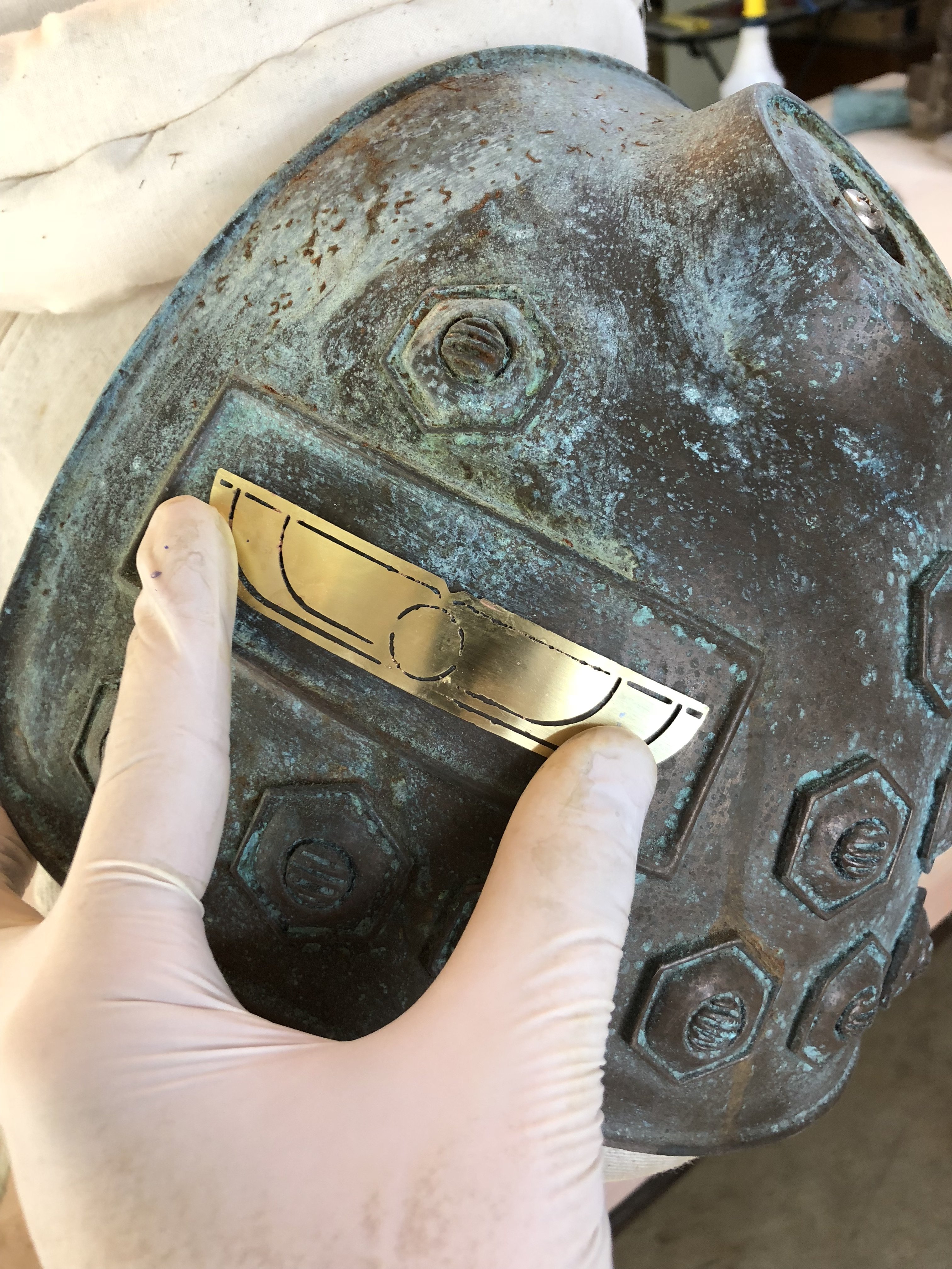

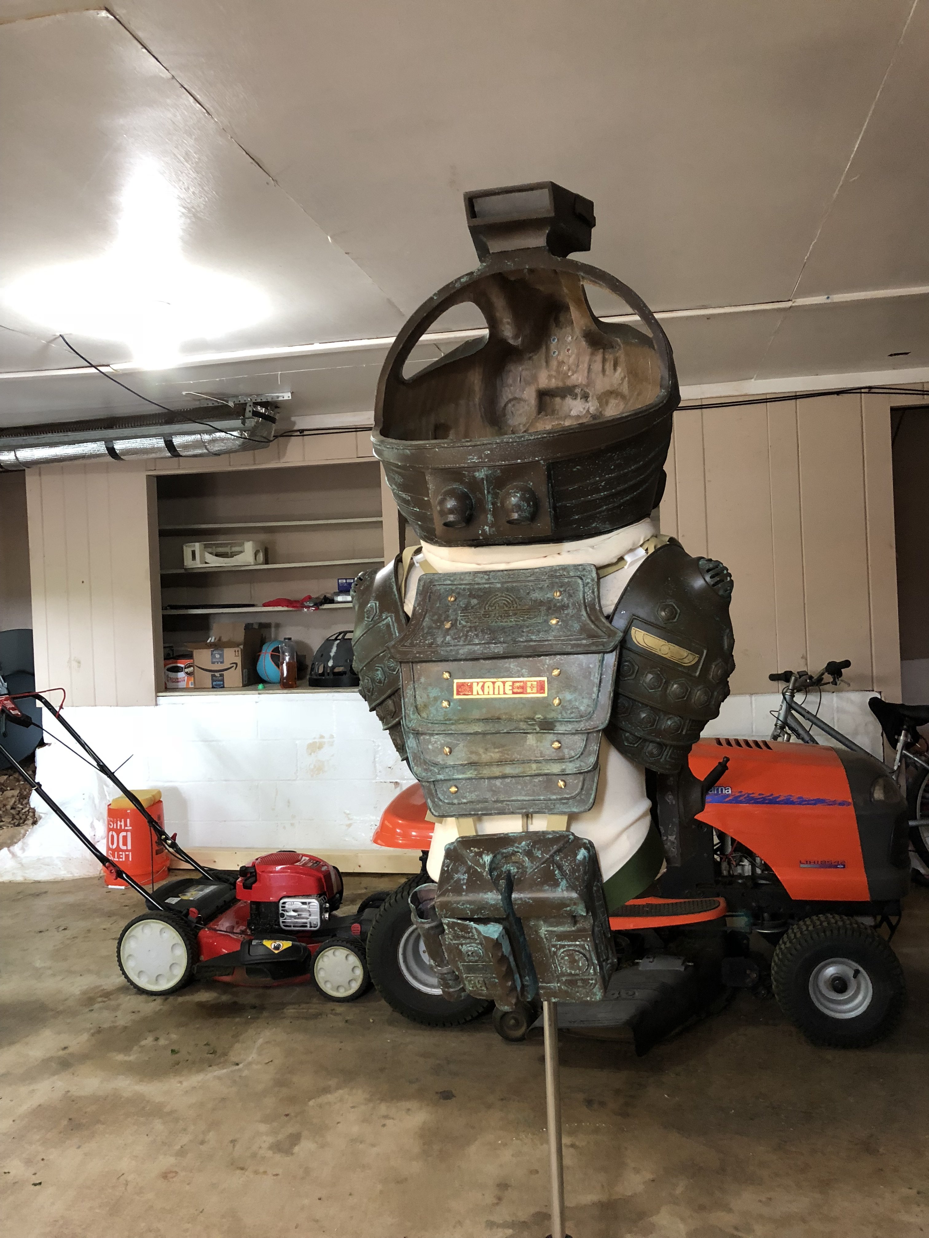

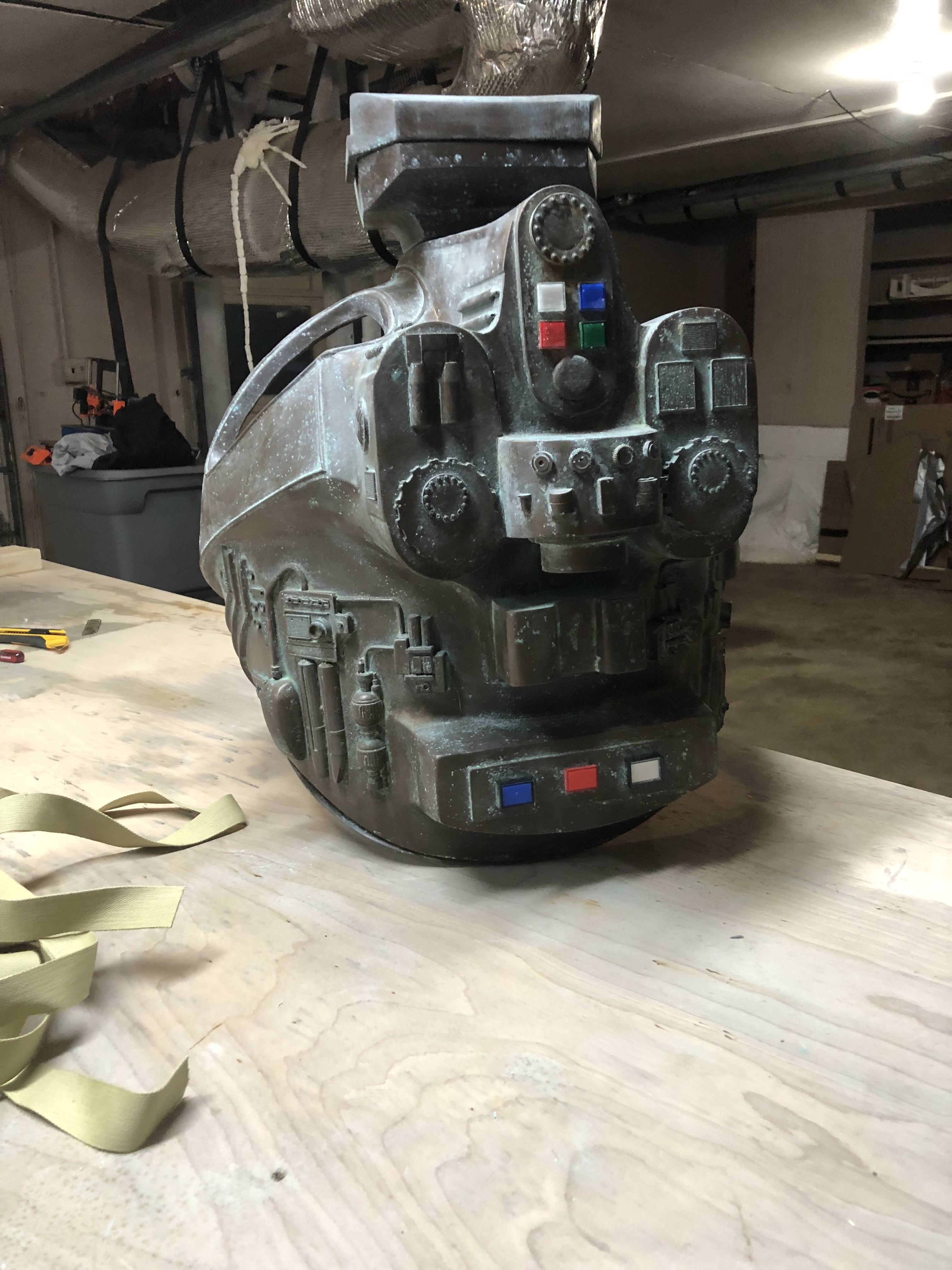

Finally getting everything pit together in one place and testing the fit. I still have to add one more of the handles to the stomach box and paint the other one. Also got some of my test brass added to the shoulder bell and name plate.
I have the hose and power cable plugged up and also added the clear dial cover
Side view

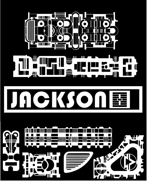

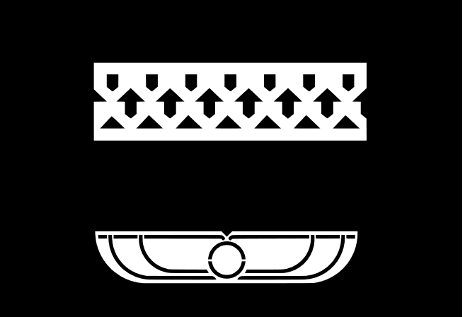

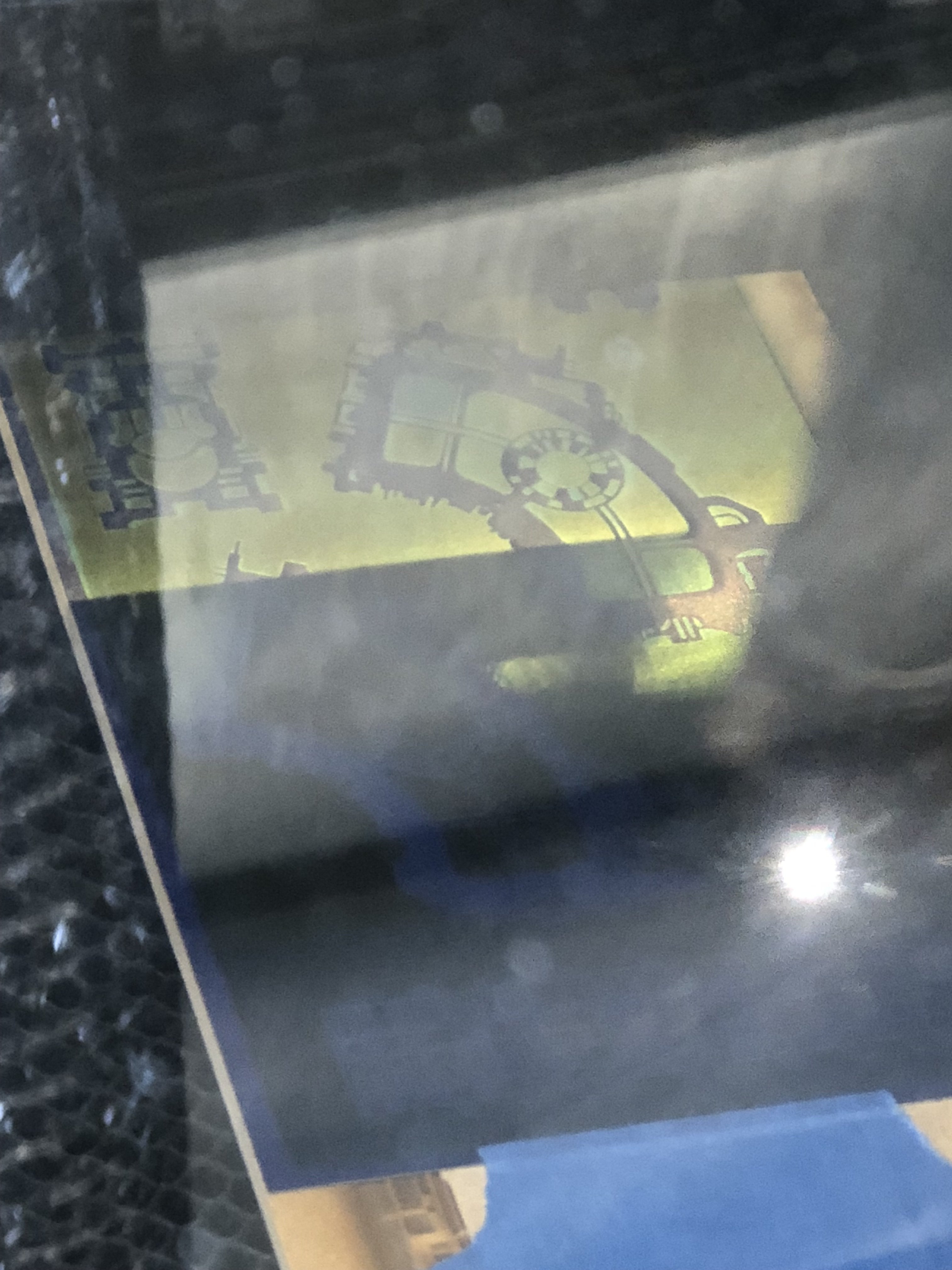

Stopped by to see my local millennium falcon yesterday to get some parts laser etched so I can start getting some brass on the helmet.
Bonus:

Hey C,
The suit is really coming along! I hope the brass etchings work out. If so, we just found another reason for the laser cutter. Looking forward to seeing more! Excellent work so far.

Thanks Sofa! I should be able to start etching tonight. Fingers crossed!

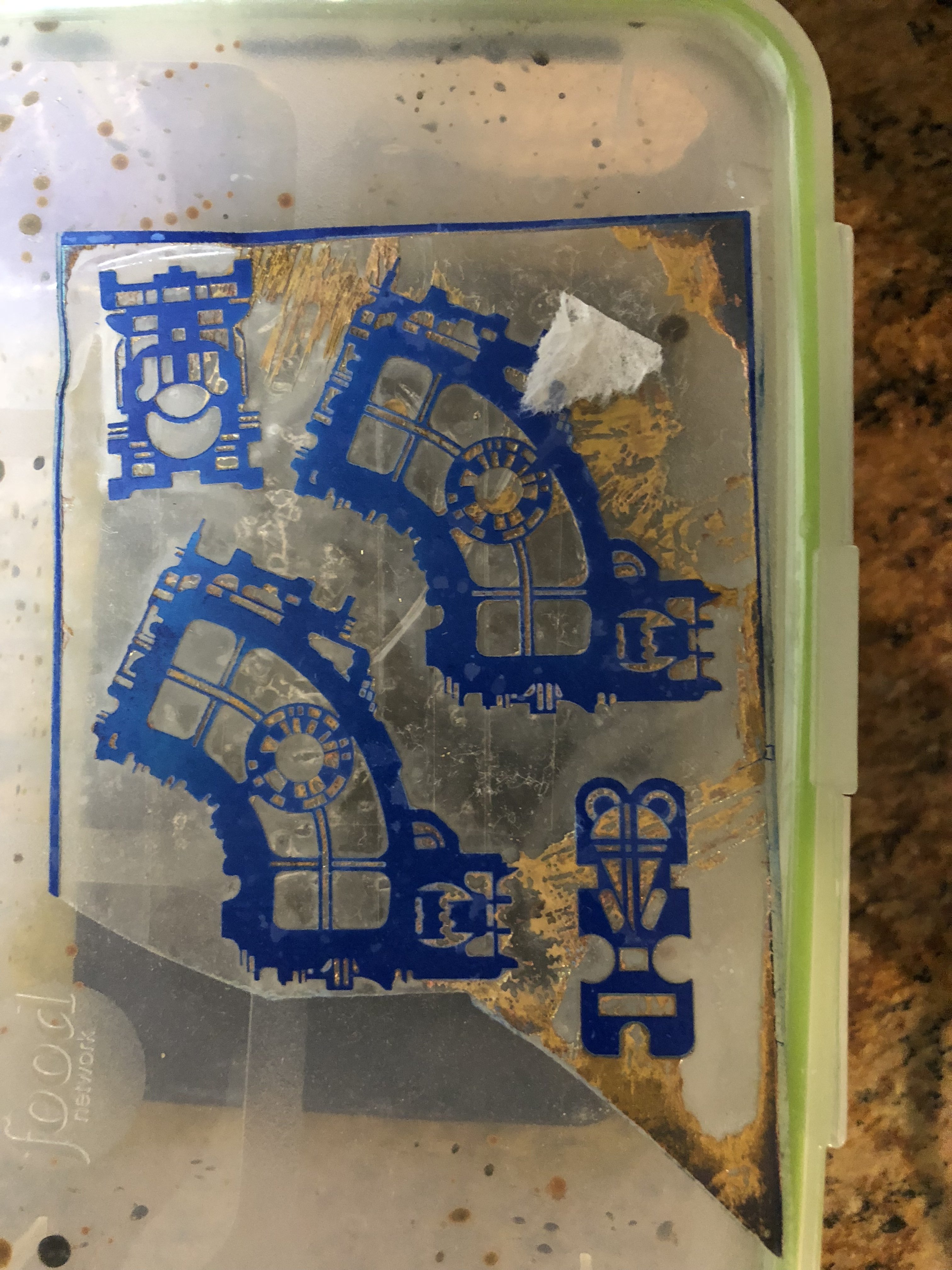

Re: Alien environmental MK50 suit group build PIC HEAVY
Started to etch the parts from the laser cutter last night, took about 4hrs to get to this point using ferric chloride acid, still about an hour or so more to get through the rest but this is going to be the way to go.
