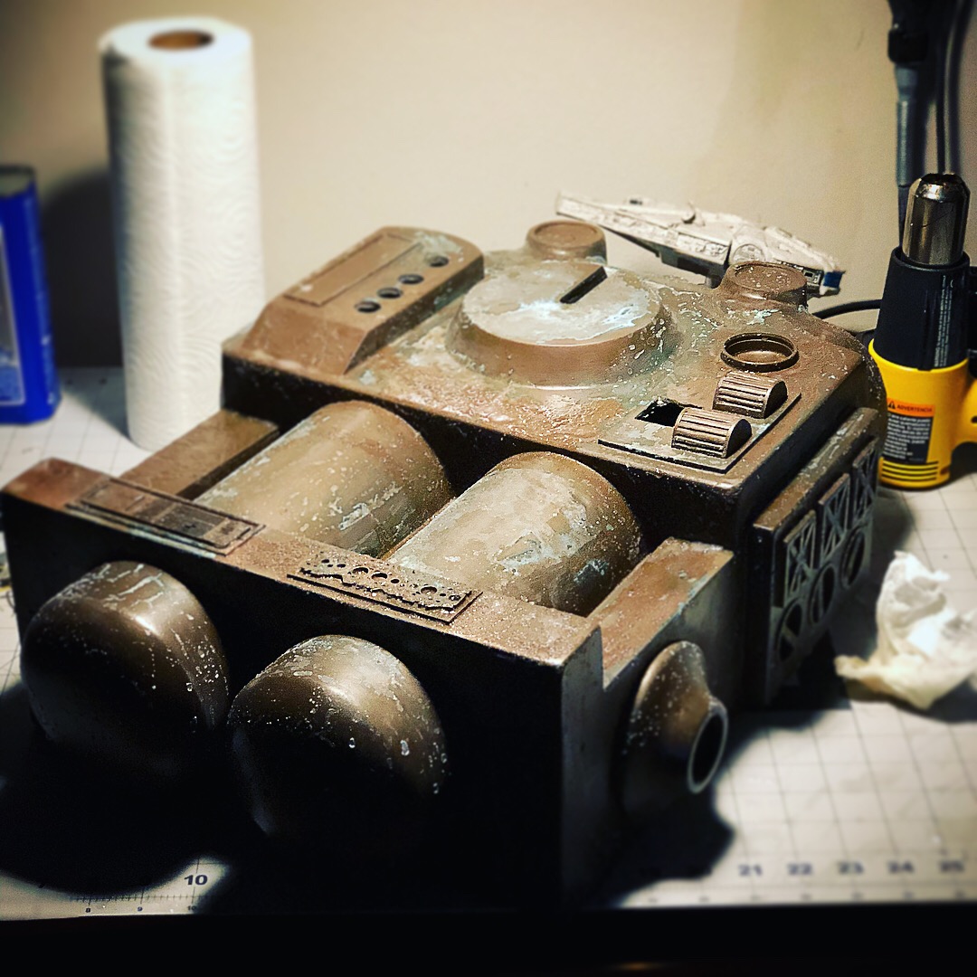

playing with weathering options and i think i found a winner. since we are cold casting these in bronze we should be able to get a good patina on them like the originals. first i polish up the surface with paint thinner and steel wool. then i used a mixture of vinegar and salt and brushed down the surface on the armor. then wrapped in cling wrap and left over night.
cleaned up alittle with steel wool.
then final clean up with steel wool. i might go back in with some black shoe polish also.
[url]http://i11.photobucket.com/albums/a178/oneeyedtom/th_20171111_130127.jpg[/URL]
[url]http://i11.photobucket.com/albums/a178/oneeyedtom/th_20171111_130131.jpg[/URL]
[url]http://i11.photobucket.com/albums/a178/oneeyedtom/th_20171111_161705.jpg[/URL]

here is the pack weathered and some of the lights attached, still need to finish painting parts of it. and we also need the pressure gauge decals plus the other stickers. plus the toggle switches which i have and the u brackets on the corners.
