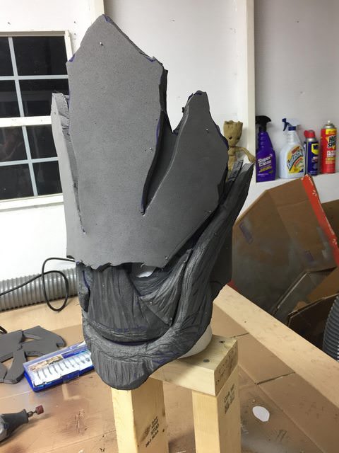

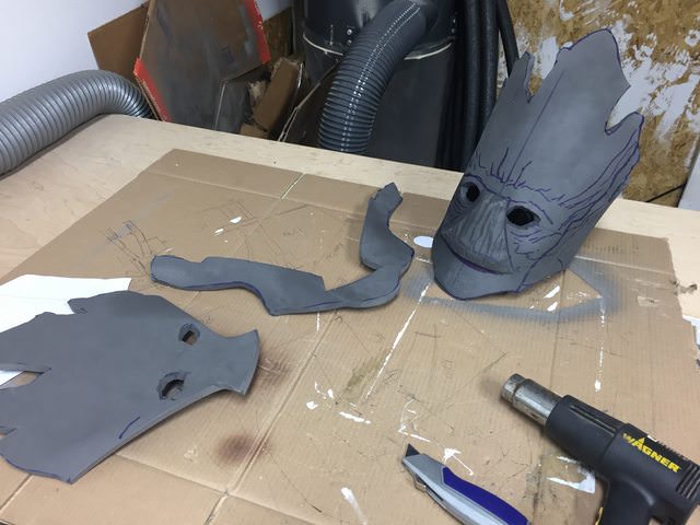

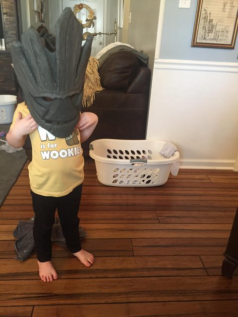

Head - constructed of 3/8 EVA foam mats (harbor freight)
Went for a little cheerier expression since I will be with my 3 year old
All construction done with Razor Blade/ Dremel Tool and glued with Barge Cement

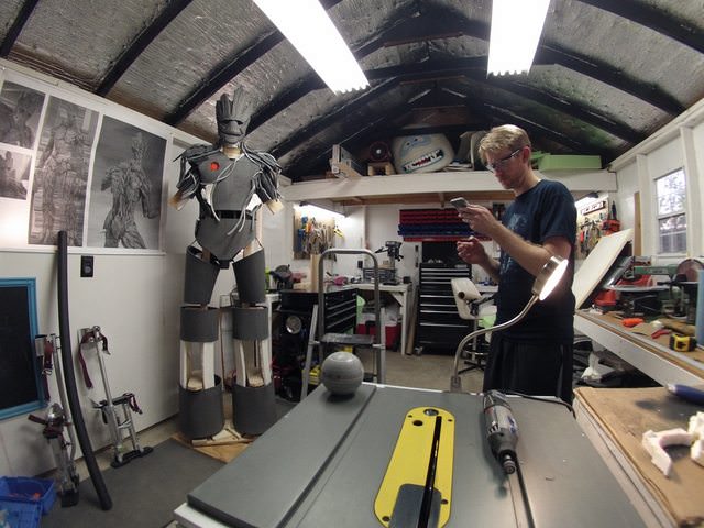

Legs will be Painter Stilts (16in to 30in) adjustable Aluminum (bought on Amazon)
I made the foam structure so the leg (skins) will be able to be unbolted from the stilts both for transport and storage.

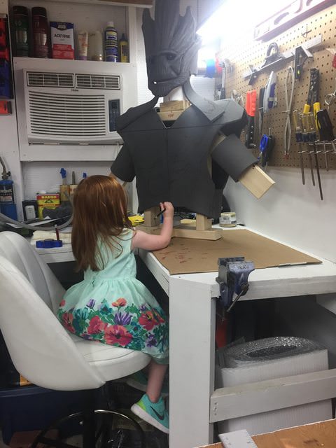

Base Torso-
Ace helping out

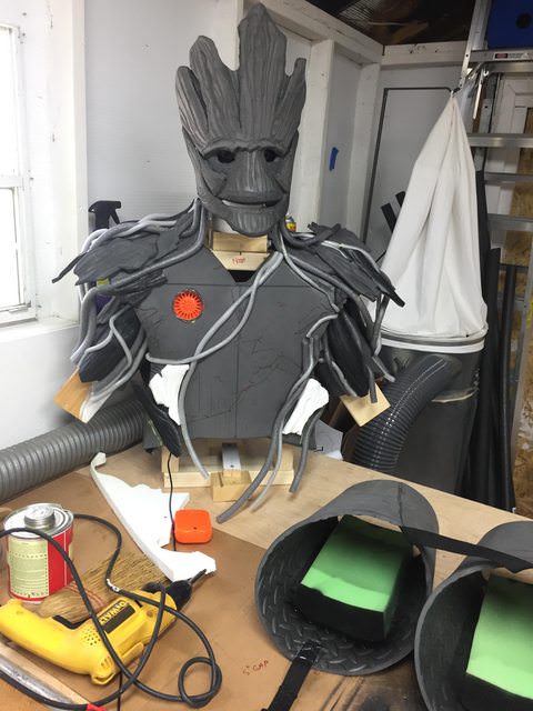

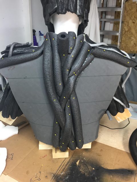

Re: Groot Costume - GOTG Vol.1 (WIP) 2017 Halloween

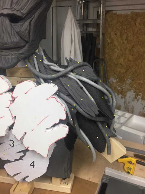

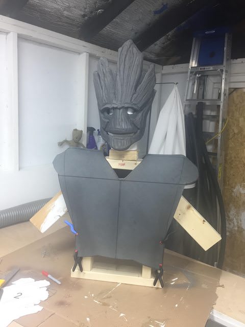

Mock up with paper Templates
Pinned foam for Mock up
Using Rare Earth Magnets to my connections between Bicep and Shoulder
Large foam parts are pipe insulation smaller ones are for door and window seals (bought these in 3 different diameters)
more to come..

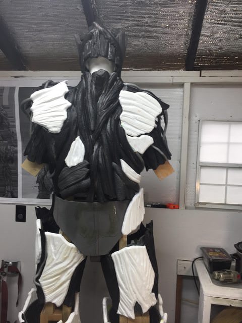

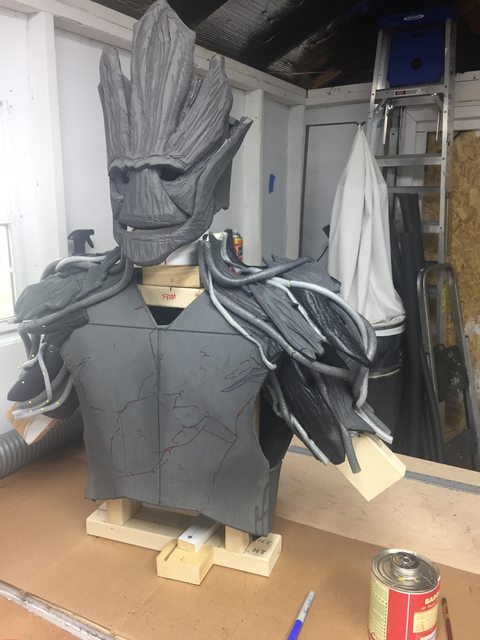

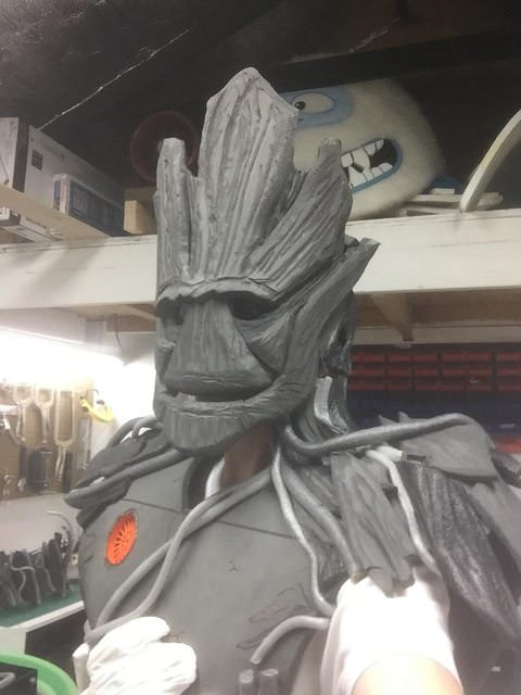

Carve Torso bark - (recycled Bumble) L200 3/4" Foam
Height Check 7'-7" (so I can fit in anywhere with a 8ft celing
Test fit Selfie
So happy so far feels comfortable - nice cool breeze on my neck and face and mobility feels pretty good- the connected vines with the magnets is a nice effect as well when moving my arms.
to be continued...

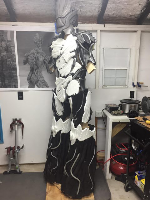

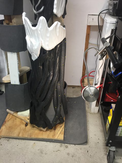

Some progress on the legs-
Mock up of what I have built so far

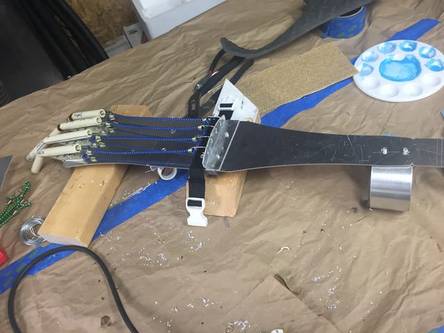

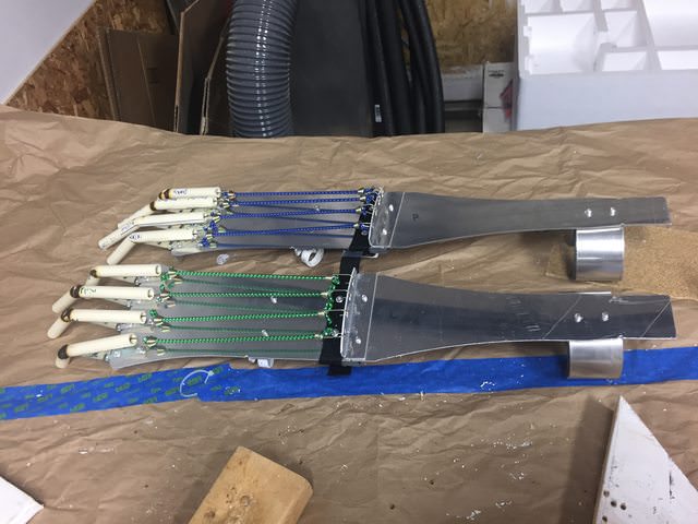

Also built my Arm extensions -
Frame made out of 16ga Aluminum.
Single mechanical Movement
Mini Bungee's for spring back
fingers out of CPVC notched with saw - heated with torch and bent to shape.
finger rings made for 1" PVC and beveled
Dude this is so awesome. I love seeing these family costume builds (and reminds me of the failures of my father :D)
Legs done!
and started on finishing the back.

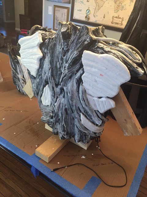

So was horrible about taking pictures this weekend...but still got a few.
Back complete-
finished his rump as well but forgot to take a pic.
got the fingers done on the hands
and with the help of some friends we got 3 coats of flexbond on each part and 5 coats on the legs...so probably Tuesday I can start laying some paint.

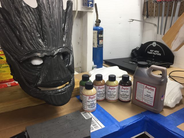

I will be using Angelus Leather Paints. Probably going to have to make some custom colors as well as mix in some duller.

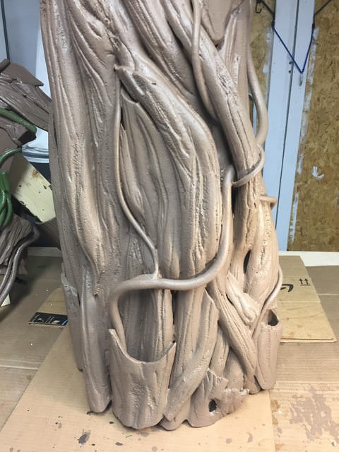

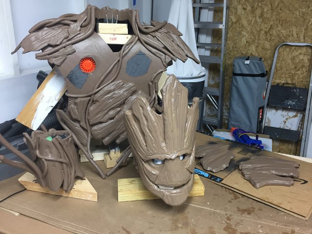

Laying my Base coat down
Paint goes on great I made a custom color with Taup and Play in the sand with 8% duller to flatten it out a bit.
decided it would be easier to detail paint the vines under the chest bark so the gray area shown is for my glue attachment that I will do after.
Happy with how my carving looks now seeing it all the same color ...
So more to go so stay tuned!

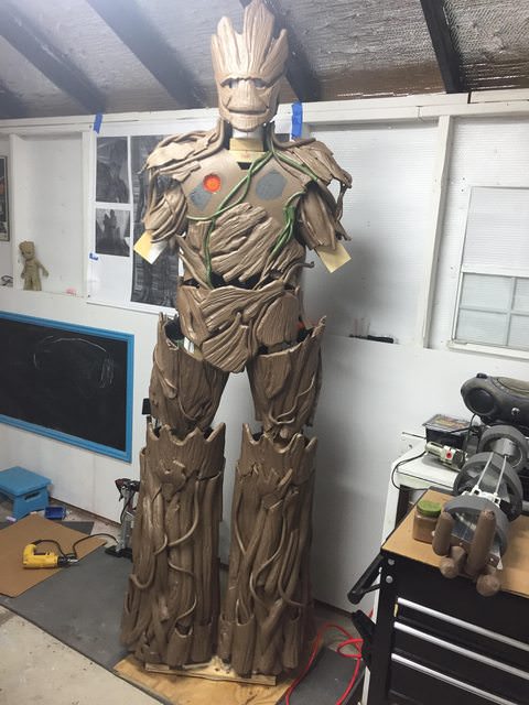

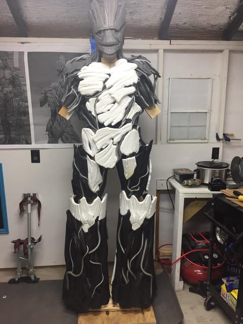

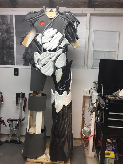

So finished Basecoat on everything but the arms (have to do those in 2 steps due to moving fingers.
so Right leg
mock up of lower body -the waist is actually just sitting on those thighs so looks a little wonky
Full mock up on the right you can see the painted fingers for the hand. next step on those in the palms/thumbs and arm organics
also pre mixed a few colors for the final paint with the duller additive
Probably do a test fit sometime this week and then go HAM on those arms this weekend.

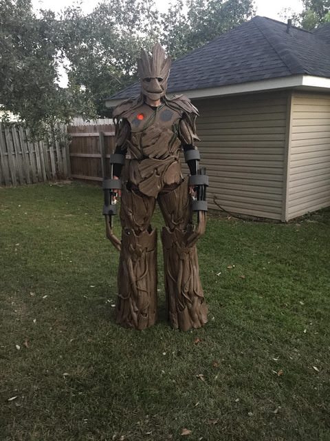

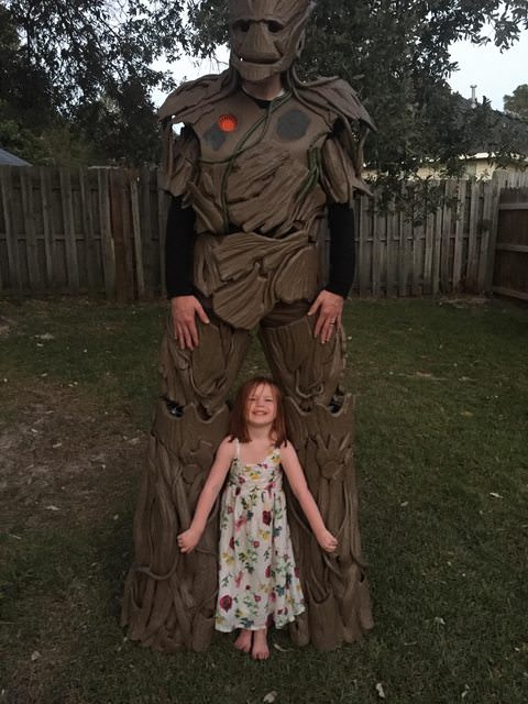

Test fit
got a few minor tweaks on 1 velcro connection and might add two buckles for the hip/torso connection just to help keep things aligned. overall went as planned. also have a good idea of what parts of me are exposed on the under suit.
good news is the cooling worked well it was 89 when I put it on and after walking around the yard for about 30min I was always comfortable so I am sure I could make it an hour in 90 degree weather easy.
