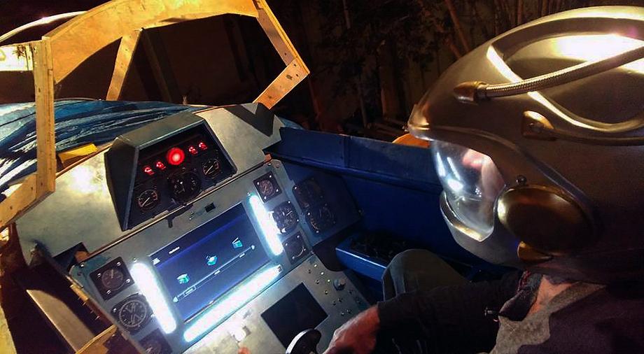

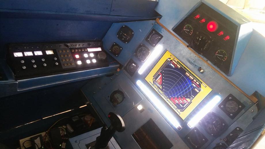

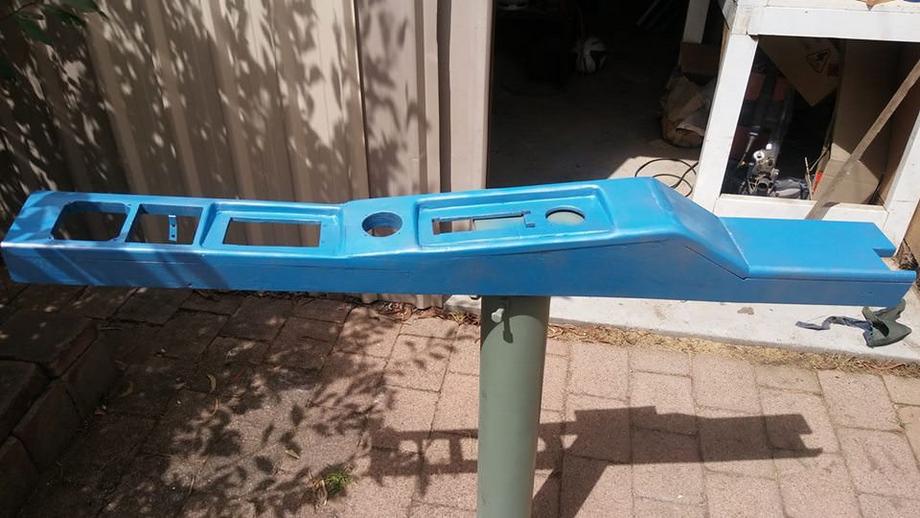

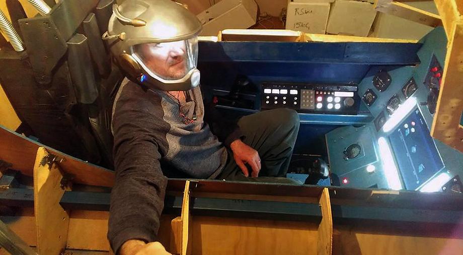

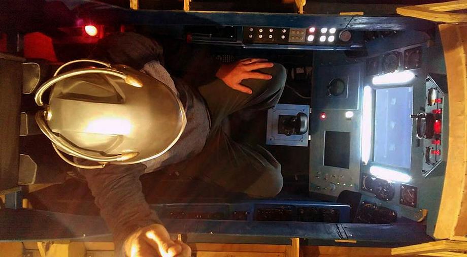

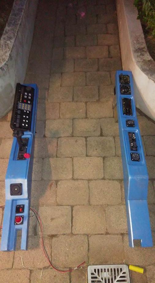

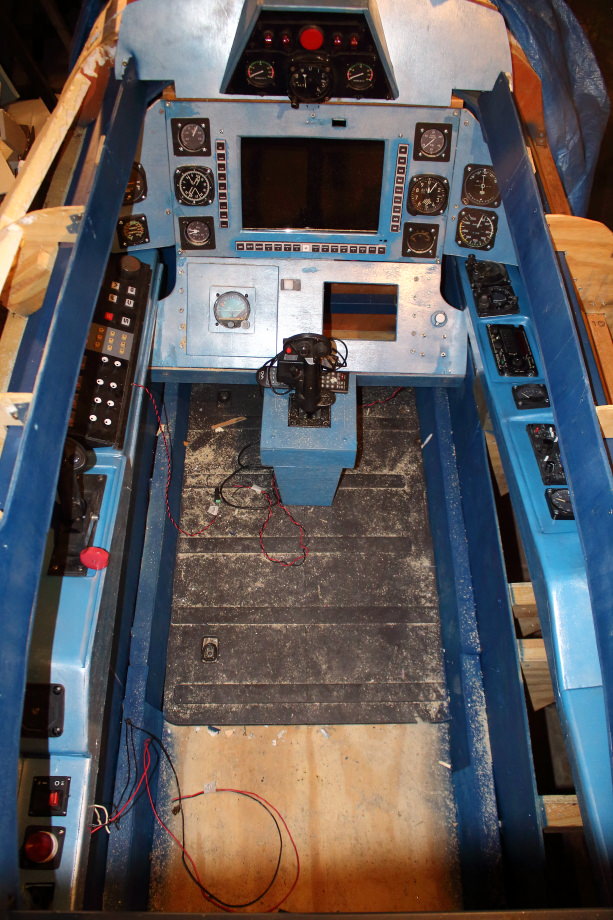

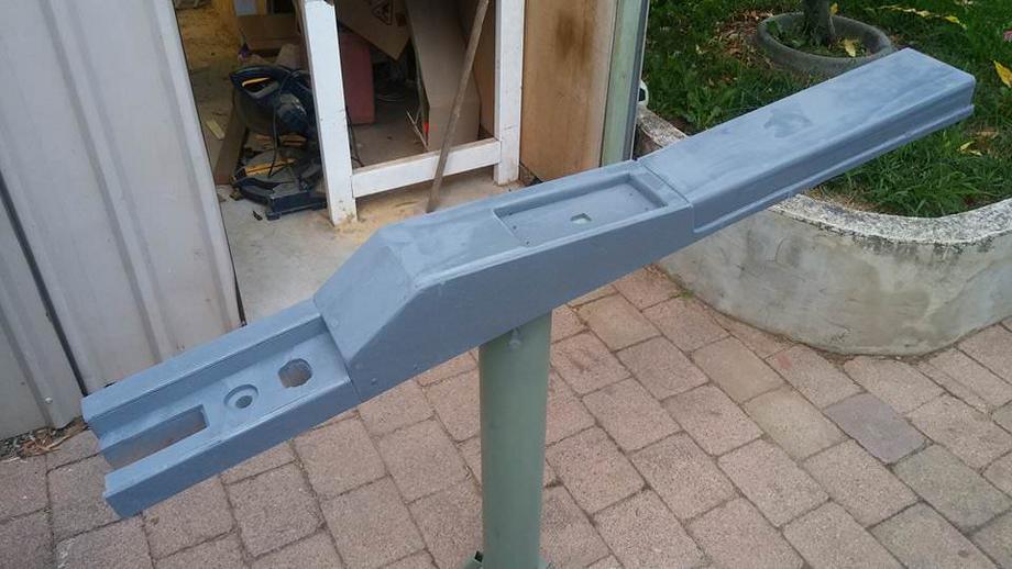

After a colour correction, I moved onto the port side instrument shelf.
Some tweaking to do now to make the starboard shelf fit. There's a former block in the way of one of the protruding instruments. Job for another day. I think I might even have a little sleep tonight.
Awesome! I am working my way up the sides as well and was debating on what to make the side panels from. Looks like wood works pretty well! You really pulled off all the contouring! I'll see if I can get those labels printed and sent out to you since you are getting close!IMG_20180202_211438870.jpg

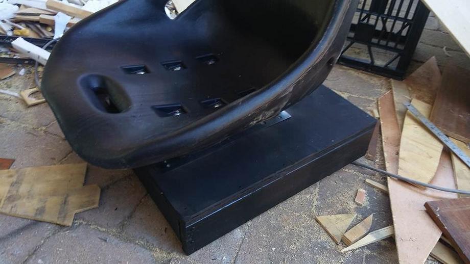

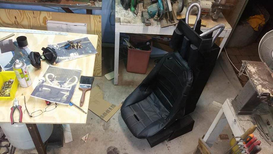

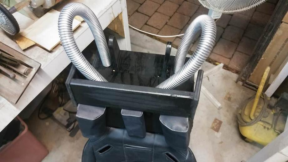

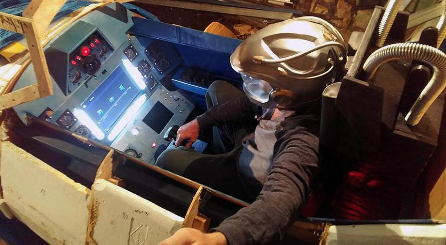

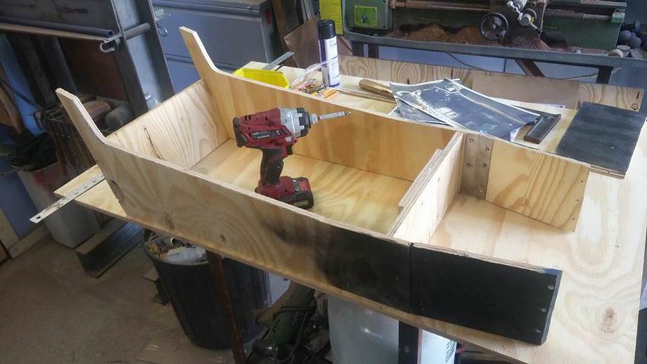

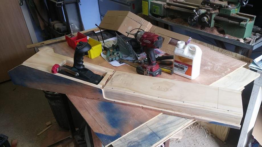

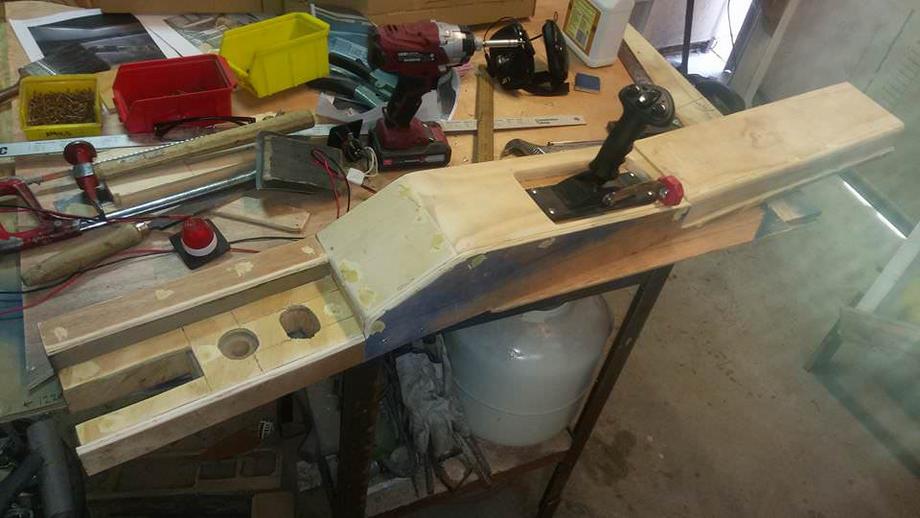

Starting the ejector seat configuration with a spacer box underneath to raise it and provide a base to build the rest of the unit from. I also cut the top of the seat off as they did with the original prop to allow for the headrest and integrated systems in the top of the seat. The padded cover just gets folded back and stitched behind the seat to dress it off.

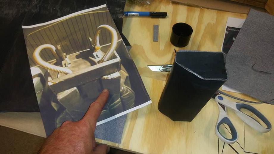

Building the sides and top was tricky and a bit of trail and error. I only really had three half-decent photos to work from at different angles, but they were difficult to translate into shape and size with such limited views and details. I made a frame out of plywood which was pretty basic to back the seat and hug it's contours. Then I started from the top, as the pictures I have are of it are best from there. Working my way down, it was a bit of improvisation with limited materials, but I managed to find a happy approximation.
Again, I found it a big money saver to use cardboard first to freehand the shapes and fit, then transfer to half inch plywood once I had established the form. I'll add in small details later, but that's the main construction finished. It was quite a challenge.

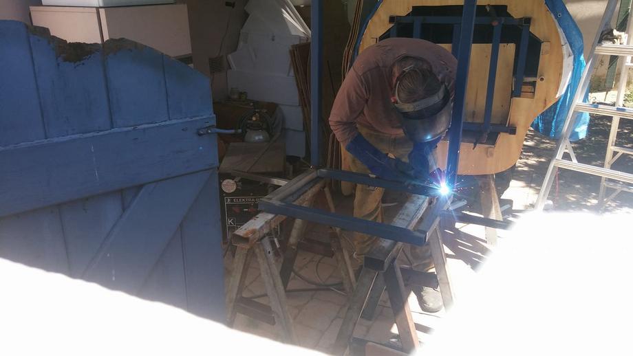

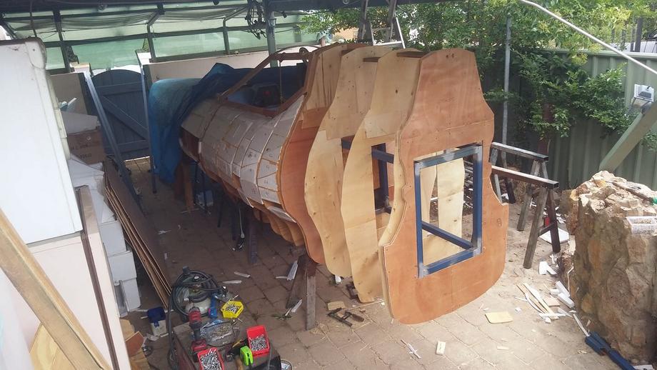

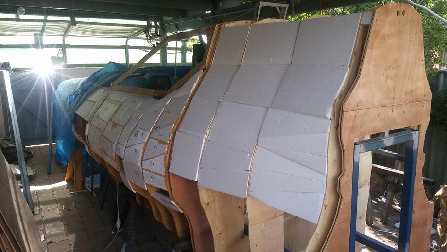

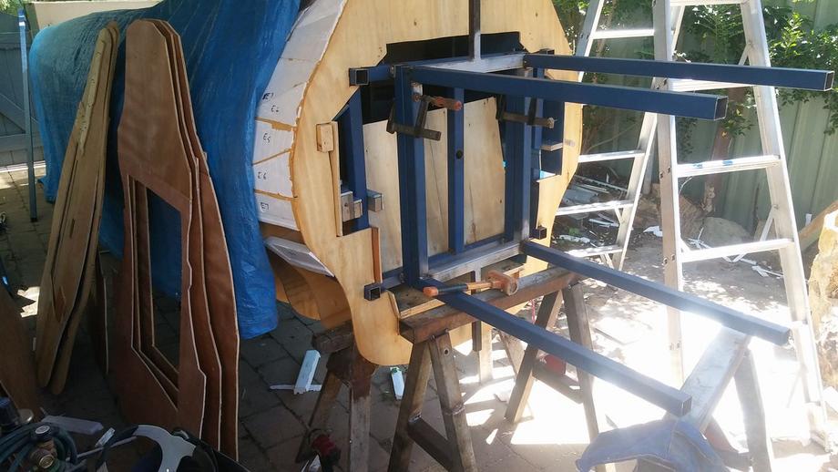

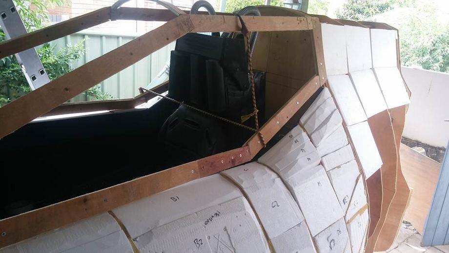

Modules 4 & 5, main engine block.
Starting behind the cockpit firewall and continuing for another 3 metres, is the last parts of the fuselage that the three main engines will attach to. Again, I am using plywood formers, spaced and supported on a rigid welded steel frame.
Will this even take off?!? It seems way too heavy with the wood and steel!
You might have missed some numbers there Baz!?
