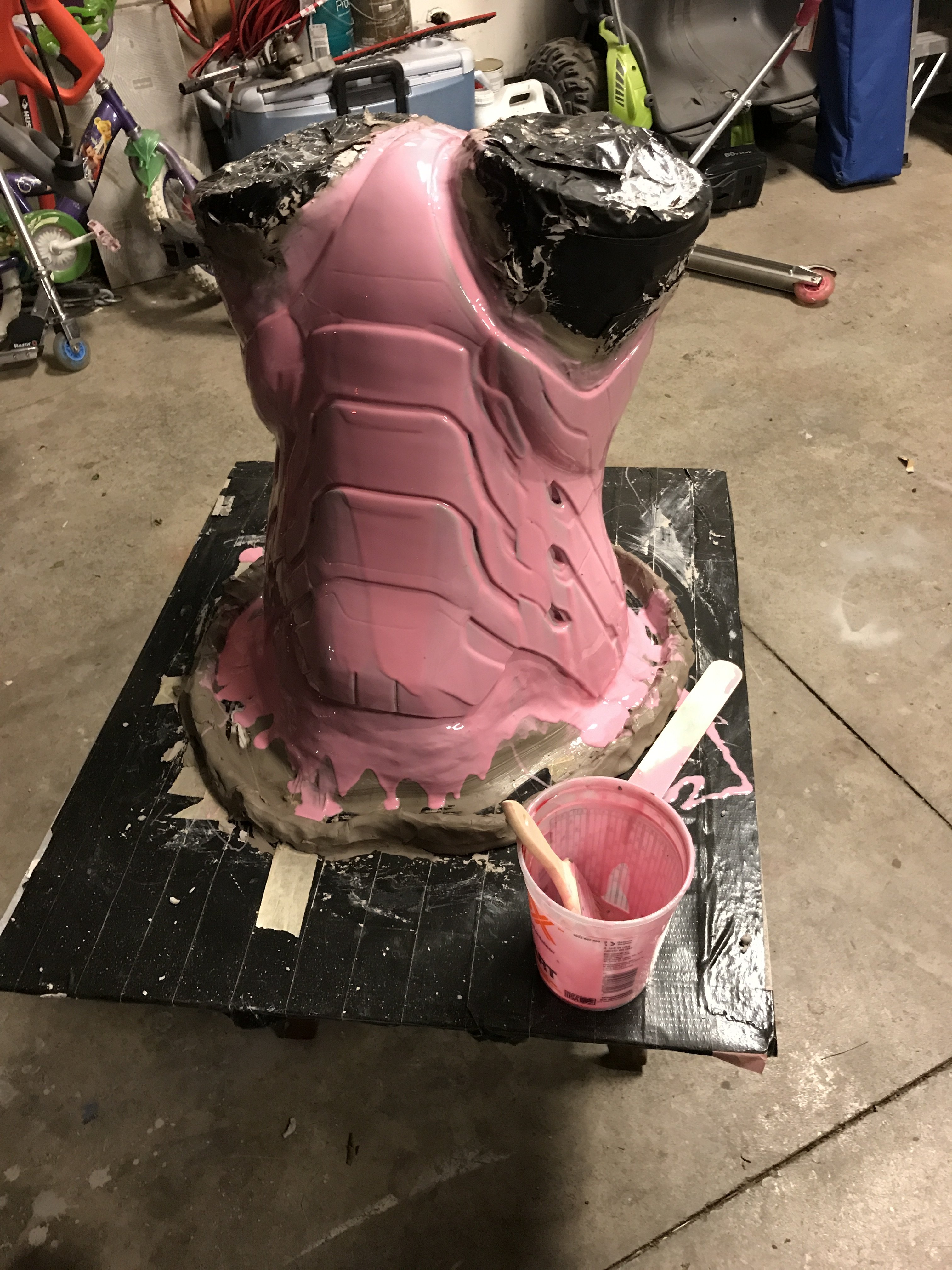

Another journey begins and will soon be adding another one to the collection below. Wannabe's awesome build has convinced me that this is definitely one of the nicest suits made. This time I plan to take completely different approach to building this suit. Each piece will be printed, smoothed/finished, molded and rotocasted in Urethane Resin (Smooth-on 65D). So far, I have been working on the Abs and Back trying to get it very smooth and lines as straight as possible for the casting. (Hopefully will start tonight) Also this suit will be painted clear coated by a local automotive collision repair/body shop who had offered their services. The internal flexible boots and shorts will all be printed and then casted directly on the print in Ultracal 30 then will be made from Dragon Skin silicone.

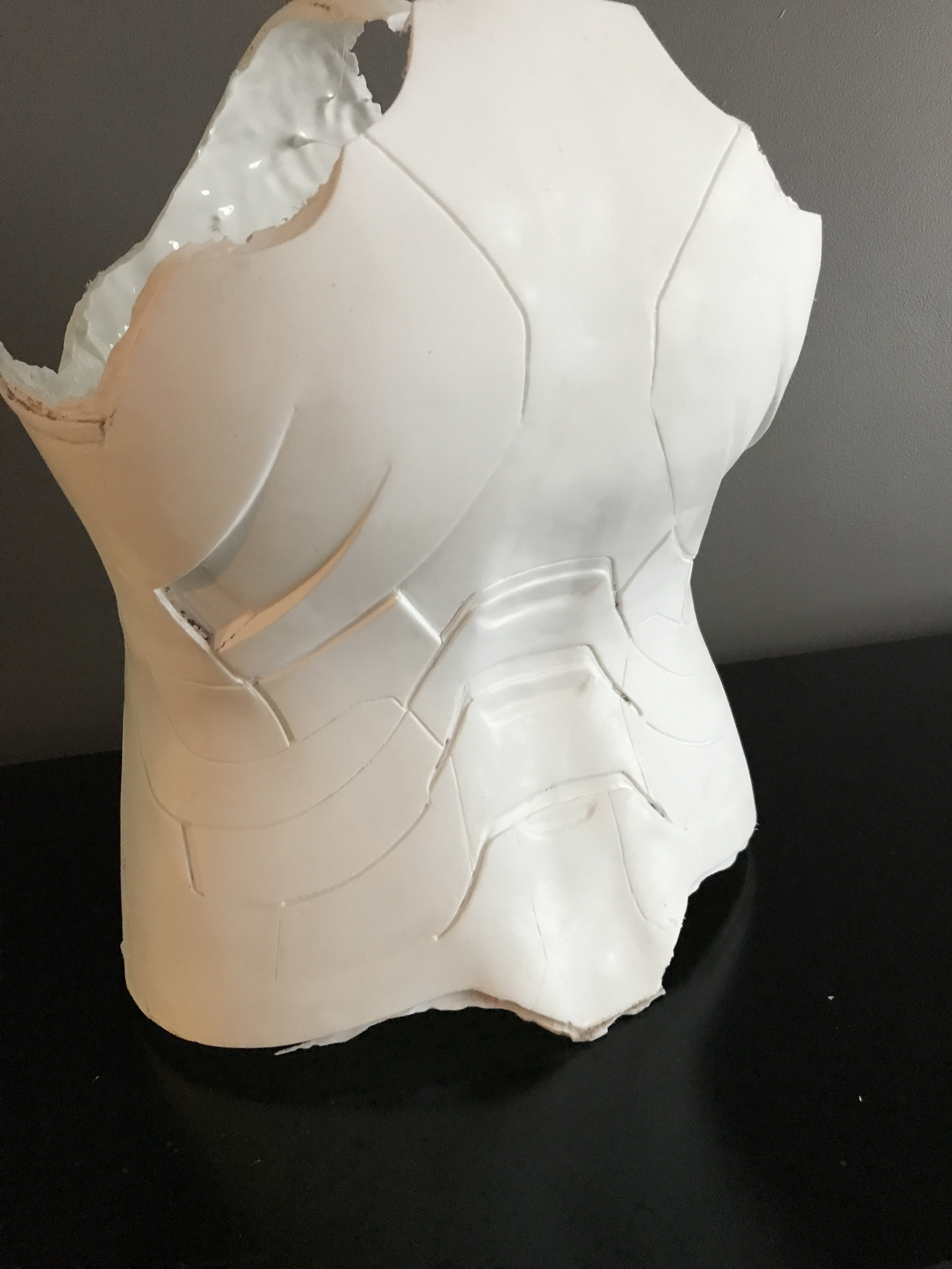

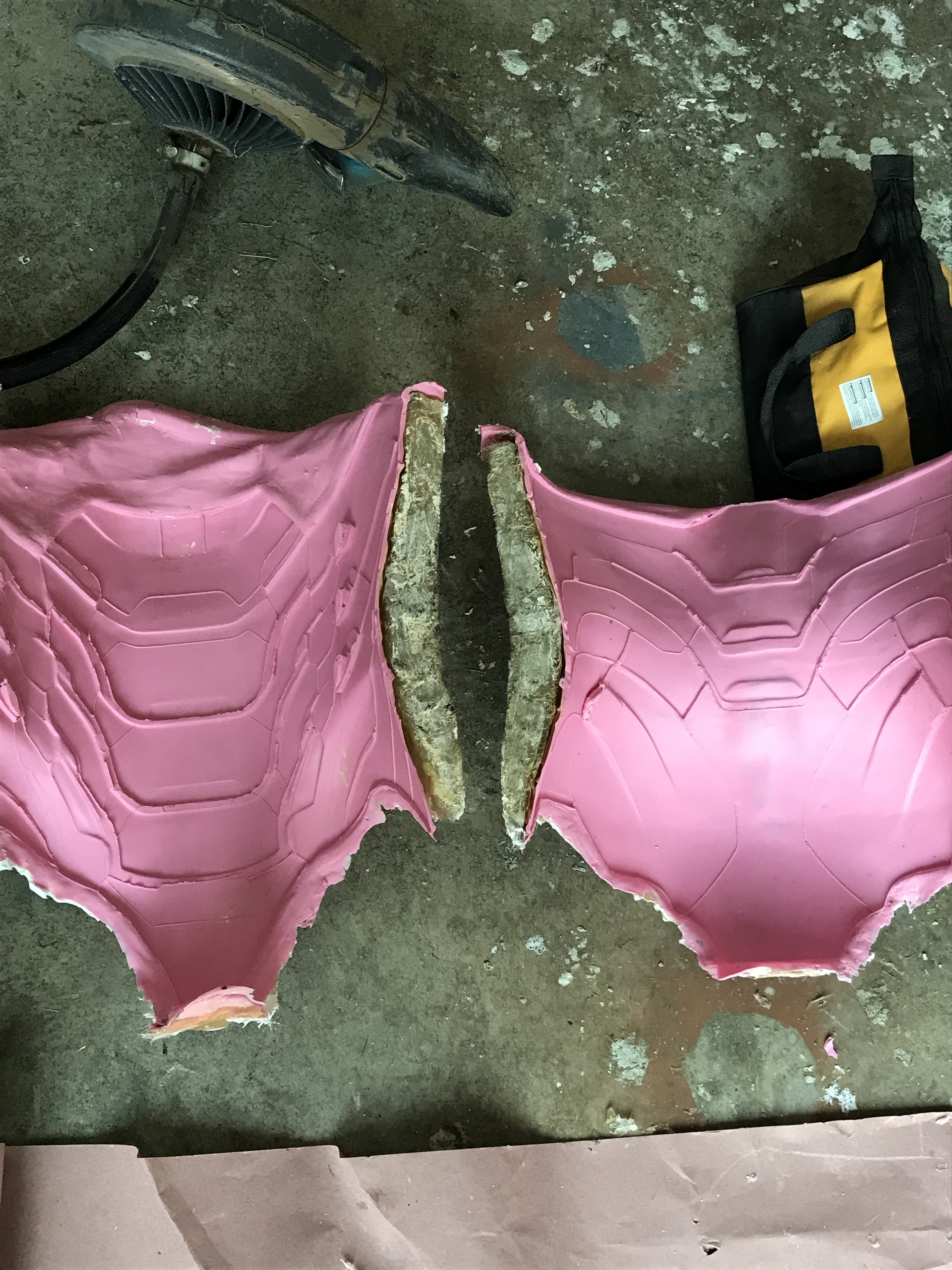

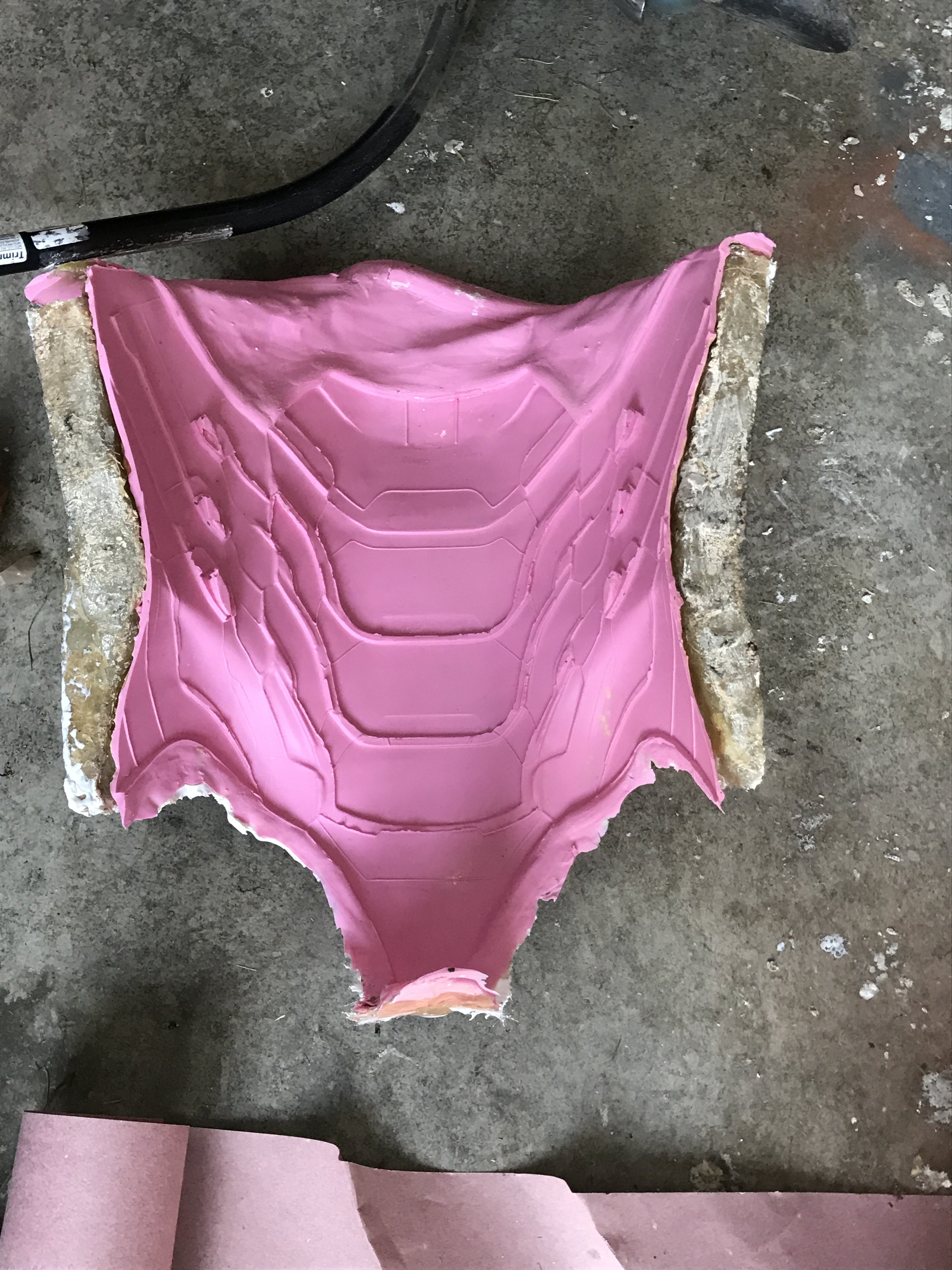

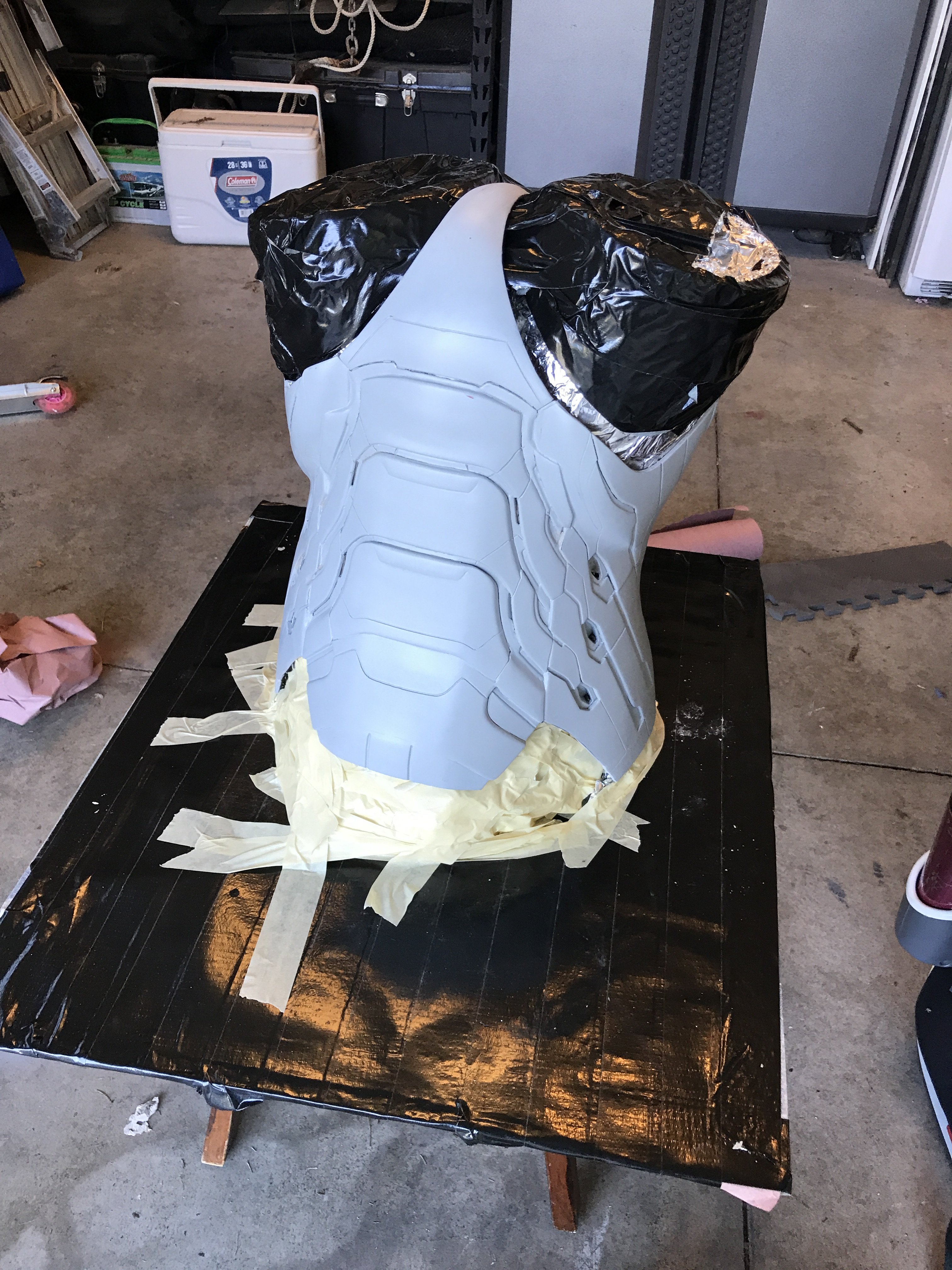

Well the cast was split in half and added a Fiberglas alignment trim on the sides to keep the back and abs even. Still lots of more work to do. Also added a first coat of primer. Can't believe how well the details pop.

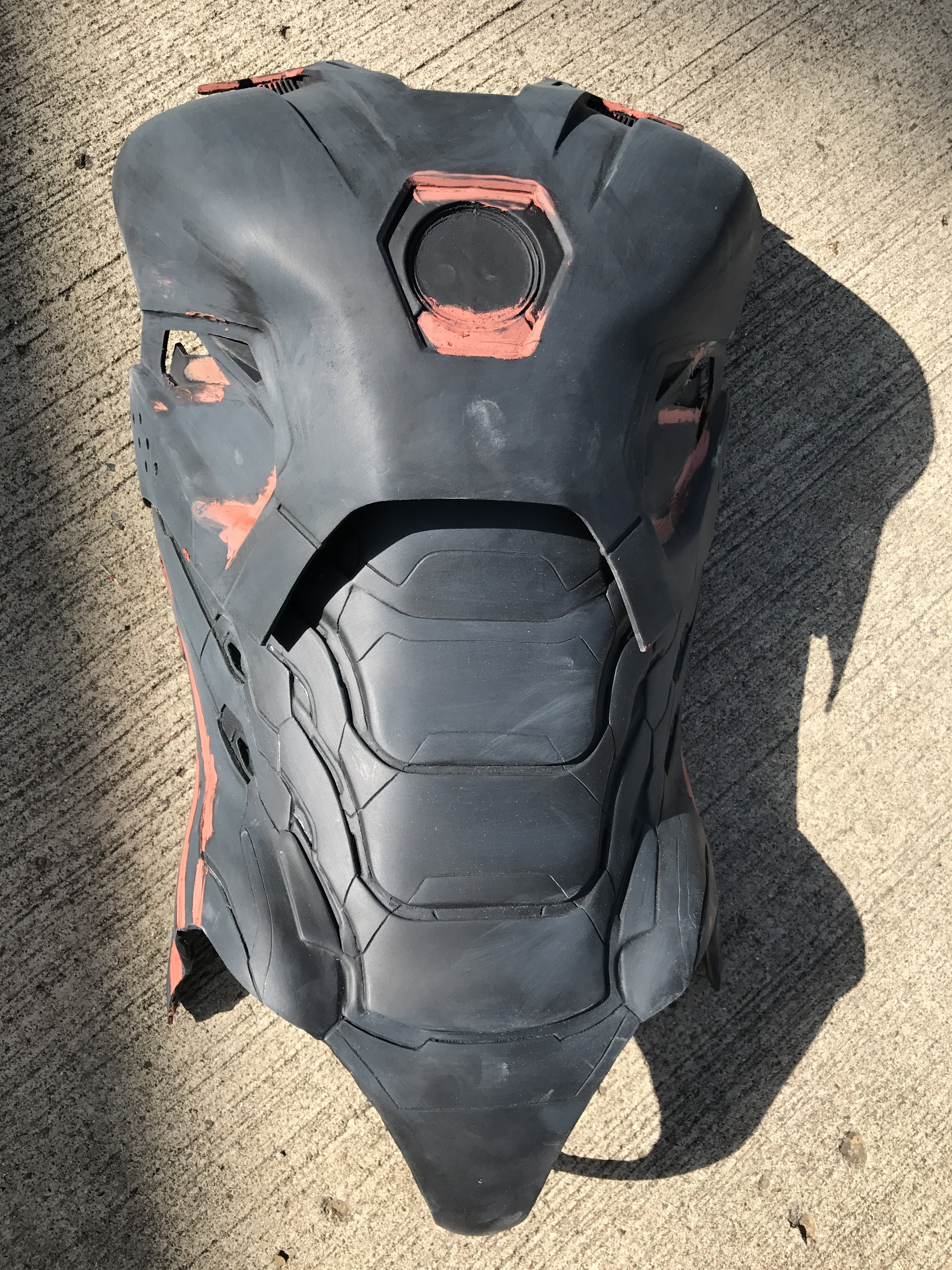

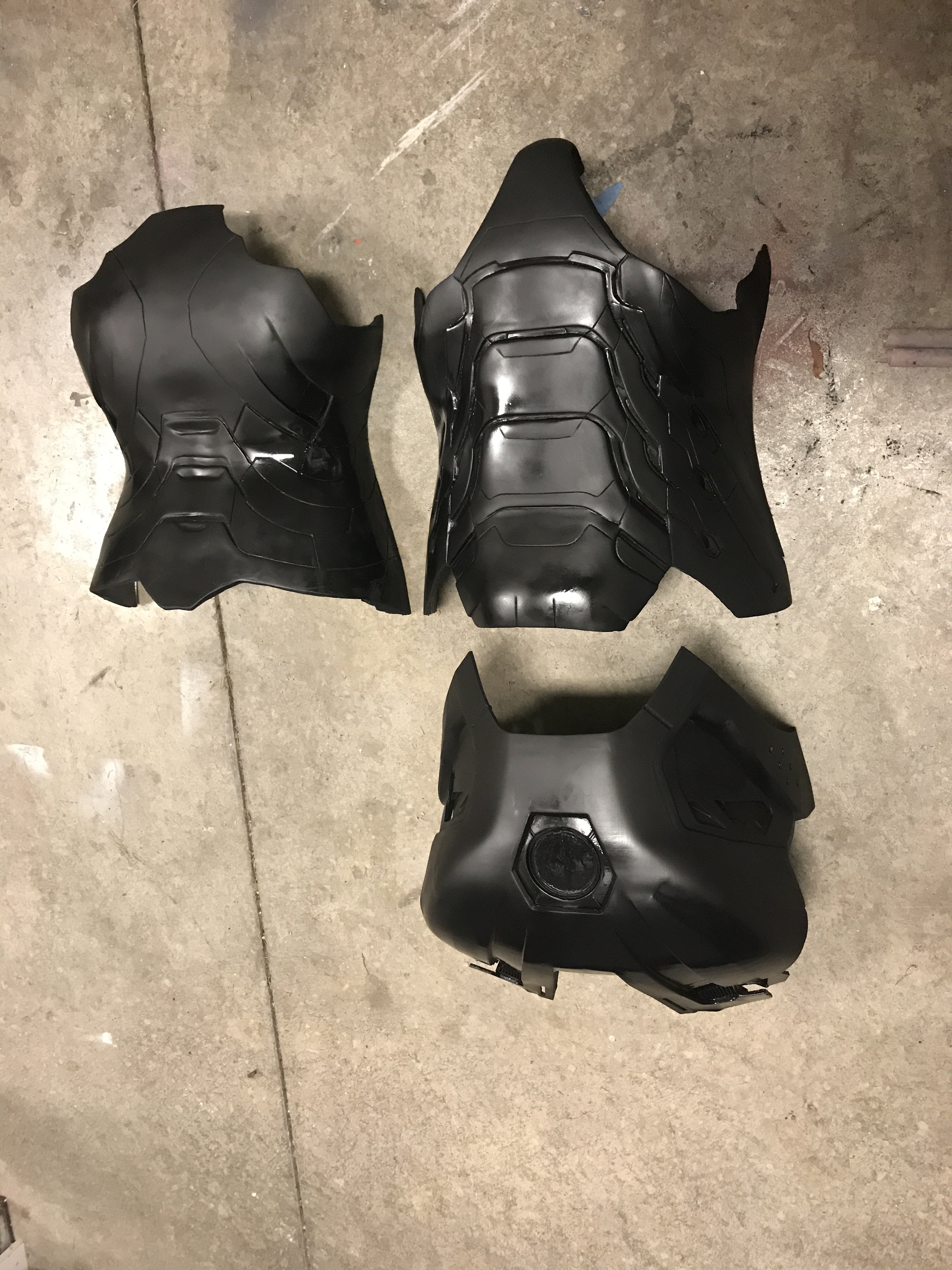

Its solid as a rock. I could throw it down a set of stairs and it would just bounce. I casted a little but to much resin on it. I may in future experiment with doing another cast and then cutting the abs individually then putting elastic bands behind it for flexibility.

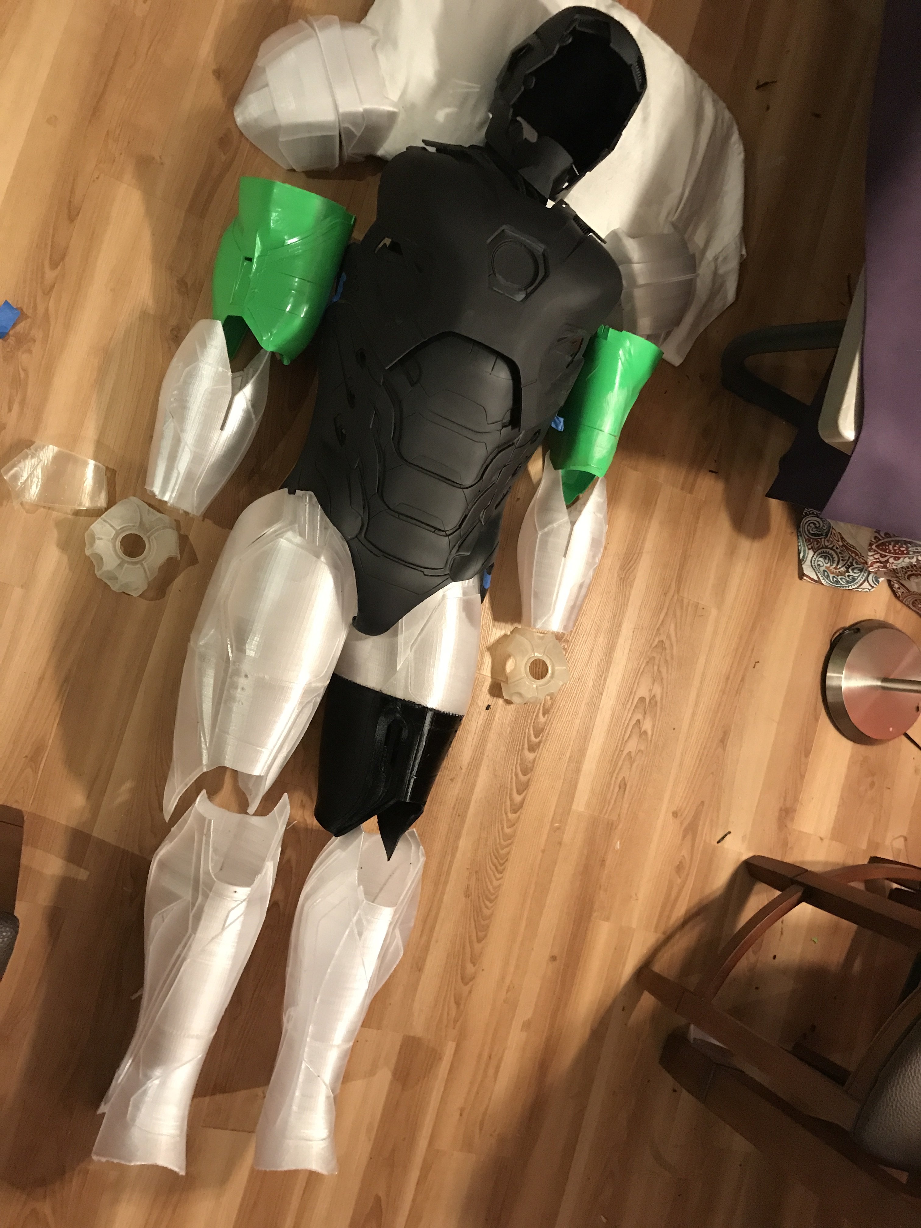

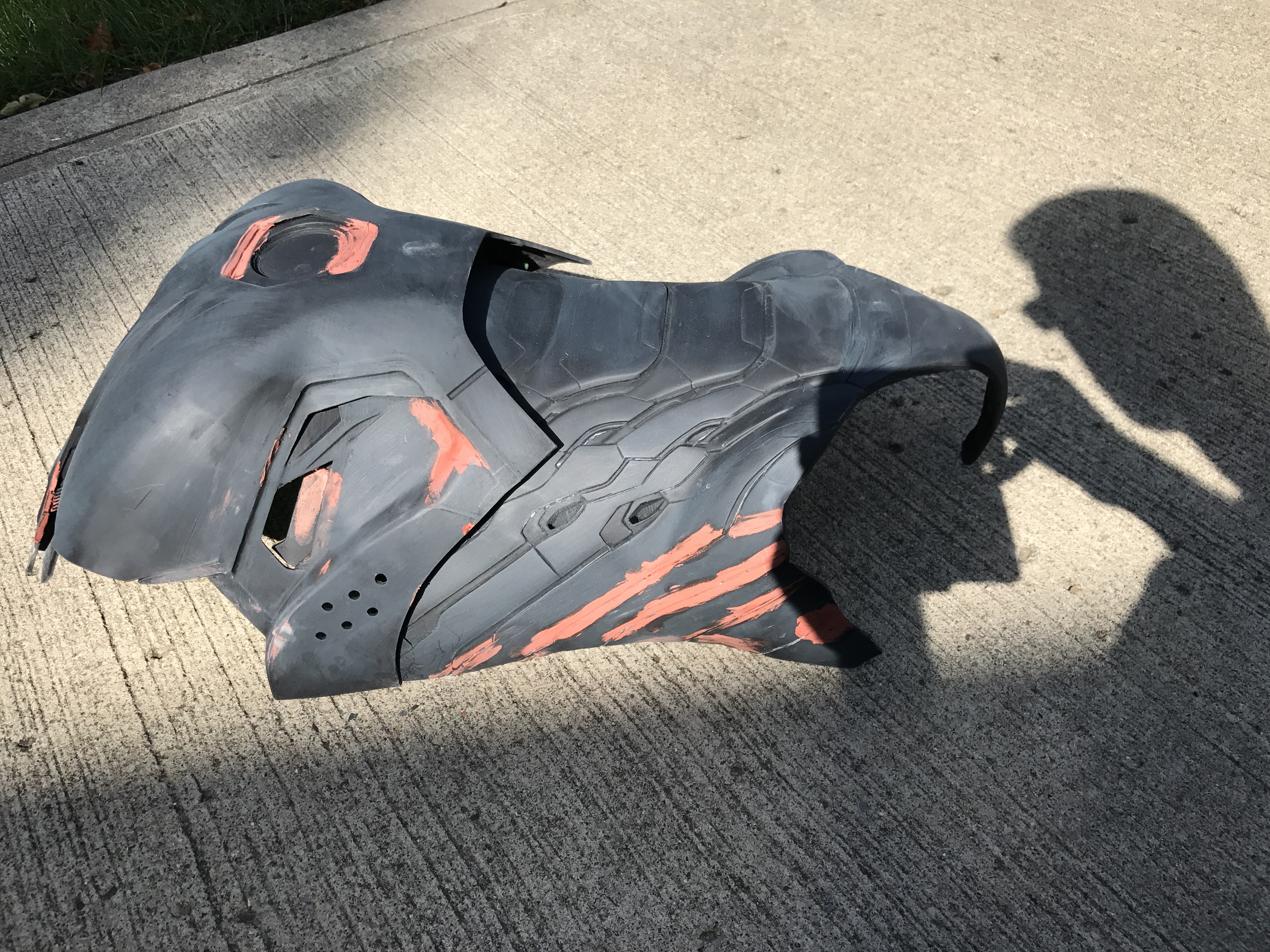

So far I have pretty much printed the whole suit with the exception of the feet, helmet, neck. (Back should be done shortly). Here's the progress on the post finishing. Still lots of more sanding and detailing on the parts till I will be satisfied.

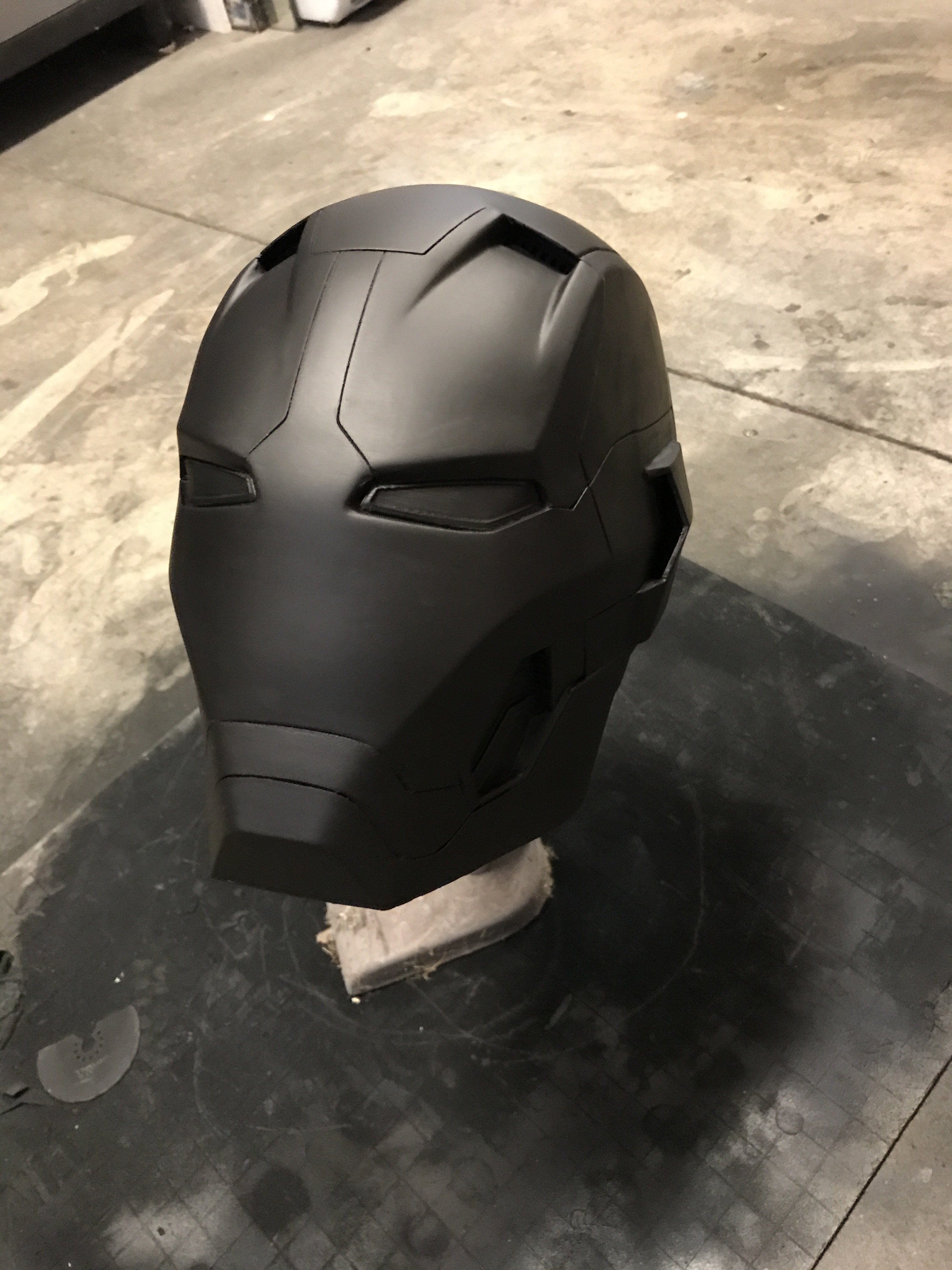

Helmet is finally finished and ready for Mold and cast. I also picked up my automotive paint and clear coat from the House of Colors. Can't wait to see how that red will come out.
That helmet looks great!! Just curious, did you follow a tutorial online for molding and casting or were you already familiar with this process before starting? I'm looking to cast some parts but no idea where to start. Thanks, and good luck
Thanks Huang, just been watching lots of videos both on Youtube and in the StanWinston School of Character Arts. There are so many different approaches and techniques, you just need to find which one works best for you. Lots of trial and error. Im nervous to see how this one will come out.
