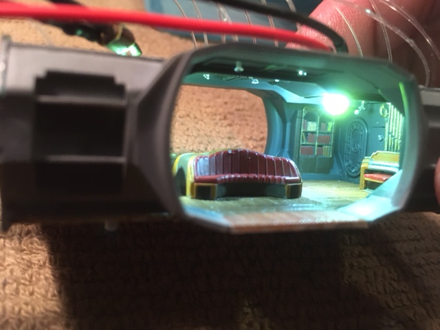

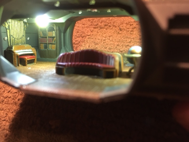

here's the salon, would like to have been able to give the sofa and curtain a velvety sheen, but couldn't think of how and gloss clear didn't seem like the right course to take, though I admit I didn't experiment on anything, yet. any thoughts on that? still can't decide whether or not to get Dry docks entire salon set...may wait for the next build. this one is fun for sure, and subsequent builds are always better anyway.
thanks dude:thumbsup salon1.JPGsalon2.JPGsalon3.JPG
I'll also have to experiment with the lighting to get it right

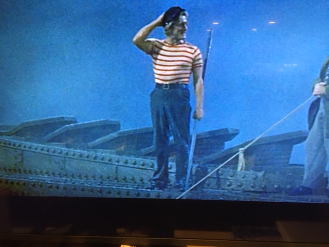

I'm building this one to look like the scene where Ned show up after the other guys are already on board. The main hatch is open, and there's barely the tip of the hatch poking out, and all the panels to the rear are up at an angle with what appears to be perforated panels showing.
I realize I might ruin the piece cutting it up. I was going to email Bob Martin and see if he or anyone else he knew of had ever done this mod, and hopefully get a procedure on it. a lot of work I know, but it sure would look good.
what do you think?????????????

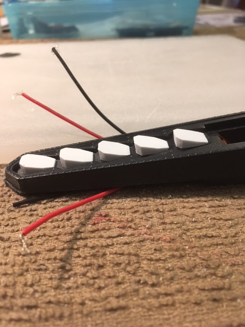

naut6.JPGthis is what I had in mind...

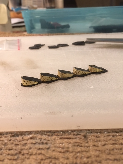

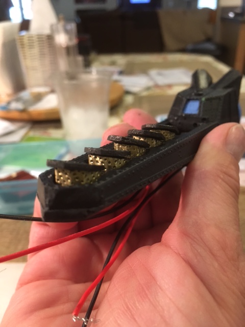

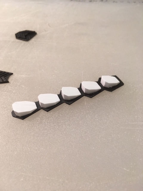

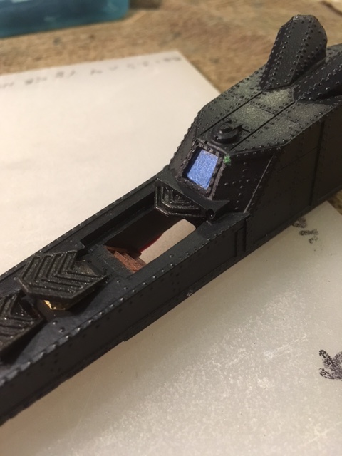

20k 1.JPG20k2.JPG20k3.JPG20k4.JPG20k5.JPG20k6.JPG20k7.JPG20k8.JPGso what I did was hobby saw the vent/hatch piece in two, separated the vent tops and sanded them to around 1/16 inch, same with the bottom half. I wanted to build all this on the bottom piece so I could paint and weather it separately. I think my brass plates could have had smaller holes and more of them, but...
I glued blocks together and shaped them as bases for the brass plate and tops
oh yeah...I took the last two hatch pieces, stager stacked together and cut the end off and glued them to appear as if they were retracted into the wheel house

TW: Opening the breathers adds so much detail to the finished boat. Very nicely done!
Tommie
I've often added a small piece of styrene to fill the gap between the raker arch and wheelhouse. This is a slight flaw that was in Scott Brodeen's original castings which I believe are now manufactured by Masterpiece.,

thanks, I still need to do the brass over...it's a bit sloppy with the holes too big and not straight
