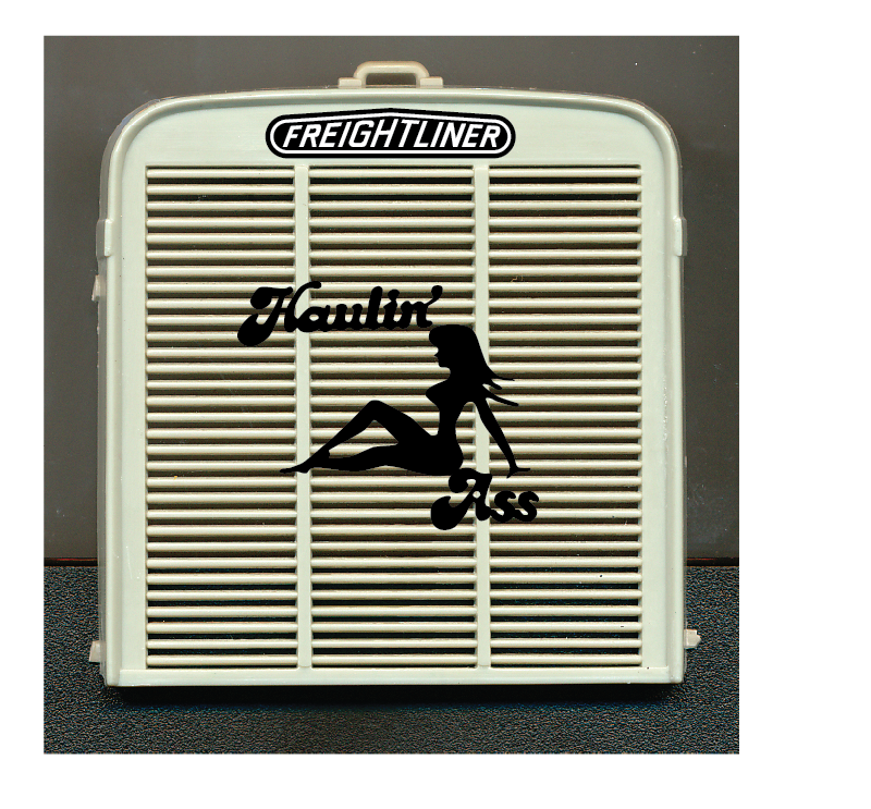

Thanks guys. In case you're wondering - Yes, it IS an Italeri Freightliner FLC kit BUT if you want an accurate PorkChop Express, you'll need a few things: 1. The sleeper that comes with FLC is way too low and thin. Had to buy two sleepers, cut and marry them to get the height.
2. Get the Italeri truck accessories kit for curved chrome stacks and other monor parts. you'll have to cut and combine. A lot.
3. For the "Haulin' Ass" logos get "truck girl" earrings (2 sets) on ebay. really cheap.

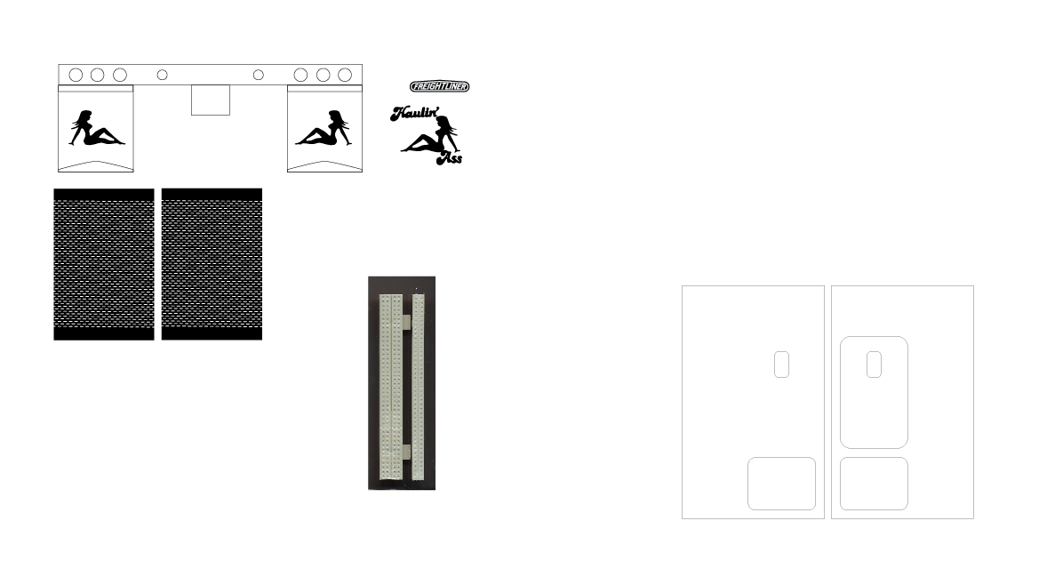

Any other detail questions - or if you'd like a high rez .pdf of the decals I made, PM me and I'll gladly share it with you.:darnkidsIndeeeeeeeed.
I've gone off the deep end and found the original truck part "accessories", redrew them, and am getting photoetch of them (and the badging, etc to make it more accurate)

I'm waiting on mail from the chromiumdioxide. He said he'd send me the decals and has no issue with me sharing them. As for the grill, I have found only one photo-etch fret with "Haulin' Ass" on it and it's from a firm in the UK; http://www.kitformservices.com/photoetch.html the set is PE- 85. This a photo of the set;

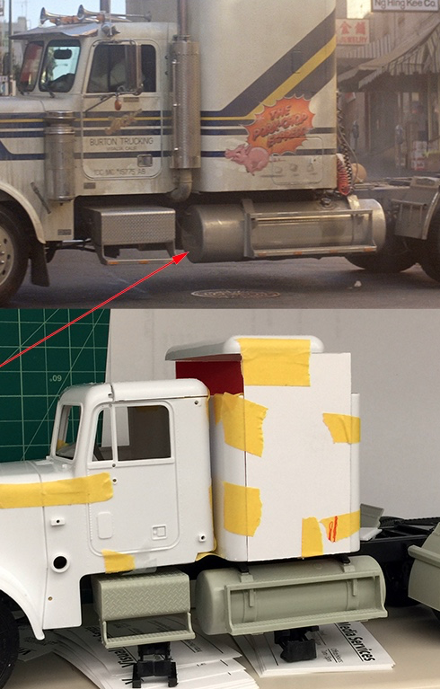

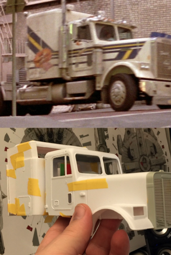

Now that Jerseyfest is over, I'm back on the photo etch set for the Pork Chop Express. George Takacs is going to offer the figures, and a resin sleeper/fuel tanks, back bumper, etc for this model. Working on the pattern when I can find the time!
Worked out the spacing (ignore my short tanks in the mock up below, they are getting fixed/cast). PE art is ready for the logos and badging, as well as the screens that wrap around the pipes. Working on the tread plates for PE, now. Also will etch/cut a back bumper.
will he offer spares for sale , or should i just make my own , are you getting the decals to for sale ...
He's making them available so all you need to buy is the FLC kit, yeah. And we will have decals made too, yep.
