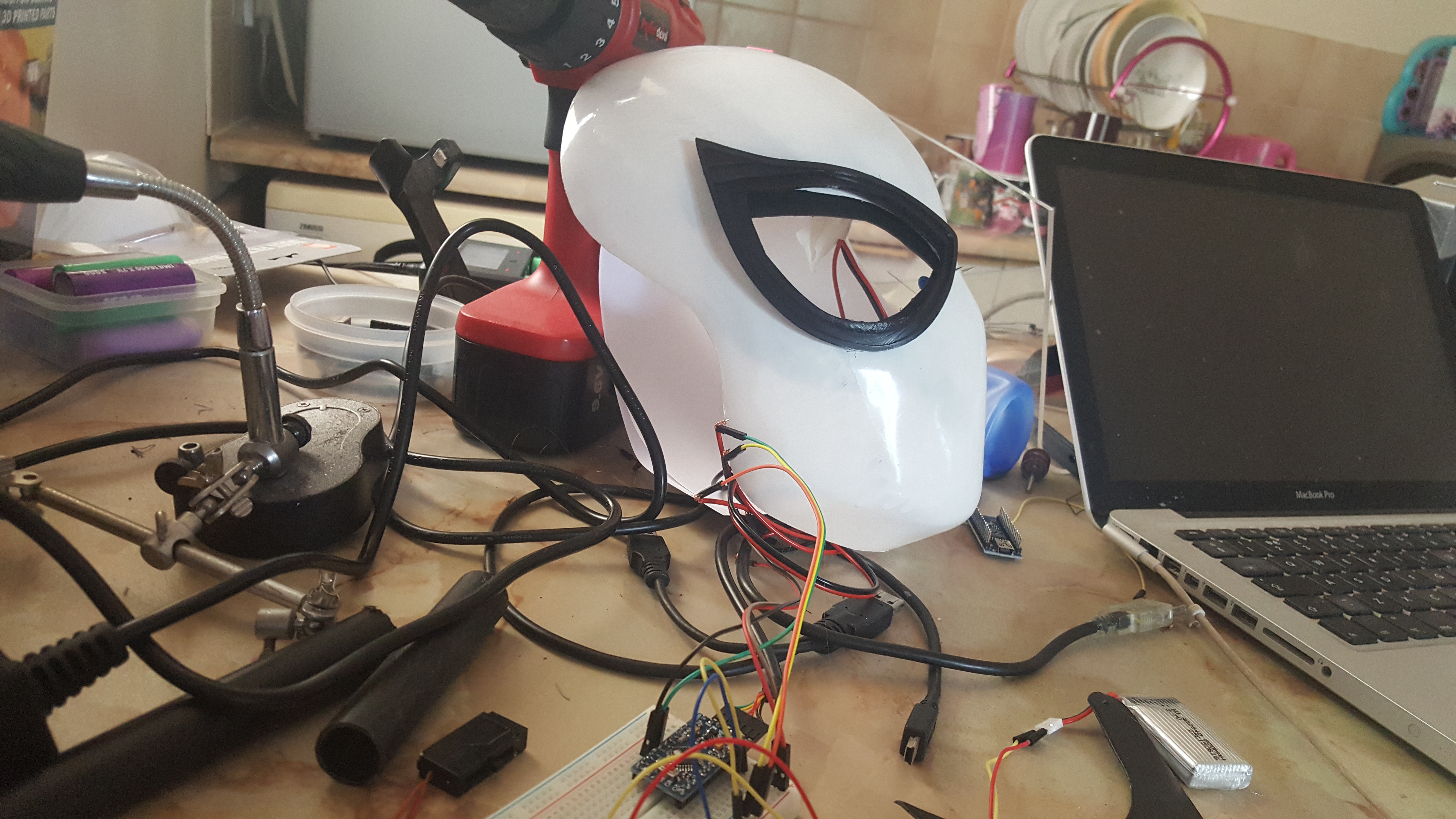

So here is the first video. Lets just consider it a "Proof of concept".
This isn't the final speed or travel distance, but it shows the top right eyelid moving.
[video]https://www.facebook.com/CandeeGeeks/videos/1204932229612802/[/video]
So here we go, a decent demo.
Lots of bugs to work out and stuff, but I wanted to get a video up TONIGHT. I'd quite like to get them opening and closing faster. Might be running slow because I have them powered from 3.3v instead of 3.7, we'll found out I guess.
I'll also be changing the "eye lids" at some point because I'm not cool with the shape. This will do for today though :)

fantastic. absolutely. may I ask you what you used as the point of rotation? the kind of stick that is coming out
The pivot is just a regular notice board pin for now. It cant stay like this because it sticks out the front lol. It's easy to take in and out during prototyping though.

I'll have a video of the inner workings once everything is installed into the face shell. I don't want people rushing ahead of me.
