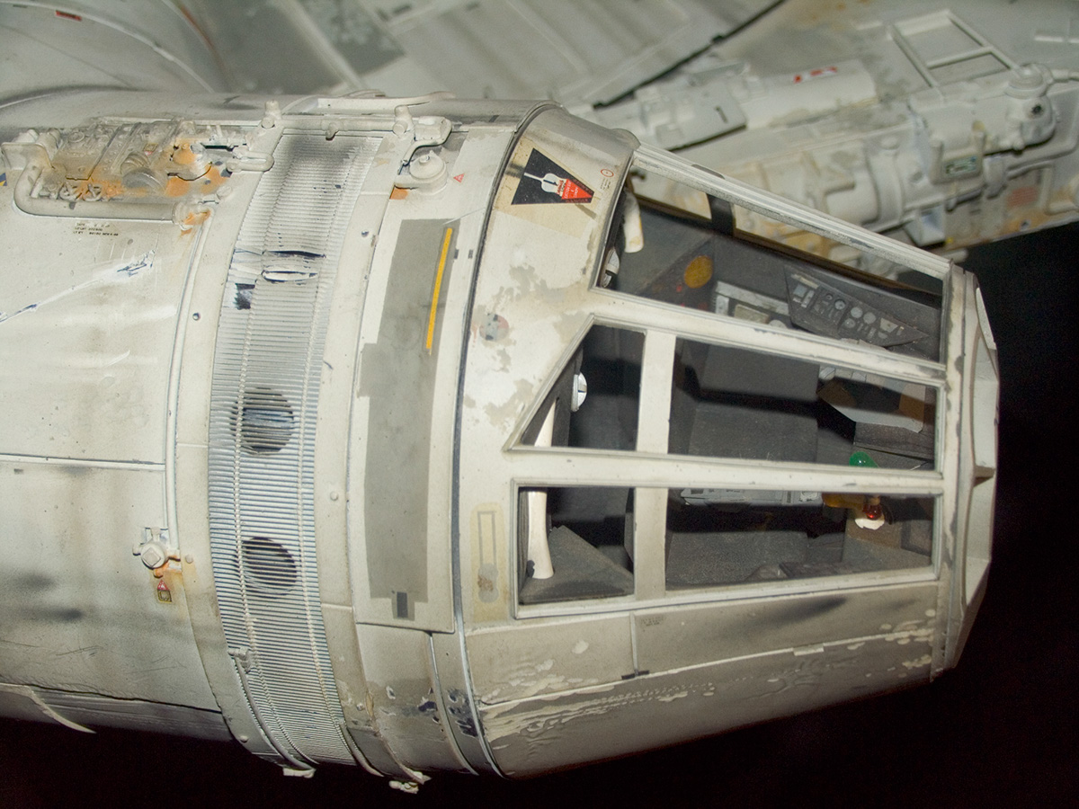

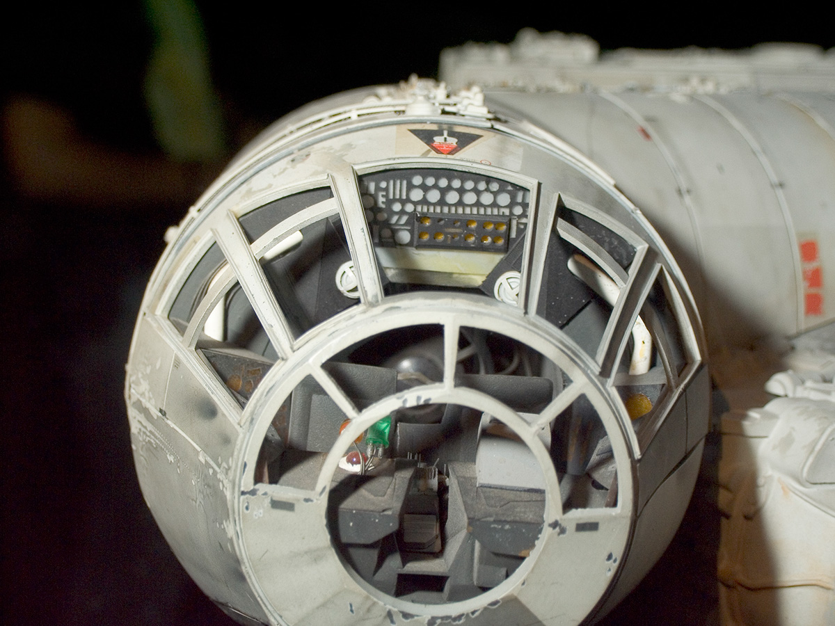

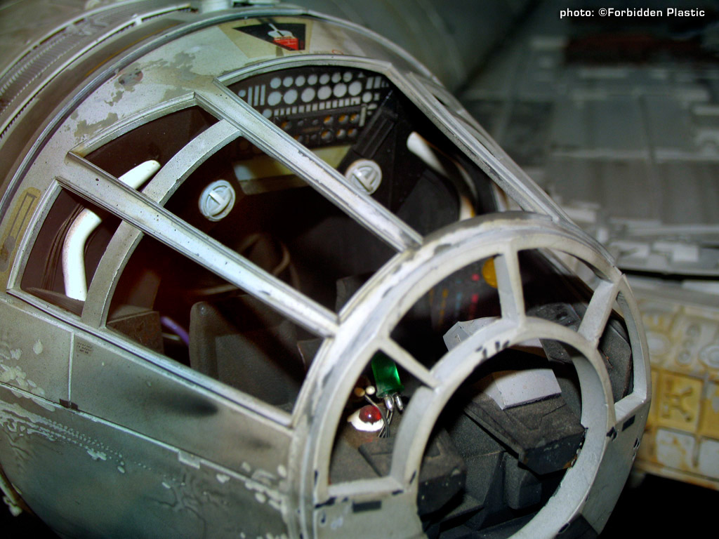

One thing to do to pass the time until the kit is released would be to do gather some research on the 5-footer studio model faux cockpit for those who want to go that route. Parts identification, layout -- maybe even someone handy with 3-D can mock up a version to aid scratch building. I doubt many people will make this modification, but I know some (including myself) are considering it.
Joshua Maruska's research suggests that the two key elements of the 5 foot shooting miniature's cockpit interior were the seats and floor pan of an LS Models Auto Salon Series No.1 1/16 Scale Morgan Plus 8 Roadstar.
The floor pan, which was used as the basis of the main dash console, is the most complex part to model. The monitor housings, the central console and levers, and the two round white thingies on the wall should be more straightforward to model based on photographic evidence.

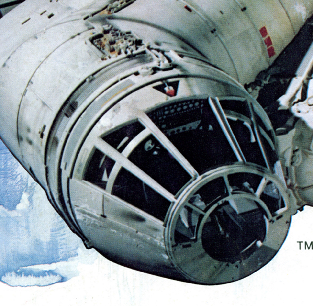

Here's the MPC box photo, showing the console part currently missing. It would be cool to build this at 1/72 scale with tiny LEDs.

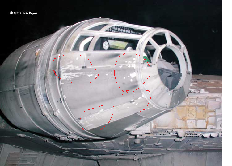

Just a quick question gang , apologies in advance if asked before elsewhere . Those circular shapes / lights ( as seen in Echo Base - red ) , under the ' kool shade ' cockpit ring ... how many of them are there ? Asking cause the two visible ones in post #83 seem to be higher placed than the ones on screen ( as mentioned ) in ESB !?

The Koolshade ring on the five foot model (it does not exist on the 32 incher) seems to have 9 holes drilled into the plastic beneath the grille. Obviously you can't see all 9 at once owing to the obscuring nature of the Koolshade material, and the way that the strip wraps around the tube.
the Empire full sized set put two red lights in the same position as two of these holes, but didn't have representations of all 9 holes. The ROTJ half sized set used for the sandstorm sequence that never made the final film seems to have another red light at the bottom of the cockpit tube.
