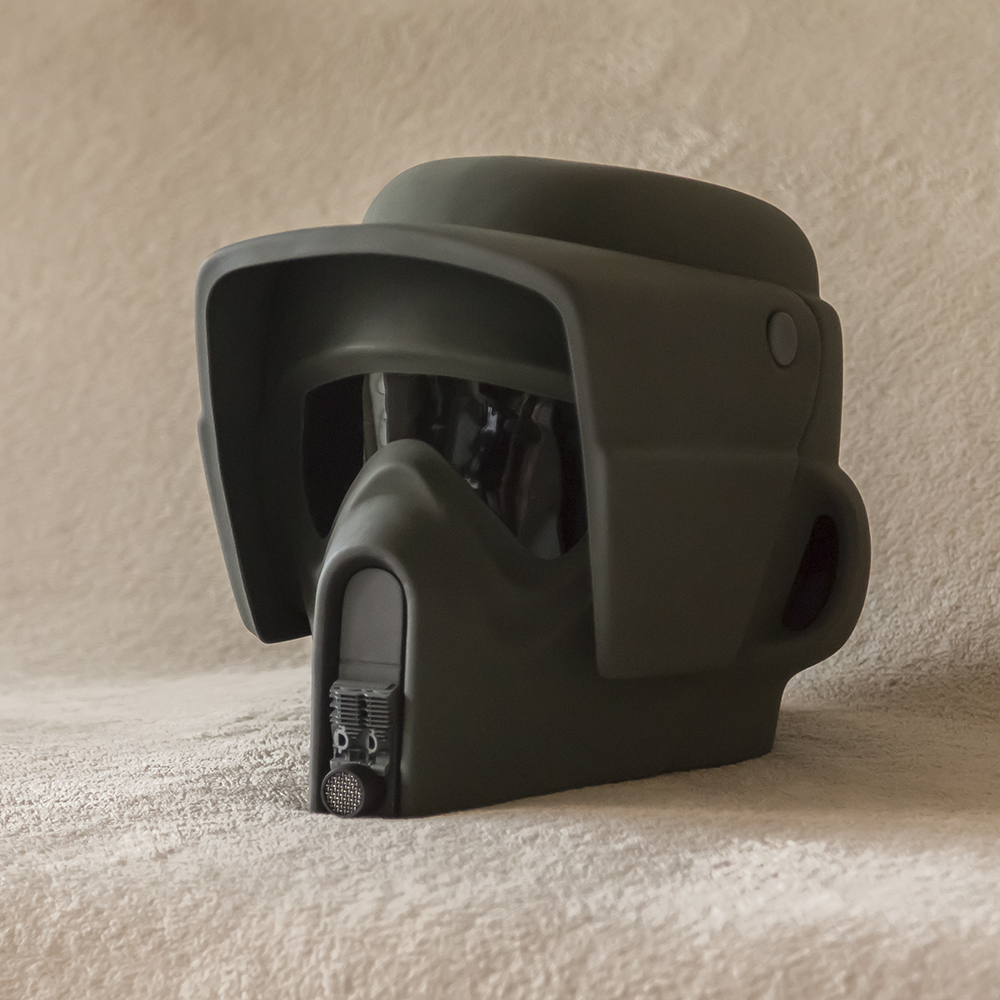

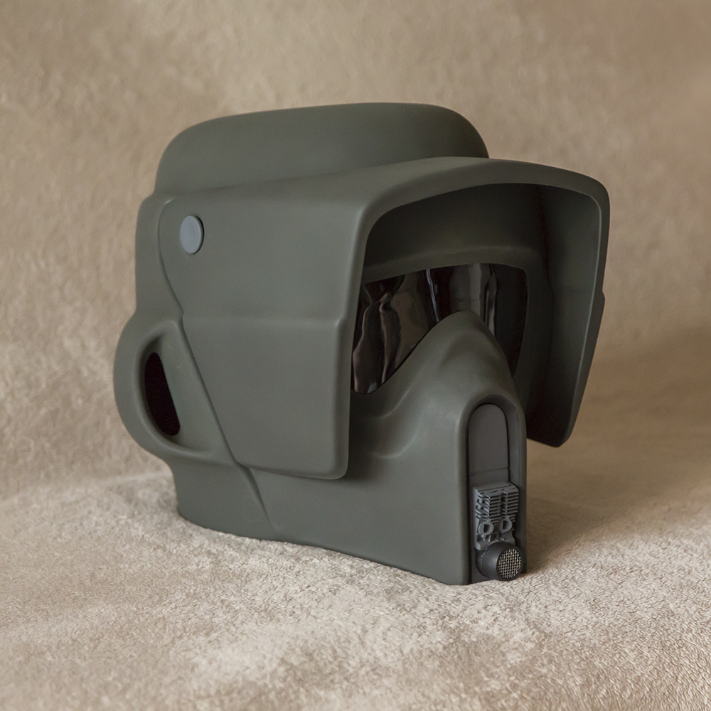

In the immortal words of Red Leader: "Almost there..."
This is still unweathered, of course, and I still need to paint on the Partisan emblem on the left 'cheek', but it's starting to feel a bit more like a character.
For the dark green color I made a roughly 1 : 2.5-3 mix of Rust-Oleum satin Hunt Club Green and Rust-Oleum Earth Brown camouflage and applied multiple light coats with an airbrush. I started with what I thought would be a good mix based on simple rattle can mixing of 1:1, but that ended up looking a bit too green still. So I added in progressively more of the Earth Brown until I arrived at a hue and lightness (well, darkness!) that looked good to my eye in various direct and indirect lighting based on comparison to the on-screen images. Without seeing the actual screen-used prop it's hard to tell, but I'm happy with what I got. I had intended to very carefully record the final paint mix I ended up with in order for others to use this as a 'standard' for this character if we ever develop a CRL for it, but the process got rather iterative in real time so I can only quote this as "roughly 1 : 2.5-3". Sorry about that.
Similar process mixing my own shade of gray for the snout - seems to match screen ref, again for a variety of direct and backlit lighting. Based on the apparent lightness of the Hovi mic area on screen I decided to add in some actual stainless steel Hovi screen, airbrushed slightly to tone down the shine just a tad.
I've got a frisket film template printed out for the Partisan emblem, but I'm going to hold off on that for another day or so while I experiment with various paint chipping effects for the yellowish-tan paint that I'll apply for that...
Dan

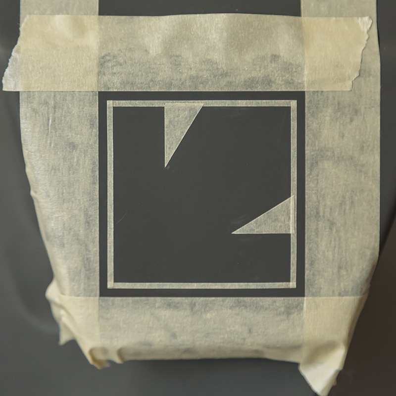

So, still no weathering but I did manage to get the Partisan emblem painted on the side. I had intended to use the template that I had printed out onto frisket film for the actual airbrushing, but in the end decided that that was just too flimsy for the size to tinker around with. I did use a printed copy of the template to position the emblem on the helmet; I just printed it onto regular paper and added two-sided tape to the back and then affixed that to the proper position on the helmet. For that and setting the actual size of the emblem I made some measurements in Photoshop from a good frame grab from the Blu-ray - 6 cm square for use on a RS Prop Masters Biker Scout helmet. Using that paper template as a guide I then used just regular masking tape to build up the mask piece by piece.
I sprayed 5 coats of hairspray, let everything dry well, then applied several light coats of various shades of 'mustard'-like yellow that appeared to match the screen reference. Wet that surface when dried a bit and scratched it up a bit.
I'll dull/darken back the bottom left corner area during the weathering stage to better match the screen reference. Looking forward to making the whole thing 'pop' with the weathering, but I'm going to just stare at it for a few days and approach it patiently.

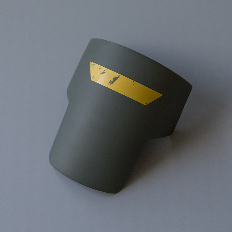

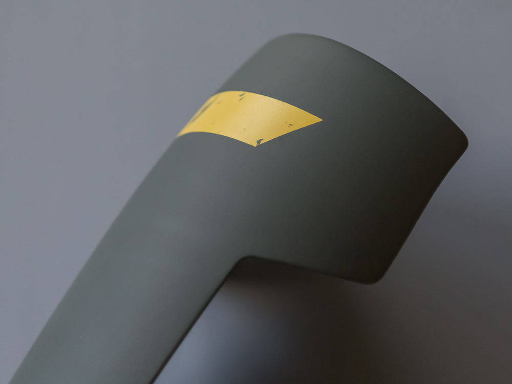

Also brought the little right shoulder bell to the same stage, ready for weathering:
I think I've got the forward-facing end looking like the screen reference, but it's hard to tell what going on at the rear-facing end since we never see that end clearly. In the 'making of' extras there's one view that peaks around just a tad and it looks to me as though there's something going on back there to break the symmetry but since I can't tell I just kept the symmetry for now.
That's it for a few days...

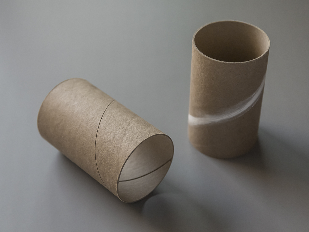

Back from some travel and have made a tiny bit of progress, getting the 'smoke grenade' canisters built and ready for painting. This scene showing one of Saw's other Partisan friends provides probably the best screen reference for not only the canisters but also the bandolier and the 'body cam' thingy:
Assuming the average adult male interpupillary distance I arrived at a tube diameter of a bit less than 3 inches and so 2.75-inch cardboard mailing tubes seemed to be the right starting stock. That also seems consistent with the more 'squat' appearance of these canisters versus the standard M18 smoke grenade that Benthic Two Tubes wears. I 3D modeled and printed appropriate end caps. I sprayed them with filler primer and sanded and they are now ready for painting...
