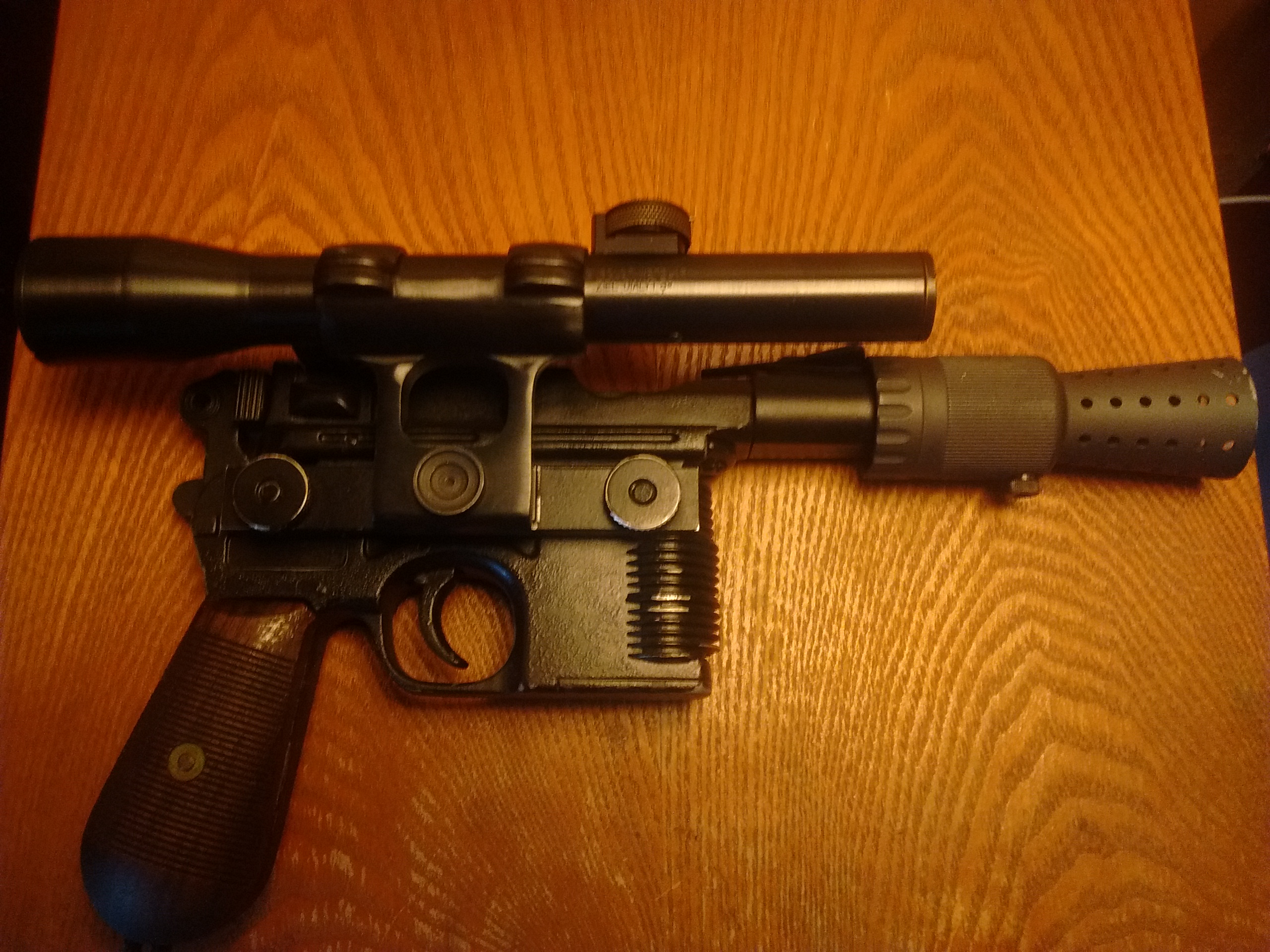

Here is a quick picture run through of my GREEDO KILLER blaster build..
I know for some building the Heat Sink Grille from the 3 cylinders can be a pain so I recently designed them up in master cam. I did two designs..
First is as close to film accurate (subjective of course) as I could come. I first I made an actual heat sink grille using the real reade cylinders then reverse engendered then into what you see below..
Here is my design printed up and finished..
And is my design along with the actual reade cylinders I cut up to duplicate..
All u need to do is cut the tips off. I left them on so u could get a more accurate weathered film look my doing by hand..
The second is more close to what you would see straight off the assembly line at “BlasTech Industries”. I also modified the inside of this second design so fits perfectly onto a denix (or MGC) with the bottom two sticking out marginally father than the top..
I think I got it pretty good. Even taking into account that not all the fines are equally spaced..

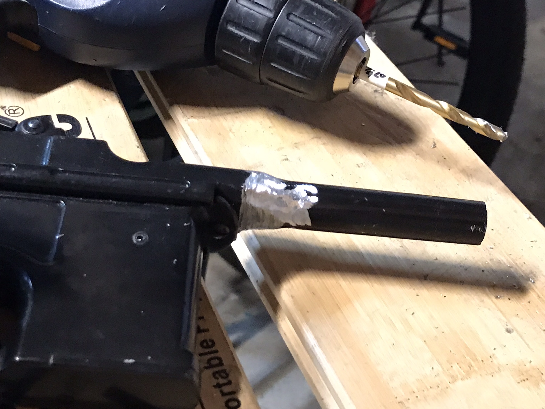

First up is attaching the bull barrel. Thanks to info shared by Kpax here on RPF I redesigned my bull barrel to where a simple cut into the denix will allow it to slid right on and into place with everything lining up as it should.
First I need to mark where this cut will take place..
Then carefully cut into it with a saw..
From here I then cut (pic above you can see the start) off the bottom as well as the end of the barrel. After I use a Dremel to soften the edges..
Once these steps are completed the barrel slips right into place..

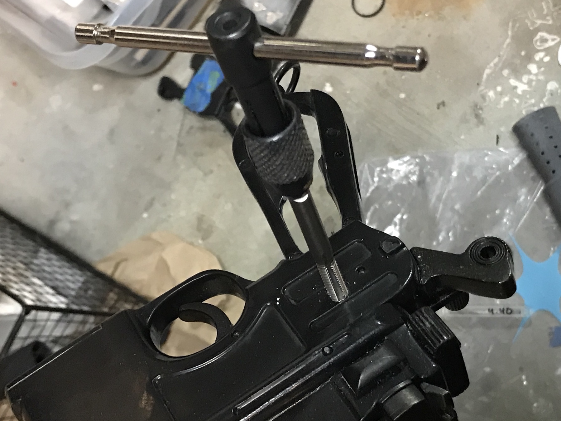

Next up is getting everything assembled but first I need to tap and thread the holes where needed..
1/4-20..
4-40..
2-56..
6-32..
Thread the Center screw 1/4-20..

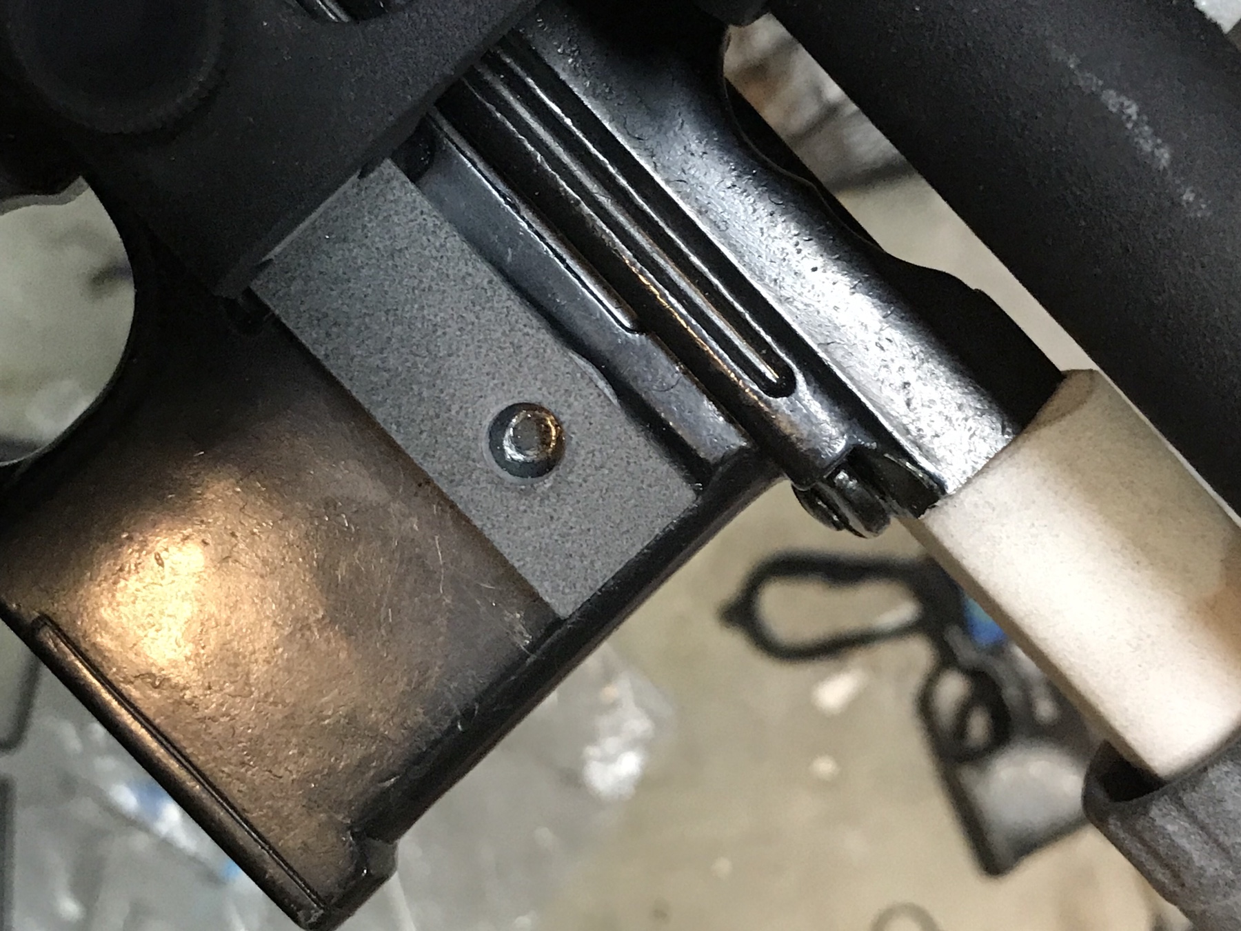

Now I start to assemble the parts and get everything attached to the denix itself.
Fist up here is attaching the dovetail..
Now the scope wheel..
I designed this part so you can attach your denix wood grips to be more inline to what as seen on film. First you need to cut out the Center guard on the denix itself..
Open up the hole with 1/4-20 drill..
And these parts will fit and hold the wood grips onto the denix..

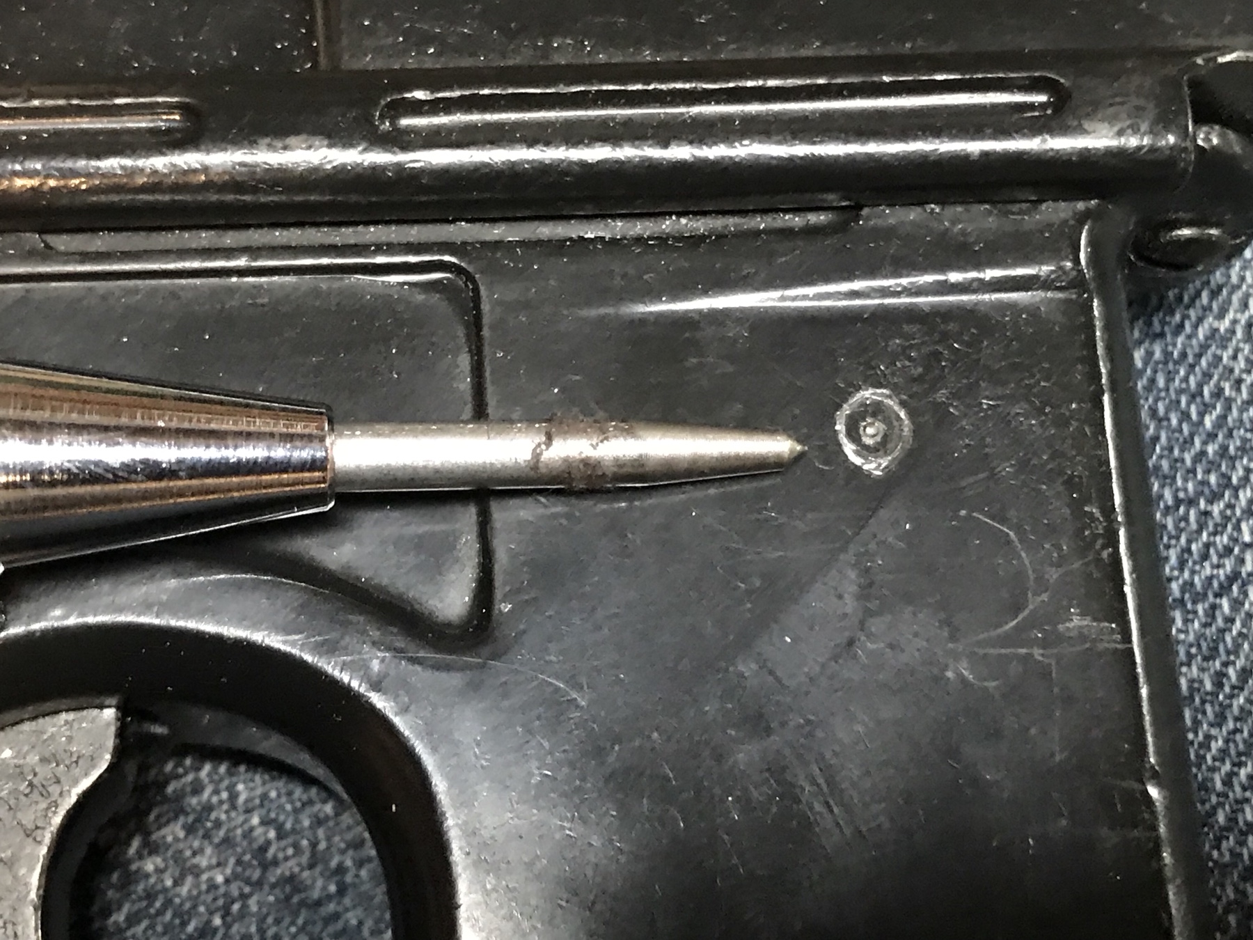

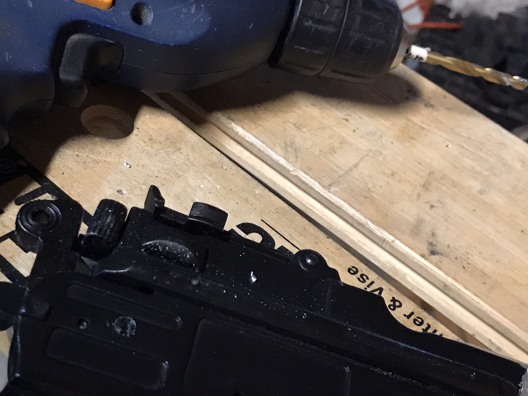

Now with attaching the mount to the denix I like to get the bull barrel and flash hider in place. Then mark with a Center punch on the denix where the back rail will be attached..
I always like to start small and work up with my drill bits as you can’t go backwards with this process..
Now tap the 1/4-20 hole..

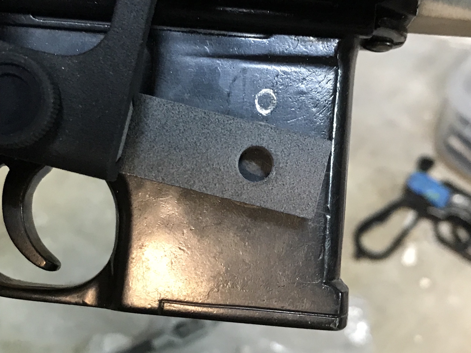

Attach the mount as tight as possible to find where the front hole will need to be. Once it’s in place trace in a circle and use your hole punch to mark it..
Next up drill and tap..
