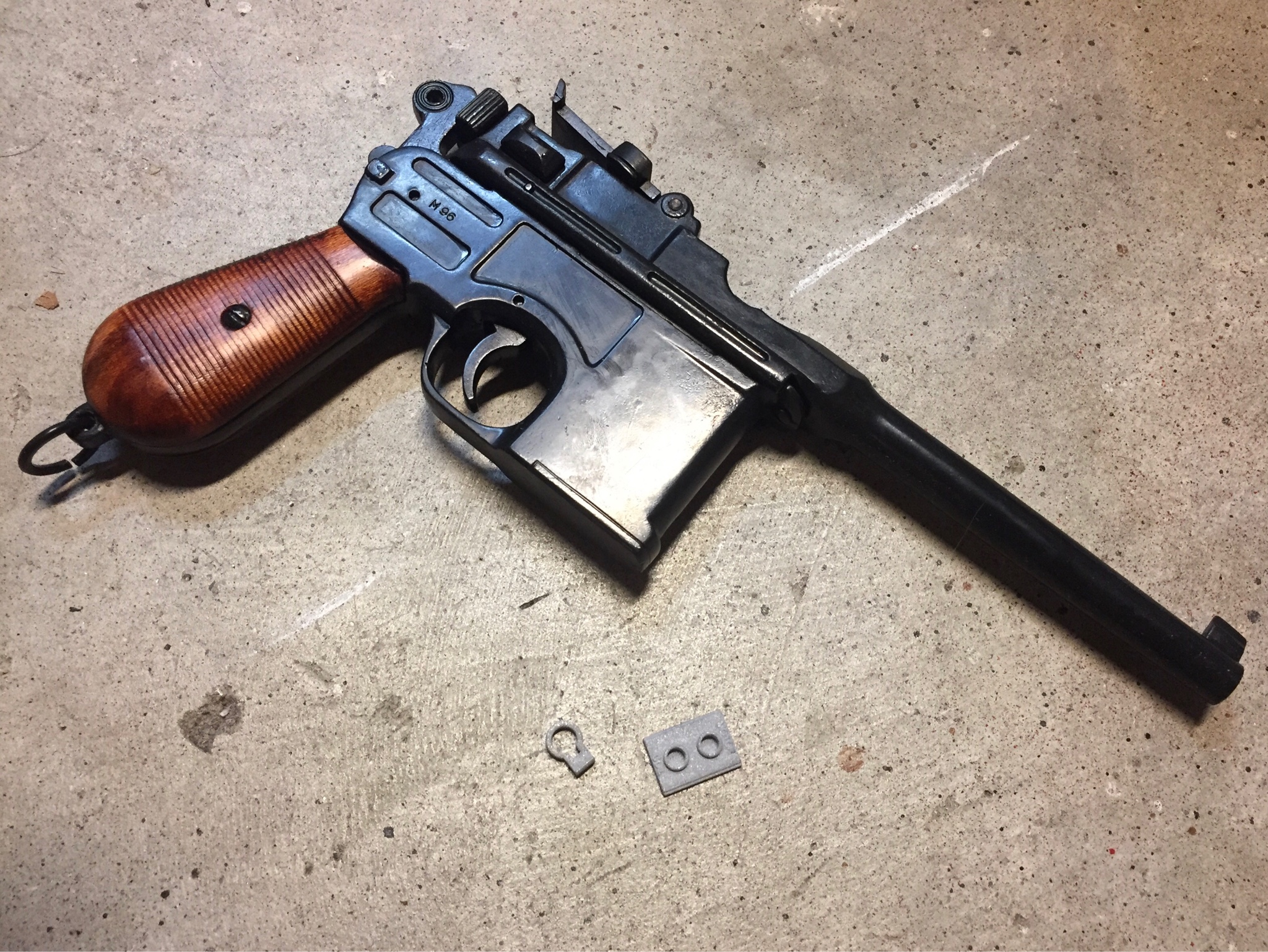

I've built this blaster twice now and this one in this video was my first attempt. It's not the blaster that's in this build thread but it's pretty much the same (I've modified some minor details to this new build). Otherwise it's identical.
I overlaid it with the picture of the film blaster I was trying to duplicate.

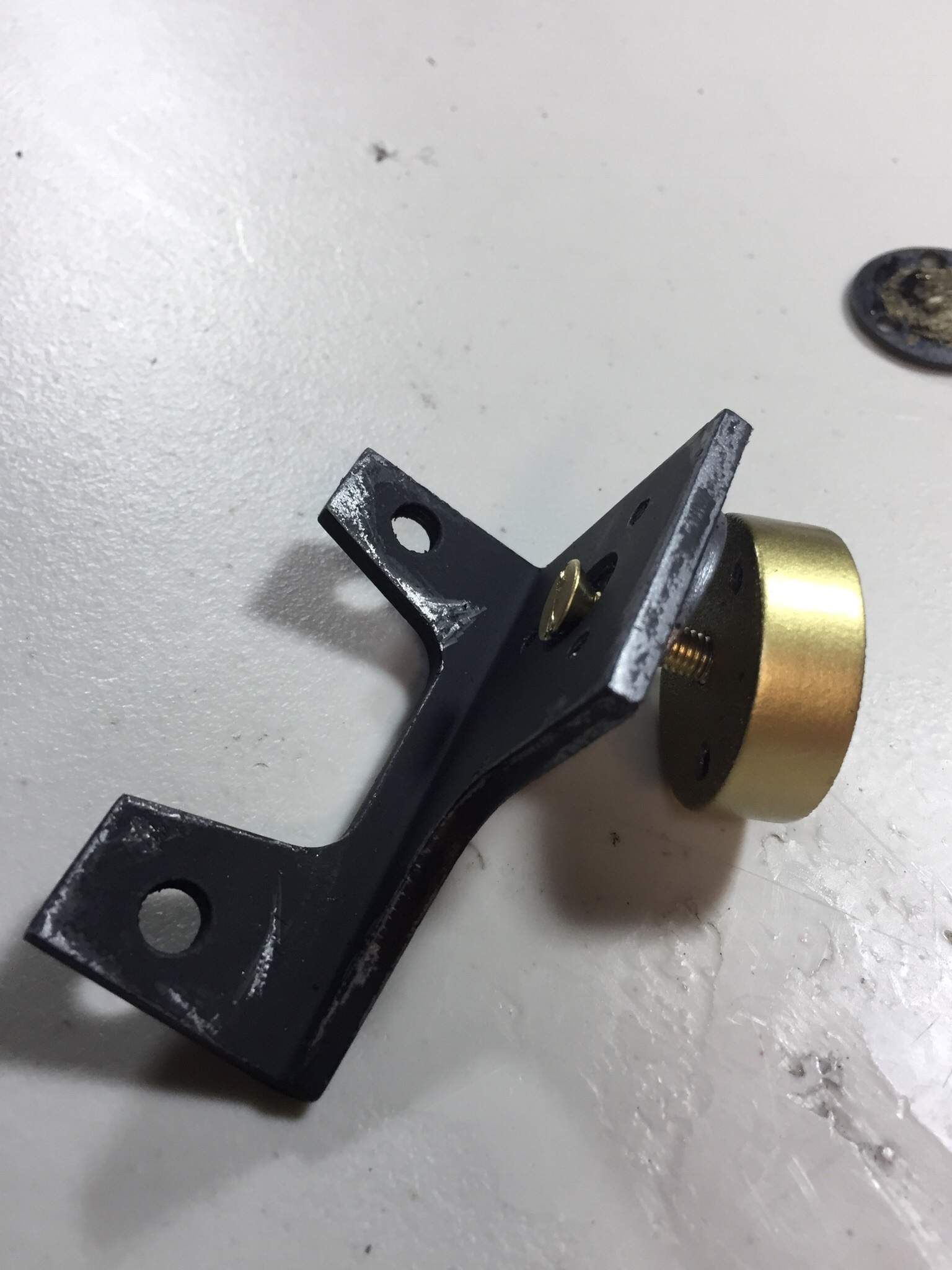

Here is a quick build of Han's HOTH mount bracket. I recently updated the design (subtle modification) so I needed to rebuild it for my blaster. Thought I would share this process as well.

This is what I'm starting with..
Also have a synthetic "mystery disk" on hand that I'll build as well as this metal one..

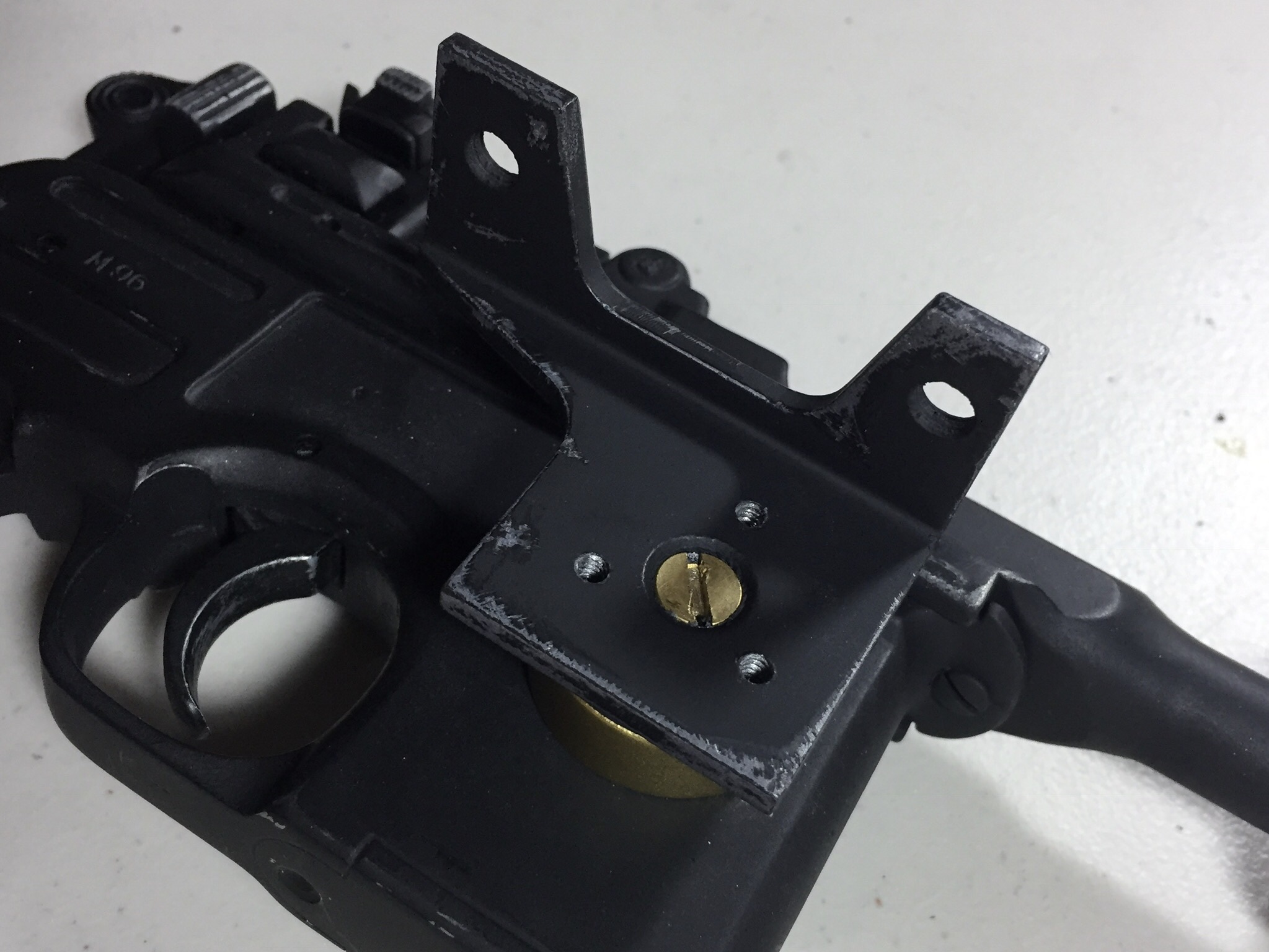

Next I like to attached everything to make sure it all lines up. In this case I'm only adding this mount to a build I've already completed so it's pretty straight forward. Just need to attach and screw everything together..
After it dries I lightly sand the synthetic parts..
Then add some metallic brass and metallic silver paint..
Add the 3/4" sticker the the synthetic "mystery disk" after I've added the brass as I did with the metal one..
Now repeat the painting process with the brass and silver where it's needed..
Add some flat black paint (rub it off the center of the "mystery disk" with my thumb as soon as it's applied)..
Now for the additional weathering..

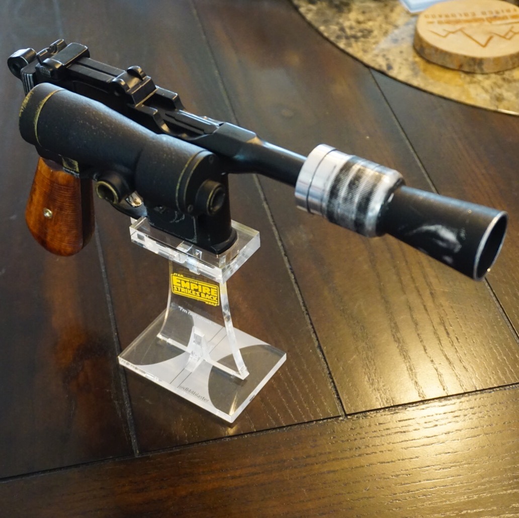

These are some pics of a Fully modified denix build of Luke's BESPIN blaster that I have previously finished..
EDIT/UPDATE: Luke’s film Bespin FYI doesn’t have that Motor/coil back greeblie you see below and also seen on the Master Replicas version..

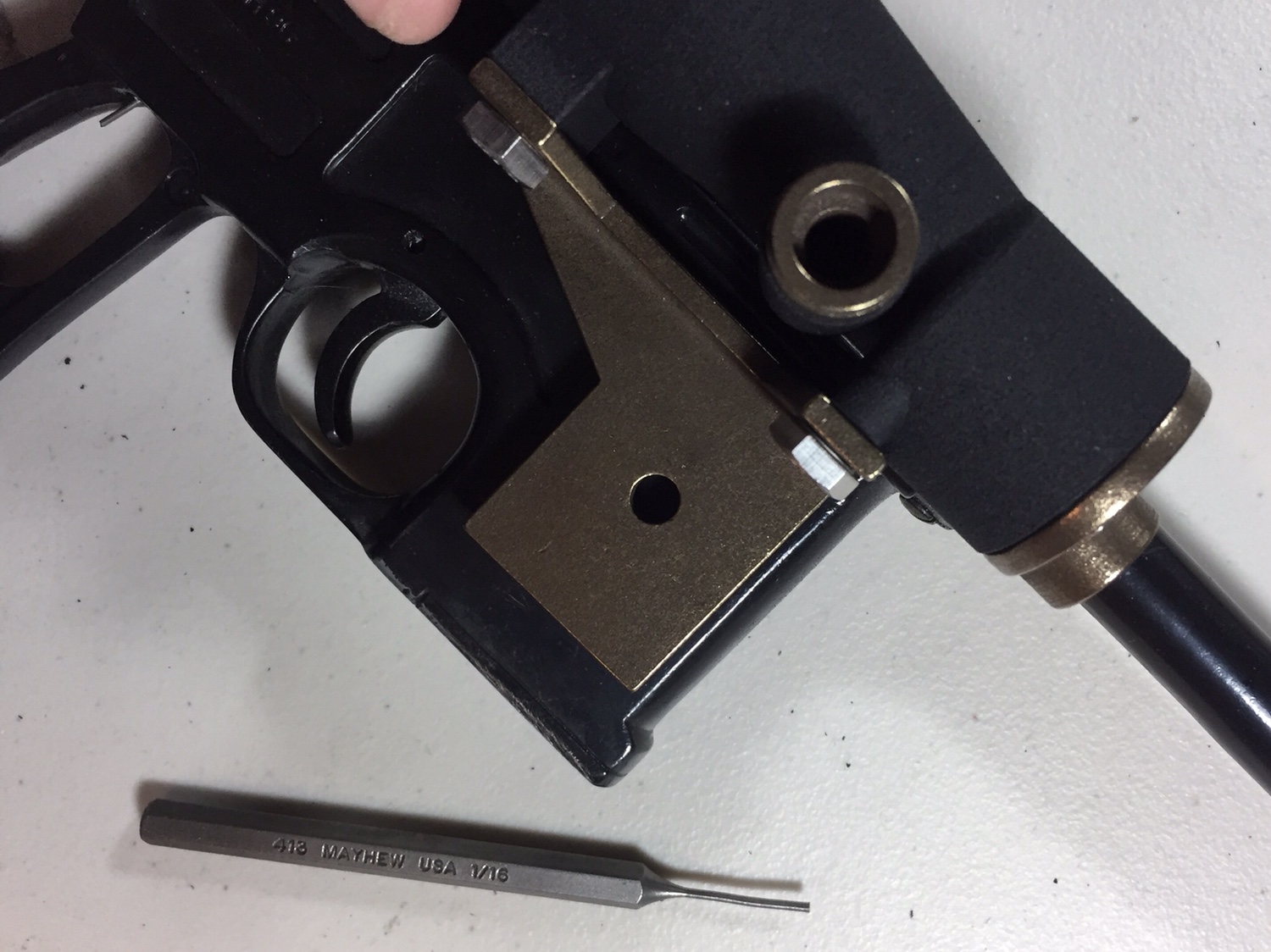

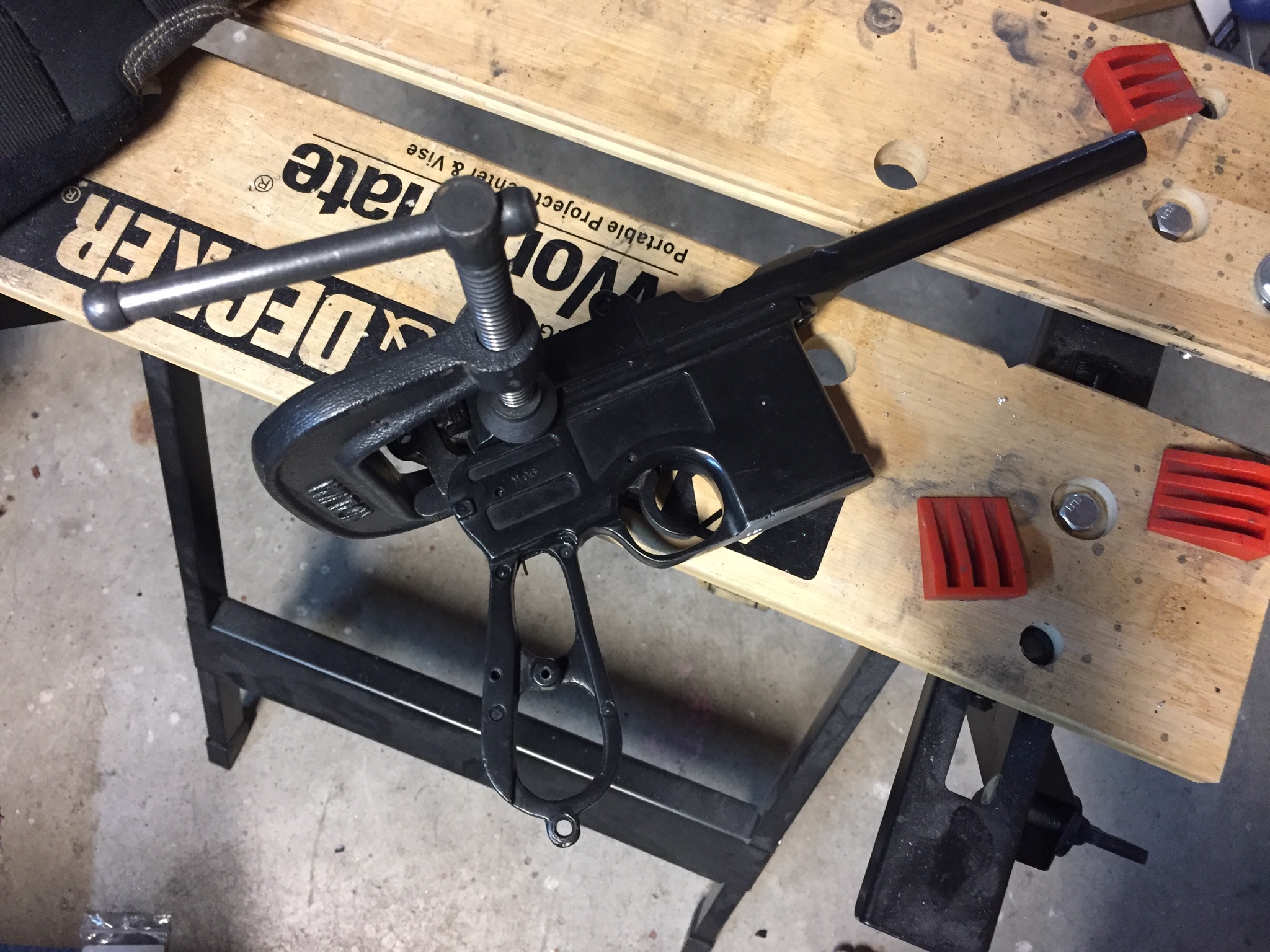

But first I take apart the denix as much as needed to prep for what lies ahead..
Now I cut off the front sight on the barrel to allow for the flash hider to just slide right on..
Then use the Dremel to smooth it out while putting on some safety goggles to keep the shards from blinding me..

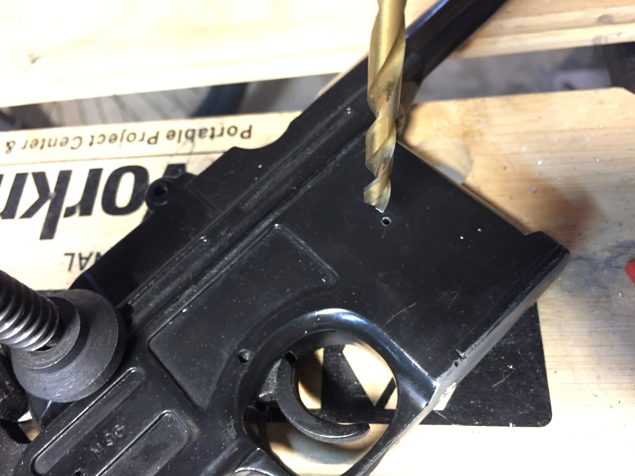

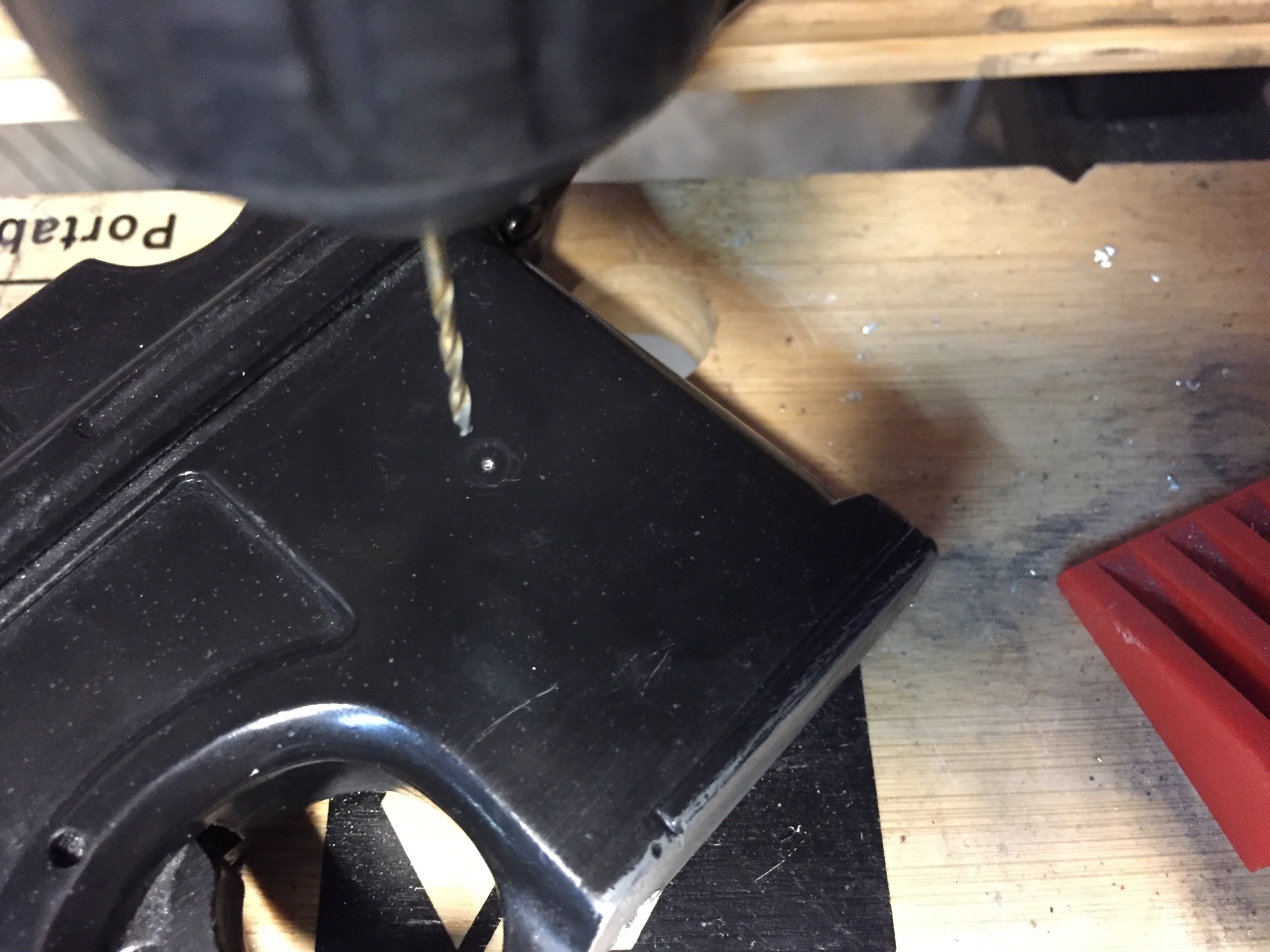

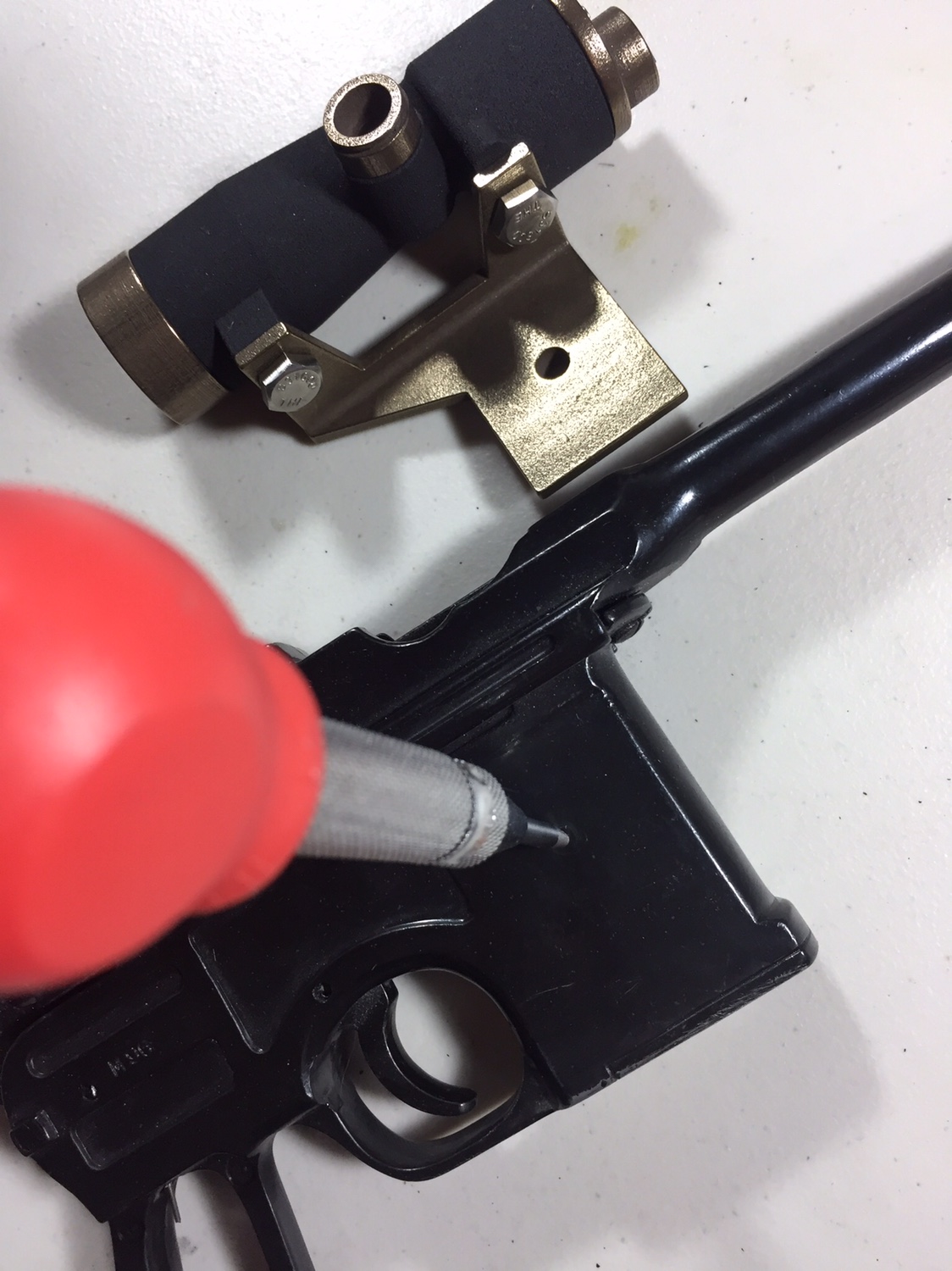

Next up is drilling the mount hole. First I find out just where I want it to be then use center punch to set up my drill bit..
I start by using a small drill bit to find the center punch hole and move upwards from there to drill in the "1/4-20" sized hole for the mount..
Again I did use a bit a little bigger than the previous one before jumping to this 1/4-20 one below..
