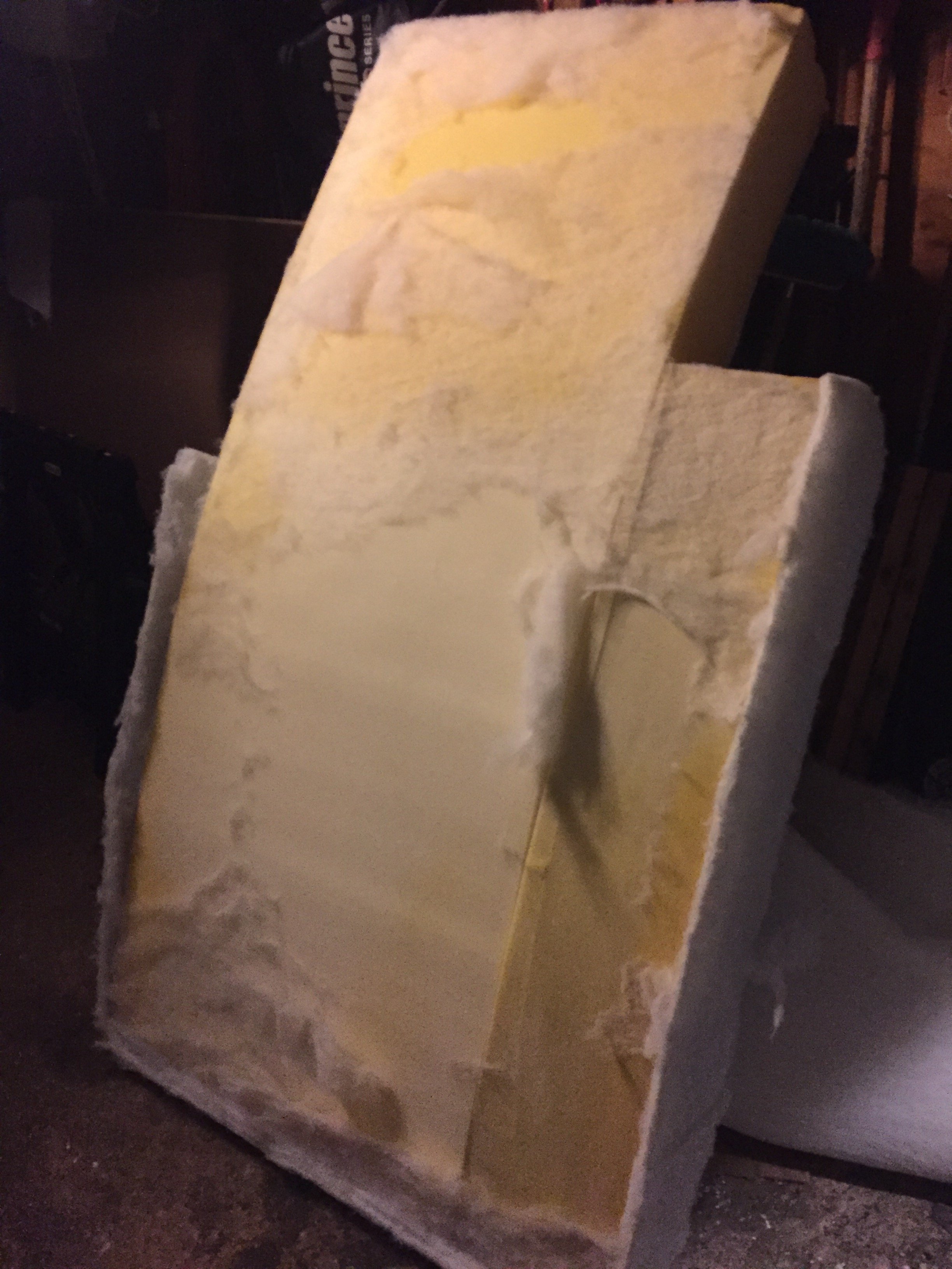

Cut the foam up into pieces. I used a filet knife and it cut like butter, but use whatever you feel safe and comfortable with. Yes, the foam is a touch rough, but I used a layer of some white stuff that felt like fake snow (it was originally attached to the foam cushion but I peeled it off) in between the fabric and foam, and it smoothed out nicely.
Then, I attached some more of that white snow stuff to the edges that the vinyl would be laying up against to reduce corners cutting into the fabric.
To hold the foam to the seat and back while working, I used some spray-on tack adhesive (I would've used Super 77 but we had this laying around and it's basically the same thing.
The back was made of two separate panels, so I upholstered each separately, pulling the vinyl through the middle section so I could get both pieces tight. In order to minimize wrinkles, it is important to pull the fabric TIGHT. Obviously don't rip it, but it is fine to pull on it a bit. I just distributed the load to (I am not joking here) the 800 1/2" staples I used to upholster this chair. Yup. 800. I am not joking. I am thanking the big man upstairs that I have an air nailer/stapler, otherwise this would've been impossible. The reverse section of fabric you see in the first photo is not just for show. When I pulled the fabric tight on the two back panels, you could see daylight between the cushions. There will be upholstery on the back of the chair (not yet, but eventually), but I wanted people to see the proper fabric underneath in the gap, so people probably won't notice the gap at all.
I used the three-layer-thick curved panel (the one I hadn't used yet) for the seat cushion so that it was removable, and matches the design of the actual chair. This is where I deviated slightly from the actual chair. I want to be able to sit in this chair, and so the cushion is a little thicker than the actual chair. However, the visual when someone is sitting in it will be unaffected, and it doesn't throw off the overall look anyhow.
Next, I edged the base piece with a strip of fake-snow-looking-stuff and vinyl and stapled it on. Then came for the big task. I put it all together. The back and base were joined by the side pieces, which I glued fabric to so that the inside looks proper too. Finally, I put the seat cushion in. I was going to screw the cushion in, but the thought of sitting on too-long screws was frightening (they could rip the fabric!), and the cushion fit really tightly, so I decided to just leave it as a friction fit, which seems to work fine. The rest of it is held together with 3" deck screws (deck screws typically have square or star drives instead of phillips, so it was easier to drive them 3 inches into solid masonite).
And now, for the (not so big) reveal! I didn't have the arms cut yet, so until then I can't finish the upholstery because of the order of assembly. But, that's OK, because I am happy with where I'm at.

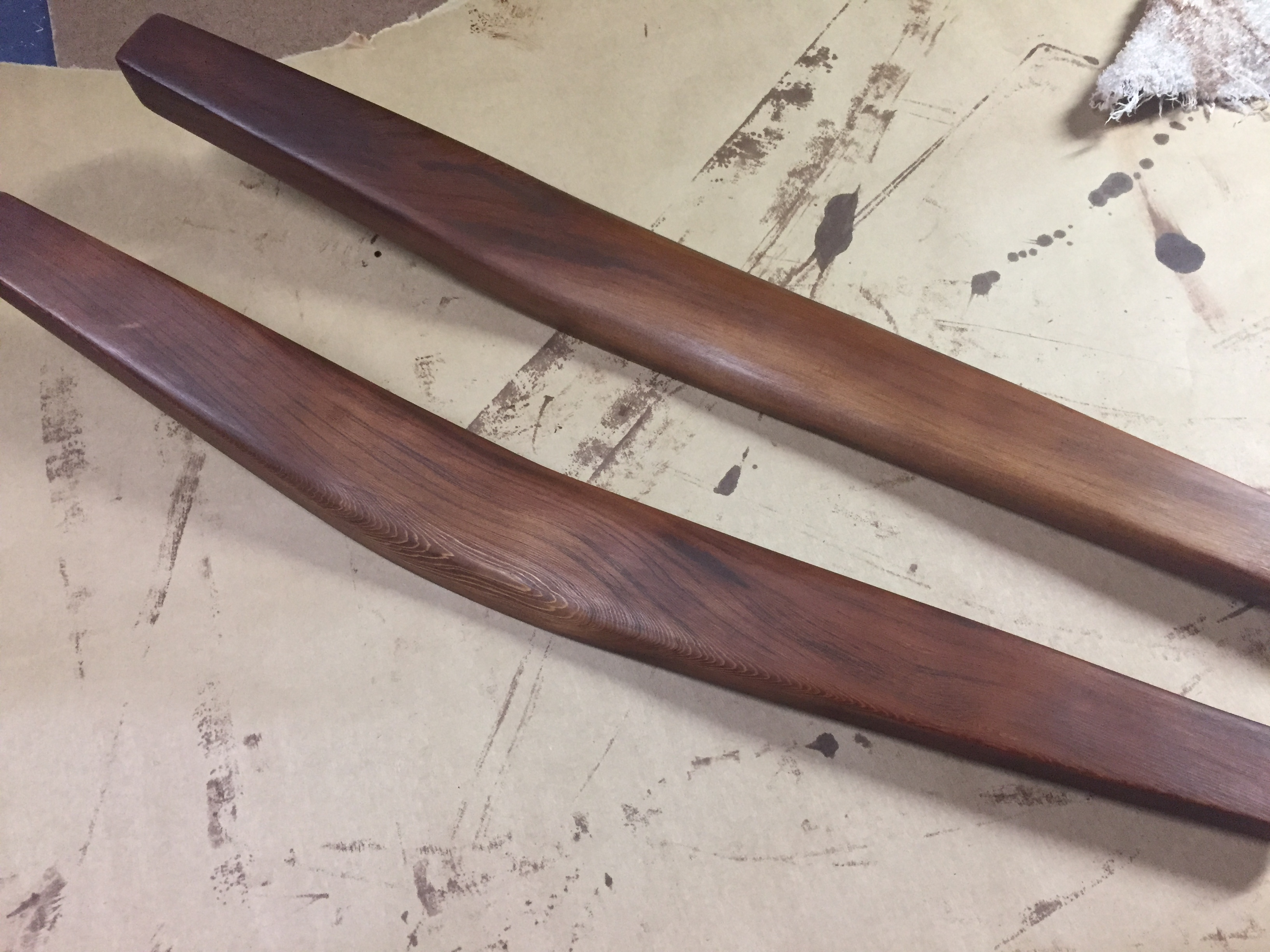

Wow, it's been a few weeks. But, I finally got back to work the last couple days. This weekend's main task: The armrests.
The plans and original chair call for walnut armrests, walnut is expensive and I don't have a planer/jointer so I couldn't glue up the right pieces even if I wanted to. What I did have, however, is some 4x4 clear cedar (clear meaning no knots). It isn't optimal because cedar is soft and will probably get dented and dinged, but I think as long as I keep the chair inside it won't deform too much, and will take stain and maybe some poly OK, as long as I leave some unfinished on the bottom to let the cedar oils get out over time. But first, I had to rehab the band saw. I snapped the only thin blade I had, and the machine is 50 years old, so hunting around for a while to find the right blade was a problem, and I had to re-do the wiring and switch on the machine, but it is now functional and better than ever.
So, some pictures.
Step 1 was to rough out the general shape on the bandsaw. I did the side profile first, then the top profile, but I think you could do it either way. This part of the project can really only be done on a band saw, unless you are really patient and skilled with a coping saw. I was able to cut the full 3.5" in one pass on my saw, which made everything much easier.
Next step was to cut the top profile and start marking the rests up for the edges that needed sanding, everywhere that was sharpied got taken out, and then I repeated the process for the other edge.
Finally, I spend a lot of time sanding. I used the benchtop belt sander at first, but then that got super tedious and I wasn't getting the result I was looking for, so I switched over to a random orbital, which was much better. I started at 40 grit to hog out the material I wanted gone, and worked my way up to 220 on the power sander, and then went over everything with some more 220 by hand to smooth it up. The sander I have has a really great dust-collection system that just plugs into the shopvac, and it makes a HUGE difference in the amount of dust I was making. But still, especially with cedar, which is bad to breathe in, if you're doing sanding you need to be wearing some sort of mask. I didn't wear a respirator because honestly I don't have one, but just something that protects you from sawdust particulates in the air is necessary. I remember one time I didn't use a mask when working with cedar, and I was sneezing and stuffy for an entire week.
After a couple hours of sanding with power tools and by hand, I finally had a product I was happy with. I had to fill a hole with some wood filler, but I suspect that after finish it will barely be noticeable.
Now, the next thing to do is to pick a stain that I like and that will look like the original, because as of now the arms are way to light. I figure I probably have one that'll work laying around, so I grabbed some scrap from the same wood as the armrests are from and did a quick test. I'm leaning towards the chestnut right now, with some poly on top after to seal it up. Forgive my awful handwriting, I was jyst trying to get this part done quick.
Finally, the basement has been getting cluttered with all my projecting, so I did a little bit of housekeeping work. Nothing like a clean workspace. (You can also see the old bandsaw off to the right, the motor isn't even part of the machine, it's a separate part. But, it cuts great and I love old machines when I can find them.
This weeks plan is to start the pedestal and get a few coats of finish on the armrests, so stay tuned for more!

Thanks! I decided on chestnut as well, and put on a first coat.
I really like the way the grain pops. However, and it isn't visible in this picture, there are some tool marks that I didn't notice until the stain went on. It looks like I'm going to be doing more sanding unfortunately, and even though the marks aren't that noticeable, I know they're there so they're getting sanded away. Hopefully it doesn't mess up the stain job too bad.

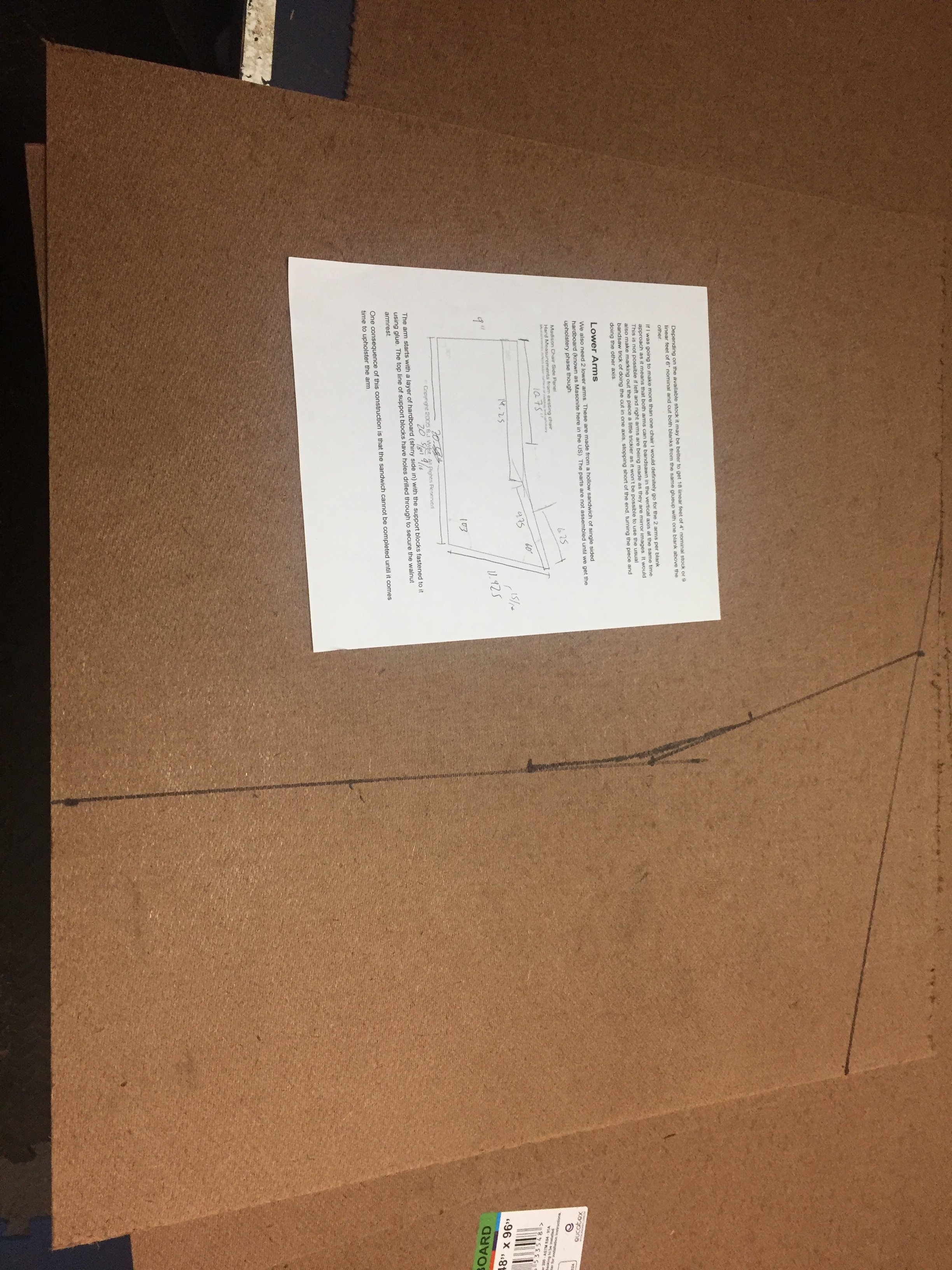

Cutting the plywood
Hey Everyone!
I got some more good work done this weekend. I'm happy to say that I have basically all of the plywood pieces (as they are set out in the plans) cut to size. I have some other pieces to cut later when I figure out how I want to make the consoles removable, but I'll get there when I get there. Anyhow, there were a LOT of pieces to cut and I only had two sheets of 3/4" plywood to do it. So, I started by laying out everything (measure three or four times, cut once). For the round parts, the good news is that I had a very sophisticated, very expensive compass to make perfect arcs with. One thing to remember, the saw blade is not infinitely thin. Mine was 1/8" kerf, so I made sure to leave at least that much between different pieces. Also I had to do some trig, if you're peeping the TI-83 and wondering why.
View attachment 746267View attachment 746268
After markup, still outdoors at this point, I rough cut everything with my jigsaw and circ saw, getting everything into manageable pieces.
Now that everything was in manageable pieces for one man (me) to run through my table saw and band saw, neither of which are large enough to handle full sheets with one person. So, I used these tools to cut everything down to final size. Another thing I find helpful is to cut all cuts with the same dimension at the same step. For example, the console faces are all 5" wide, and there are 8 pieces total, so I made sure to set the table saw fence once, and cut all of them before moving the fence again, to ensure that all the pieces are as close to the same as possible. For some of the pieces (like the disks and console sides) I pinned the pieces together with a couple brad nails, and cut them together to make as perfect a match as possible. One day's work and a broken band saw blade later, I wound up with a whole heap of pieces ready for assembly (on another day).
