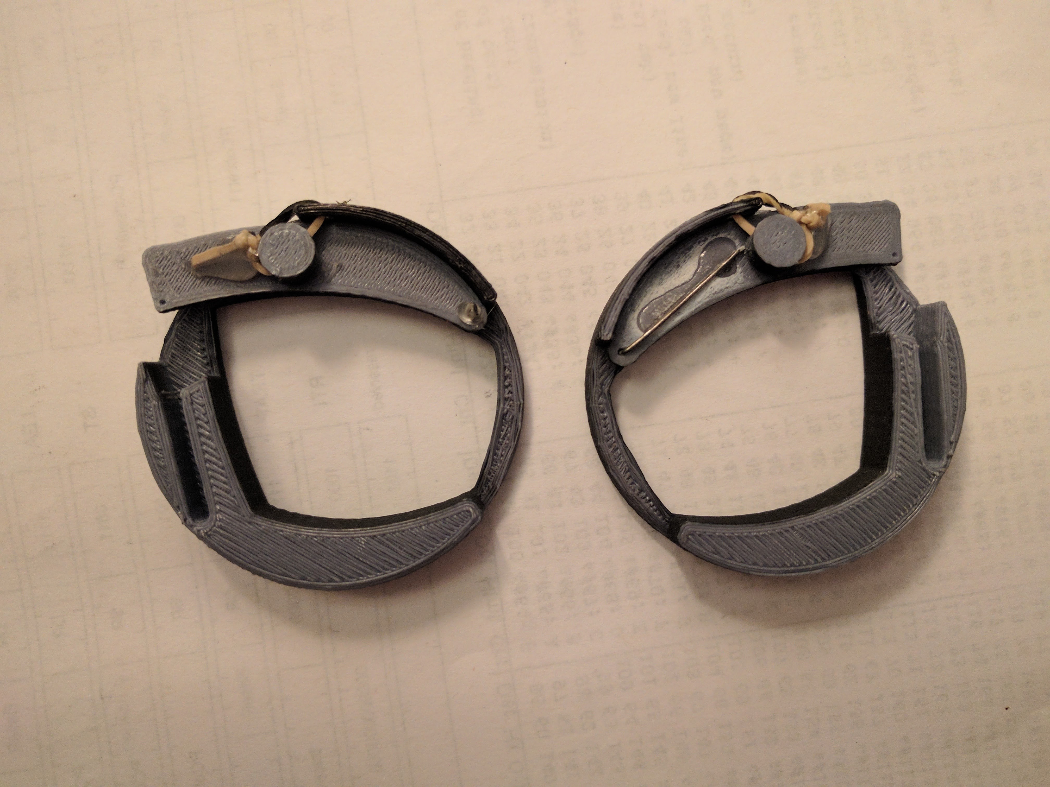

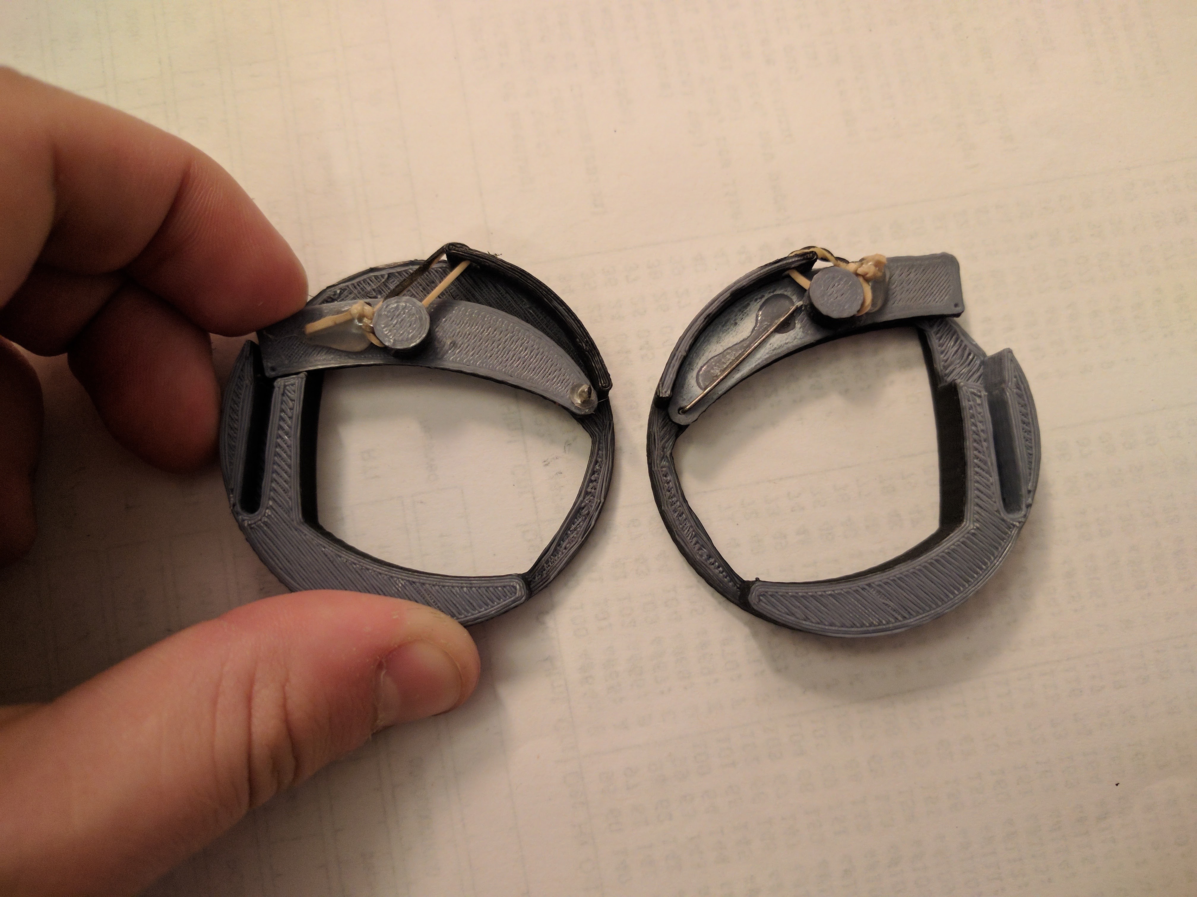

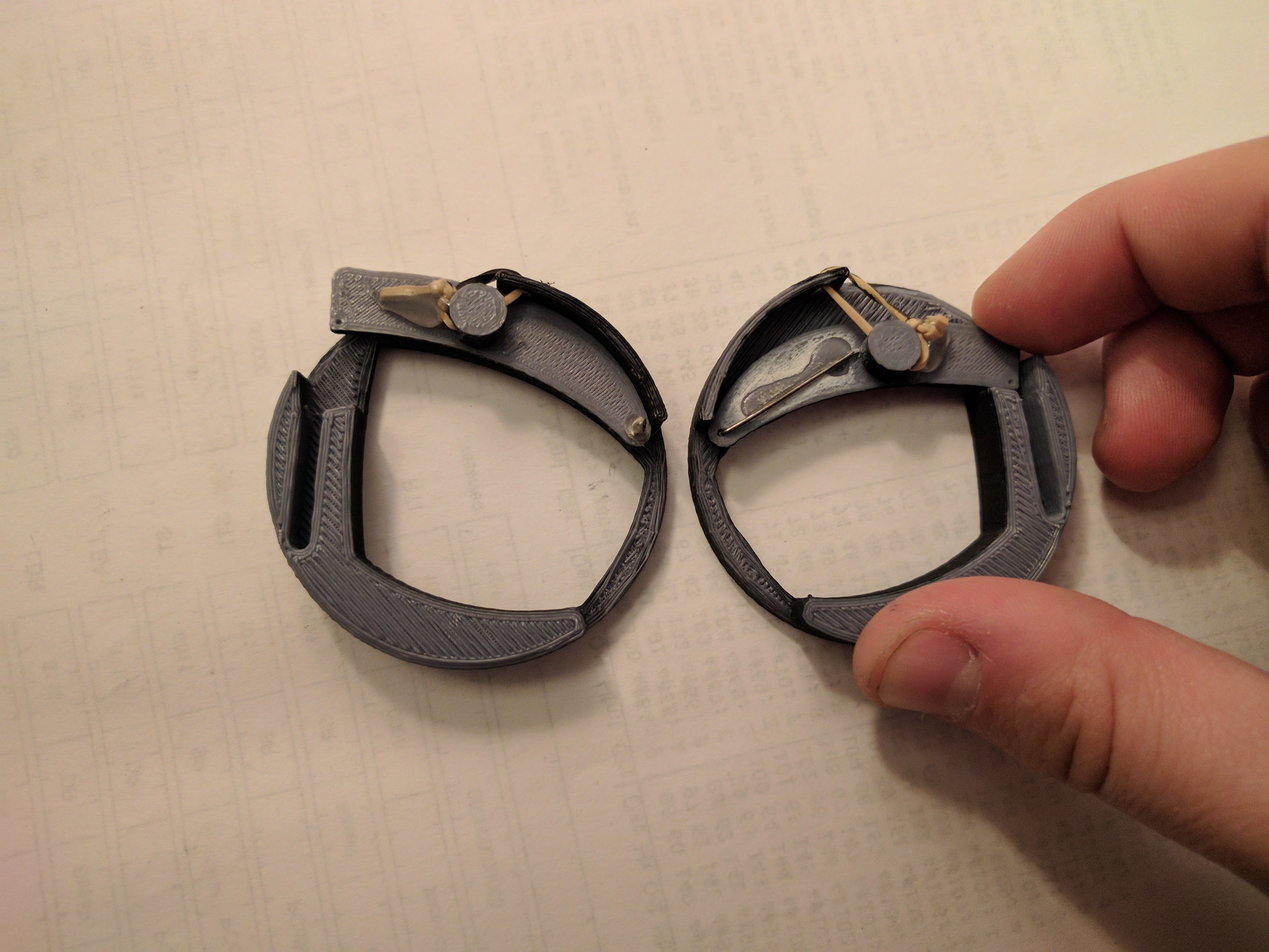

Got some prototypes, and they honestly work really well so far. The joint that I designed in Fusion360 was too small and broke off in like 5 seconds, so I took a needle and hammered it in a and cut it and glued it to size. Not perfect, probably a little dangerous, but it works pretty well imo. The hole I made in the lenses for the string was also too small, so I'll probably have to heat up a needle to get something through there, which I'm not too stoked about.
IMG_20170620_013539.jpgIMG_20170620_013550.jpgIMG_20170620_013603.jpgIMG_20170620_013612.jpg
Also need to redesign those webshooters to be able to fit a microservo, since right now there's not enough space. So far things are coming out nicely. Probably won't have this done in time for the premiere, but I wasn't really planning on it.

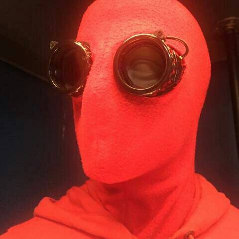

Ey boys, now it's time to get serious. My welding goggles showed up today, about a week earlier than I expected. A surprise to be sure, but a welcome one.
Yesterday I used a match and a needle to get some fishing wire through the lens, then used a hot paperclip to make a sort of pulley that lets the string be pulled perpendicular to the lens motion. I added some mesh that I spraypainted white and superglued it onto my lens frame.
Now to the goggles. I took the goggles off the strap and took them apart.

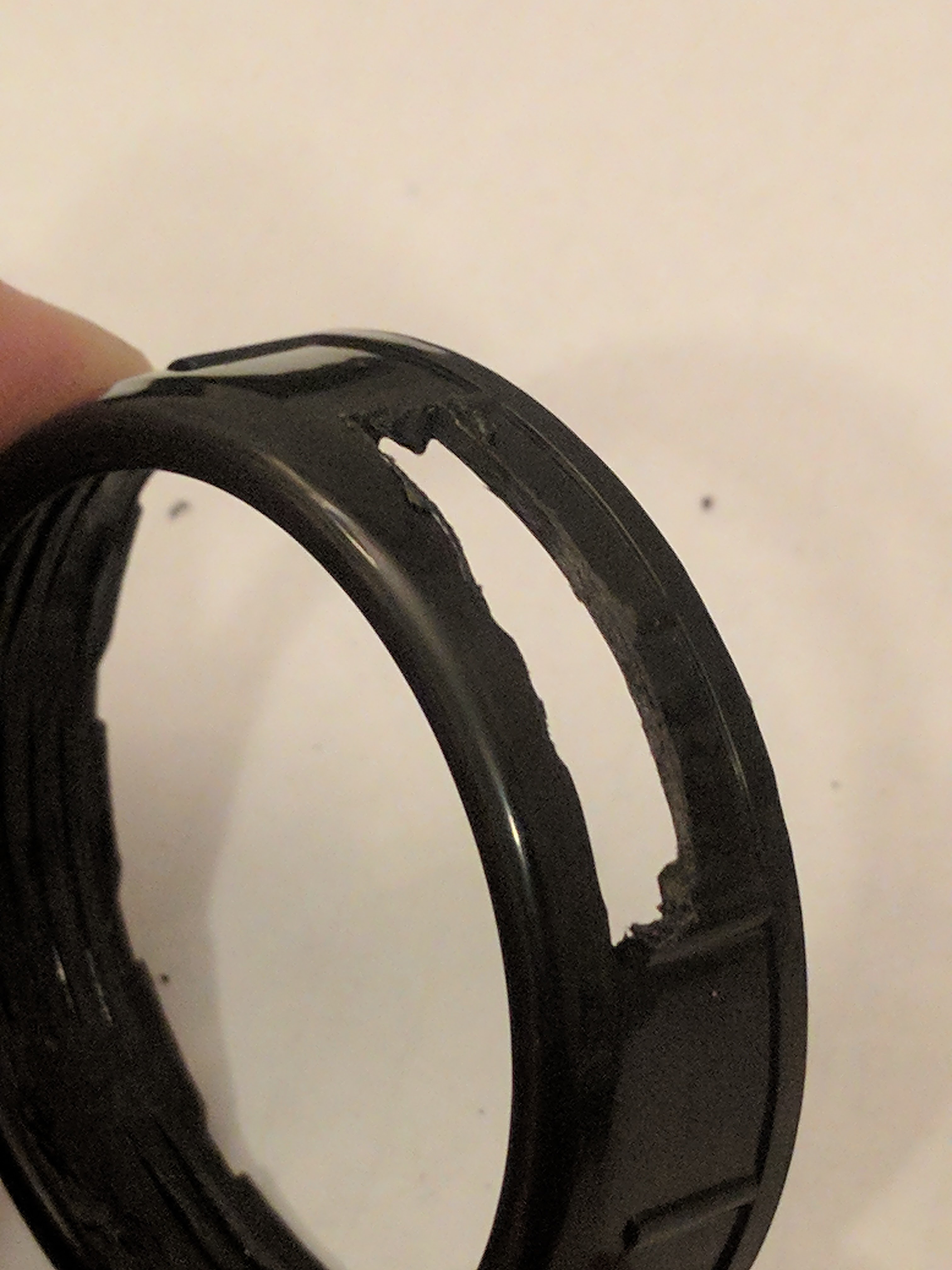

Next I took the main part of the goggles and used a dremmel to cut it down.
Then I took the other piece (the part that normally screws onto the goggles) and used a dremmel again to cut a chunk out of it. I overdid it on my first try and made mine too long. The cut should "1 and a half notches" if that makes sense. This will let the lenses move freely. I also took another dremmel bit and smoothed out the inside of it so things would fit a bit better.

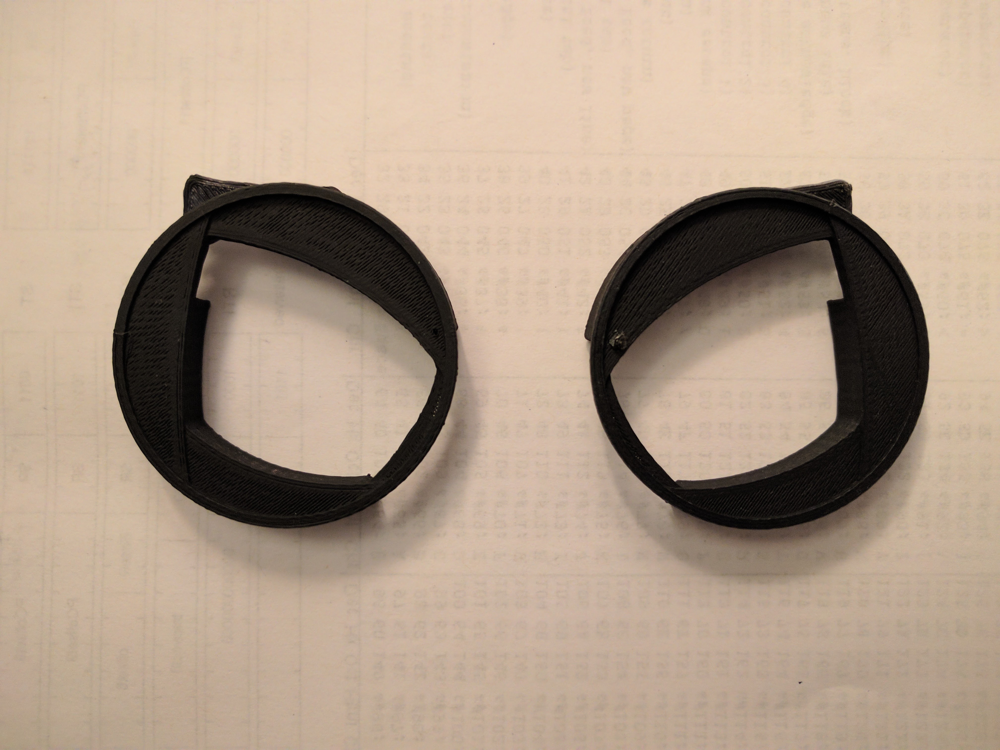

Version 1 of the lenses is now up for download. These aren't the exact files I used. I made the holes in this version a big bigger so nobody would need a hot needle like I did. They'll be coming to shapeways as well for those who don't have a printer.
https://drive.google.com/drive/folders/0B1h3JuMp6PKLbUJMcFhJNnVYbjA?usp=sharing
Not sure if I want to make a V2. If I did it would probably make it all one piece with the goggles part of it all
