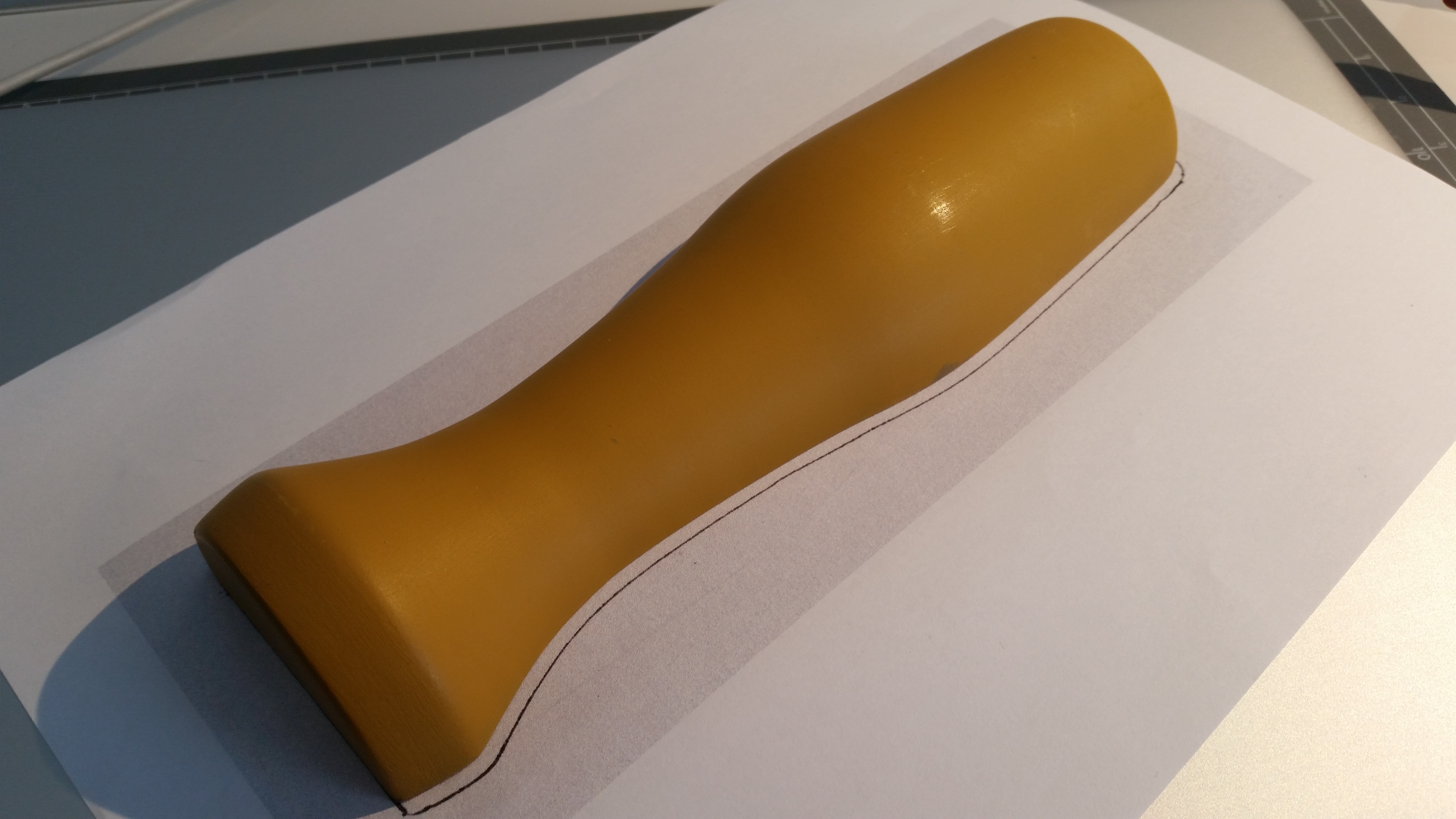

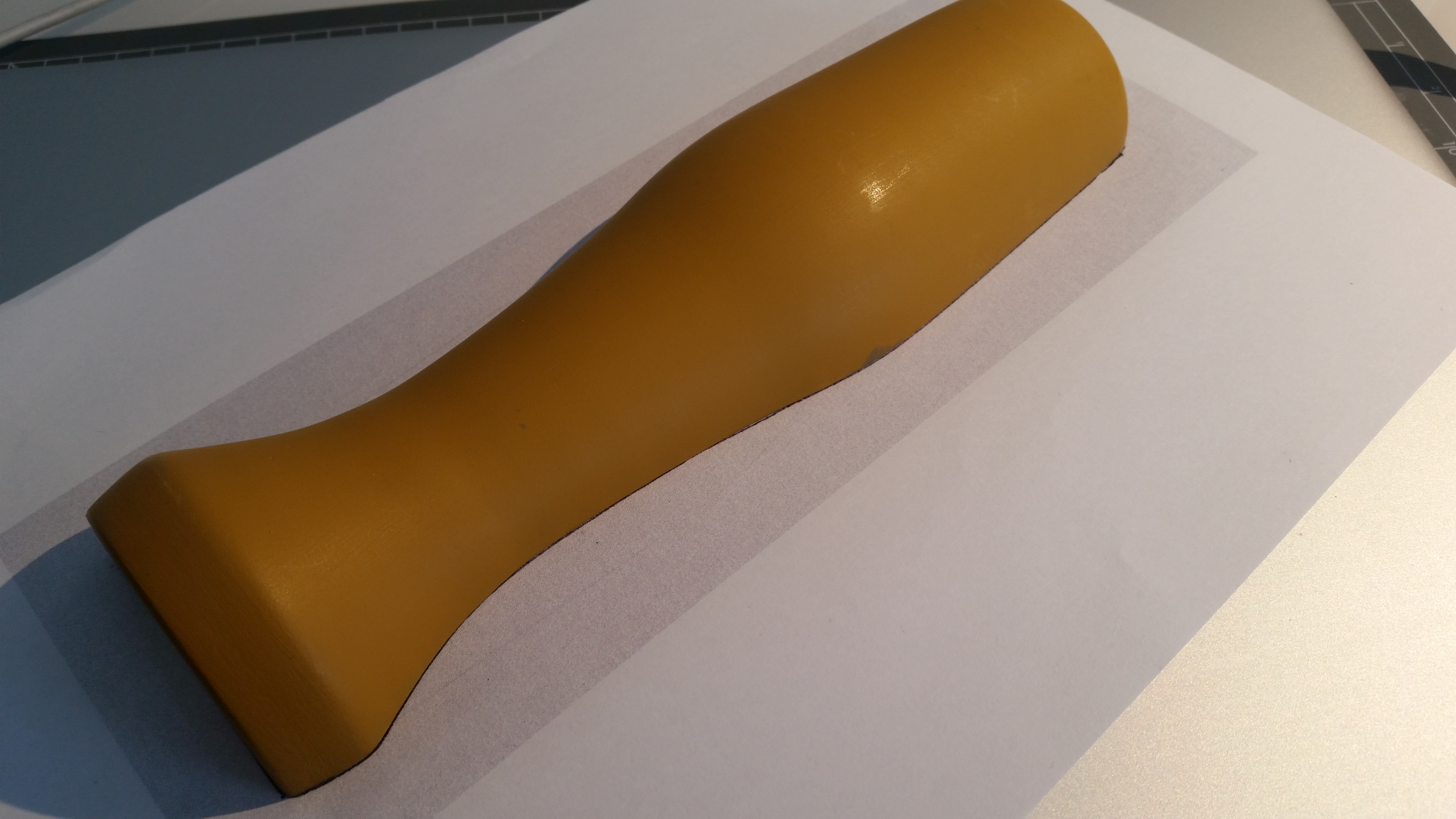

Heres a few photo of my buck against a printout of Gary's tracing, you can just see the outline at the edge of the buck, I think its as spot on as you could ever get it!
Here I have offset it slightly to show the profiles side by side.
And here I drew around half of the profile in red pen to show how well it matches up.
This is the polished buck just before it got moulded.

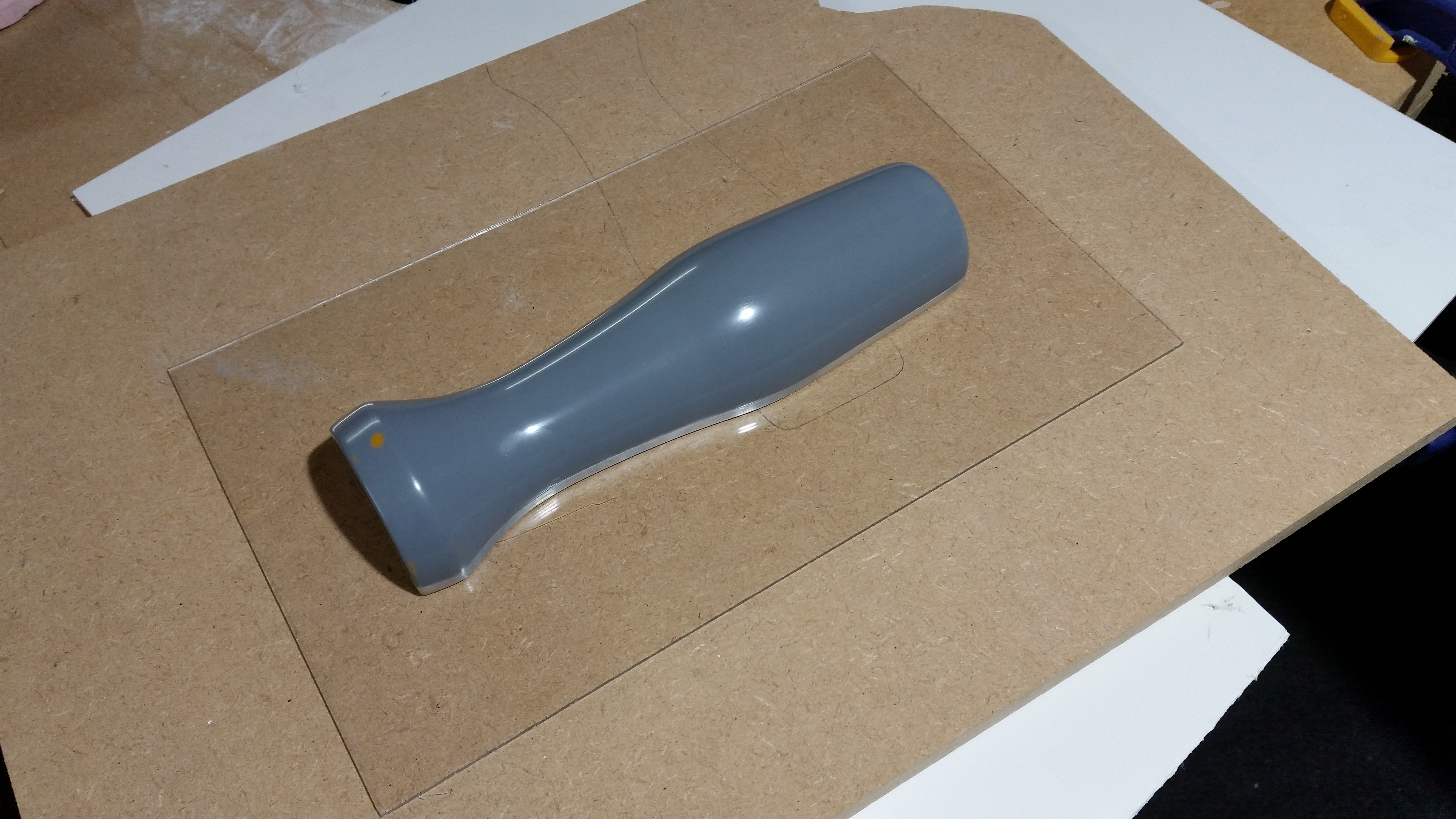

I then moulded and cast two bucks ready for vacuum forming. I knew my master was the exact size that I wanted it to be so to avoid any shrinkage and also to help thermally when it came to vacuum forming I cast the bucks out with a mix of resin and aluminium powder.

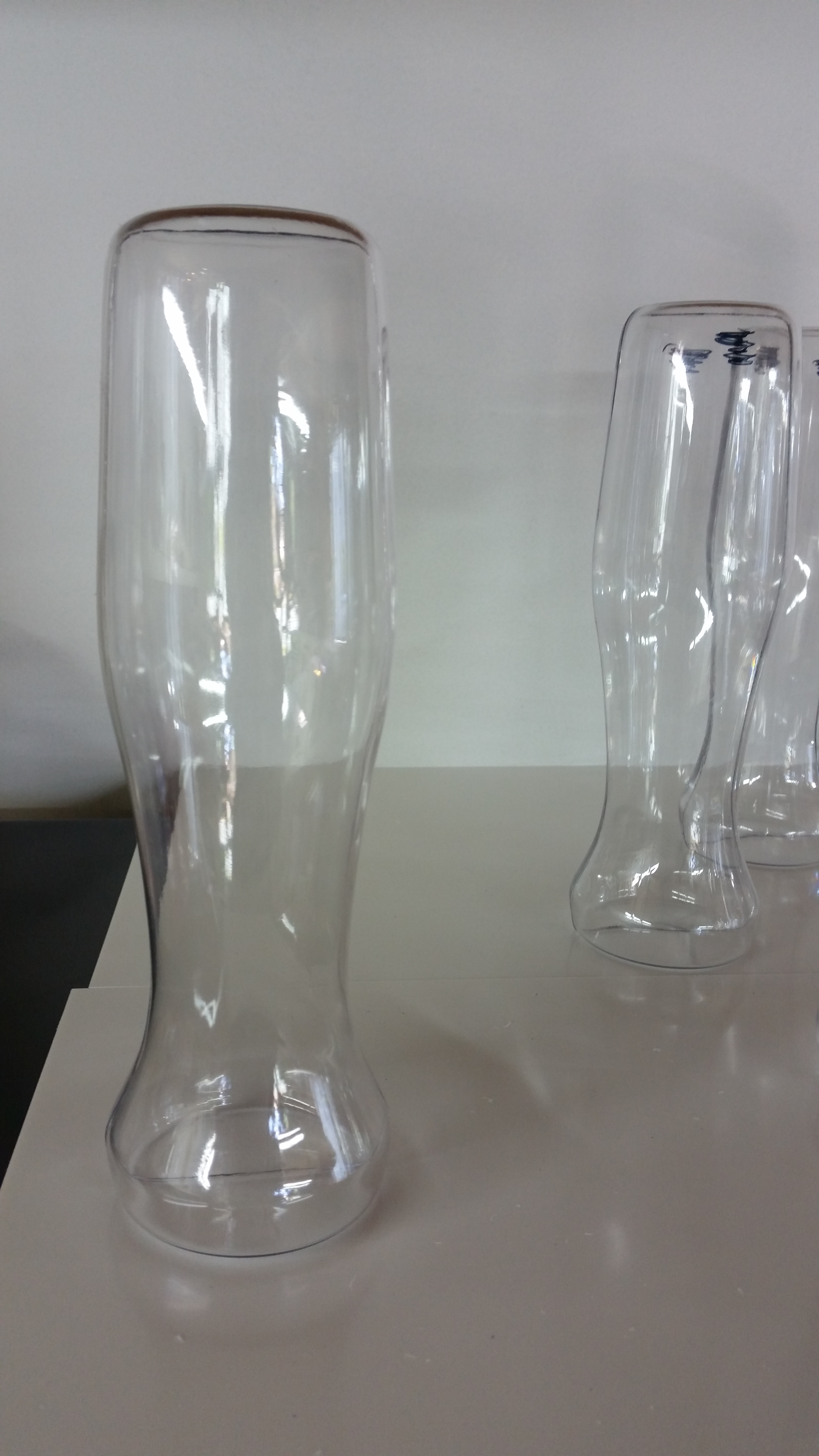

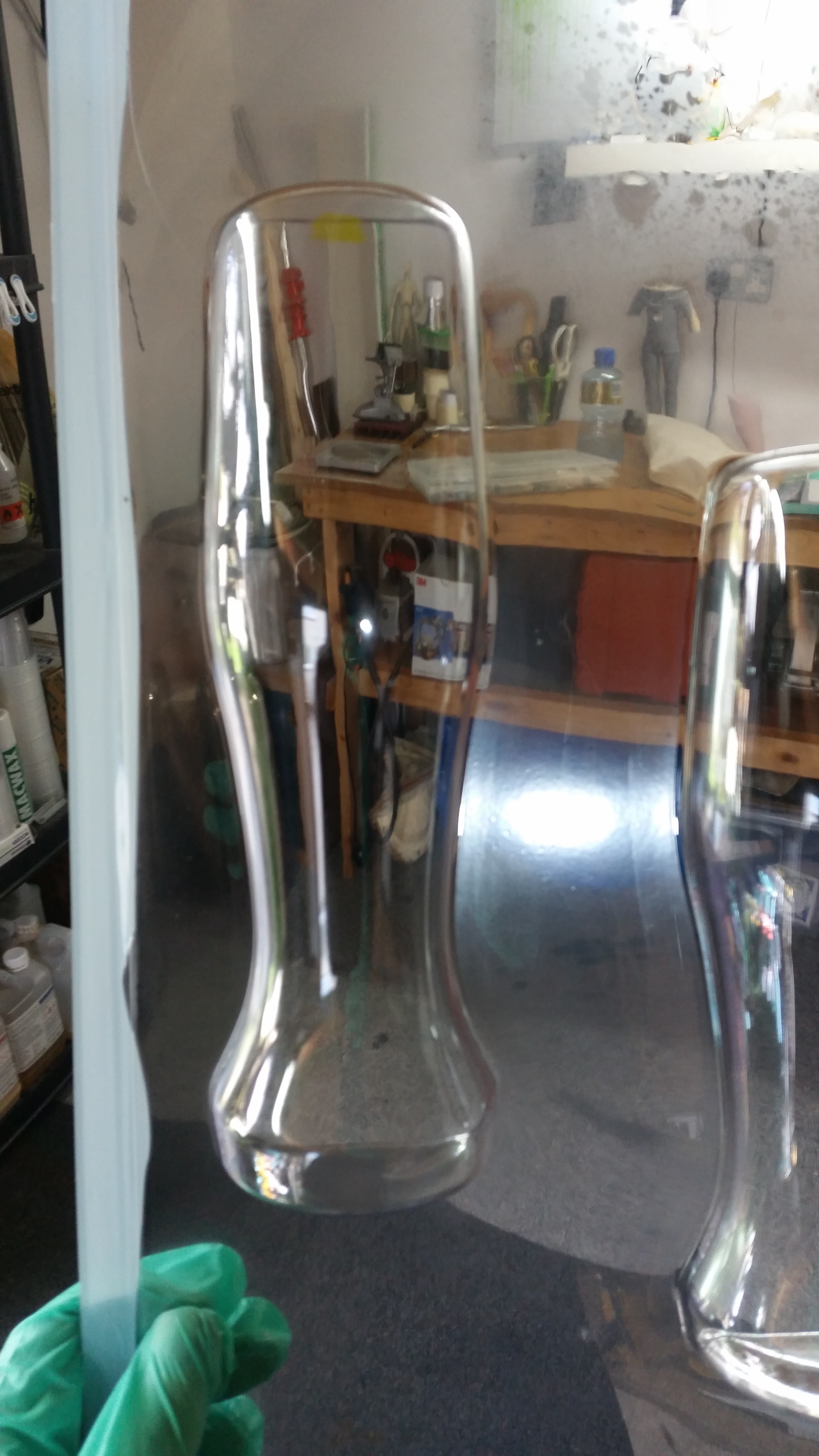

It took me a looong as time to figure out the kinks when it came to getting good vacuum form pulls with good clarity but after buying a Ionized air gun the clarity in the pull was as good as I could possibly be for a vac form
I then trimmed the forms and then the hardest part of all came.
Gluing!!! I really have to give it to Gary Weaver. There is no easy way to make these bottle and have them screen accurate and gluing these things is not an easy task to figure out.
But I got there!

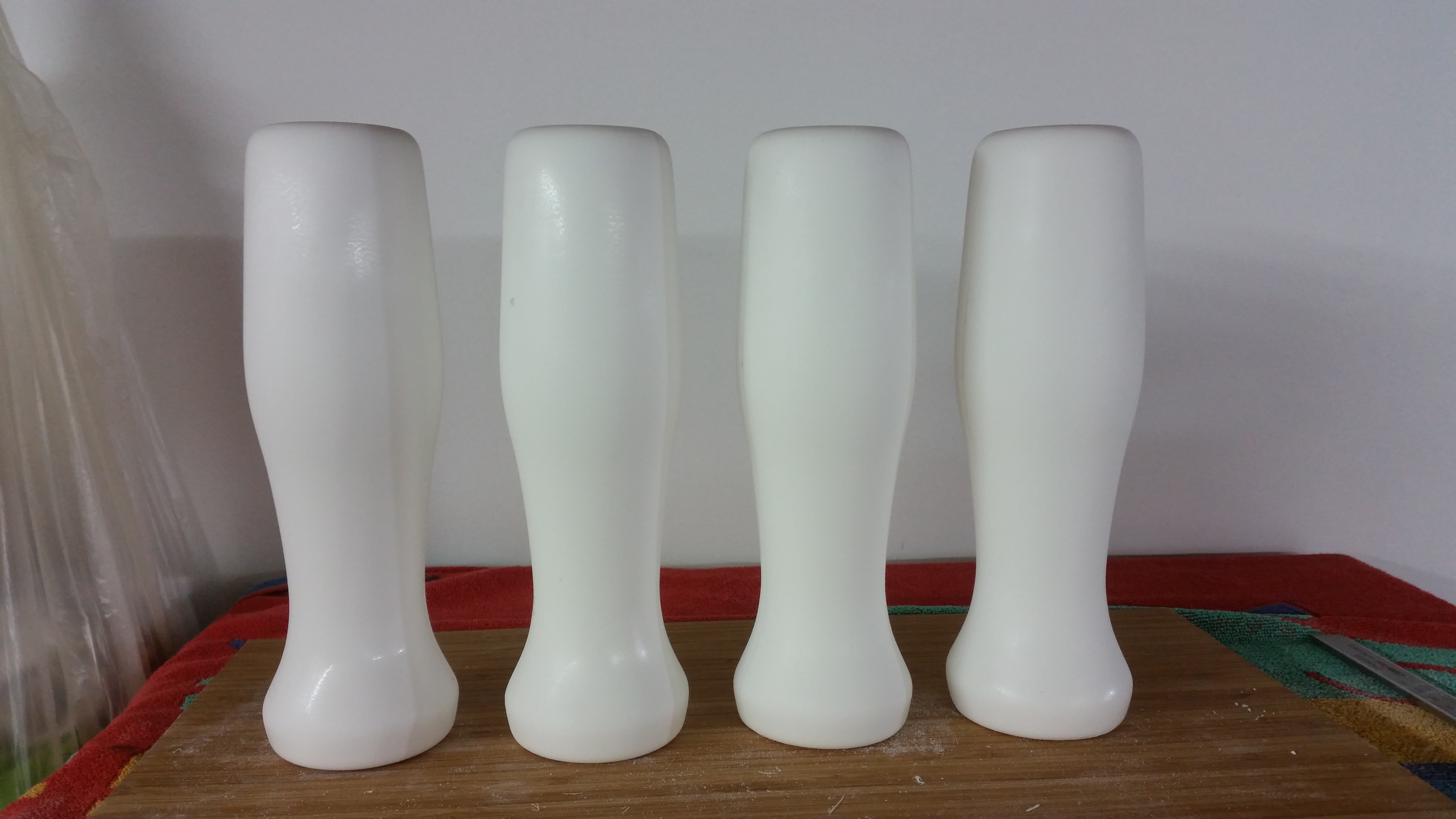

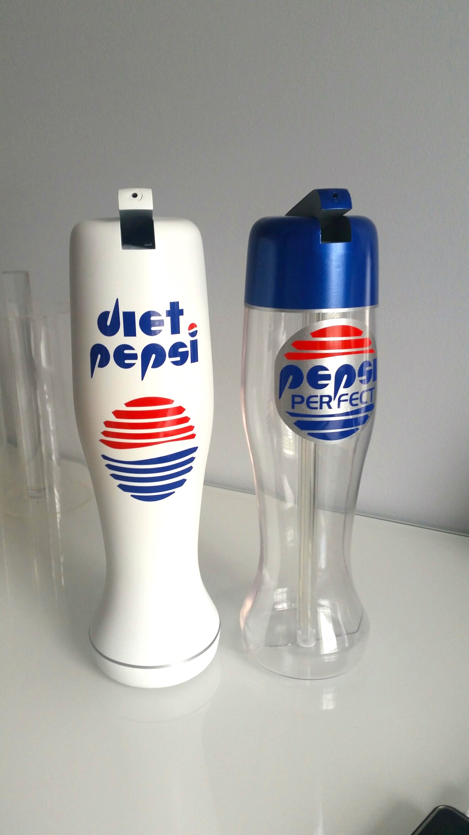

I also made some white pulls to make the Diet Pepsi bottle.

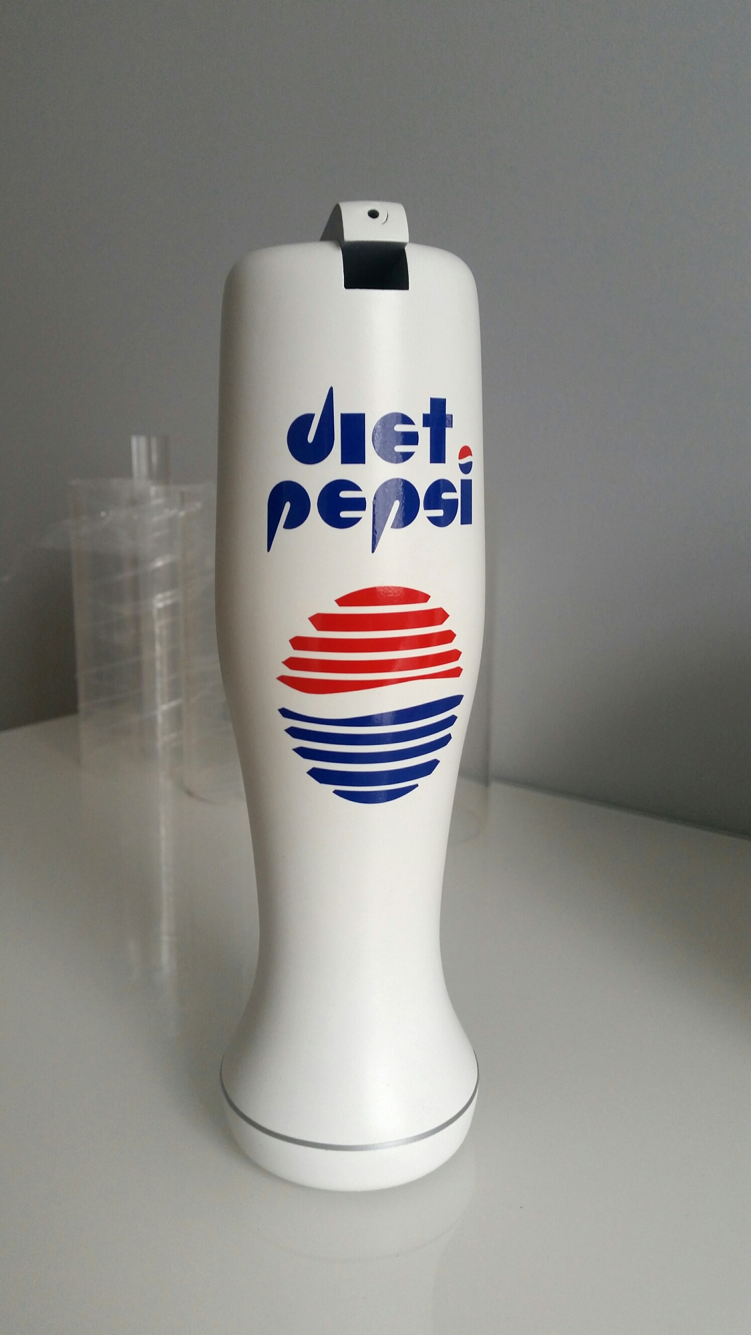

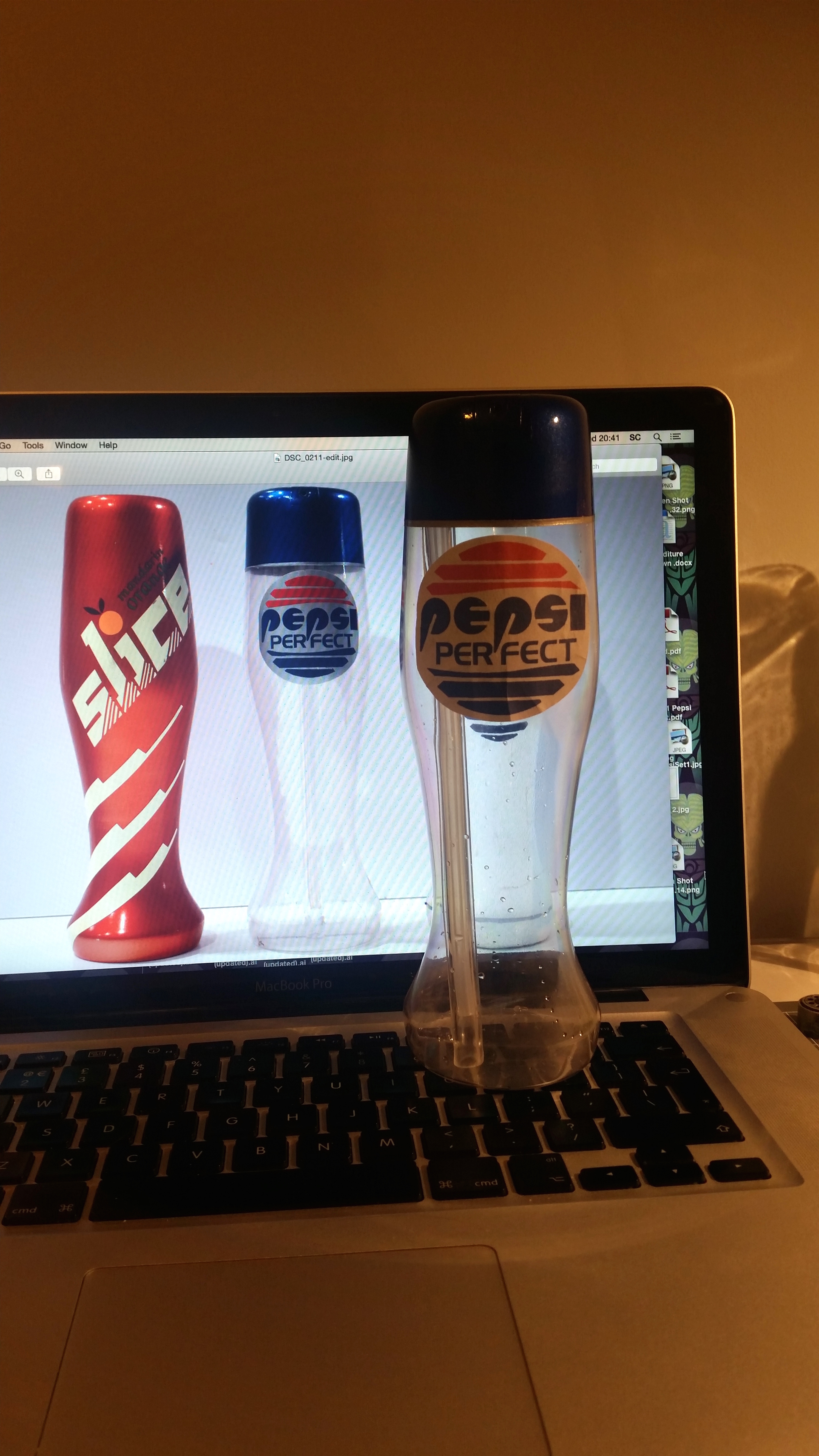

I quickly made up a prototype bottle with all the bits i have so far just to see how it looks and here it is. I haven't glued in the rigid straw that runs down the middle here so thats why its off to one side and obviously I still need to get Vinyl labels made etc. Sorry for the bad lighting.
Let me know what use think. I do plan on selling a few so if anyone is interested let me know. I will be posting more as I get further on with the project.

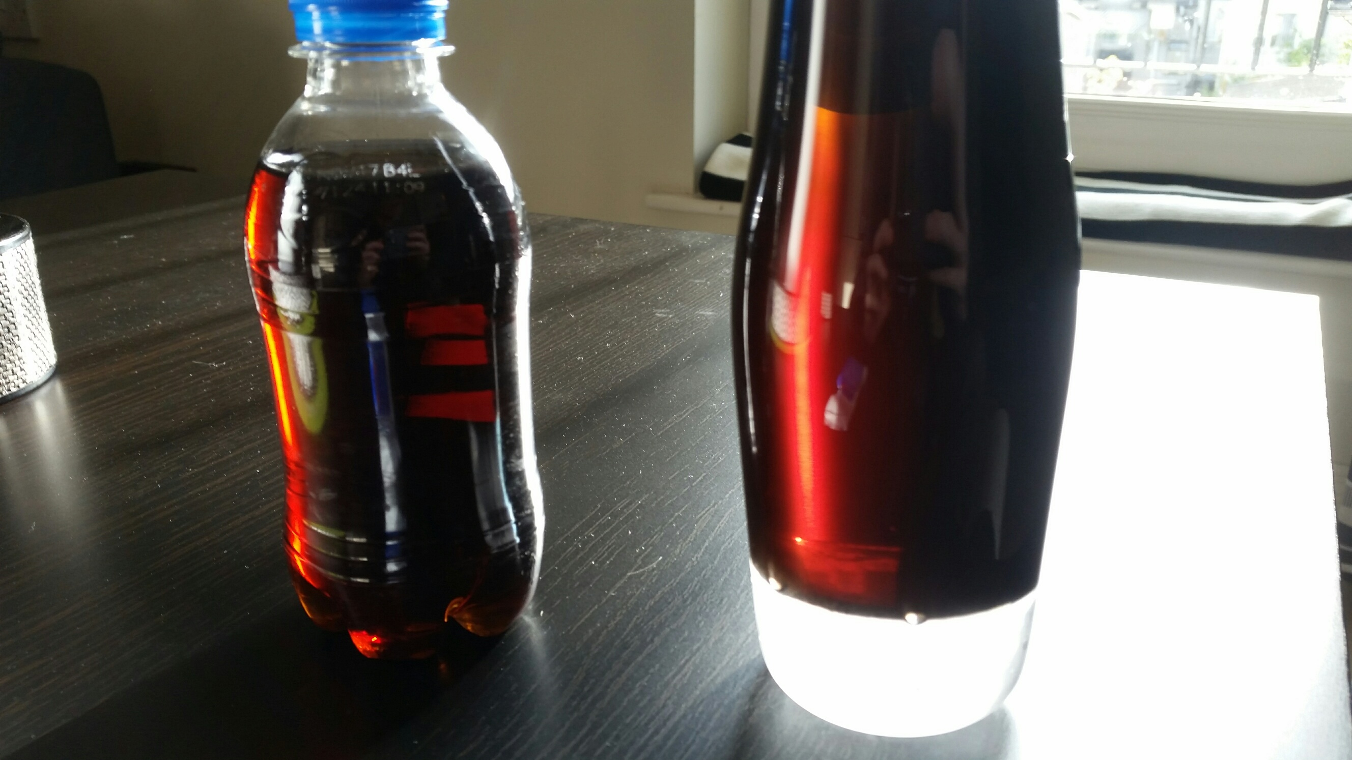

Just a quick update. Ive installed the flip up straws and I have also be doing a bit of experimenting using resin as pepsi.
You can see here I have colour matched resin with pepsi. The colour is pretty spot on :)
20170518_141133_1495472113142_resized.jpg20170518_185350_1495472105437_resized.jpg20170518_185247_1495472107512_resized.jpg
And one more of the bottle upside down just to prove that I didn't just pour pepsi into it. Lol
