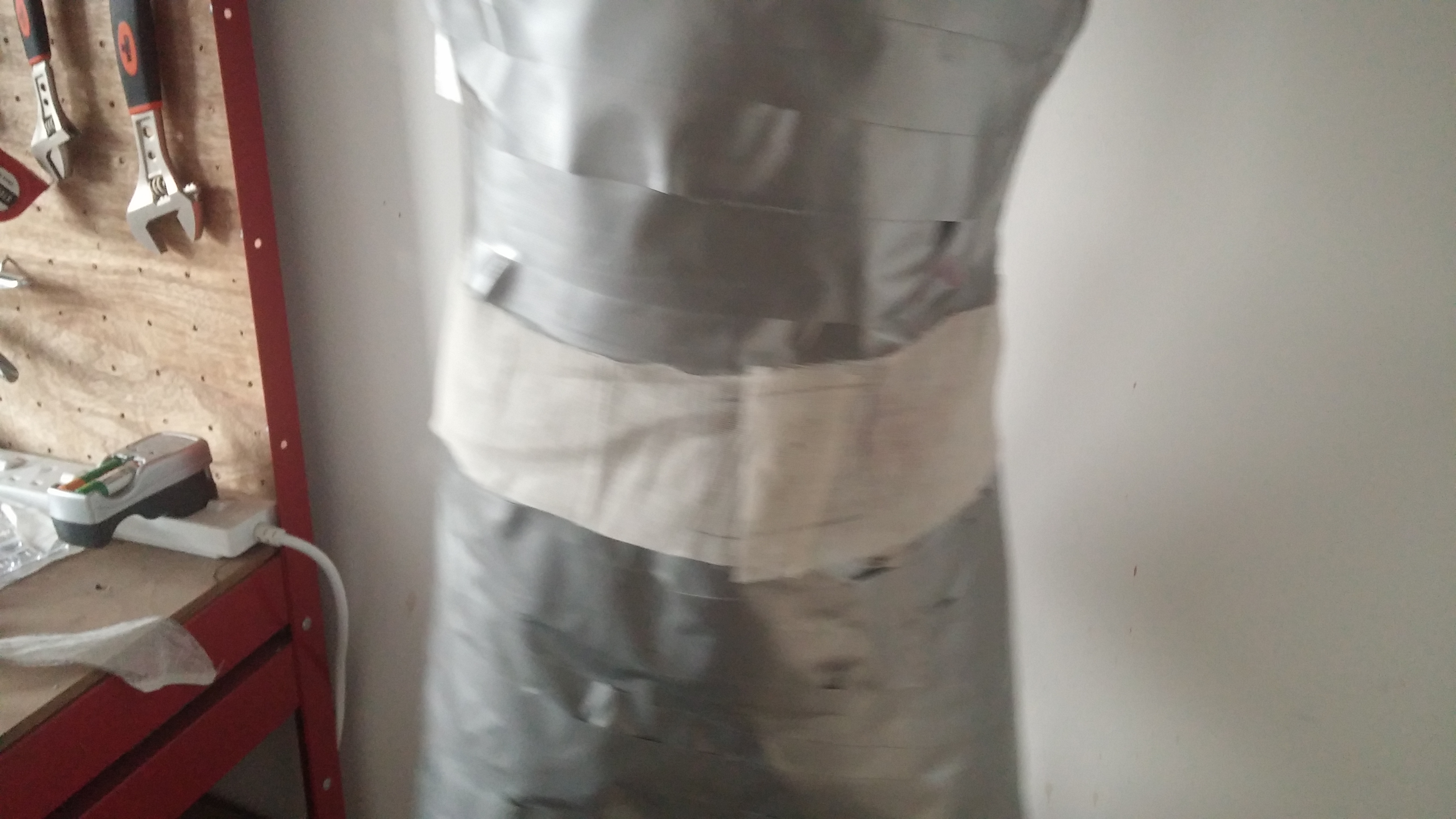

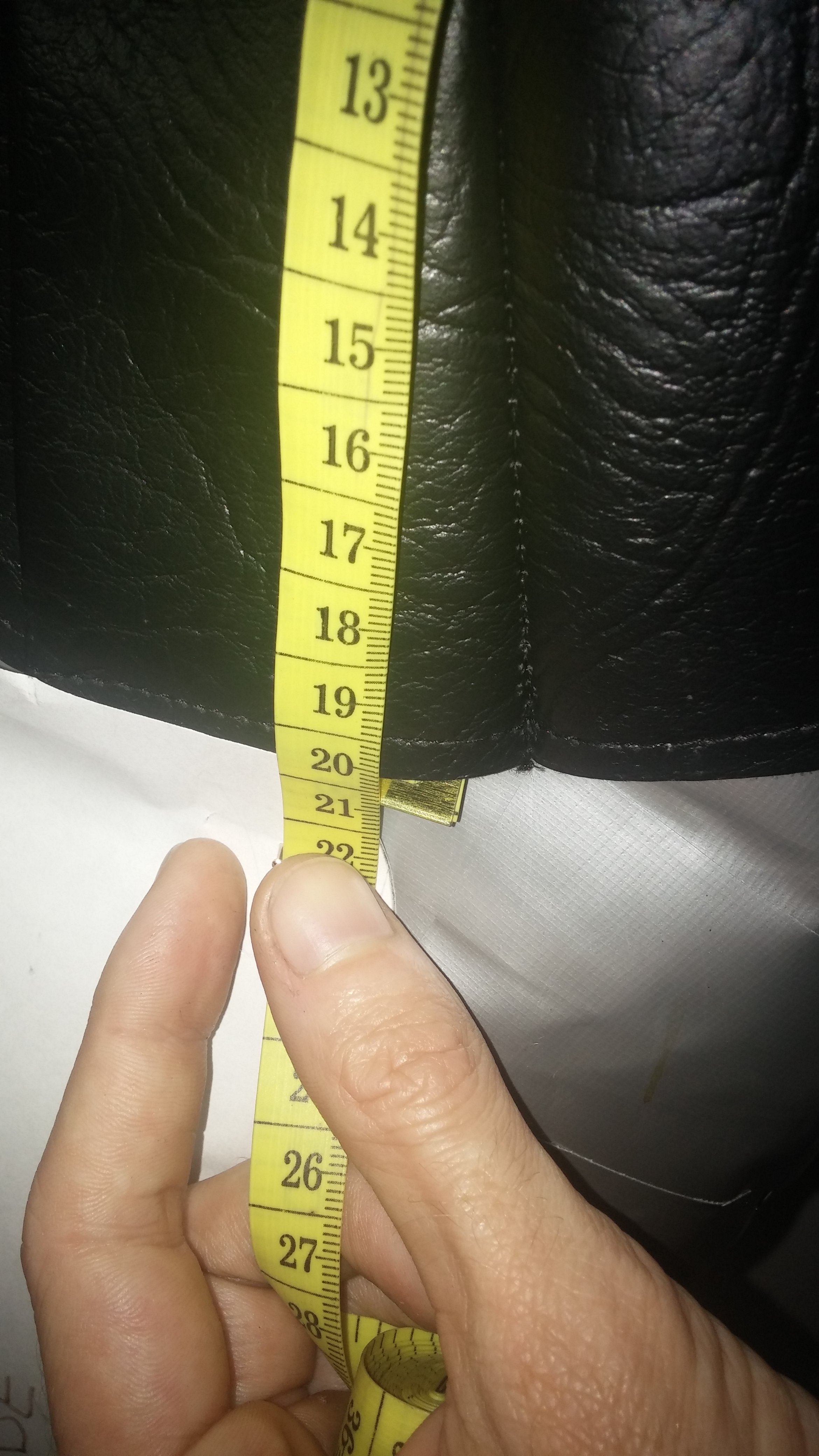

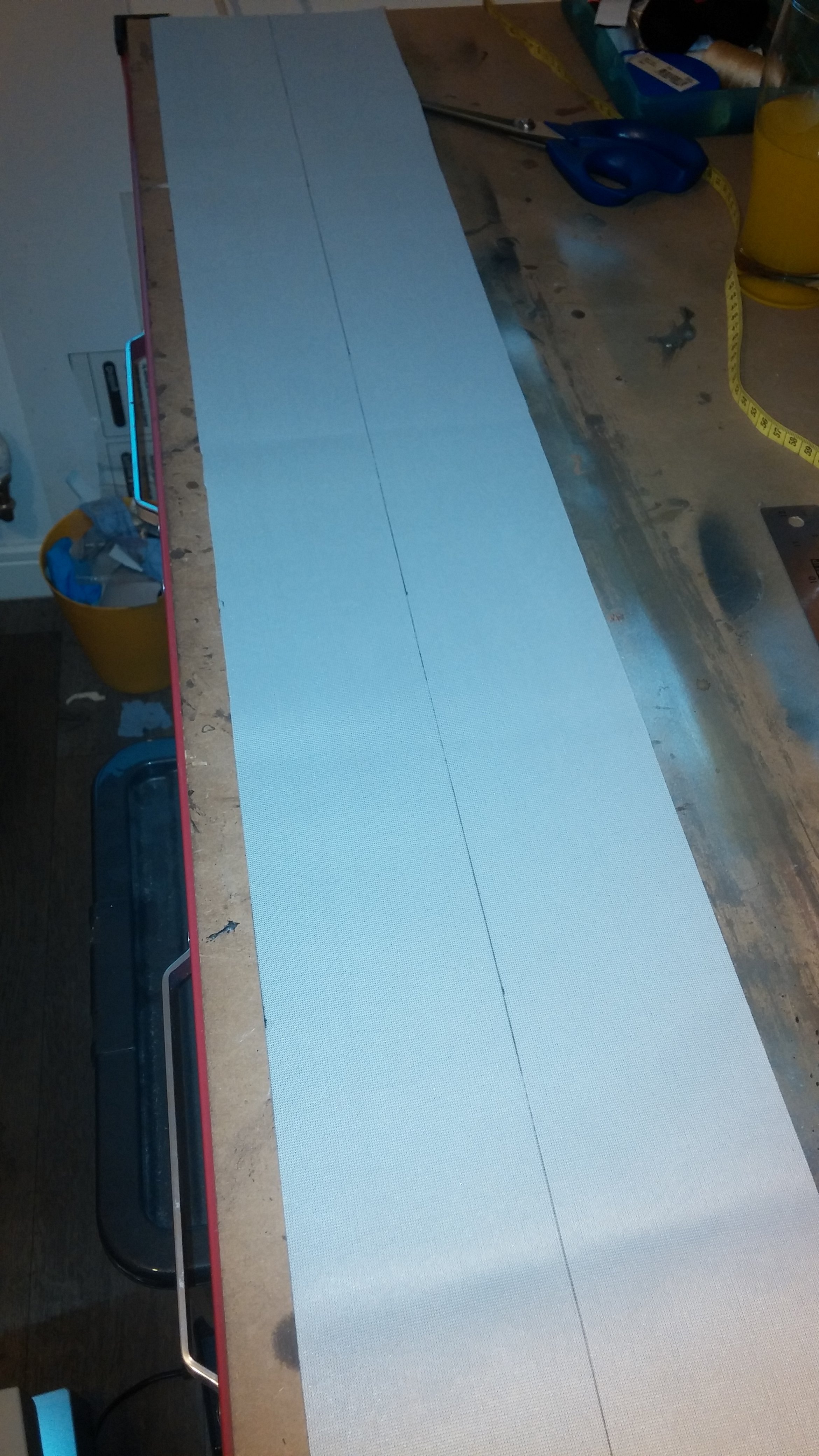

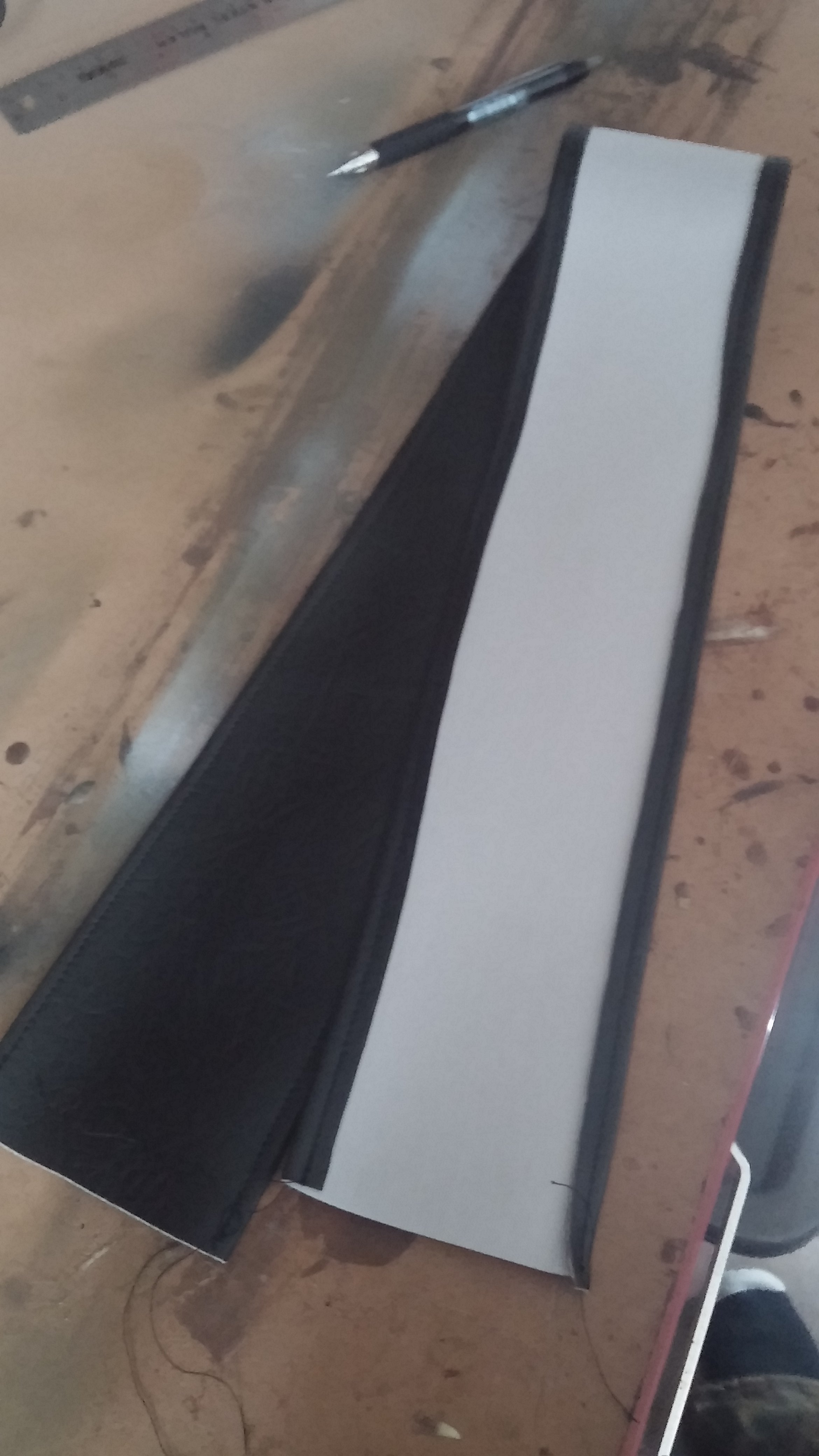

I started by using a piece of scrap muslin to work out the length and thickness of the main belt on a dummy of my body.
I then measured out onto a piece of black pleather the length and width I needed, and cut it out.

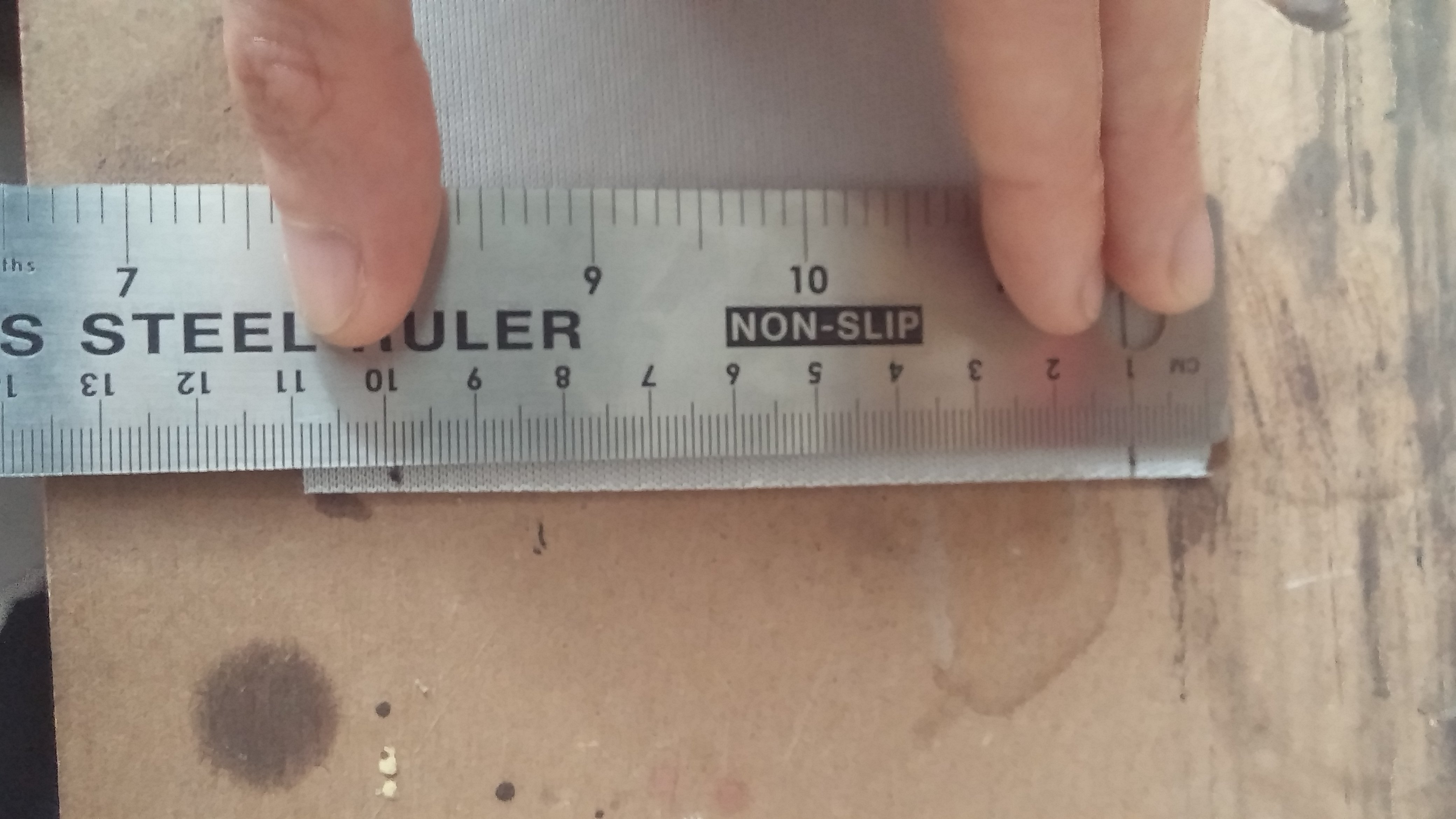

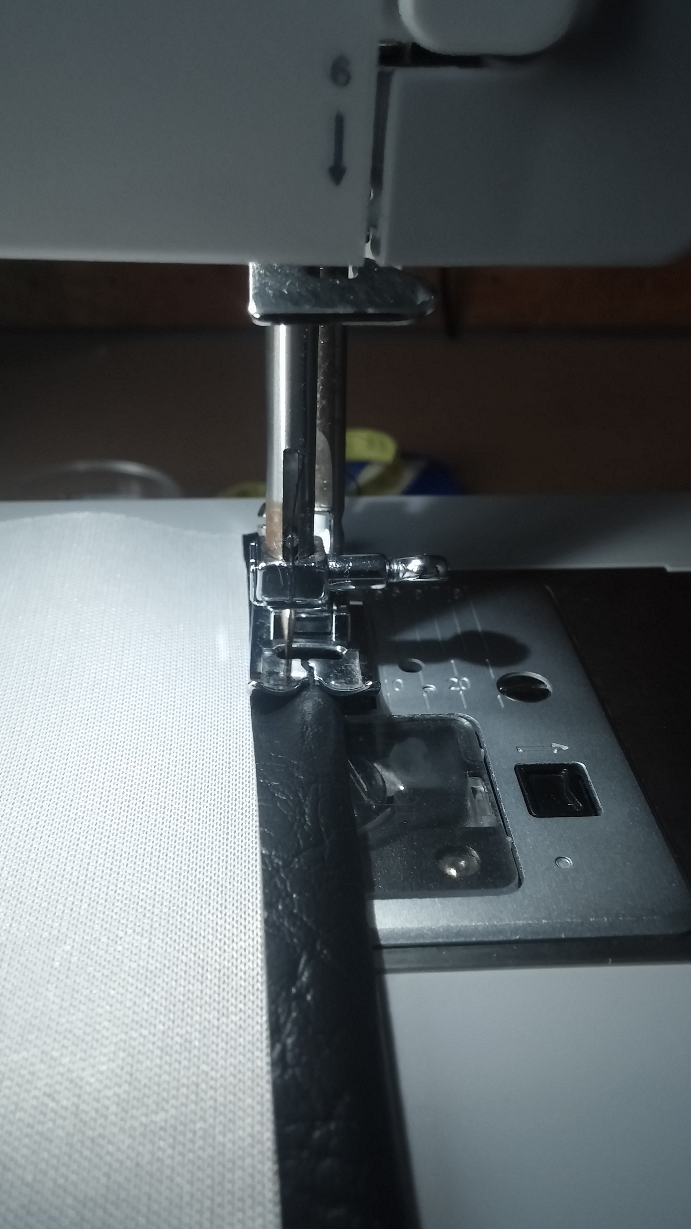

I measured a margin of 1cm length ways on both sides and machine sewed along them to create a nice seam on the edges.

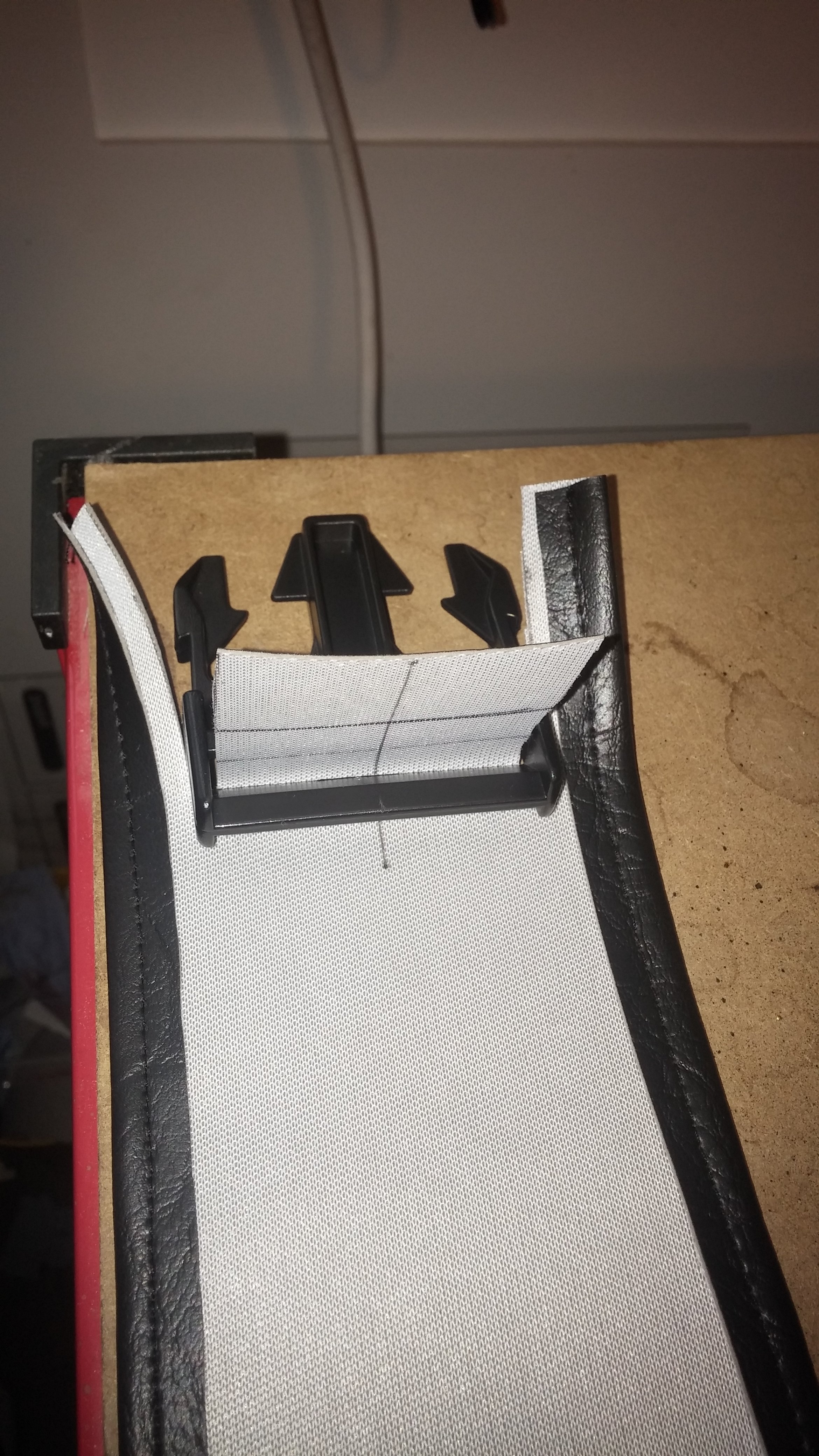

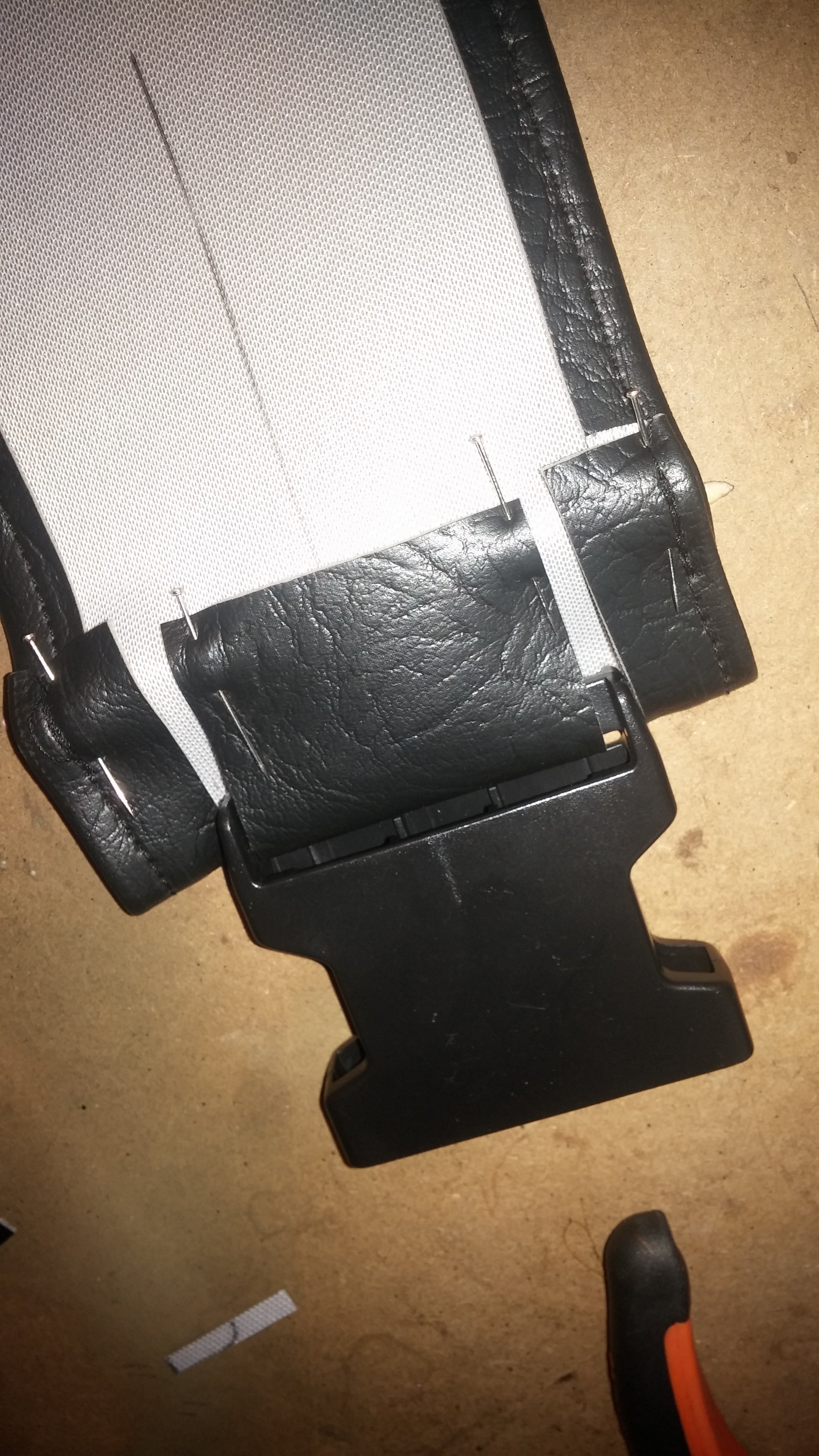

Using the largest side release buckle I had, I marked the center point on the belt and drew around the buckle giving myself plenty of space to fold over the pleather ready for stitching.

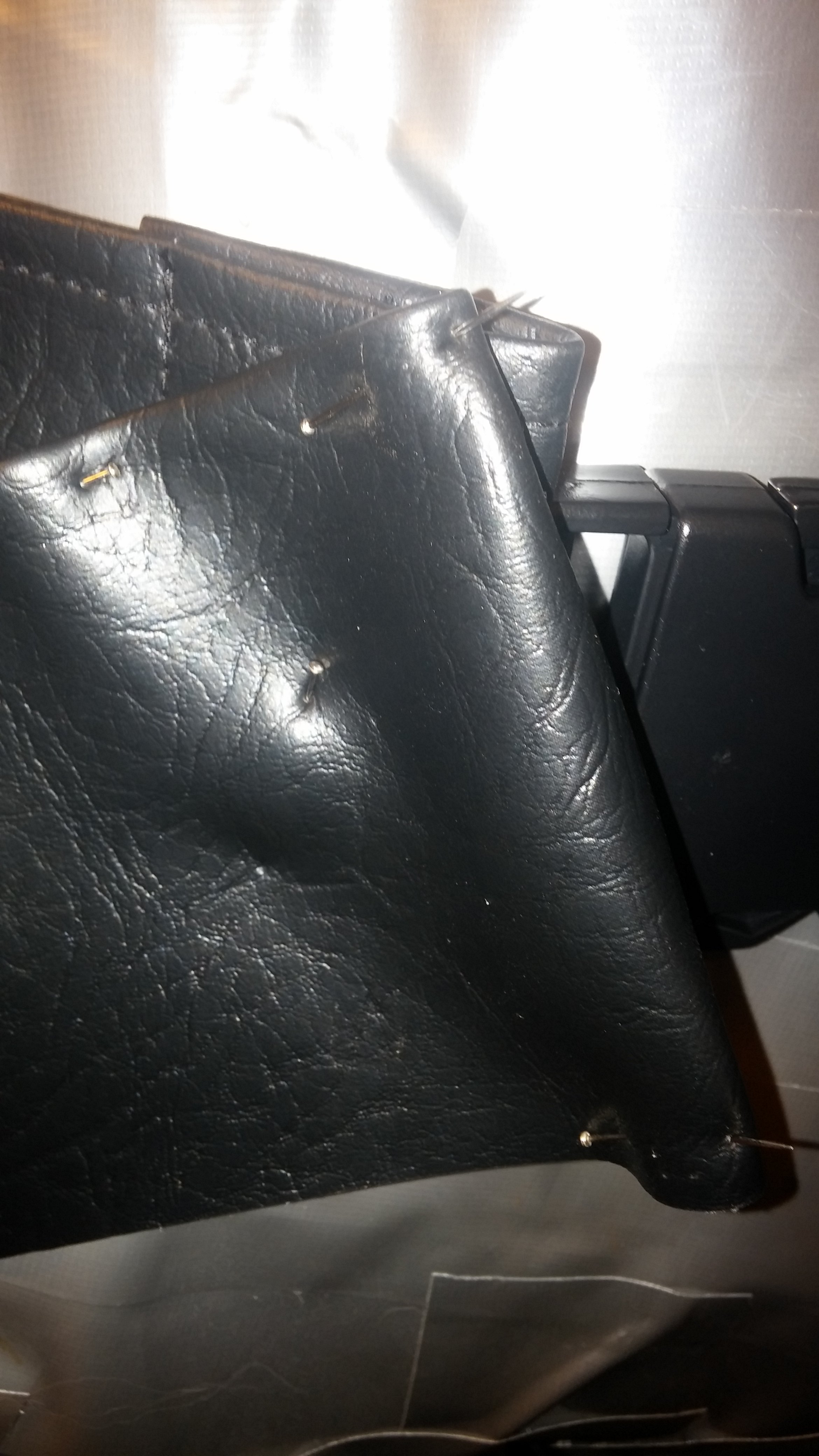

I cut slits to accommodate the buckle, then pinned and machined it into place.

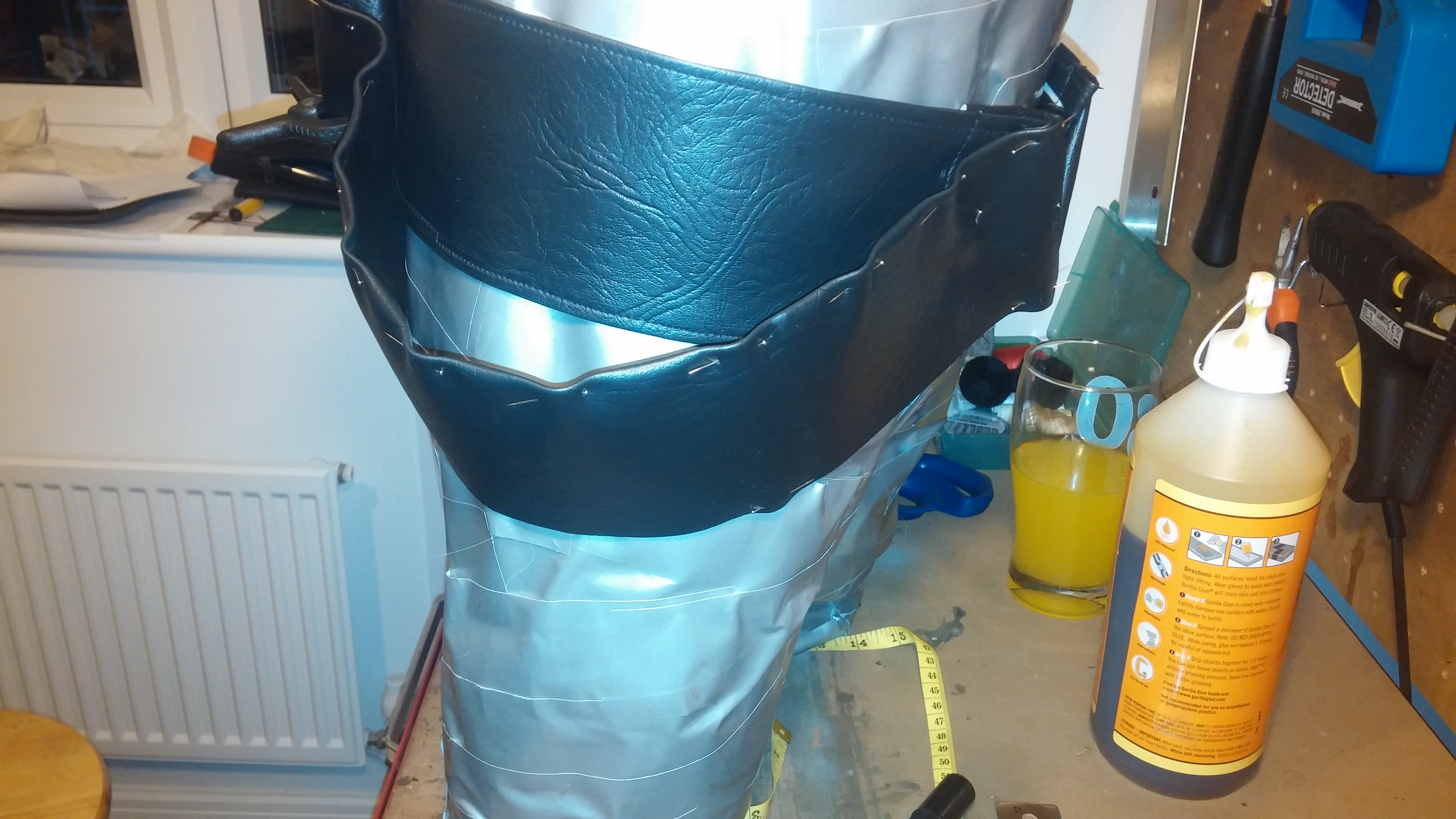

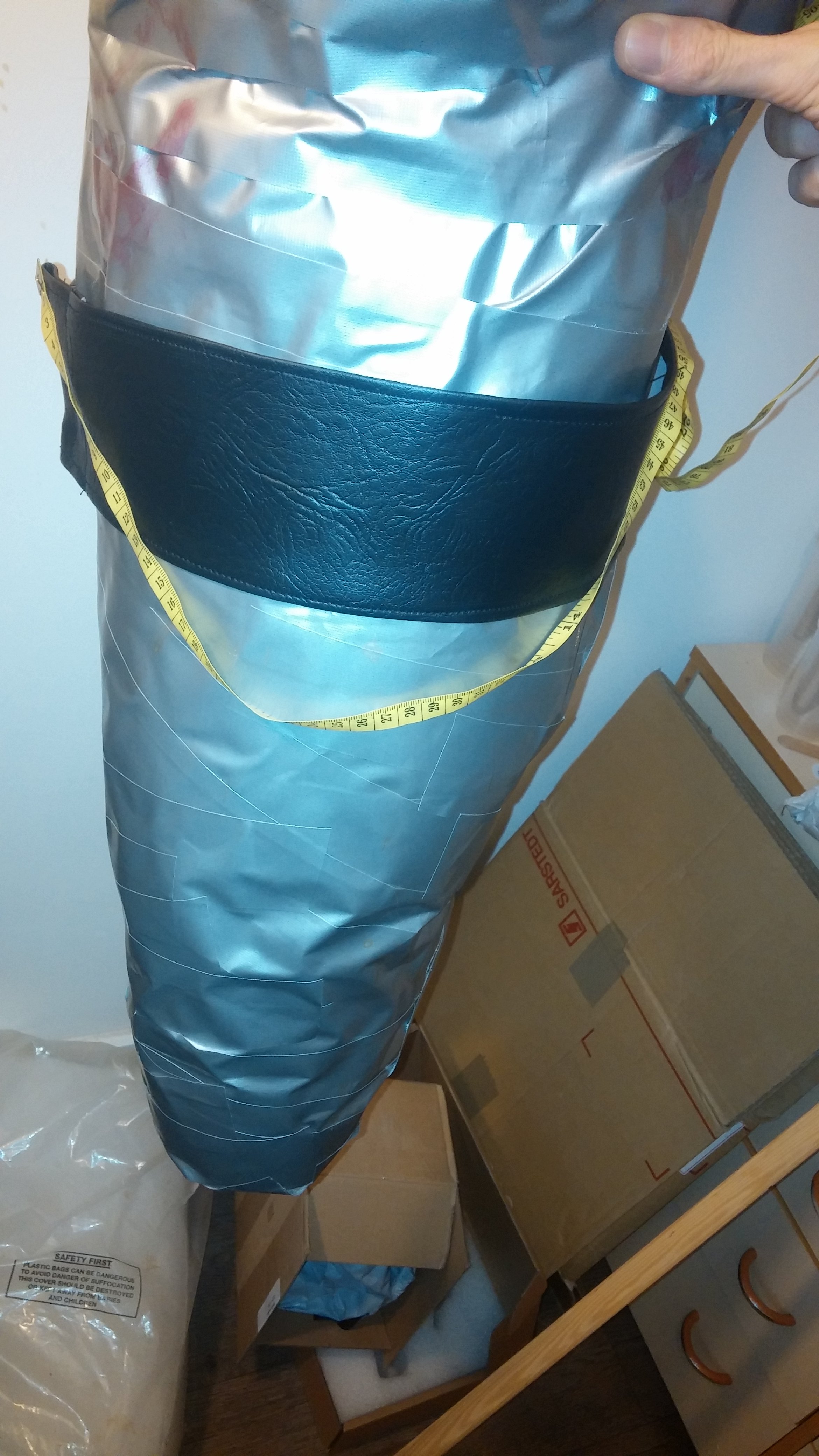

Wrapping the belt around myself I marked where the opposite end of the buckle needed to go and repeated the process to finish the main belt.
