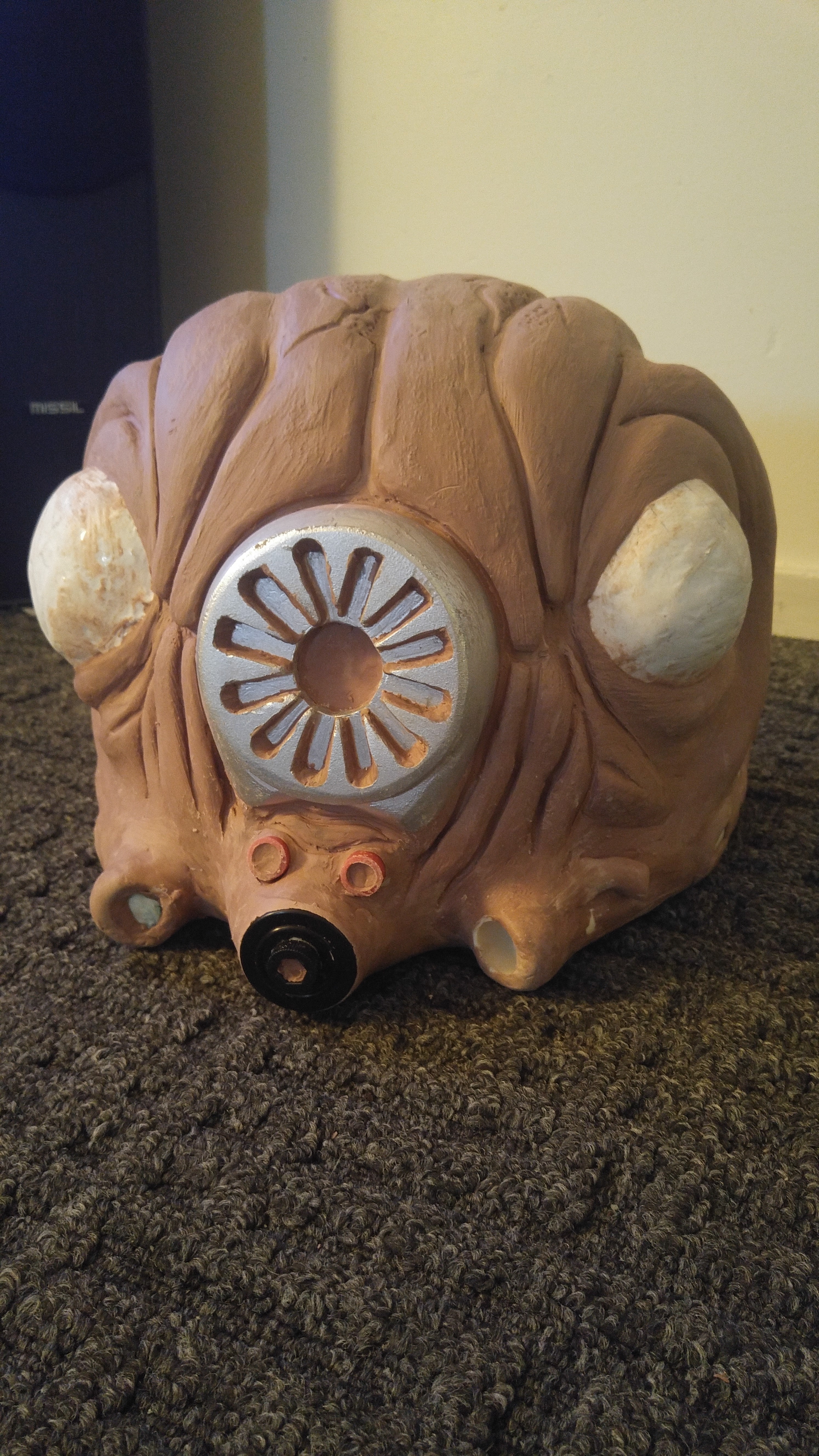

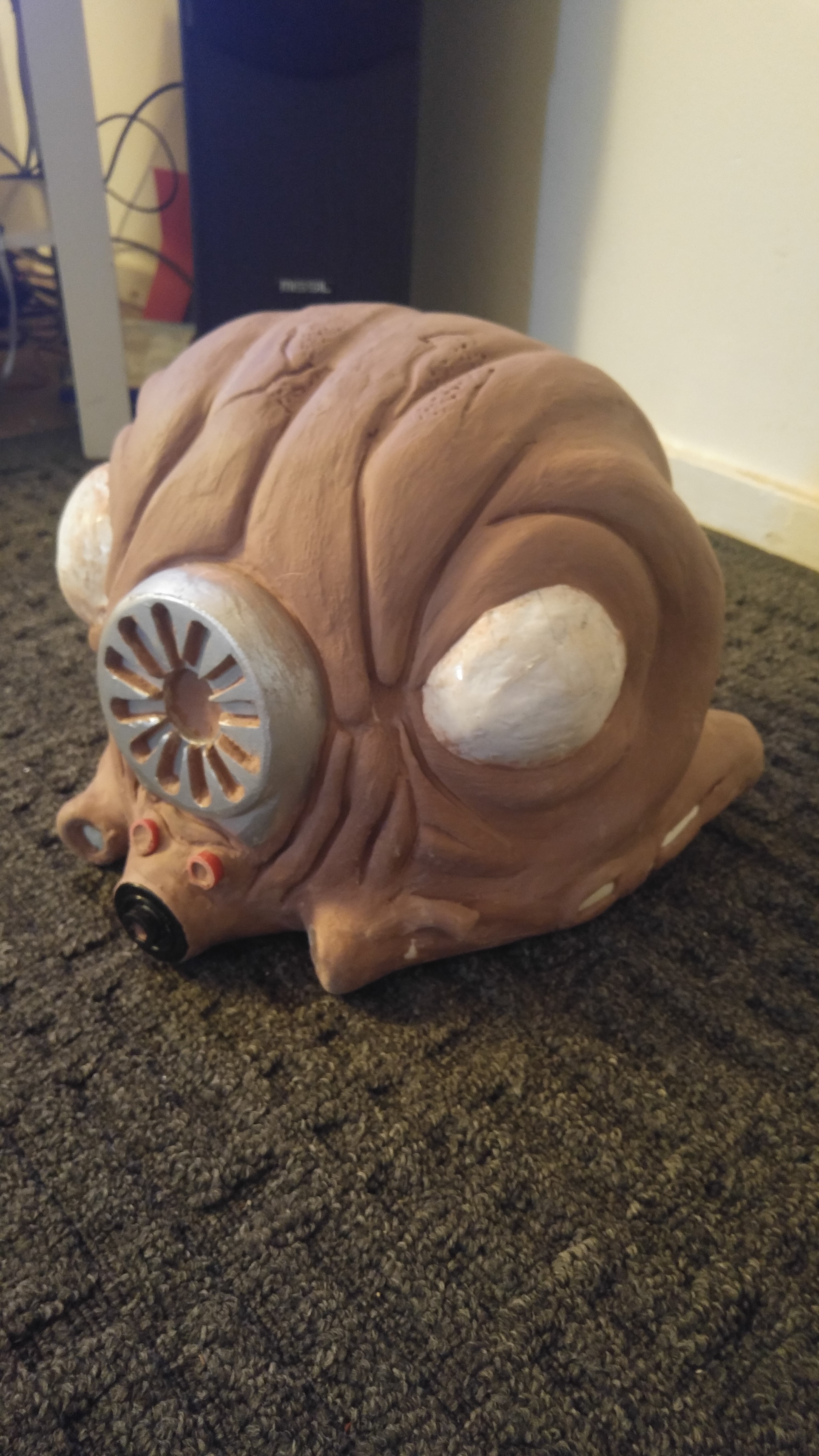

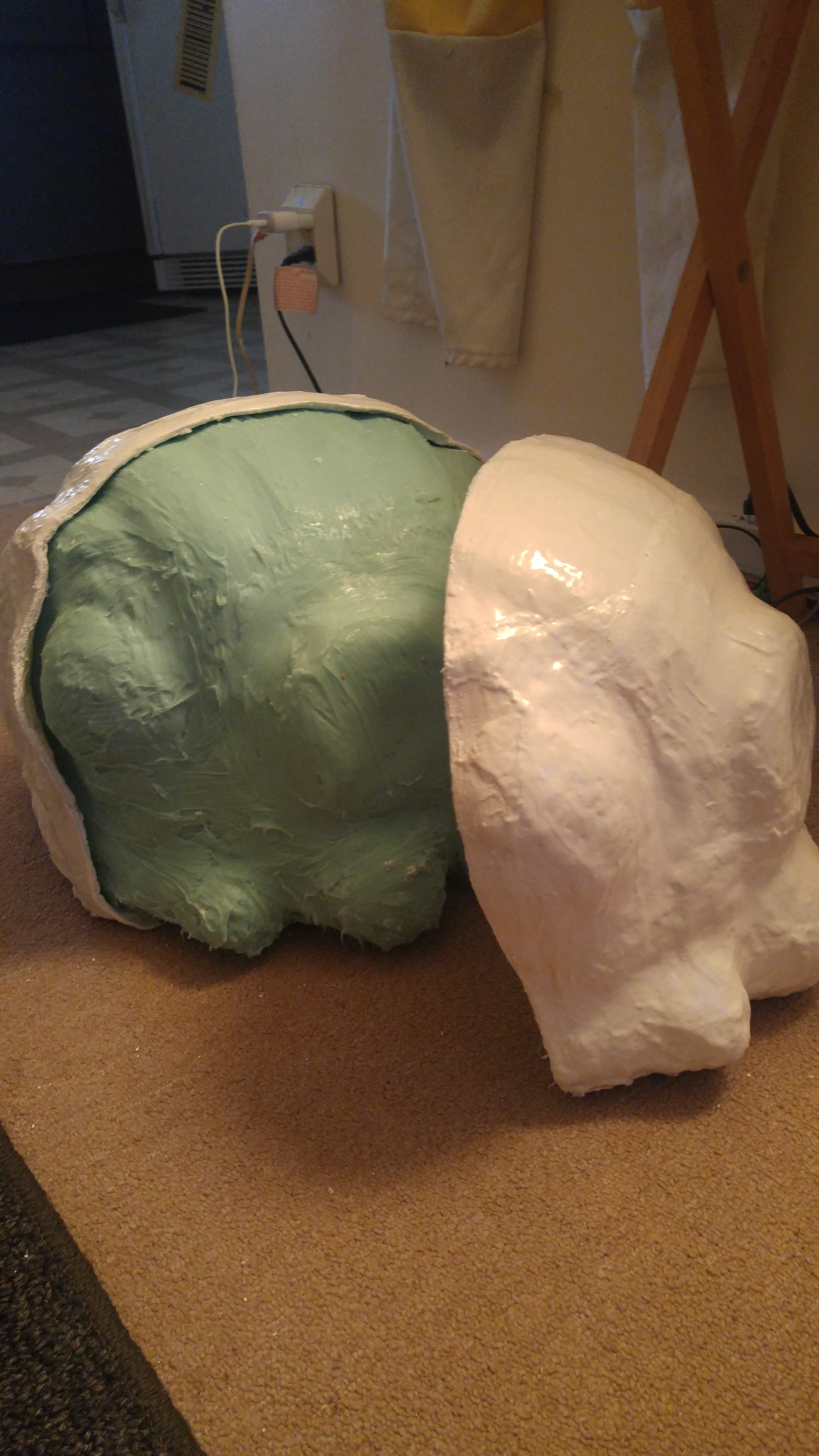

i decided on building a zuckuss mask and or helmet, i figured a helmet would give good air flow and ventilation. im pretty new to sculpting but really wanted to make a zuckuss. i bought 10lbs of monster clay and didnt have a head and neck bust...so i opted for a giant ballon and paper mache...then fiberglass to strengthen the thing to support the weight of the clay. i made the front grill then began to add clay and sculpt. long story short i have made a mold and mother mold and after spending all my money on materials i have to wait for the fun part slush casting. so heres where i am at. 20170503_163711.jpg 20170503_163503.jpg20170503_163346.jpg
Is this your first try at sculpting? If it is, damn, you're a natural! That looks great :thumbsup

Thank you... yea this is pretty much my first sculpt, i did a bossk mask before with help, but this i made alone and cant wait to slush cast with the resin and see the thing in plastic. I will cut the eyes out and add mesh screens and the hoses will be maybe garden hoses with shoe goo for a organic look then painted. I might make a few copies if i get any interest from my garrison or anyone interested.

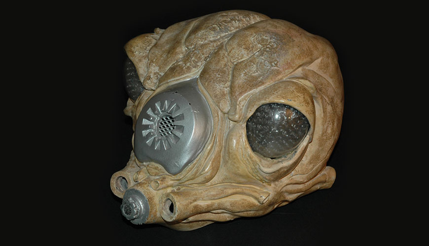

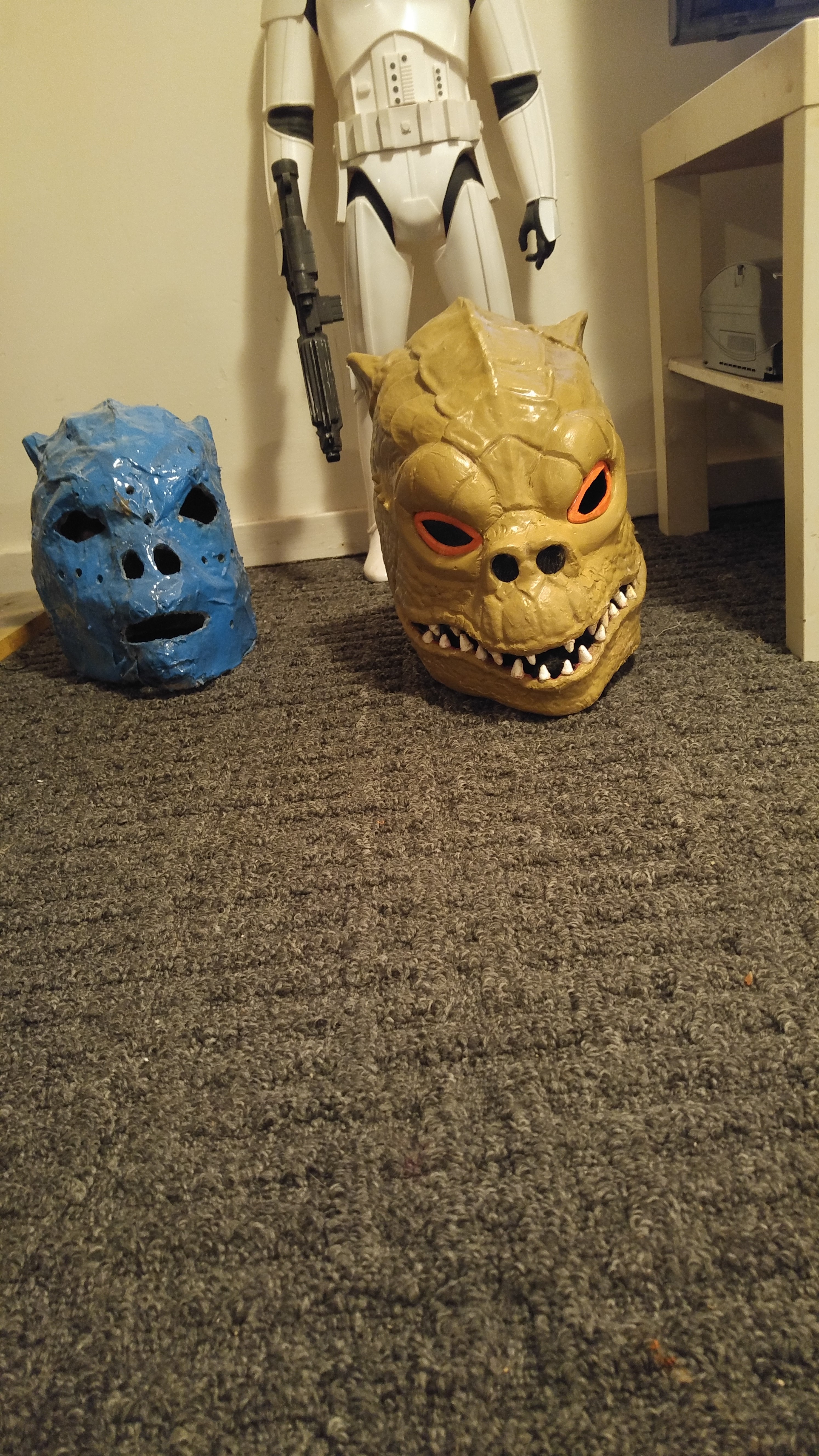

yea i found this picture of the original mask, if i can find some see through orbs or clear Christmas bulbs large enough i will add the bubble wrap inside. its a sacrifice of vision for accuracy. I had this riddle with my Bossk mask before, the lenses i had fogged up so bad, (couldn't see a foot ahead of me) then i decided on screens and it was perfect vision with a cool breeze flowing threw.zuckuss real mask.jpgmy bossk mask.jpg

I ripped the mold when i pulled it off but managed to get the one copy out of it, the bossk is actually a helmet not latex mask. You can add fans and edit it with bondo like change eye shape etc... I made the zuckuss mask from smoothcast aswell. If your looking for a bossk mask i seen a nice one on the dented helmet recently. I may make another in time tho.

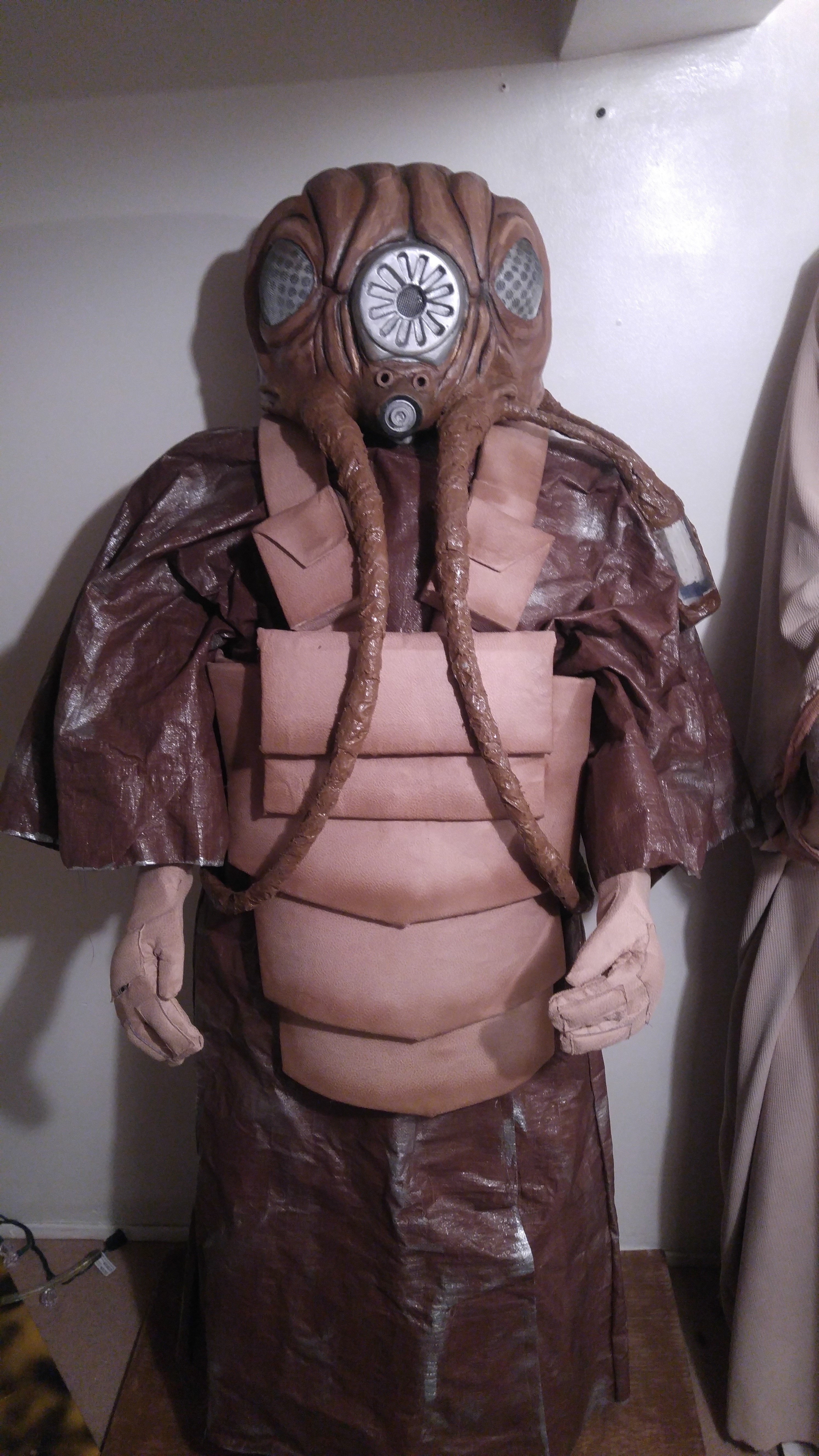

added some hoses some helmet padding made a kimono from tarp (thanks iggy) made the belly plates from foam and pleather and put them on a mannequin. still need to do a bit more things, but its getting there.
