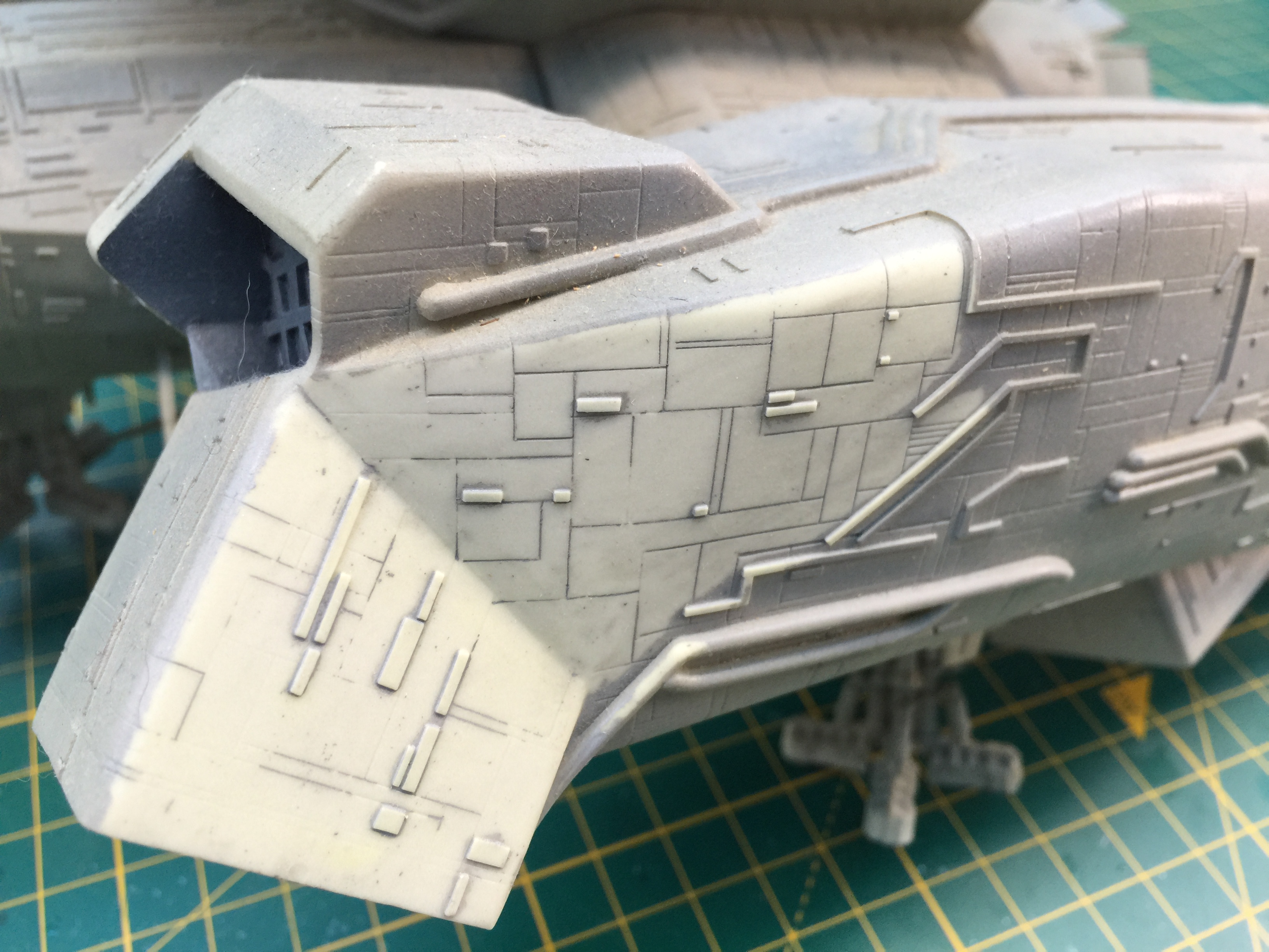

Just acquired a built, badly painted Nostromo model and I need to remove the paint, fill some seams and start again.
I started removing the paint with X20A thinner but then it occurred I might be damaging the soft vinyl underneath.
Any thoughts? Anyone done this before? Also would welcome any source for colors once I start repainting.

OMG! like a bad penny this kit keeps popping up!
I was asked when it came out to build one for the LHS and finally gave up!
As for paint stripping, I use easy off oven cleaner for everything and have not yet had a problem!.......Back in the day these kits/material was popular I stripped paint off Iron man and the Creature from the black lagoon and it worked pretty good and didn't mess up the vinyl.

It's worse than I thought. The black paint used for the engine inlets looks like some kind of lacquer that just smears when I try to use thinner on it. Also, there isn't a single surface made from the soft vinyl that isn't concave or convex, bowed, misshapen or with really bad seams. It's a shame cos it could've been a really good model. Most of the parts are glued with super glue that is so brittle that it just comes away, so I can take most of the thing apart. So now I'm thinking to take it all apart and try and correct some of the mis-shaped surfaces.
I'd heard of Easy Off before but I don't think it's available in the UK. I'll have a look for an equivalent. I wonder if any small model companies are doing low volume alternatives to this model, made from a decent material?

"Easy Off" is an aerosol (spray can) oven cleaner. You can probably find something like it over there. I'll warn you that products like that are extremely caustic, and can give you chemical burns and damage wood & other materials, so wear gloves, be careful and (ideally) use it outside.
If you do feel like rebuilding it, you may be able to build some internal 'bulkheads' to force the warped parts back into shape. You can soften the vinyl somewhat with warm water, that may help you get it apart and un-warp it.

Thanks Mike. I hadn't thought of warm water to make the vinyl more flexible. Excellent idea.
I've managed to get the two main engine pods off with very little fuss. I now need to get inside these pieces to reinforce the misshapen panels.
I recall using Dettol, which is a disinfectant, to remove paint on a styrene kit a while ago. The smell was terrible but it did the job. Vinyl is not something I've had much experience with.

Vinyl is pretty forgiving, you can pretty much throw anything at it. The only problems I've experienced are when leaving it soaking for a day plus in some strong solvents which tend to make it go a bit soft, but it usually "dries out" again fine. Never had it actually dissolve.
Thanks Antsnest, I have removed the vector plates around the two main engines. I may try one of those in Dettol to see how it copes.

If you want to correct the shapes that are deformed, just use a hairdryer! Heat up the part, and push it back to shape, then run it under cold water until it firms up. You may have to repeat it a few times but this method works great!
I have one i'm repainting atm,depending on what it was originally painted,try methylated spirits(ethanol) for acrylic paints, if enamels, use the oven cleaner, the shape can be kept true if you use balsa wood blocks to fill the interior of the parts.
