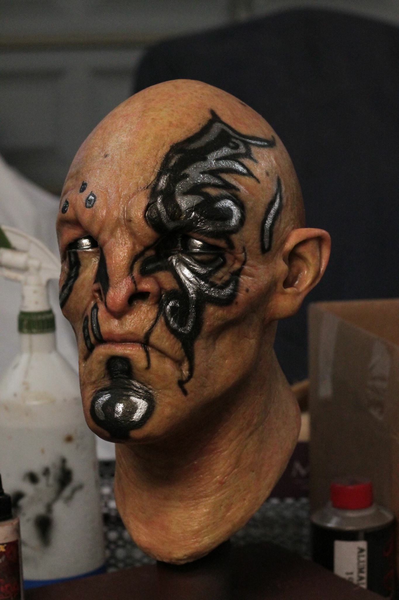

Hey folks. Painted this up recently and thought I'd make a thread since not a whole lot is happening in this area of the forum.
It is a sculpt by Francisco Charlie Hernandez and painted by myself. This was my first time doing fleshtones in a little while. I have been stuck doing resin helmets and props for so long that I needed a break, so I just kind of painted it off the dome between projects.
They are a bit out of order but hopefully you can piece it together. I started with the raw latex, basing it in prosaide with a drop of green mixed in. I then started airbrushing reds, purples, and browns. From there, I did a few passes of spatter and mottling, veining, freckling, and then I added the stupid tattoos. I had to then go over and give the illusion that the ink was under the skin. I'm not happy with the eyes, but I don't know what I want to change them to. I am also kind of so-so on the tattoo design and execution. I think I would have preferred to leave it flesh tone and incorporate a creature pattern into the back heading towards the face. Who knows, I may still repaint it yet.
If anyone has had any questions about the how's or why's feel free to ask. Any critiques are always welcome too.

It was based with prosaide and then the rest was Tim Gore's Bloodline acrylics. A little airbrushing for the reds, purples, blues, and greens, and then super thinned out with alcohol and flicked on with a tooth brush. The black was FW acrylic inks, and the silver was Alumaluster. :)

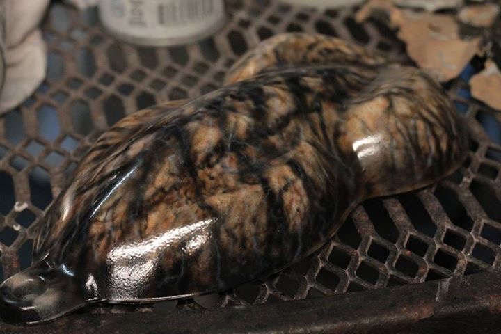

Today was mostly a little bit of practice on a speed shape.. which if you don't have any, I absolutely recommend! The curves are nice to have instead of painting a flat surface, and they're dirt cheap.. Inspired by yesterday's Alien Day!

Thank you, I appreciate the kind words. To be honest, I don't think I've got the sheen down completely myself. My stuff does tend towards the shiny side.
What I'll do is seal the whole piece with Flex Gloss and then while it's still wet, I will lightly mist on Liquitex Matte Medium in select areas. I basically try to avoid the brow, nose, lips, and eyes. The rest gets a light misting with the matte medium and it dries to a more satin finish. It takes a little practice to get the timing and amount down, but I really hope this helps!

In terms of the eyes (not that you need any suggestions from me), maybe a dark wash on the lower lid would eliminate the hard transition and tie it in. As a static figure painter, a gloss coat on eyes goes a long way to differentiate surfaces.

Oh and as for the eyes on this one, I agree with the above about a black (or maybe red-brown) wash on the lower lids. I'd go a step further and say what about adding a touch of translucent pearl metallic electric blue or purple around the sides of each eye (where you'd have pink haze or veining on a human eye) to give them a touch more interest? May look cool like when metals get tarnished around an engine and get that blue/purple tone. Then some high gloss liquitex in 3-4 layers would give you a nice finish. Just what came to mine looking at him.

I am always open to suggestions and critiques. I think you're absolutely right. Once I've got the eyeballs sorted I'll definitely give the lower lids a wash.
I usually do epoxy the eyes and sometimes the lips, but where I was unsure of the design I wanted to push it off until I was happy.
As for your prosaide question, to be perfectly honest I'm not sure! I have masks that are 4-5 years old that were painted with Prosaide and they're going strong. I'm sure the bond is a little less vigorous than RCP, but hopefully it'll last as long or longer. Never used the old 355.

That does sound like an absolutely fantastic idea for the eyes. I was also thinking of doing some veining and layering on those side areas of the eyeballs with whites and yellows, and then doing some metallic or candy tones.
I usually use Epoxy. Do you prefer the Liquitex method?
Sounds like a neat approach. I tend to prefer anything over epoxy. It does look good but always seems to yellow over time, especially in prolonged contact with aging latex. The acrylic high gloss is great, but you have to lay on a few good layers to get a really good "eye" level shine.
