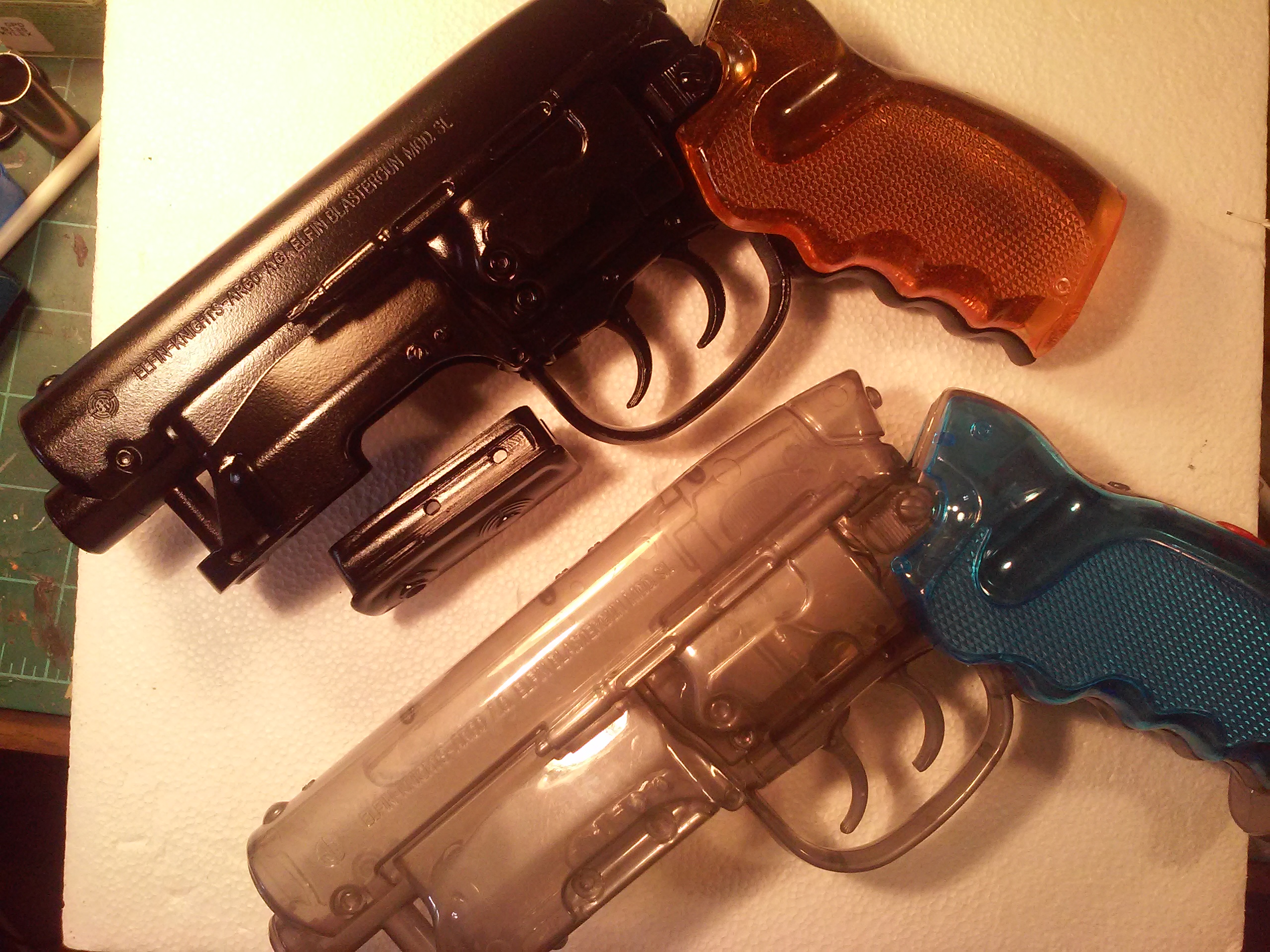

    I carefully cut out the magazine (which was really tricky) with Tamiya .01mm craft saws. Mutilated one in the process! Then I built up the walls and created a 'roof' with styrene, effectively making a sealed compartment for the battery/LED housing. Eventually, I'll fill the body of the gun with resin to give it some weight, so now the resin won't come pouring out of that gaping hole!
    Click image for larger version.

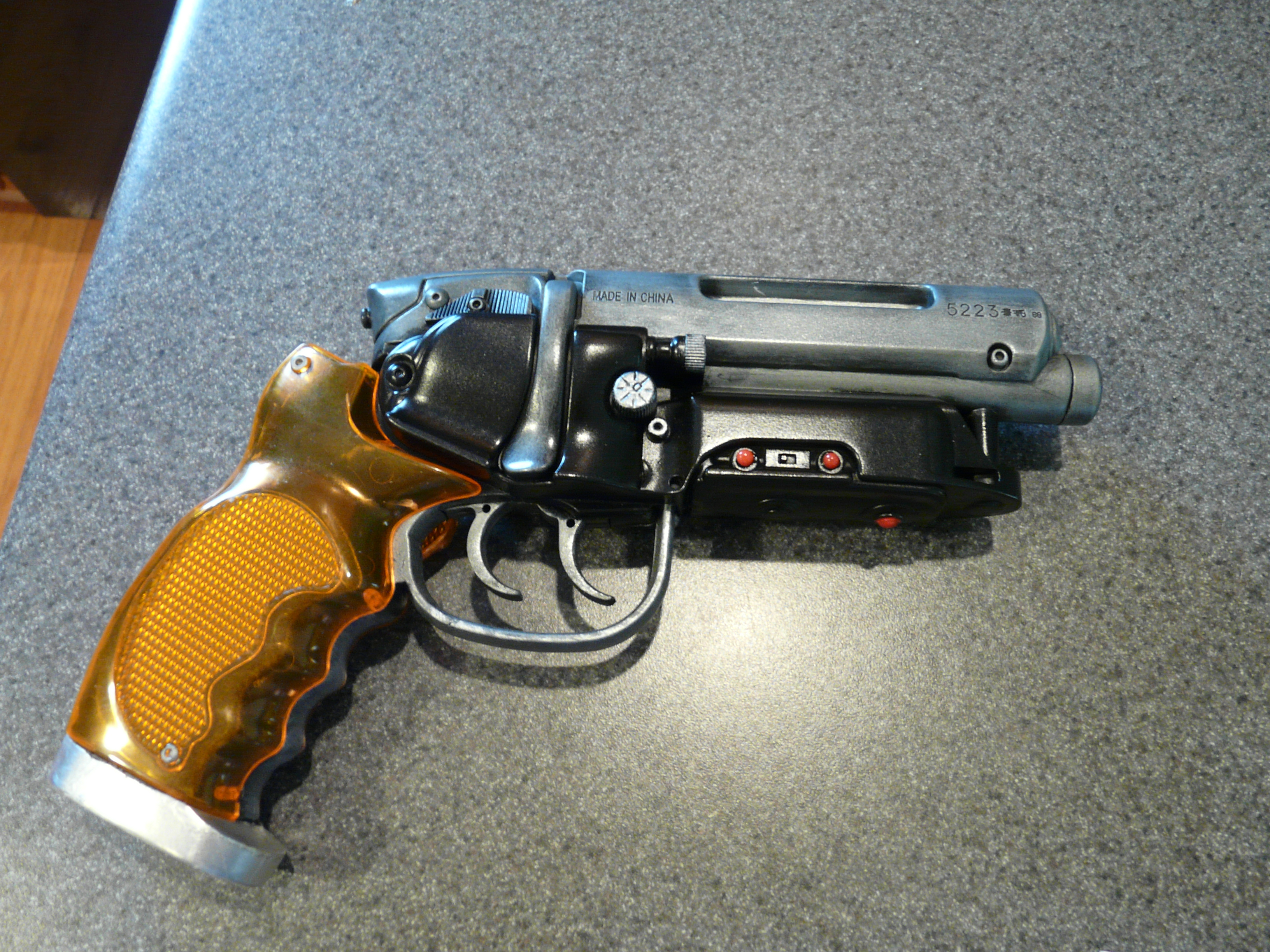

  17. Member Since
    Dec 2016
    Messages
    29
    2 Weeks Ago  Jan 9, 2018, 12:01 PM - Re: Cheap PKD (Water Gun) #1142
    propmainiac said: View Post
    The chrome looks absolutely awesome...you used spaz sticks? I'm not familiar with that. I too have the blue grip version. I am looking to make it look like a chrome or aluminum version with blue lights.
    If you are speaking about mine then yes its Spaz Stix. I am okay with how it came out. It makes a good gift. It really needed some primer and sanding to get it glass smooth for Spaz Stix but it didn't come out too bad. I am finding Spaz Stix doesn't work without that glass smooth surface. Gotta get a new airbrush to finish the others.

  19. nbennie's Avatar
    Member Since
    Jul 2012
    From
    South Bend, IN
    Messages
    13
    1 Week Ago  Jan 9, 2018, 7:48 PM - Re: Cheap PKD (Water Gun) #1144
    Here are some pics from my second gun. It was originally the silver and blue. I opted to go for a solid Blue as opposed to the original translucent. Iím debating that color, and also whether to weather it or not. Suggestions are welcome as always.
