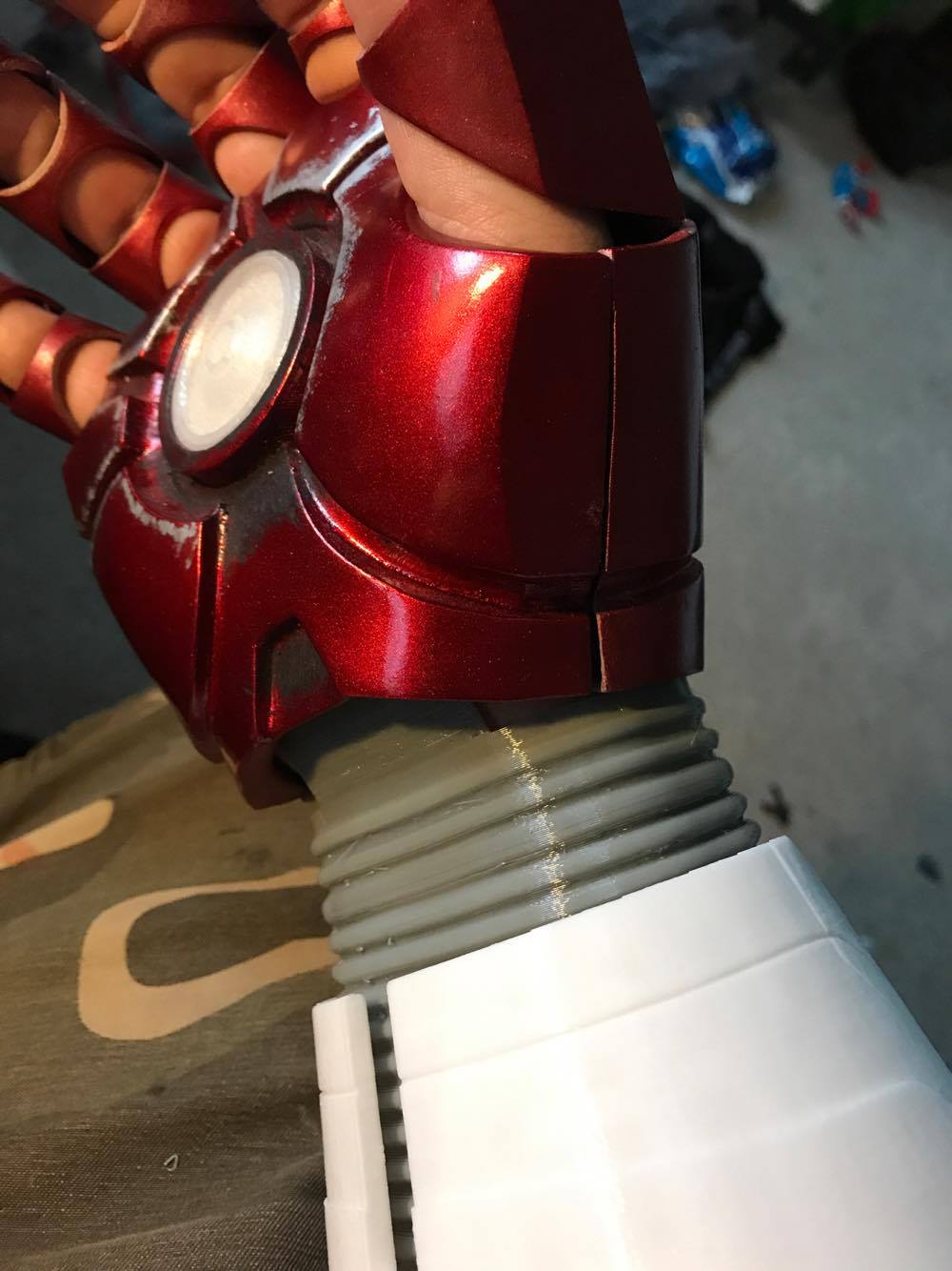

I've got the forearm mostly done with programming except for a few errors concerning the bluetooth serial communications. It shouldn't take much more longer to those sorted out though. I've also managed to created the ribbed portion that goes on the wrist between the glove and forearm. I'm currently waiting on some red ninjaflex filament to print the final version. Next up is the ribbed finger pieces and then painting the forearm. I've got the helmet painted up except for a re-paint on the main portion where it fell off from drying. I should have final painted pics by the end of the weekend (fingers crossed).
Here's the pics for the test ribbed wrist cuff:

Big fan of your hinge setup and the forearm ribs. Is that based off the rib file you worked with before? I printed that one in ninjaflex in red, but it was a translucent red. I couldnt get it to print cleanly, and support material in ninjafex is murder to clean up!
Thanks. It's similar to the one I posted before but I redesigned it for the most part. This cuff is a lot thinner and will for the most part cover your entire wrist and about 1/4 of your lower palm. I did the lower palm portion for when you put your hand to fire the replusor (there was gap between the glove and wrist cuff but that's covered now). The new file I made has a then slit in the top to put your wrist in and will be covered by the handplate so it will look like one solid piece. Also I managed to print it without any supports so it came out clean. The hinge setup is the TheRealTonyStark's hinge setup that I remodeled to be able to put in the Mark 42.
