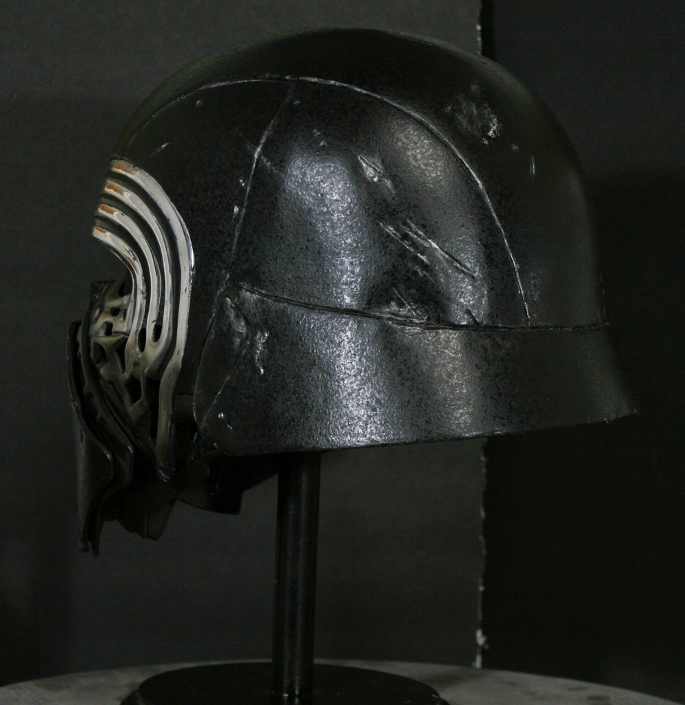

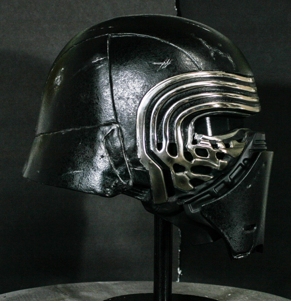

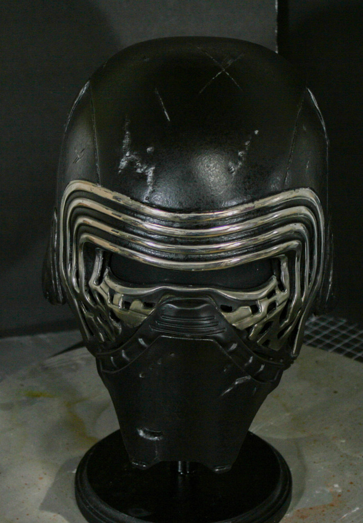

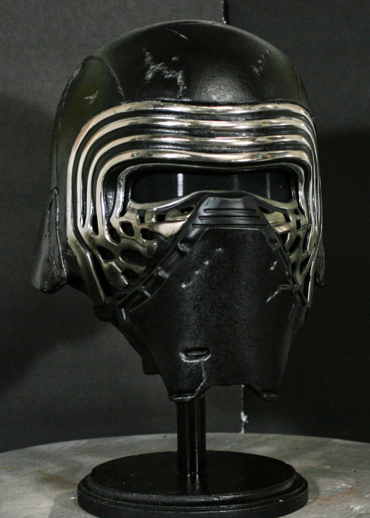

    Mar 26, 2017, 2:46 AM - YET ANOTHER Kylo Ren BS mod #1
    At the risk of redundancy, here is my Black Series/Disney mod. No progress pics since I'm lazy.
    Nothing really new here, just sharing the end result.

    Mar 31, 2017, 11:54 PM - Re: YET ANOTHER Kylo Ren BS mod #6
    ForceSensitvAL said: View Post
    Seems like more and more people are getting that same textured look down. From filing a fire brick between layers of black spray paint, to soaking cans in icy water, to splattering on resin, etc. Any tips about how you did it would be great.
    Al,
    I sanded as much of the helmet down as I could to get rid of the texture, then I just started adding Evercoat Polyester Glazing Putty on it. I built up a layer just thick enough to cover the surface of the helmet. I originally didn't intend on doing this, but I just couldn't get the texture smooth enough to my liking. So basically after all was said and done the majority of the helmet (not the faceplate) had a layer of Evercoat. It sands easily and was easy to work with. I then filled in any irregularities with Bondo spot putty (the red stuff). I went a little overboard but it got me the look I was going for.
    Then I primed with filler primer, sanded, and hit any irregularities with more spot putty, then reprimed and resanded. For painting, I used Rustoleum Painter's Touch Semi-gloss, Satin, and Flat (all black). I started off with a base coat of flat, then I built up several layers using the spatter technique. I did not chill the cans but that would have worked just fine as well. Basically I held the button down just enough for the paint to spatter out. Less pressure will give you bigger spatters and more pressure will give you smaller spatters. I started with Semi gloss and did bigger spatters, let it dry for 20 min or so, then went to the satin. Then to the flat. Repeated with the semi gloss doing smaller spatters, then satin, then flat. Finally I did one last coat with small spatters using just the satin and flat. Turned out pretty well. Did not use a clear coat.
    Of course after letting it dry/cure for a couple of days I did weathering, using a combination of Rub n Buff, drybrushing Testor's metalizer, and airbrushing.
    Hope this helps and if you need any clarification on anything let me know.
