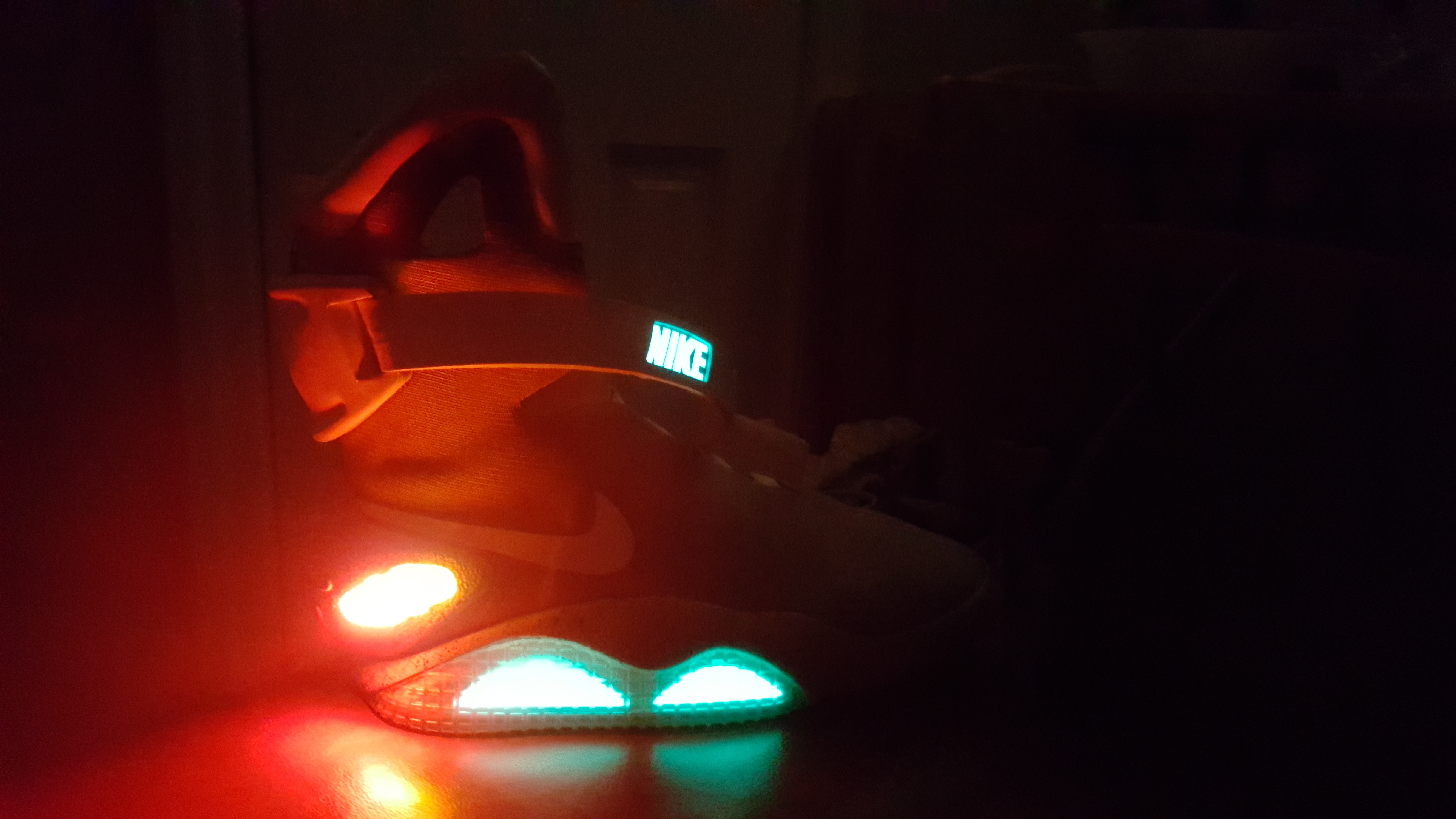

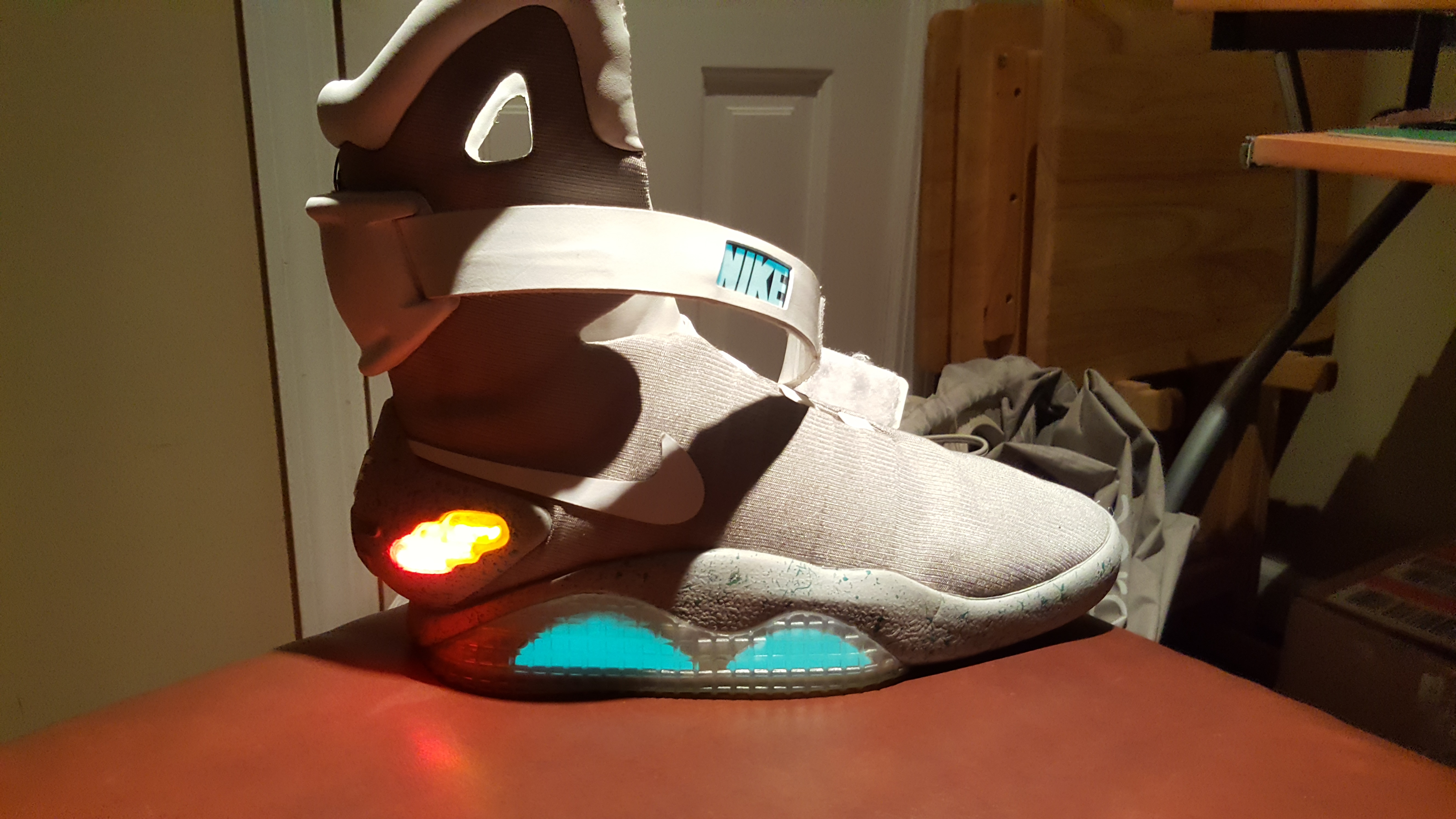

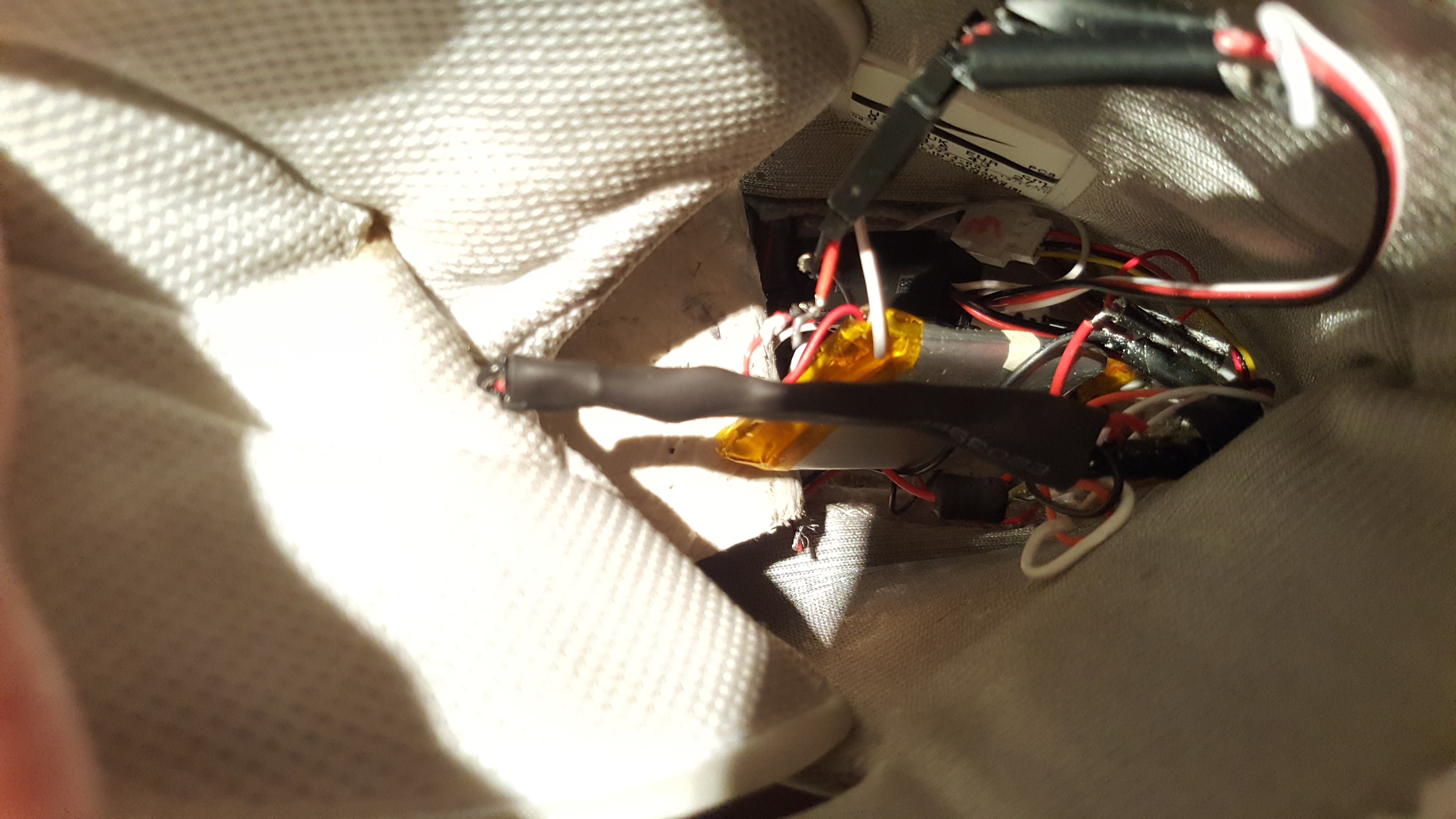

I was able to retrofit new electronics into the v3s as mine were completely shot. I bought a pair of new precut v3 Els from Ebay and an digital inverter from back light 4u as recommended by @Catfish45. Originally I was disappointed as when I tested this inverter on my v2 els they were dim and green. But it had turned out the v3 els are optimized for digital inverters and they worked great. I used the existing Nike Part EL and Leds. The Nike EL I connected to the now unused battery wire so it came into the sole and connected it along with the sole EL to the inverter. The LEDs come out as red yellow and black wire. Red and yellow go to the positive terminal and black to negative. They run off 3.7v the same voltage as the digital inverter. Then I just placed a small switch in between the battery and it was all good. The only problem is since I am such a novice at soldering I left my self a lot of slack in the wire as seen in the picture so I could solder outside of the shoe. I am now learning I am gonna have to redo that as although the inverter is super small and able to be hidden the wire takes up a ton of space.
This cost like 75 bucks. The inverters were 30 with shipping from Germany, the Els 25 and the Batteries were 18 for 4 with a charger. Only a little cheaper than what davids site wanted but this will be able to be repaired more easily and the Els are laminated and said to be much more durable.

Those look great, glad those inverters worked out. How does the color of the El look compared to the V3s?

Great job! I will try to do the same as I'm expecting my V3s (defective lights) soon. I have a light kit from airair but I think I will go with your design and order those parts. Novice also so going to test out EL's and lights first.

Glad you were able to repair them. I've not bothered with my wear pair. And with wiring, in general it's always good to have a little slack somewhere, especially in things that move (if you'll be wearing them, for example) - if there's a bit of slack in the cables rather than 'just fitting' it's much less likely to pull the soldering out or something like that. :)
