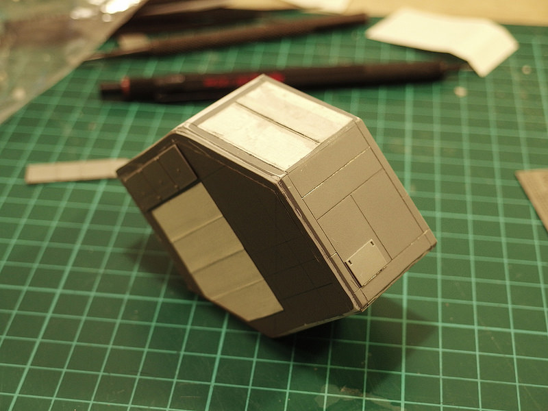

I spent the majority of the day building the habitation module master.
This took way longer than expected, the geometry is bizarre; it may have been easier to machine this from a block of acetal or something rather than building it up from sheet plastic....ah well, hindsight is a wonderful thing.
Not to mention all the beautiful square edges the piece had needed to be machined away as the ship has external chamfers on all the edges anyway. Sigh!
