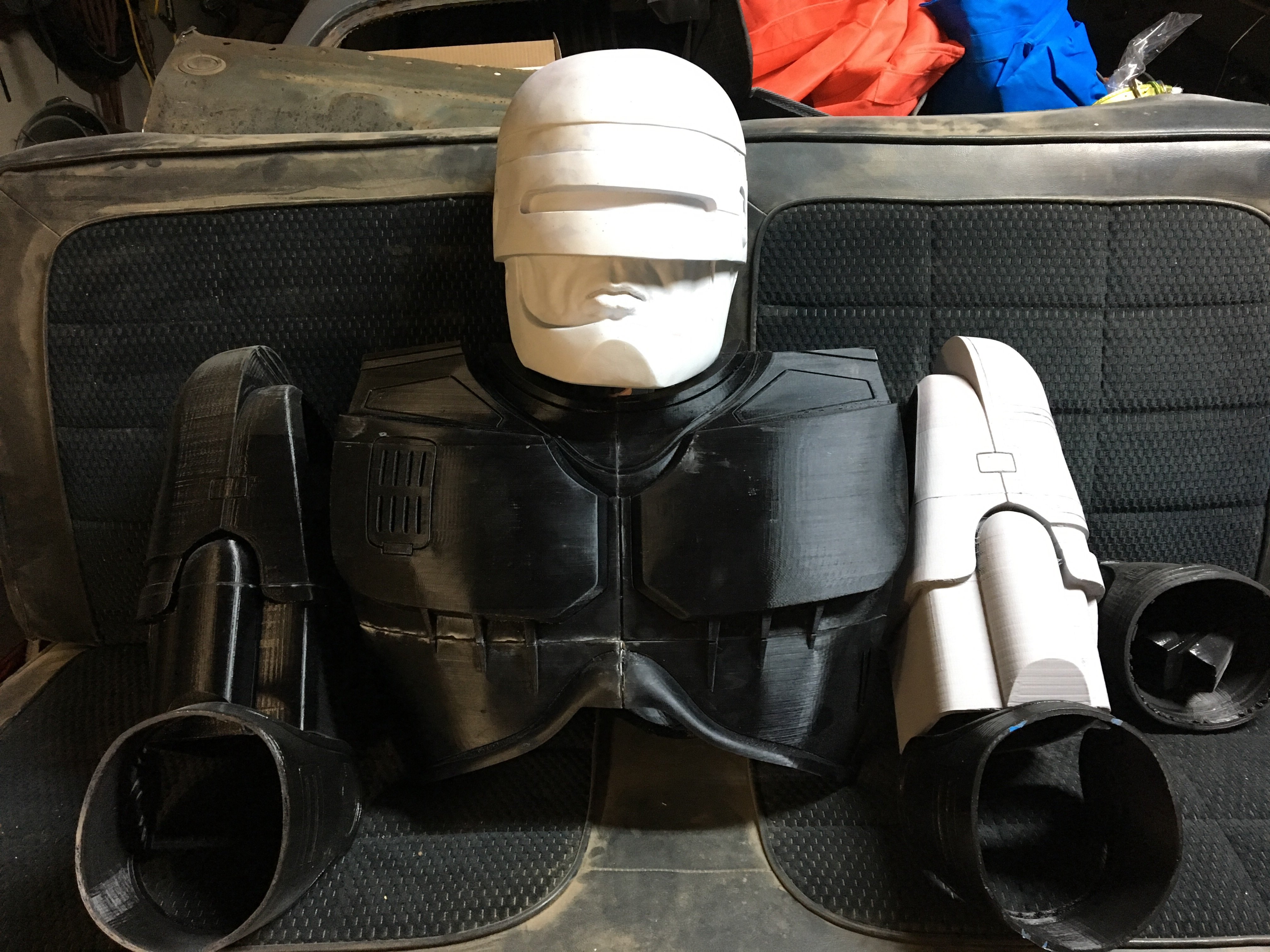

image.jpgJust a progress shot all laid out
part 1 of left shin completed. onto the crown (top) of left shin. part 2. part three is from middle to ankle. once thats done Left thigh. pics to come.

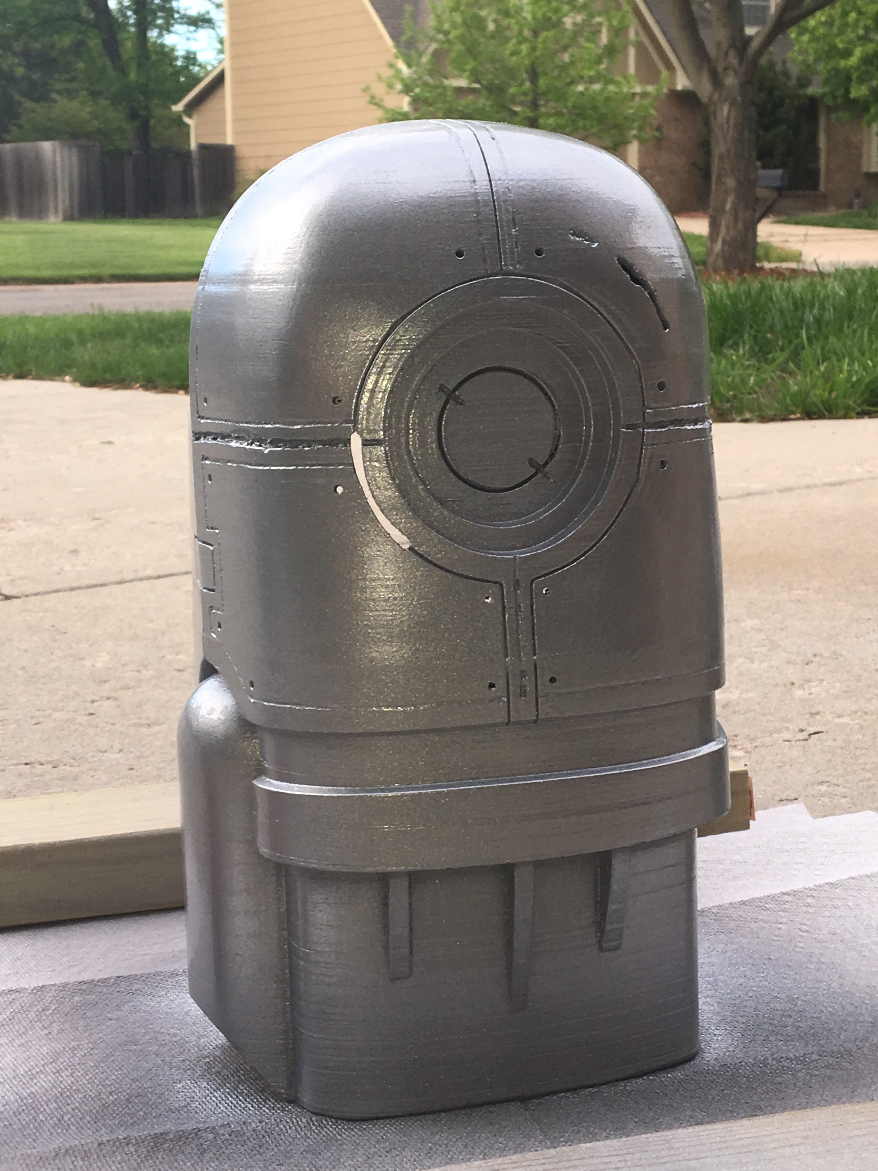

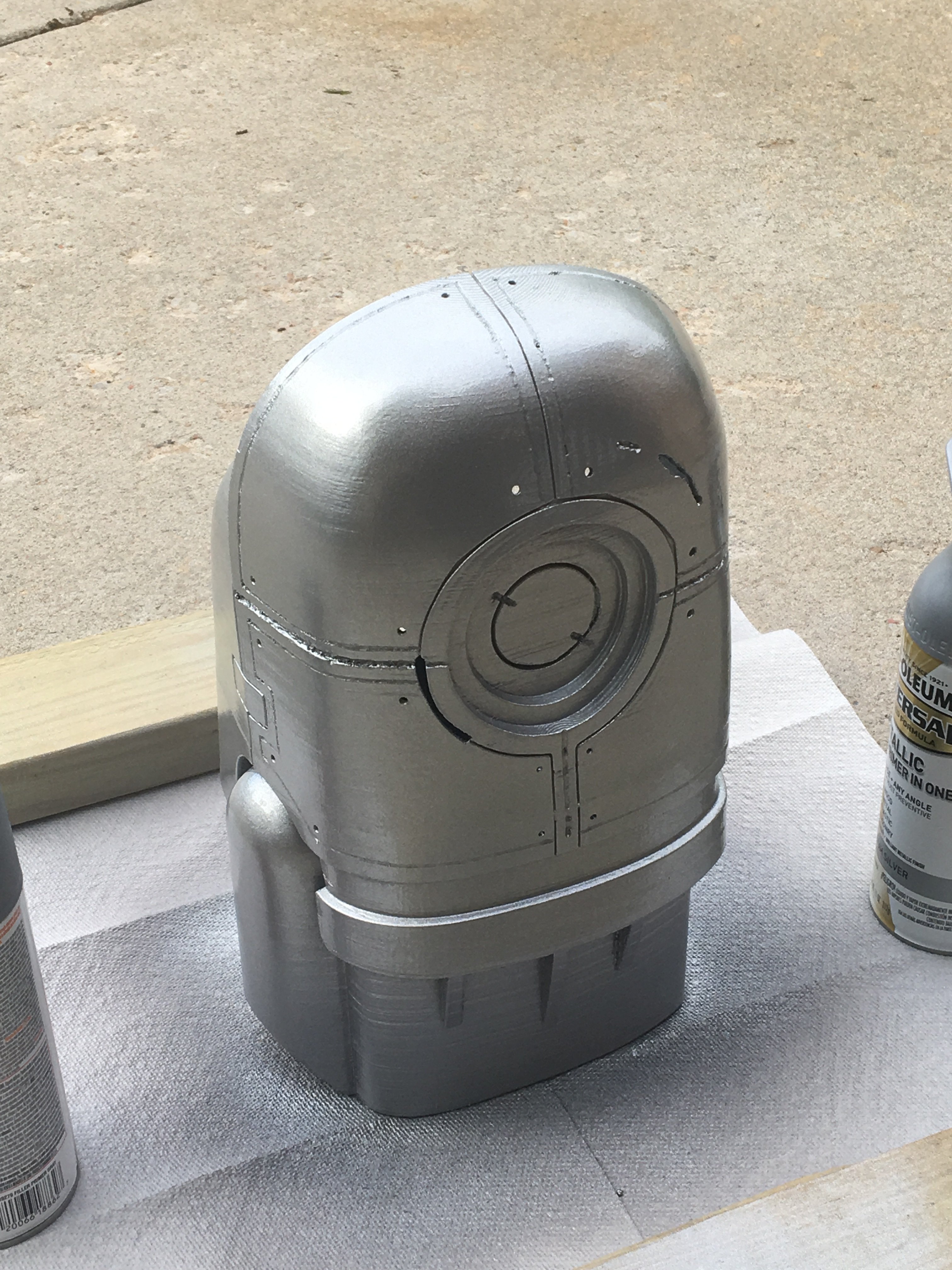

Some progress! Been out of town. Sanded and prepped left bicep today. Working on forearm too. Laid a test coat of metallic on it to see. Added the details to front shell. Looks alright.. here it is. Still have some small bondo work ahead but very little.IMG_0844.JPGIMG_0845.JPGsmal curved holein the big shoulder circle, might leave in as ventilation lol

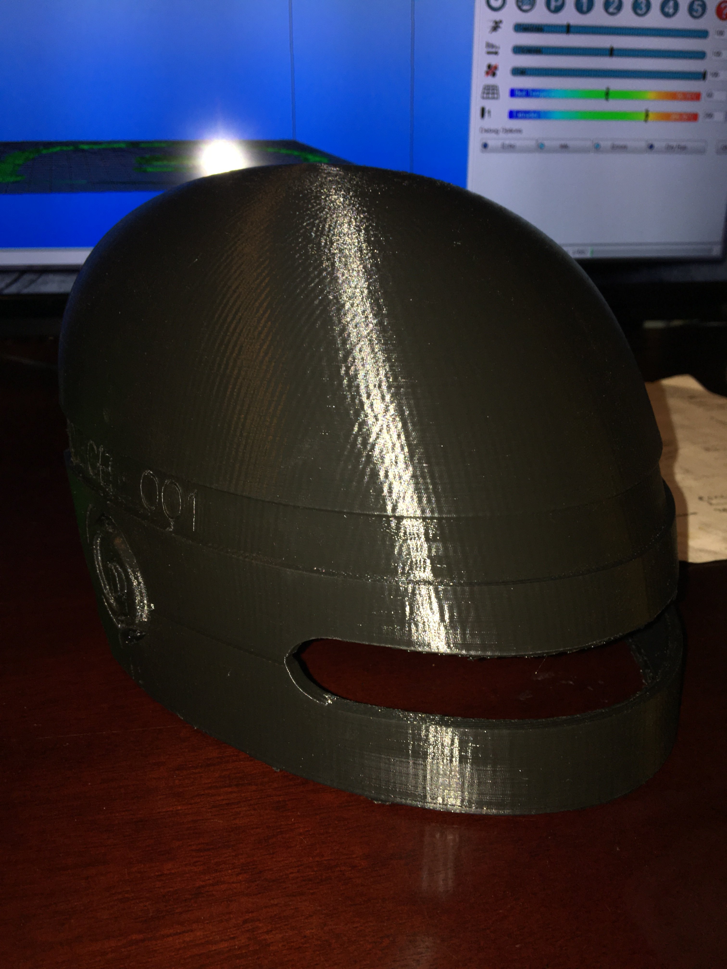

IMG_1138.JPGA long hiatus due to some long standing personal stuff has kept me from getting this suit completed. I am finally back to the grind. Helmet just came off the printer today. My aNet A8 was basically dead for a few months but I have repaired it and here we are.. good to return to my thread.. more to come. So great to see the progress all the other suits around me are making.
I have just started printing my own suit now. I'm starting wit the helmet. For your helmet did you slice it at all or print it upside down to reduce filament waste or was the whole inside printed with supports?
I cut the helmet into two pieces that fit on the printer bed. I printed it upside up. If you try to print it upside down you will have loads of support structure holding the outer shape up, without the support the helmet could break off and fall off the bed. As it went the main section only needed one main support pillar on the inside center and some smaller ones around the visor area.

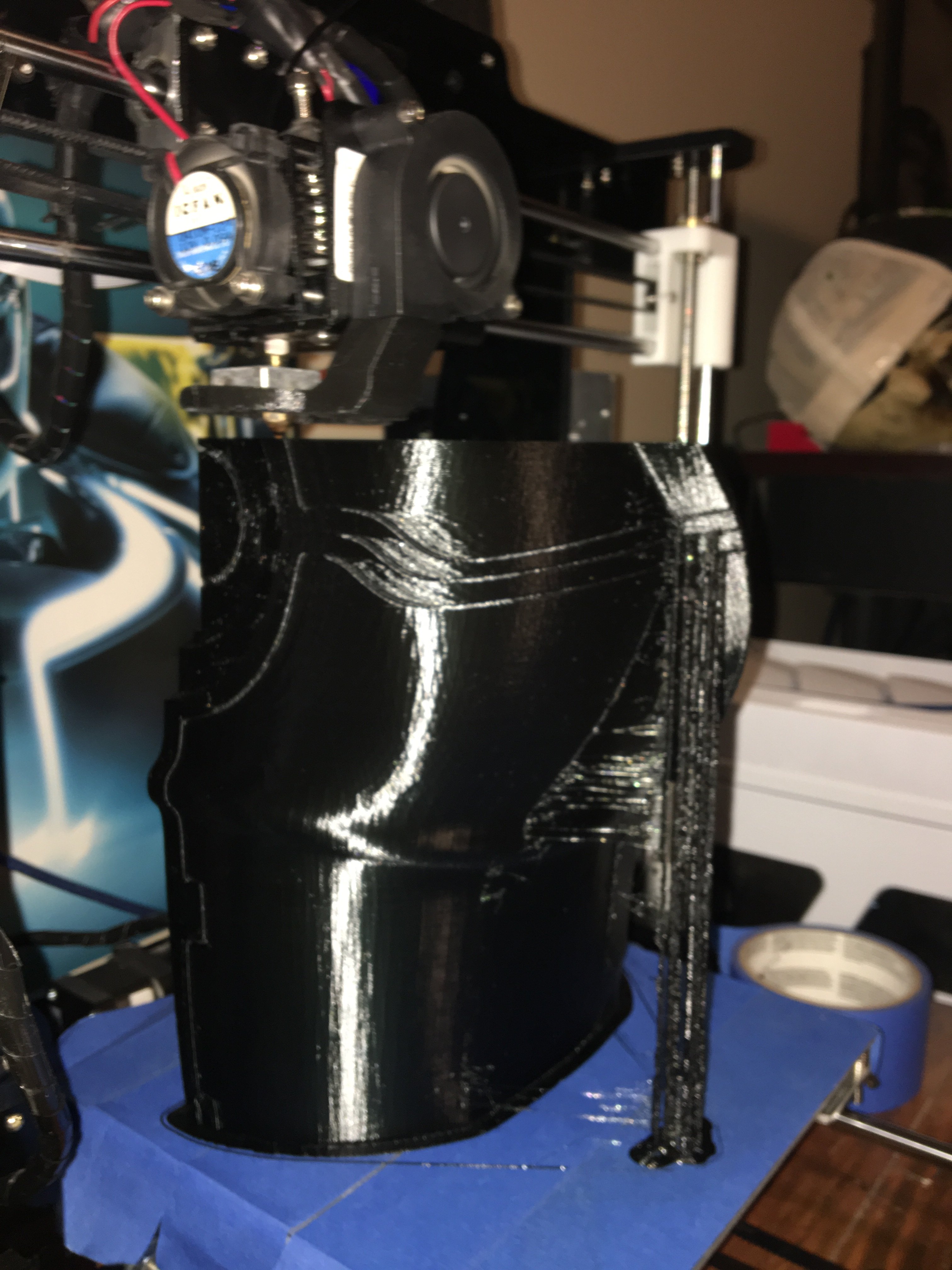

started the right leg today. :) excited as I think it will be the last of the parts I am going to print. Am going to use Crafting foam to recreate the torso so I can have more movement, the fingers as well. I decided on crafting foam for the fingers because well I wanted to be able to feel things through the foam as opposed to plastic, and I am really good at EVA foam work. ;)
